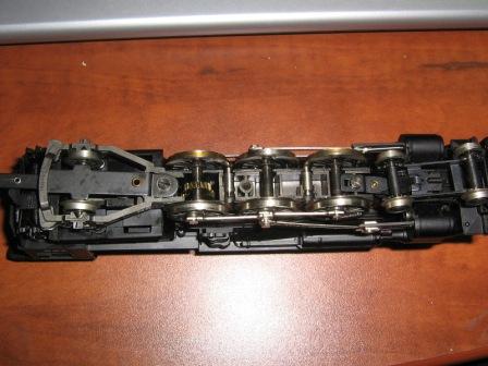

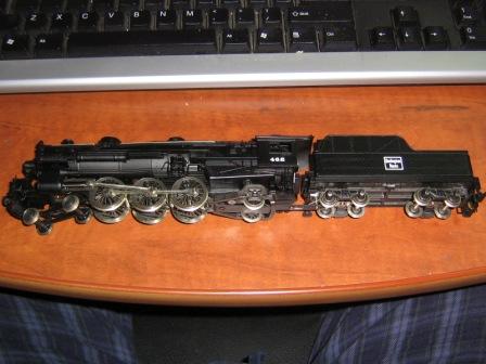

GOT THIS ONE IN THE MAIL TODAY BUT FUDGE
IT'S FALLING APART AND I ALMOST GAVE MY SHORTS FOR IT
I WANNA KNOW EXACTLY WHAT IS IT SO I CAN ASK FOR PARTS
TO YOU GUYS OR TO A COMPANY THAT SELLS THEM
RIVAROSSI 4-6-2... BURLINGTON ROUTE... TENDER SEEMS TO BE AHM
WRITTEN UNDER IT BUT I KNOW THESE 2 COMPANIES ROLL TOGETHER
ANY IDEA ABOUT THE MODEL ..... AND THE YEAR...
TX IN ADVANCE AGAIN...

BY THE WAY ENGINE'S NUMBER IS 462 (4-6-2)....
 Posted - February 10 2009 :  9:57:04 PM Link directly to this reply  Show Profile  Add shaygetz to Buddylist
AHM/Rivarossi Pacific...mid '70s when they started using .039" flanges.

Lexlie, it just looks like you need an axle cover, and the center screw. I have them in my junk box.

That the USRA Heavy Pacific?

heavy pacific all right but cannot find anything about burlington route
not 100 % sure about the tender says ahm but????
as for the loco the road number 462 did not appear anywhere

Now that you mention it, a closer look reveals a pretty spare set of side rods---definitely not AHM.
Ray Marinaccio
RayAvatar
 Posted - February 14 2009 :  12:39:50 AM Link directly to this reply  Show Profile  Add Ray Marinaccio to Buddylist
That's the AHM economy version.
#5088-E C B & Q (Burlington)
http://www.hoseeker.net/AHMRivarossiassembly/ahm462pacificrpg1.jpg
Ray
 Posted - February 14 2009 :  10:38:56 AM Link directly to this reply  Show Profile  Add shaygetz to Buddylist
Learn something new everyday---never would have thought that AHM would've gone the Tyco route.
 Posted - February 17 2009 :  09:49:31 AM Link directly to this reply  Show Profile  Add toptrain to Buddylist
Ray has got it. The economy pacific. You shouldn't have payed that much for it. No detail. Good parts to fix a much better heavy pacific.

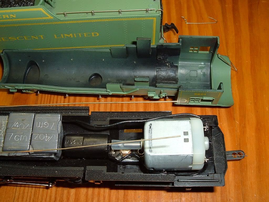

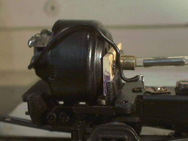

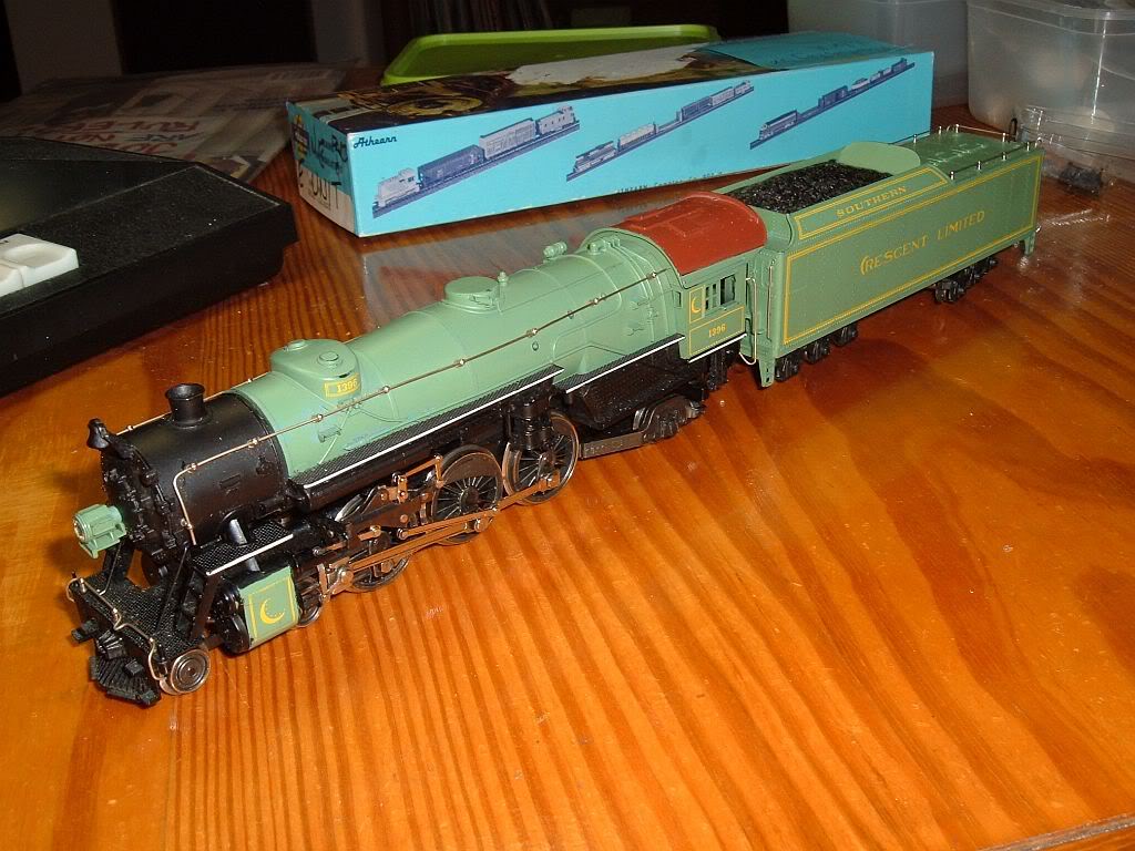

The worst Rivarossi design is the plastic motor mount in these Pacifics. I bought a Southern Crescent in 1978 (spent everything I had), and couldn't understand why the motor screws kept loosening up. It turned out the motor was melting the mount, and it eventually melted the plastic drive shaft as well. I don't know why it ran so hot, but I spoke to someone on another forum who had the same thing happen. Strange, because the Hudson has the same frame, but with a metal mount. It's not only sturdier, it helps the motor to cool itself, since it acts as a heat sink.
It's been remotored since. I still have the original motor in my parts box, and it runs cool now. I saw your regear and remotor of the newer RR pacific, Ray. How did you get the JB Weld to form the gear cover? I haven't found it to be that strong, even with everything degreased. Is it because I bought the quick set type?

I had the melted motor mount problem also on another one I rebuilt.

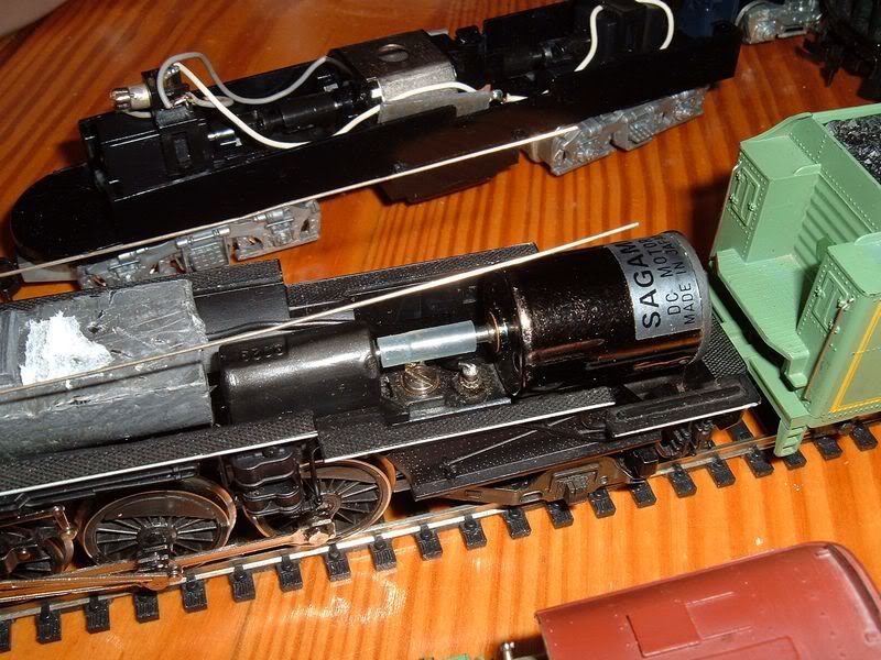

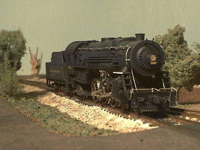

 Posted - February 23 2009 :  3:52:34 PM Link directly to this reply  Show Profile  Add NickelPlate759 to Buddylist
My first motor replacement was this Sagami, but it was too speedy with the stock gearing.
I recently decided to use a much cheaper motor, the one IHC used in their GG1's. It has much lower RPM's, and is completely silent. I had to hog a lot of plastic out of the boiler and firebox to make it fit, and put a floor in the cab.
The motor is wired directly to the drawbar.
Here's the old girl back together. She's been through a lot, but runs better than ever. Btw, I added the handrails to the tender using wire and stanchions from my scrapped Chattanooga when I was a teenager. I actually used a soldering iron to sink the stanchions into the plastic because I didn't own a pin vise.
