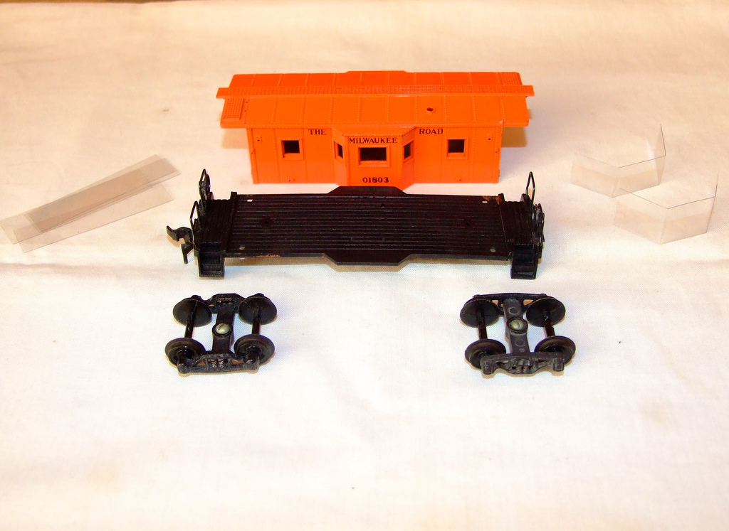

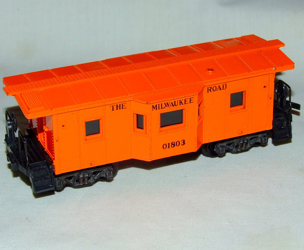

i was sent this lovely condition,milwaukee caboose,(no names) but as you can see its got some parts missing,can make,most but would love to keep it as original as possible any spares gratefully paid for ken
needs marker lights,ladders,chimney stack etc

Marx put that out too, you may be able to swap parts in that direction as well.

I have a Marx similar to that, except it's a cupola caboose--looks like they share lots of common parts except for the body. What parts do you need?
 Posted - February 10 2009 :  4:59:32 PM Link directly to this reply  Show Profile  Send catfordken a Yahoo! Message  Add catfordken to Buddylist

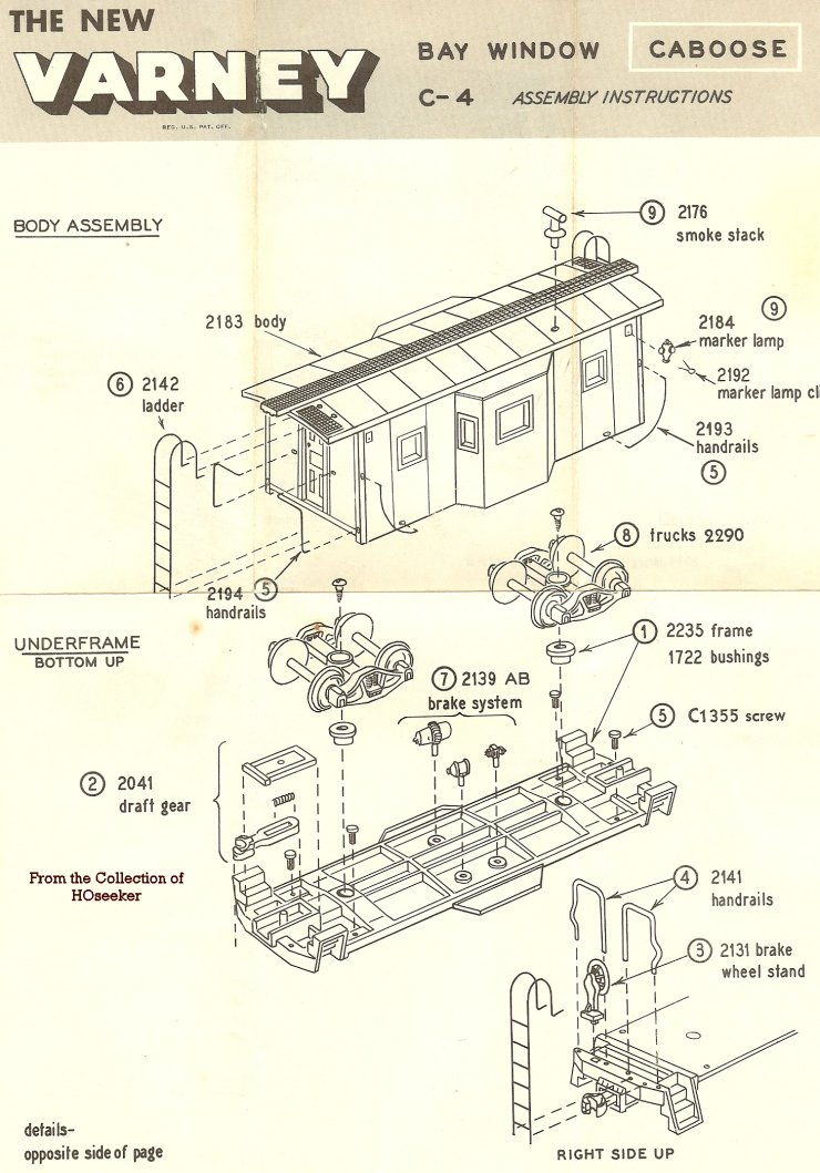

hi chris i need the 4 marker lights,chimney stack,2 ladders i can make the rest which are underside items,cheers ken
hope larry does not mind but this will show you what i mean

The Varney Bay Window Caboose actually shares a lot of components with the Varney Northeastern caboose - the frame is the same except for the wings for the bay, and the detail parts were all shared with the center-cupola Northeastern caboose (from the same period) too. Since these are much more common it shouldn't be bad to find one from which the correct parts could come.
The Marx caboose is from entirely different dies and shares nothing with this car.
This Varney car could be had with plastic or die cast frame, and was sold Undecorated from 1950-61. The Milwaukee Road version was 1959-61 only - and per the guide the only roadname offered. However curiously I have a very clearly factory decorated example that's painted box car red and lettered Kansas City Southern. The book doesn't even show a Varney loco in a scheme for that road. Some have theorized it may be a special run, but I haven't run into anything to clear it up for certain.

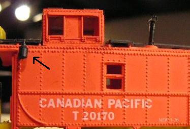

I have an easy substitute if the marker lamps are not found...
The Athearn diesel brake cylinder has a peg you could stick into the holes.
You will also notice that the tree-nick of the cylinder has a flat but round disk perpendicular to the cylinder... you can actually have a Right and Left marker lamp. And, no one would have to point out that you have two brake cylinders missing on the truck/bogie assembly on your diesel locomotive.
Actually, I have a dozen of my cabooses with these jiffy "marker-lamps" installed. You can even paint the little disk what is appropriate for your train.
Now, if you are gonna count rivets, these little fixes may seem gawdy.
