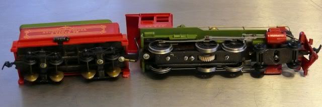

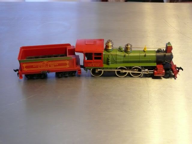

I dug this one out of a shoe box & noticed I can't find a maker mark on the underside.
It is primarily metal, tender sides & engine cab are plastic. It has the old style 'slot car'?? motor.
Pick up appears to be the brass wheels on 1 side of the tender. Which bothers me as the tender body sways like a palm tree in a good wind. Which may explain why it runs quite erratically. Speeds up/ slows down unassisted.
Any ideas on who made it/era/ & how to get it running more smoothly?

Definitely an old Tyco/Mantua old-time steamer. For electrical pickup, clean loco wheels AND tender wheels. Also clean the surfaces between the tender and tender trucks. I've used fine steel wool on tender trucks. Some advise against this, but if the trucks are disconnected from the tender, there's no chance of getting steel in the motor. These locos tend to have a wobble in the tender. You could file the tender trucks and mounting area a bit, as many Tycos have little nubs that the trucks ride on rather than the tender floor. You could also add some weight to the tender. For the motor, carefully oil the front and rear bearings (and clean/lube the axle bearings also). You could even clean the commutator (motor shaft). Hope this helps.

I am always hazy about where the electrical pickup is meant to occur on these older locos wired back to the tender.
Are you saying the loco wheels & tender wheels bothl pick up??

Not being a smart ass,but the wheel arrangement is a 4-6-0.

Yes, the tender wheels pick up from one rail, and the loco wheels from the other. You'll notice the non-pickup wheels being insulated or plastic.

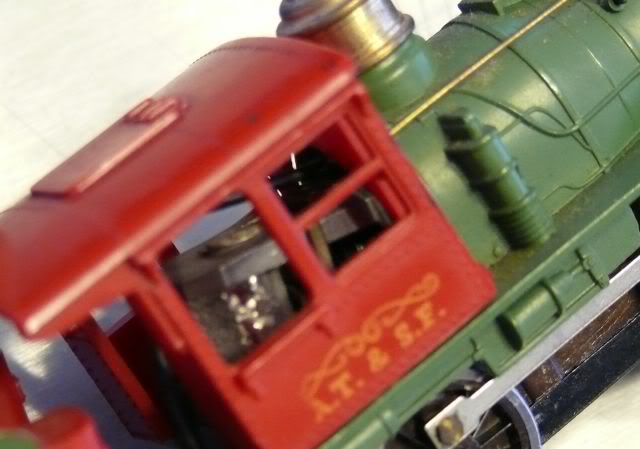

It's missing the motor cap, smokestack and the tender load piece (there were two, a wood load and a top deck with coal load and toolboxes on the sides).
