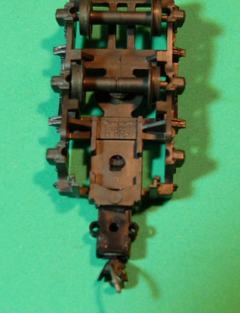

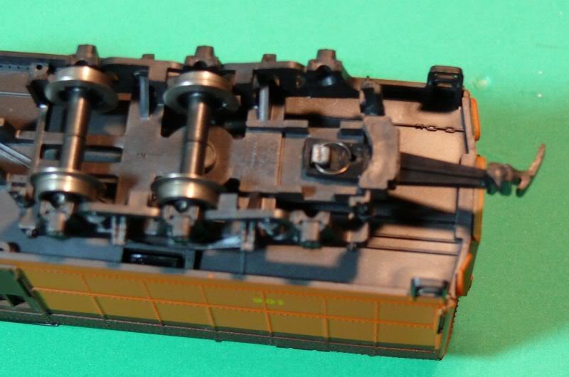

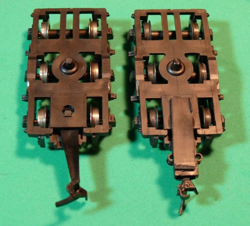

TankedEngine
 Posted - September 09 2008 :  8:04:44 PM Link directly to this reply  Show Profile  Add TankedEngine to Buddylist
I now have some pictures, which I suspect will confirm what prior posters have said & that I am probably looking at complete truck sets [do they come with coupler]??
Here would be the Rivarossi & Kadee couplers from underneath & the pair side by side from the top - except I can't figure out how to insert the images into the message like Ken did. Copy & paste? Doesn't want to paste
Help wld be appreciated & thank you Ken for your kind offer earlier re spare couplers.
Tanked
 Country: USA  ~  Posts: 243  ~  Member Since: September 08 2008  ~  Last Visit: January 04 2012 Alert Moderator  Go To Top Of Page

TankedEngine
 Posted - September 09 2008 :  10:24:20 PM Link directly to this reply  Show Profile  Add TankedEngine to Buddylist
[quote]I'll tell ya how to upload pictures, it's quite simple:
Thanks MM 1498. Lets see if this works
Ok, if one refers to my previous post then the photos make sense. In summary- am I looking at new trucks with the Rivarossi couplers because of the way the Kadees have been fited?
Thanks
Tanked

Ray Marinaccio
RayAvatar
 Posted - September 09 2008 :  10:49:24 PM Link directly to this reply  Show Profile  Add Ray Marinaccio to Buddylist
If you could get all the KD mounting off without damage, you should be able to use the newer style coupler by putting a round post on the old trucks for the newer style coupler to pivot on.
Ray
