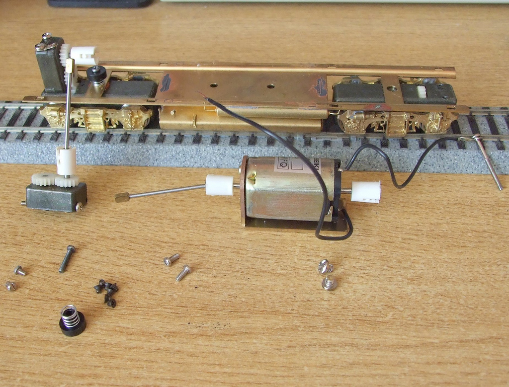

i hate asking but eyes failing,etc,has anyone split the body from frame on one of these,there are so many screws do not want to undo the wrong ones ken

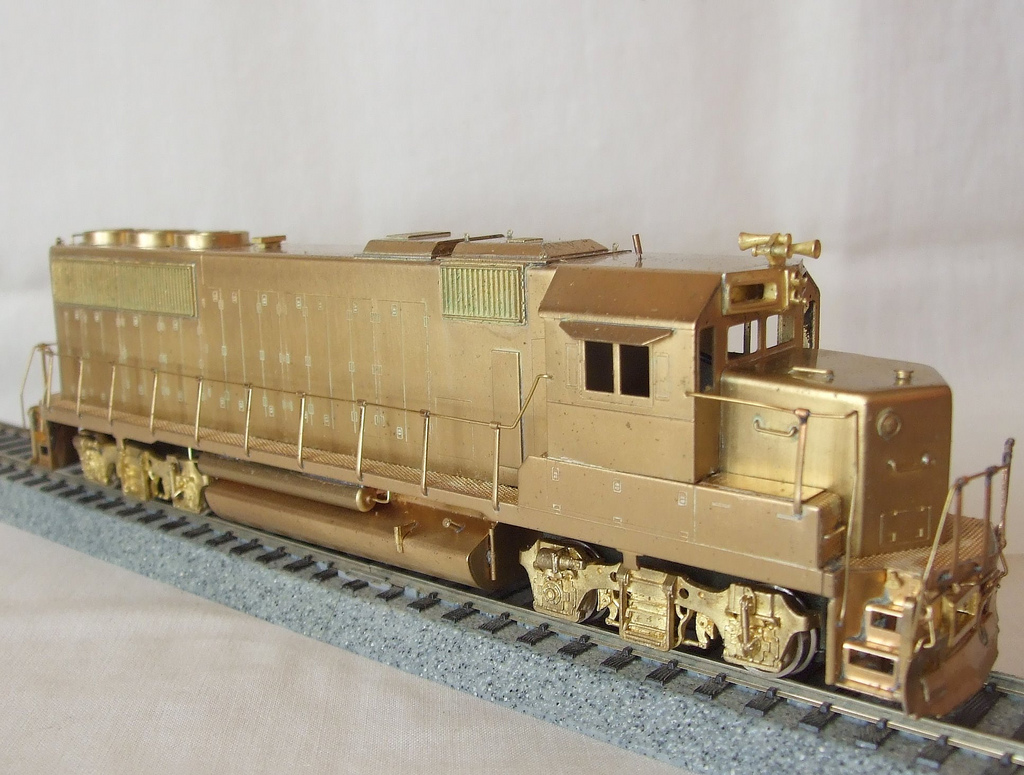

i have not gone over to brass,but if it tickles my fancy and is something that i think will go up in value for kids i buy it,this cost me 50 dollars all in but it has faults,noisey motor,handrails need straightning,as does horn etc but is boxed and had little use seened a good chance

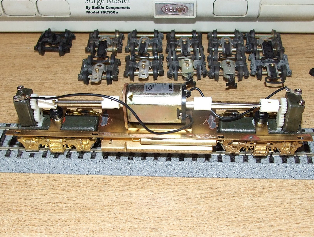

hi guys after trial and error got it apart,no damage caused by me,but the interior tells a few tales,firstly its been repaired by a novice,soldered wires to screw,which needs to be free to access screws to trucks,to adjust movement,and gear maintainance,and one truck was missing insulater between truck and frame,hence non working,but am forging ahead,like a blind man with sunglasses,ken
motor is a canon en22-t12

One lesson i learnt from this is not to tighten the truck screws to tight otherwise it jams the cogs of the drive train,so beware if you have one of these
got this far,replaced missing insulater,assembled all parts after cleaning,lubing,care of a friend,runs as sweet as the day it left factory,if not better,with a few spare mantua complete bogies in background,ken
now the hard bit straightening the brass bits

You lucked out, Ken. For $50 bucks you got a unit with minimal issues, and a good Canon can motor instead of a big ol' Pittman. Those resemble Hobbytown gear towers with plastic gearing. Even better news, there's plenty of room for flywheels.

You could probly get some Athearns on there depending on shaft thickness and use some Athearn couplings to mate them to the gear towers. Yes you did luck out for 50 dollars, I got my first brass engine for 90 dollars it was sitting on the shelf of my dads friends hobbyshop since 1970. A sw1500.

NWSL would be a good source for flywheels that would fit, just measure your shafts. The most common are 2.5 and 3mm. Nice work...
