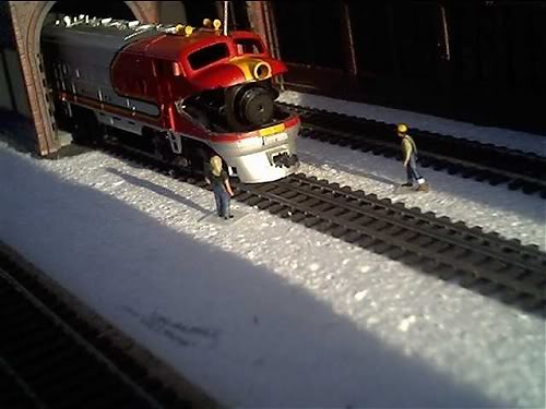

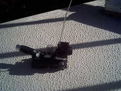

Funny you should mention that as I did that very thing about 5 years ago. [;)] I mounted it on the truck and cut a slot in the nose so that it could pan back and forth with the track....
Sadly, the camera met an untimely death when I accidentally crossed the polarity on the battery...sigh...

Hey Shaygetz. Clever design. I was thinking more of putting it behind the cab window (you'd be able to see the window frame and nose so it would be like an engineers view), but that's neat how yours can pan with the curves in the track. Where did you get the camera from?

Thanks, the position came from experience. It just felt more realistic at that level. The nose or roofline would create a fuzzy "hemisphere" that I didn't care for. The best effect I felt was to aim the camera to the track about 3 feet in front of the engine. The pan really worked well and help take away the "thrown from side to side" effect as you approached a curve. The camera came from www.wirelessmicrocolorcam.com.
