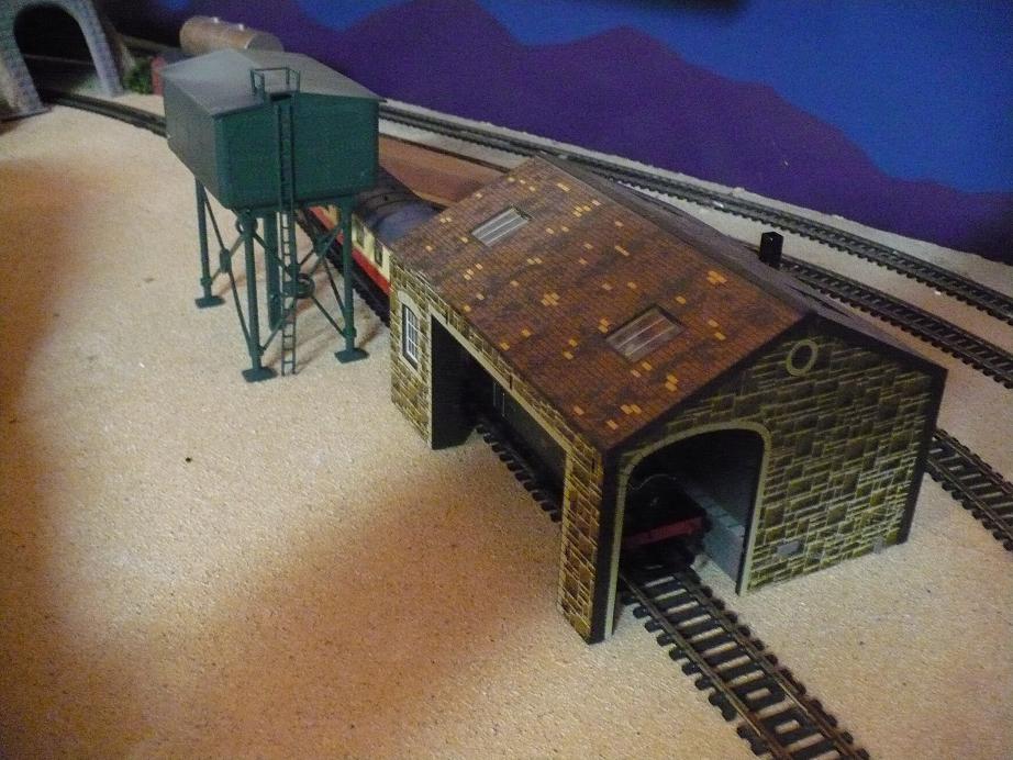

Hello All--Time for an update on my 'new' layout...the one seen above on this topic. As much as a liked the idea of 2 passing sidings, a diamond crossing, and the really cool control panel I made, It couldn't do what I wanted, i.e. have a solid run with 22" minumum radius, not short out my new British models with wide wheels, and be able to operate in a somewhat realistic manner (besides watching 2 trains pass). So, simpler, but better, I think. You can see that I have an outer loop of 22" radius. A switch leads off the main (left rear of photo) to give a connection to the rest of the world. The inner loop (the branch line) connects to the outer via a crossover. On the back side of the branch is an electric switch which will lead to a mine or something. With careful placement of insulated joiners and use of Peco power-routing switches, I do not need any block wiring or electrical switches. At least 2 locos can be on the table at once, and either can get to any spot on the layout. Generally, freight can be brought from the outer spur to the branch, and a passenger train can run the outer main, dropping off cars for the branch loco at the crossover. I have only set down some temporary scenery so far. Notice the holes in the front fascia (sob..) where I removed the control panel.
