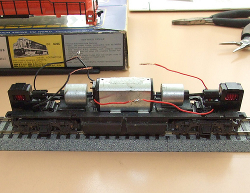

hi,i am puzzled,hoseekers site shows a completly different chassis and set up to mine,mine is shown below,would show hoseekers but have not had reply to request,can anyone help ken

I have two of these that look just like that, but yours is missing the plastic worm & motor covers where the headlight used to go.
Assuming the motor has a wire from each pole, connect one pole to each truck, on the same side (rail). The colors are irrelevant (do not try to connect the same colors or it will short). IN other words: wires from the left side go together, as do the wires on the right side. If the loco goes "backwards" compared to others, then swap the pole leads.

 Posted - April 20 2008 :  3:52:18 PM Link directly to this reply  Show Profile  Send catfordken a Yahoo! Message  Add catfordken to Buddylist
hi as you can see from photo have connected 2 lots and it runs smoothly,are you saying thats wromg ken

Hey Ken,
Looks like you just need to connect those 2 loose wires. Right now your loco is picking up current on only half the wheels. Seems you will need to add some extra length of wire to get the connections to reach.
