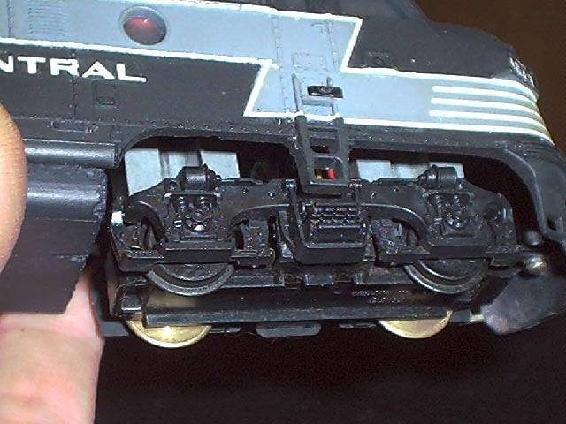

Last night as I was running my CN MU-2 powered F-7, I noticed that 1 of the 2 fuel tank posts was broken. Although the second one can hold the tank in by itself, I'd like to fix the broken post before the other one snaps. Does anyone has any ideas for fixing this? I'm thinking super glue, but I'm wondering if there is anything better to use on plastic.
I've lost 3 other CN F-7's to fuel tank problems, which I would like to fix. Here are the problems...if any one has any suggestions for fixing them let me know. (All of these are mounted on single posts btw).
The first one has the fuel tank, but the post has completely snapped off and is stuck inside the tank. Basically there is nothing to mount it on.
The second one has the fuel tank, and most of the post, but the top has cracked off and the remainder of the screw is stuck in the post. The tank stays in, but is not very secure without the screw.
The third one is missing its fuel tank (post is fine)...I'll have to find a new one.
