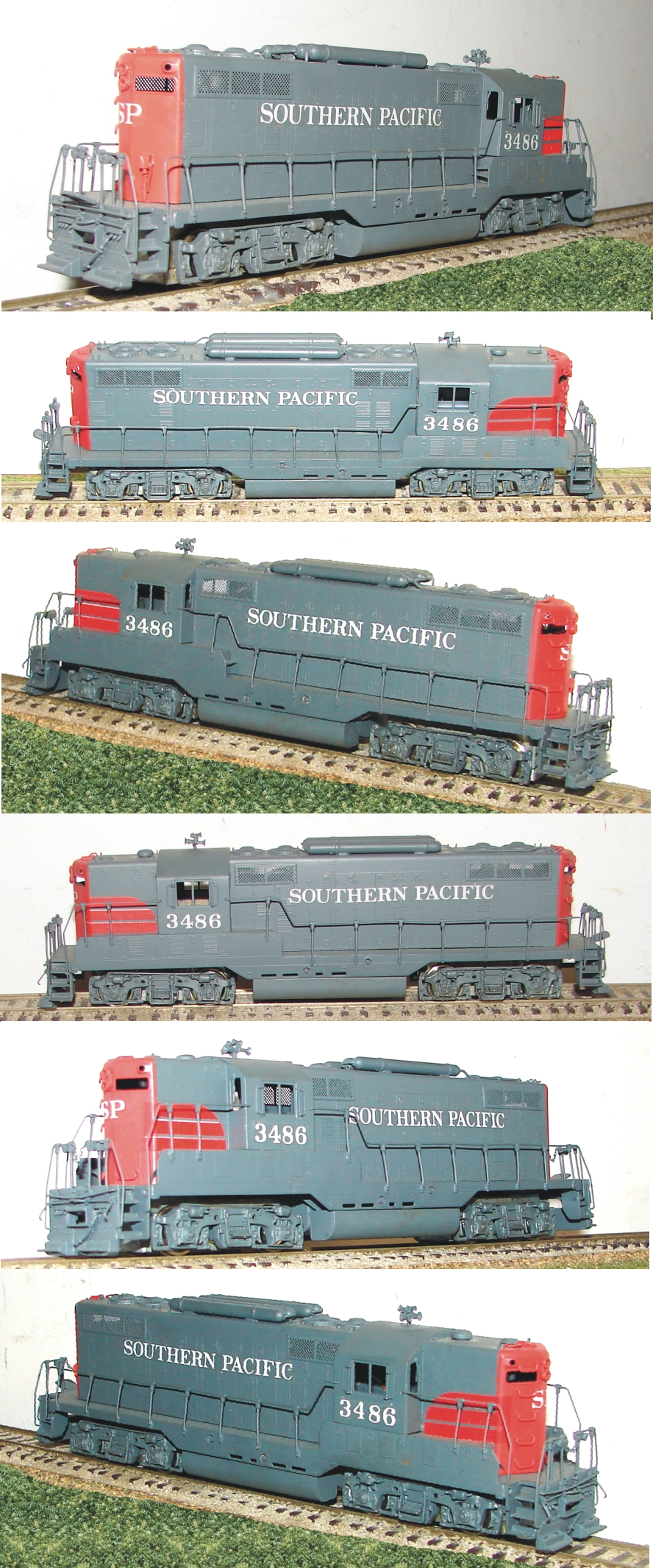

I have a few of the Mehano GP 18s that I reworked
They are a decent locomotive with potential.
Kind of a diamond in the rough.
I bought one back in the 80s for $9.99 at Woolworths. Still have it in the original box in A1 condition.
Some only had 4 wheel electrical pickup that is easily upgraded by adding 2 more wipers Most have the mounting slots for the wipers and all that is needed is to slide them in place and connect the wires.
Changing the gear ratio from 9/1 to 18/1 can be done by installing a Kato worm in each truck.
Upgrading the motor is an easy swap also
Oddly the thing I dread doing the most on these locos is changing the hand railings.

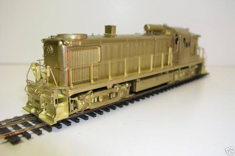

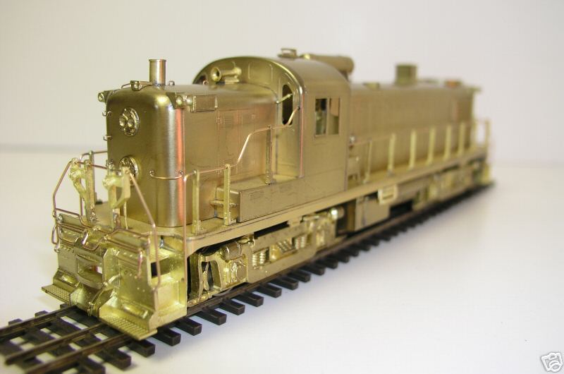

Ultimately my AHM GP18's/RS2 will become:
1) GP18 CNR long hood forward, old Green/Yellow paint, passenger version with air tanks on roof. Kinda like this:
2) RS2 Commuter-NYC, kinda like this:
3) RS2 LV: Just make power improvements and replace railings?
