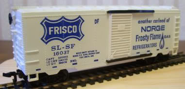

Hello,
I just joined the group and am looking forward to learning about Tyco, and other manufactures of interesting toy train models. My primary interest is Frisco. Thus, I am trying to collect at least one of all Frisco models made by the different toy manufactures. I have started with Tyco, which does not appear to have produced many Frisco toy trains. I have the Frisco auto loader, Frisco Spirit of 76 caboose, and two other cars, one of which I have a question about. I recently purchased a SLSF 16037 box car with ‘another carload of Norge Frosty Flame gas refrigerator’ billboard on the side of the car (unfortunately there is not a box). I have always thought this to be a Tyco car, having seen it advertised as such on eBay, but can not find a Tyco marking on the car. All it says is, ‘made in Hong Kong’ on the bottom of the car. Does any on know if this is a Tyco car? The other car I have is a Frisco refrigerator car.
Does anyone know if there are other Frisco cars made by Tyco?

 Posted - April 01 2008 :  9:38:38 PM Link directly to this reply  Show Profile  Add GoingInCirclez to Buddylist
To my knowledge you already have the only two Frisco cars that Tyco made: the Autoloader, and So76 caboose. There are two versions of the caboose though: one has a built date, the other does not. ( Incidentally, the loco that "matches" the caboose is based on a Seaboard Coast Line prototype. )
I've seen the Norge boxcar a few times on ebay and it is NOT a Tyco car. The tooling on the roof gives it away, it extends higher above the carsides and not as peaked. To me, it looks more like early Life-Like / Varney tooling, but I am not certain. I have never seen it properly ID'd.
A lot of rookie / lazy ebay sellers list any random train under Tyco, because it is such a famous (or infamous, depending on one's outlook) name. All Tyco cars have the name Tyco (sometimes Mantua) embossed on them however.
*EDIT* Well, seems there are two more on ebay and this time the sellers claim they ARE Lifelike / Varney. Given the better photos, I have to agree. Different colors too... haven't seen the red one before.
280214078449 and 310035888057

 Posted - April 02 2008 :  12:57:25 AM Link directly to this reply  Show Profile  Add n/a to Buddylist
Thanks for the reply’s guys!
I saw the two Norge cars on eBay. The one advertised as Life Like is what got me wondering what I had purchased. There is also another guy selling the Norge car who list’s it as Tyco. (It is a buy now). The other car I got on eBay is a Frisco/GRAX 40 foot refrigerator car. I emailed before I bid and the guy said it had Tyco on the bottom. We shall see!

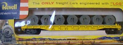

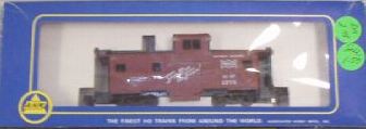

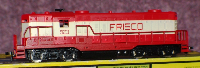

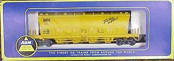

 Posted - April 03 2008 :  2:29:06 PM Link directly to this reply  Show Profile  Add Tony Cook to Buddylist
Here's a few Frisco items...
Life-Like 40' Box Car
AHM Flexi-Flow Hopper
AHM GP18
AHM Extended Vision Caboose
Revell Cable Reel Car
