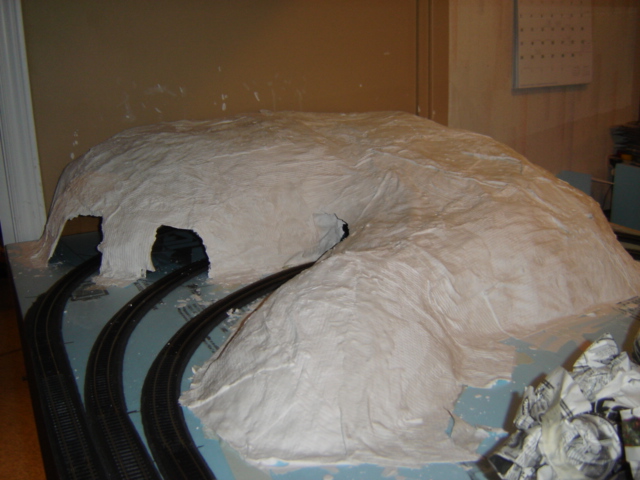

I've gotten the basic shape of my mountain using crumpled newspaper, and a very thin layer of paper mache. Now I'd like to put some paper towel dipped in plaster over top. Can anyone tell me how thick the plaster should be???
-cheez

It would probably be easier just to get the rolls of stuff, that basically is the paper towels with dry plaster, just cut to size, dip in water and fit it on. I found this to be a lot easier and cleaner than the other way.

Hey Jeremy. I have looked at those, but they seemed kind off expensive compared to just dipping paper towels in plaster. $10 per role of plaster cloth vs. $3 for a box of plaster. Plus, where's the fun if you don't get really really messy.[:D] [:D] [:D]
-cheez
 Posted - February 27 2008 :  03:28:48 AM Link directly to this reply  Show Profile  Add Brianstyco to Buddylist
Cheez--the plaster should be close to a soup mix so the towel will abosrb the plaster. The brand of plaster mix i use is DAP and is sold at Lowes-ACE hardware-Wal-Mart and probably most other hardware stores. The plaster rolls from woodland scenics work great also. The tub of DAP will make a lot of mtns. Have fun getting plastered!![:)]

I got the paper towels dipped in plaster on the mountain yesterday. BIG MESS....GOOD FUN.....good good fun...[:D] And its not over yet....I still need to spread some thicker plaster on top just to smooth everything out a little. I pulled the crumpled newspaper out of the shell today, and just kinda piled it next to the mountain...it looked good, and now I'm wondering if I should make the mountain longer.[B)] Anyway, here's what I got done so far:

Hi CHEEZ--They look great. You should consider Woodland scenics tunnel portals--They really enhance the openings. I hope you made a cut out in center to get to any derailments--when i built my first mtn--train ran fine and then derailed-had to get jig saw and cut out holes to retrieve train--easier to install access before built than after. Use flat green or brown spray paint on the plaster before adding earth materials or leave white for snow capped mtns--just a suggestion on the paint.
 Posted - February 28 2008 :  8:12:10 PM Link directly to this reply  Show Profile  Click to see DaCheez's MSN Messenger address  Add DaCheez to Buddylist
I'm not entirely sure what to do about portals, but i'll take a look next time i'm at the hobby shop. There are no holes cut in the middle of the mountain, but all the track exits are big enough for me to get my arms through, and on the back 2 tracks share one exit which is fairly big. For paint, the steep walls by the track are going to be stone grey and the rest is going to have green ground foam sprinkled on it, with green or brown underneath.

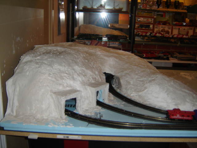

 Posted - February 29 2008 :  11:56:58 PM Link directly to this reply  Show Profile  Click to see DaCheez's MSN Messenger address  Add DaCheez to Buddylist
That was EPIC[:D] I tried making concrete portals for 2 of the tracks and I think they turned out pretty well. On the inside loop I put concrete walls on either side of the track. They should look much better once they're painted. The finish is now very rough and bumpy...LOOKS GREAT[:p]
-cheez
 Posted - March 01 2008 :  07:36:25 AM Link directly to this reply  Show Profile  Add Brianstyco to Buddylist
The portals look great!!! Nice job. You could use gray primer for the concrete color or FLoquil concrete color paint. The gray primer you can get at wal-mart for $0.99
