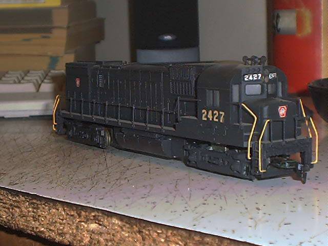

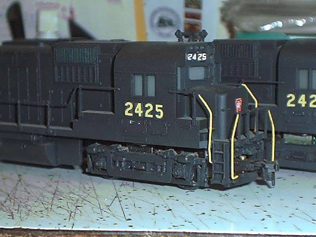

Here are a couple of PA. C430s I built. The decals seem to be coming loose but they still look good for their age.
Thia is a PC unit I did.

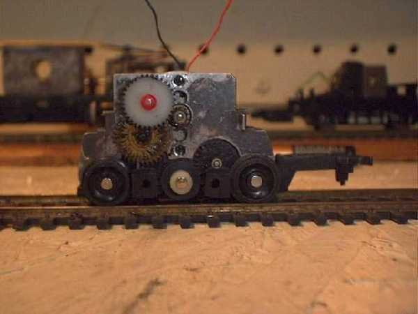

If you look close at the truck you can see the new motor that was transplanted.

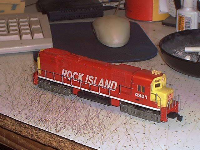

This is another shot of the CR C430.
A RI C430.

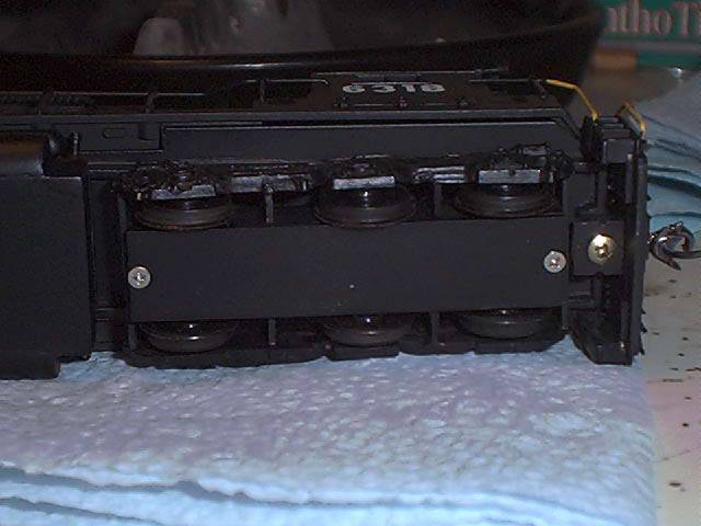

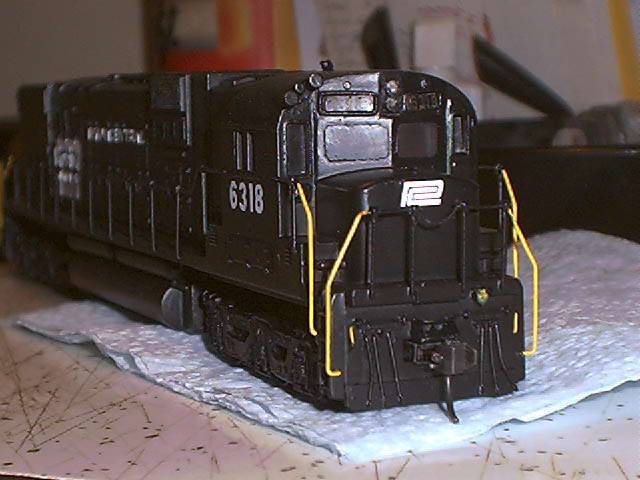

This is a closer look at the low nose C630 I built.
This is one of the scratch built dummy trucks.
The truck frames are built up from styrene and the sideframes were cast from resin in wax molds using L/L C628 sideframes as patterns.
You can see the coupler mount in this photo also.

Ray,
What kind of motor is in that PC unit?
Some kind of can motor?

That trick truck in the PC unit was an experiment I did to find a solution for the weak PT motor.
I mounted the truck block in the Lathe and machined out the motor cavity enough for the can motor to fit.
The motor is a 3V motor from a portable CD player.
I didn't have a pinion gear to match the original Tyco large gear so I set up another set of gears. The gears gave it a higher reduction and gives it some enormous pulling power.
I have a Resistor in series with the motor (I forget what size) and added more weight to the loco.
I am working on a pulse-width-modulating circuit to replace the resistor.

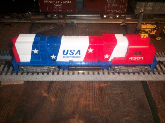

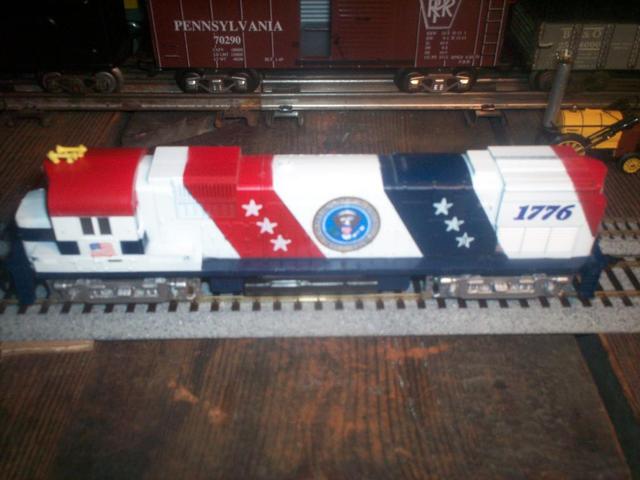

Here a few pics of my pristine Presidential Seal C430.
The handrails are in the box.
Picked this baby up for $3.00 at my LHS.
Carl T.

 Posted - February 17 2008 :  07:08:43 AM Link directly to this reply  Show Profile  Add Brianstyco to Buddylist
Carl T.
Originally posted by choochin3 - February 16 2008 :  01:44:15 AM
$3.00!!!!!!!!! for a lettered Presidential seal!! W-O-W That was a steal for the condition of seal and loco. The one i bought several years ago mint off ebay was way more than that. Great score

 Posted - February 26 2008 :  01:05:43 AM Link directly to this reply  Show Profile  Add thetycoguy to Buddylist
Carl T.
Originally posted by choochin3 - February 16 2008 :  06:44:15 AM
sweet! at my lhs those are about $50.00!

 Posted - February 26 2008 :  02:03:39 AM Link directly to this reply  Show Profile  Add romcat to Buddylist
Hey Ray:
Where did the nose for your 630 low Nose come from? Profile looks differnet than the Tyco 430 which sucks.
Ray Marinaccio
RayAvatar
 Posted - February 26 2008 :  03:34:18 AM Link directly to this reply  Show Profile  Add Ray Marinaccio to Buddylist
Hey Ray:
Originally posted by romcat - February 26 2008 :  01:03:39 AM
I cut down the high hood and made a new top for the hood.
The arch to the hood was formed as close as I could get it, glued on, then filled and sanded to shape.
I was going to look at the C430 or C628 noses for my next one.
Ray
