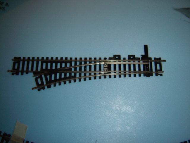

Hey guys. I finally started working on my new layout yesterday. I was laying down track (temporaily) just so I could mark where the track bed should go. When I came to a switch, I found 2 problems. (it is an atlas left manual snap switch code 100, item #860)
1) The switch came with a 1/3 18" radius curve piece of track. I want the track coming off the switch to run parallel with the original track. What size curve piece would I need for this??
2) The little tab that sticks out of the switch (the piece that moves side to side when u open or close the switch) is too big, and almost touches the track next to it. Does this piece just pop off?

2 of tose 1/3 pcs will get you along side perpendicular...as far as the tab..do you mean the throw bar?...the piece that moves the rails?....it depends on the age of the switch...the older ones have rivets...but the newer ones have a little box in the center...and that centers the rails (I think)..that version you can just snap out..CAREFULLY....I usually shorten mine...drill a hole for the CABOOSE ground throw and install..hope that helps

ok thanx.[:D] i checked the switch again, and it looks like it will fit without being modified. the switch is brand new btw. the part that i was talking about is the small black rectangle:

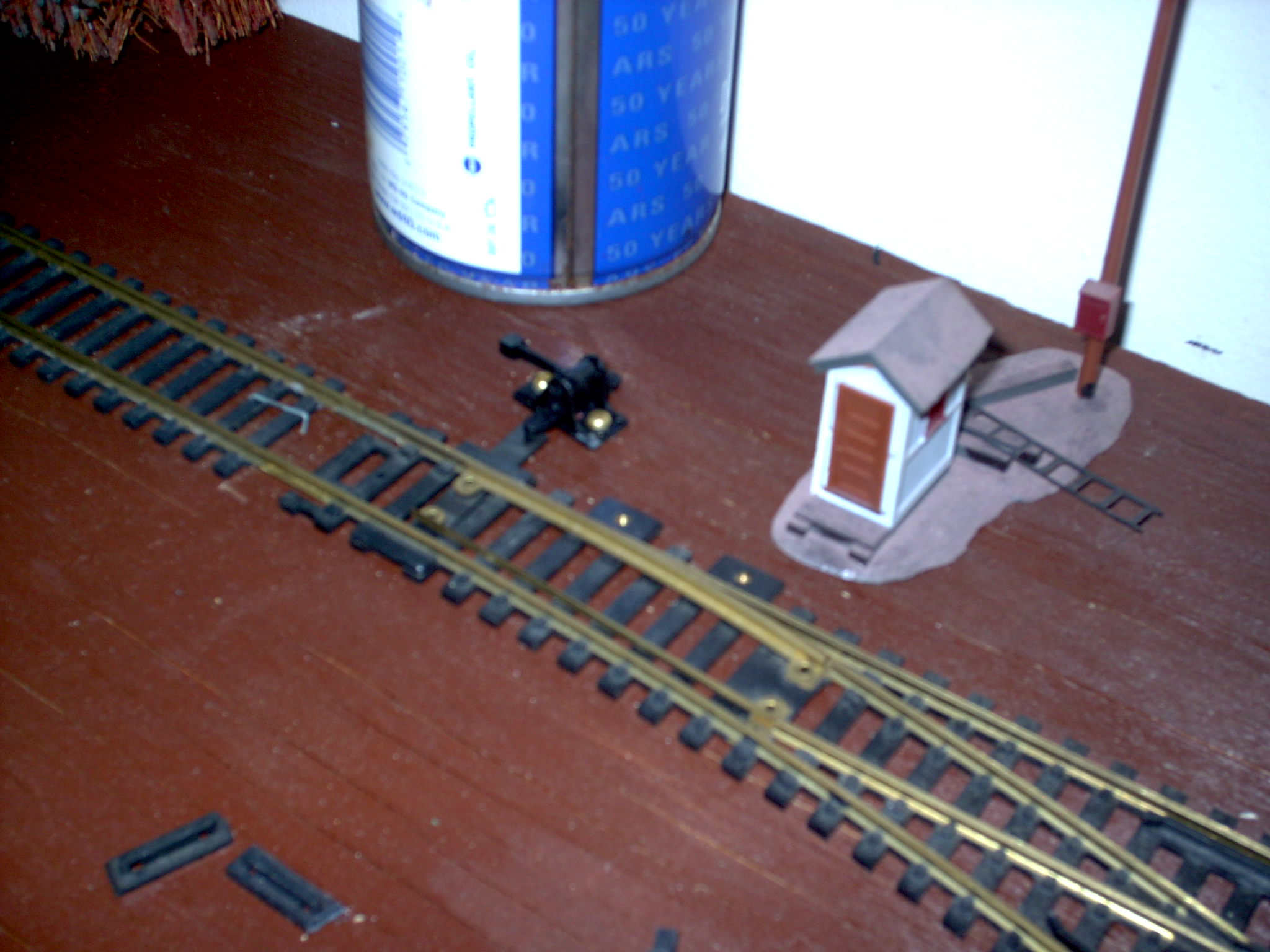

Yep thats the throw bar...I chop off about a 1/3 of that...A Caboose Indutries ground throw is a larger than scale hand operated switch machine...fastened to the benchwork and connected to the throwbar of the switch...its a hair large but closer to prototype than the machines that come with them...

pic of Caboose ground throw on one of my older Atlas turnouts...screwed to benchwork with very small wood screws...
