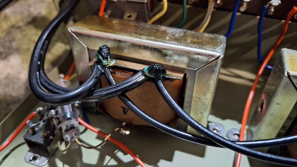

Well, after opening and testing components on the MRC D-2000 'Master Twinpak', I can confirm that one of the 2 transformers is dead.
So, if anyone has a TESTED and WORKING replacement transformer, PM me.
Measurements:
Input: 120v AC (standard house power)
Output: 20v AC, 1 amp
Width (not including mounting brackets): 2 3/8 in (6.1 cm)
Depth (across coils): 1 3/8 in (3.5 cm)
Height: 1 7/8 in (4.8 cm)
Distance between mounting holes: 2 7/8 in (7.3 cm?)
