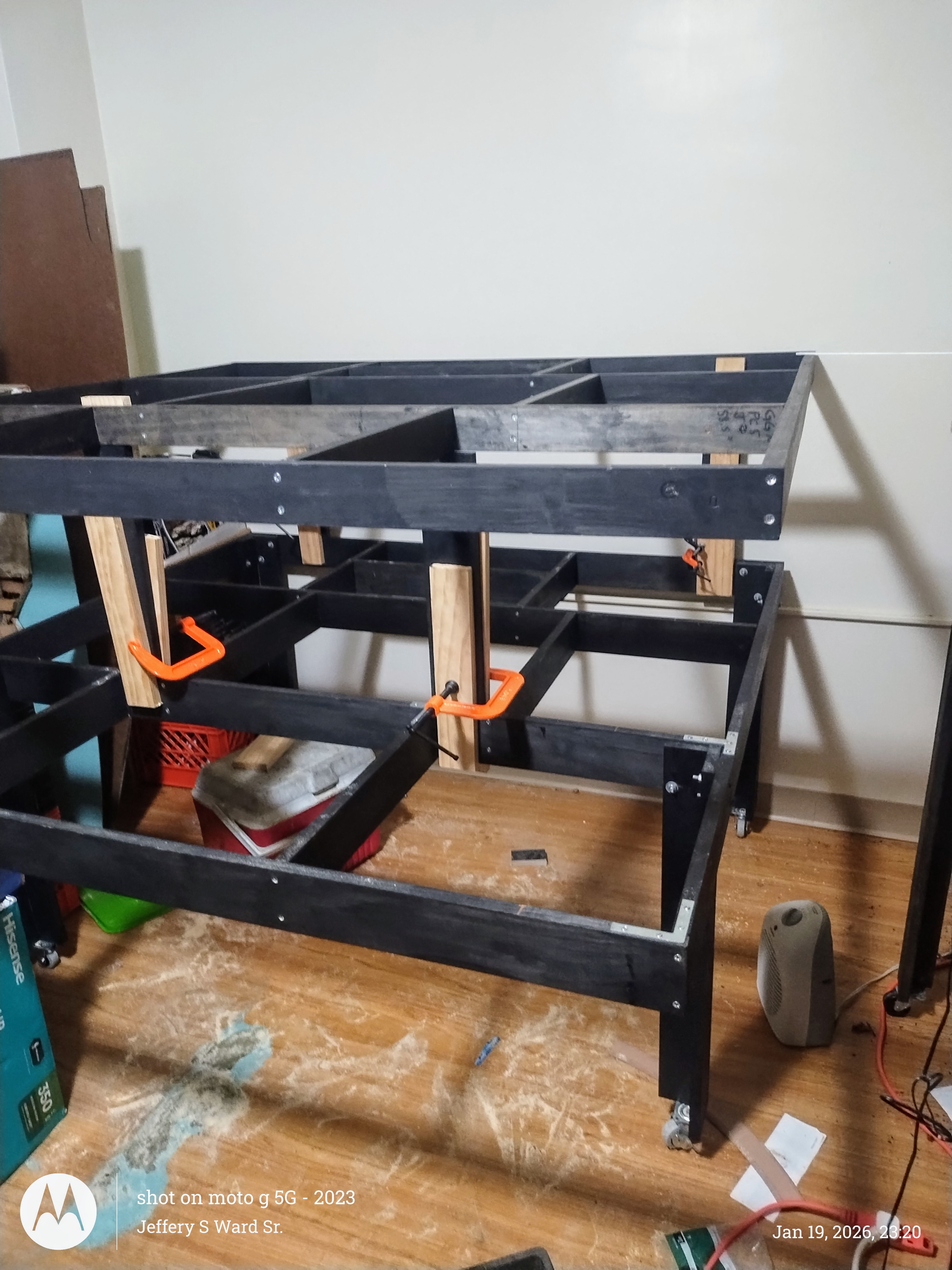

Construction has started on the Alleghany Railway, deep in the mountains along the Virginia-West Virginia border. Grading has been completed for a few miles near the Liberty Creek yard, and preparations are being made for tracklaying.
The layout will be two decks, and is built in two 5x5 sections to enable it to be moved if necessary. Here is the first completed table half, with the top deck temporarily fitted to demonstrate the concept. I decided to build the lower deck first, because I don't want to do intricate trackwork in a confined space. I will start with the lowest levels first, and build my way up the mountain to the upper deck. Fortunately, each deck will be able to function as a complete layout.
Each table half is supported by 4 legs on casters to allow minor repositioning of the layout. The L shaped design eliminates most wobble, and the tables are rock solid. The lower deck framing is 1x4 because it has to support the weight of the entire layout. The upper deck is framed with 1x3s. I bought premium lumber to reduce the possibility of warpage. Since the track itself will be laid out on dimensional pine board, each piece I add only adds to the solidity of the layout.
I have been having problems uploading images so I'll try later. There are alot more photos to post.
Edited by - jward on May 27 2026 11:09:24 AM
