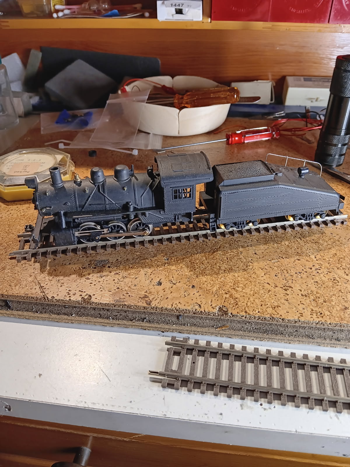

..a completely basic "Big Six", just purchased last week. It doesn't run quite as well as my Shifter, but I think it'll get there eventually.
