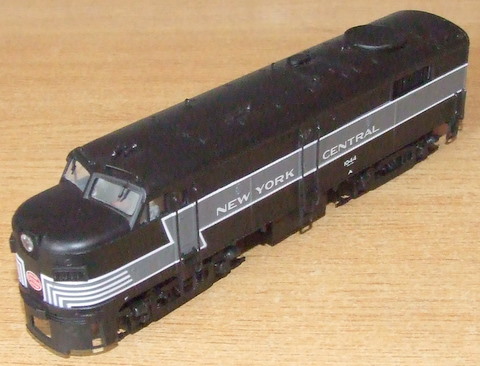

i have a fa2 new york central by lifelike proto 2000,but no instructions,can someone confirm right method of body removal before i take a guess cheers ken
MY REASON FOR ASKING IS THAT LOCO BODY DOES NOT SIT SQUARE TO CHASSIS,AS IF SOMETHING IS MISSING AT REAR MAKING LOCO LOOK LIKE ITS GOT ITS NOSE IN THE AIR

Ken, here are four screws under the fuel tank holding the shell. They are the four outboard screws that go into the frame. The other four going through the weight hold the weight/motor together.
To get the fuel tank off one has to be weery, weery careful… The tank is just snapped on but the clearance between the truck brake rigging is close and there are the air tanks and piping on the fuel tank itself to consider. Easy does it. Lightly pry with a slotted jewelers driver, the tank usually pops lose with the minimum of pressure.
Of course the front coupler has to be removed but it looks like that’s been done already.
Now, all that said, check with Gareth or someone else to make sure my memory is not defevtice….
Loopy

hi LOOPNHOOK NOT OBTREY? MY SINCERE APPOLOGIES yes right one the ball,but 2 screws are missing will have to replace front coupling missing,thats what you get when you buy cheap,many thanks ken

Hope you have the coupling boxes, They are not the same as the athern types.

Drill your own hole for the coupler. I permenantly MU'd My FA(dummy) with the P1K F-3 (bells & whistles)... made my own drawbar.
Also be aware that the FA's also have the fan-shroud mechanisms. It may interfere with part of the shell. I also had that high-nose ordeal, like it had bad springs or shocks. I will look to see if the screws are missing.
These are good runners, My MU job also consisted of putting a decoder in it from another Proto RS-18. The F-3 weight/chassi goes 90% flush with the top of the shell... not leaving any room for the speaker. So, I put the speaker assembly in the dummy FA, and wired up the pick-ups from the wheels with the pushing B-Unit, giving this pair of locomotives 16 wheel pick-up.
Screw-on draw bars makes closer coupling, make both units as an individual locomotive.

thanks for all the tips guys,taken onboard,but no i do not have the coupling box for front coupling,ken
