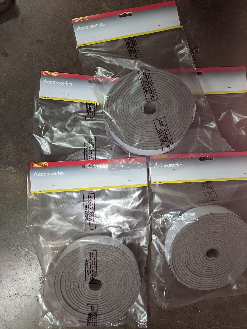

I am an expert. In what I like, only. And what I like is to run trains. Fiddling with track, in my case,
set track, that always finds a way to warp, to bend, to crinkle, to disjoin, particularly when affixed
to roadbed that is not entirely and perfectly flat as a silver dollar, and even then with heat track
has a way of working itself out of gauge. More than that, I hate, positively hate, ballast. Ballast is
an invention that model railroaders use to torture themselves. Combine the two, and it becomes
an endless chore. Moreover, when tacking the set track down, one will almost invariably incur
a gentle hump, end to end, sure to foul you at some point. Not for me. Thank you.
This week's AOW are several rolls of the finest roadbed money could buy, Hornby Foam Roadbed,
which is identical to Woodland Scenics, and just as annoying. Got to put it up on eBay, maybe
I will get a dollar for it.
My salvation has come in the form of Bachmann EZ track, a track designed for children and doofuses,
such as myself. On the rare occasion something goes off the rails, and derailments are such a thing
of the past now, it is almost always to do with the rail vehicle.
The Tyco Expander Layout books shows something that appears to be carpet, trimmed to width.
So, RP uses ballast, but no road bed. Other posters use both, some like RP but with a rustic
backwoods sort of feel. What say you about ballast and roadbed?
