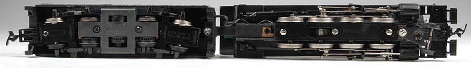

I ordered one "second-hand" Tyco 245-15 Consolidation 2-8-0 638 of the Chattanooga Railroad just because I love it. Unfortunately, the seller mention "Noisy runner / Poor Runner". So I probably have to open the tender for some mechanical works. How can I open it without destroying it? Thanks a lot for your help.

The tender should just pry apart as shown in the video. It's a mostly standard PT truck otherwise I believe. 'Noisy runner' usually means it needs oil on the armature shaft bearings in particular, among other things. Nice looking engine!

Got it ! My new and first Tyco steam loco arrived this morning in a perfect shape (for me). It runs very well as you can see in the video. I used my secret weapon to solve the "poor runner" problem.

I gently removed the tender shell. Then I used a wild method: I vaporized all the parts. Kontact 60 is just an electrical contact cleaner. Works fine !
