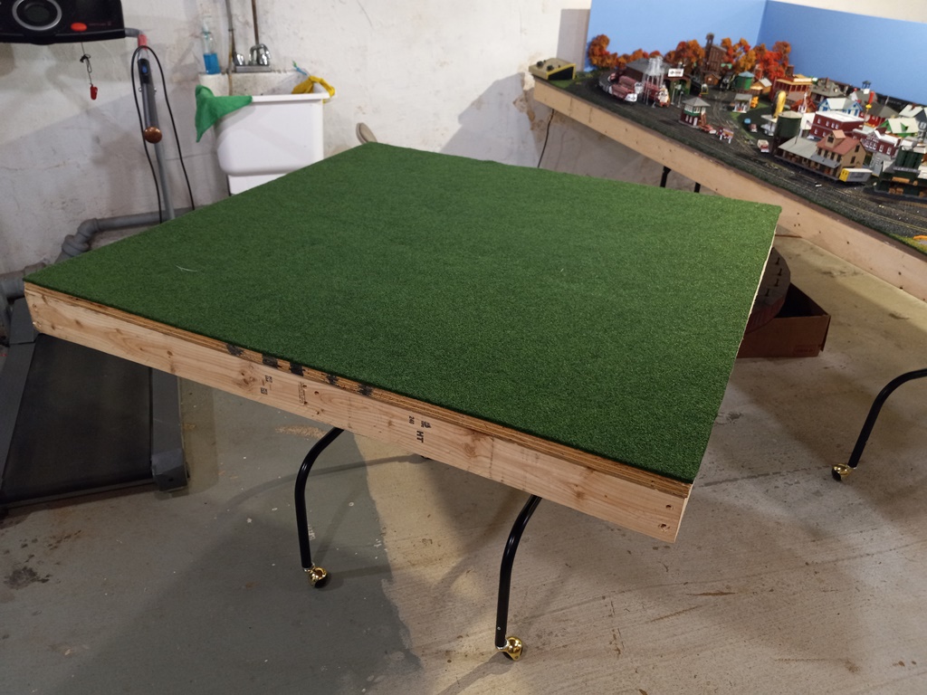

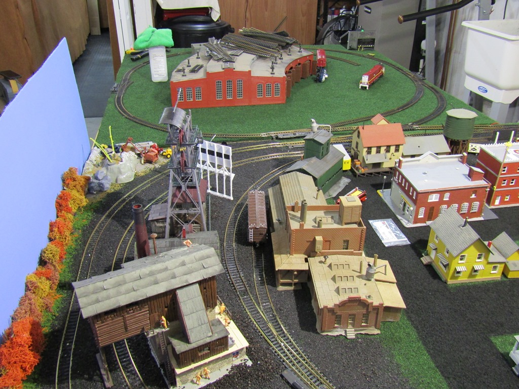

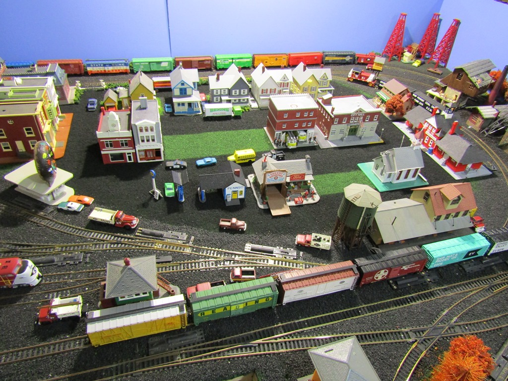

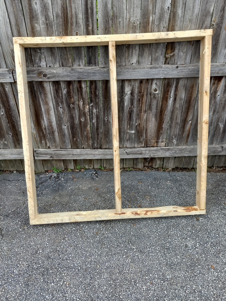

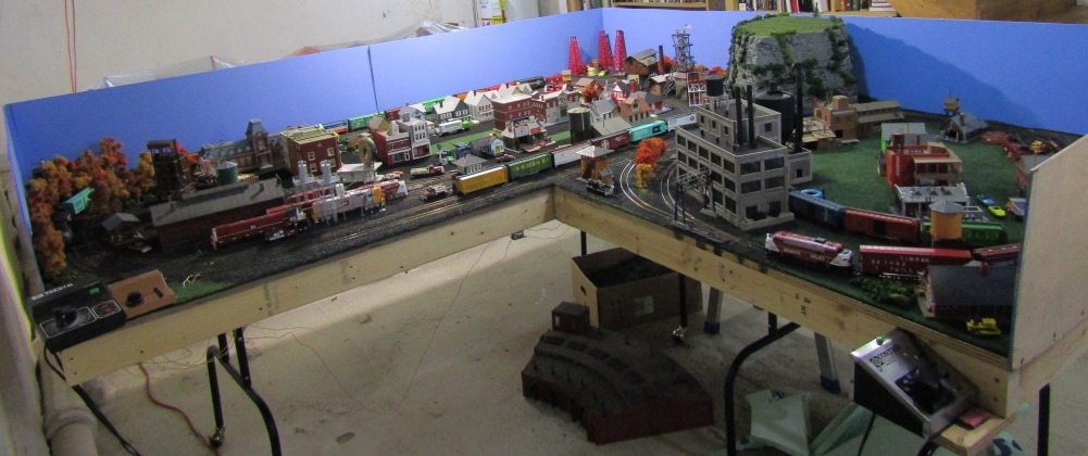

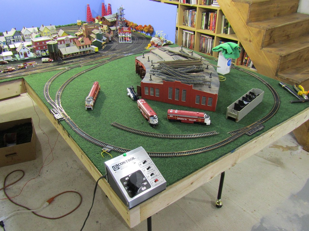

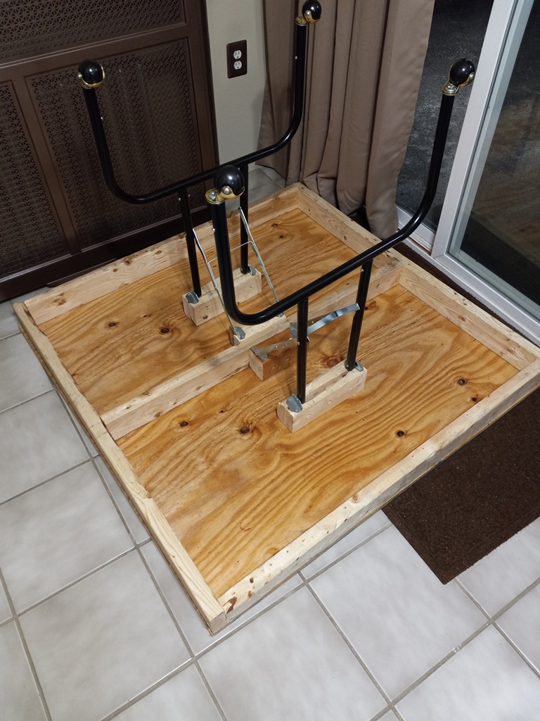

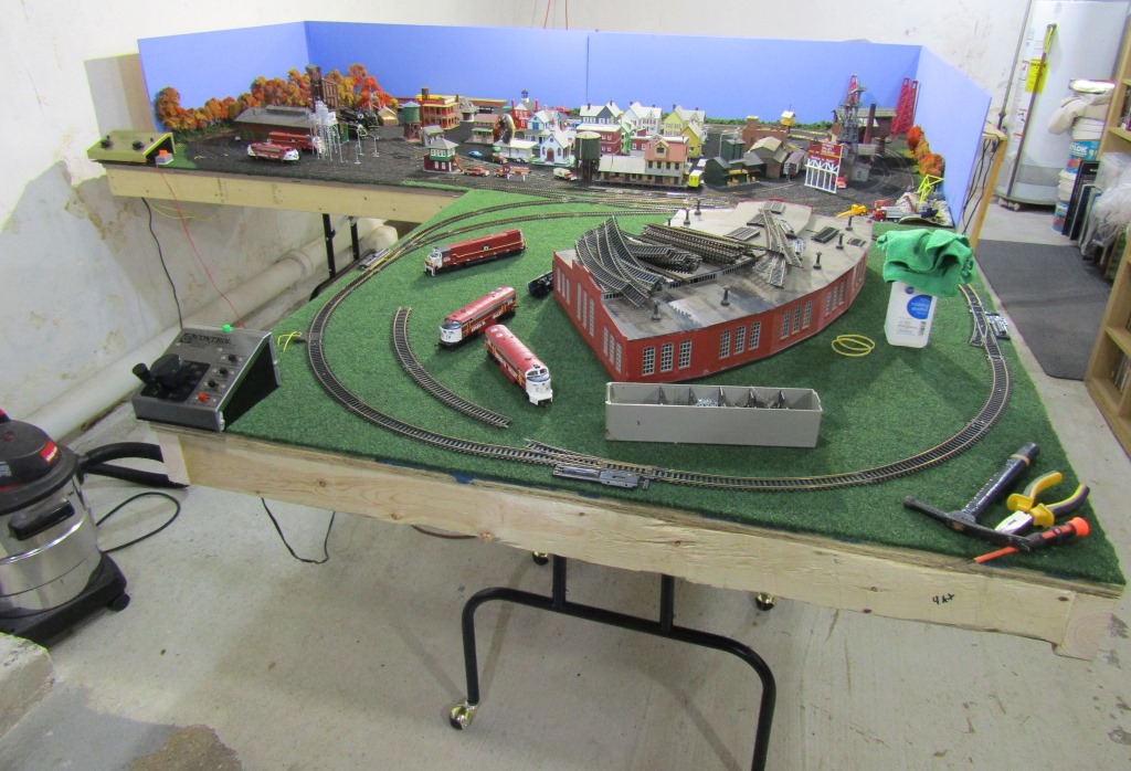

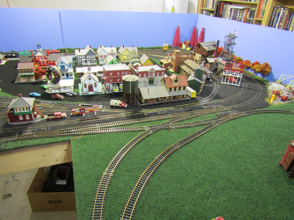

With inspiration from Chops' recent Henley expansion and larger layouts, I decided to expand my Ephrata Valley RR 4x8 layout, by adding another 4x4 section, to create a L-shaped layout! The basement is now at full capacity.

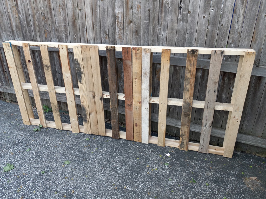

I was lucky enough to find a large skid made out of 3 2x4x8's in a dumpster, so I loaded it in my truck, brought it home, and later took it apart to salvage the 2x4's. I saved probably 15 to 20 bucks.

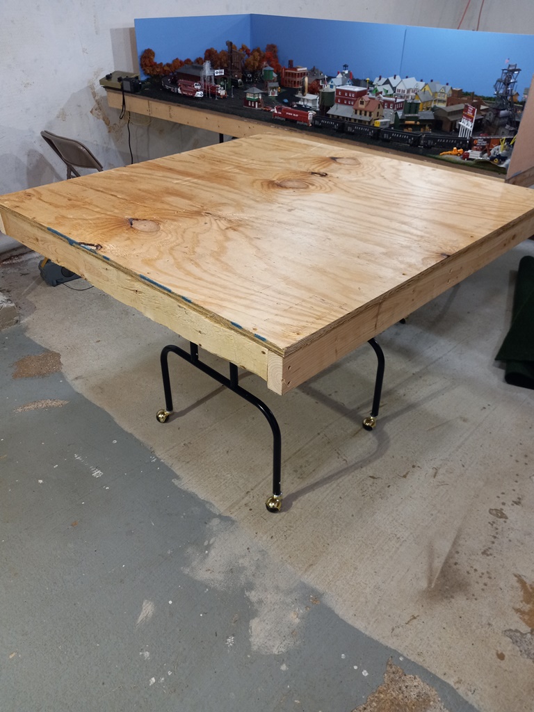

I then cut the 2x4's, assembled a frame, and attached a 4x4 cut sheet of 3/4" plywood to it. Shoutout to Mom and Dad for lending me a hand with the building process.
I only needed about 12 inches or so of 2x4 to cut pieces for the banquet table legs to attach to, so a 2x4 from the scrap barrel in the garage came in handy. The next and most tedious step was building and attaching the table legs to the underside of the table.
Perfect height, aside from being a little bowed and the uneven basement floor.
I happened to have a 4 foot wide, by about 4.5 foot long piece of green fabric left over from the 4x8 layout project, so I used it, and glued it to the tabletop.
I then spent the next 2 days working on the railroad - laying track, removing track, and wiring. I used the Tyco block switch from RETRO TYCO, and set it up so that 3 trains can run at one time (2 on the 4x8 and 1 on the 4x4, controlled by a separate powerpack) -- OR 1 train can run from the 4x8 onto the 4x4 and back again. Lastly, after testing and testing, I nailed down all track. I haven't had any major derailments related to the trackwork - surprisingly, all trains run smooth! This new setup not only gives me more room, but will make for a more interesting experience as HO-Scale train engineer, with paying close attention to the switches. I still have more trackwork to go.
 Posted - May 18 2022 :  12:49:00 AM Link directly to this reply  Show Profile  Add Chops124 to Buddylist
DIAMONDS, DUDE! Your frame work heads and tails better than anything
I've ever done, and out of the dumpster, now less! I really like that bypass
track on the inside of the feeder- I'd never have thought to do that. Very
clever use of turnouts that allow for easy in, easy out centered on that diamond. I don't think I've ever seen quite that arrangement before. Best
of it is good to hear that it isn't derailing trains.

 Posted - May 18 2022 :  11:47:40 AM Link directly to this reply  Show Profile  Add jward to Buddylist
I like the way you overbuild your benchwork, and use 3/4" plywood for the base. That's a good sturdy layout there. And the junction! I am impressed. can't wait to see the trains running through that place.

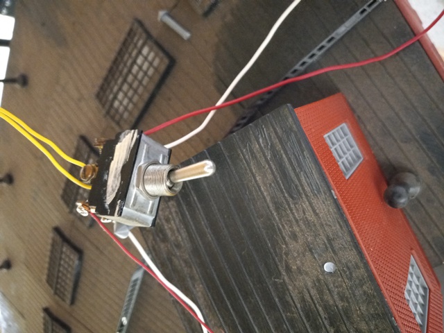

 Posted - May 24 2022 :  9:06:08 PM Link directly to this reply  Show Profile  Add RP model railroads to Buddylist
Thank You!

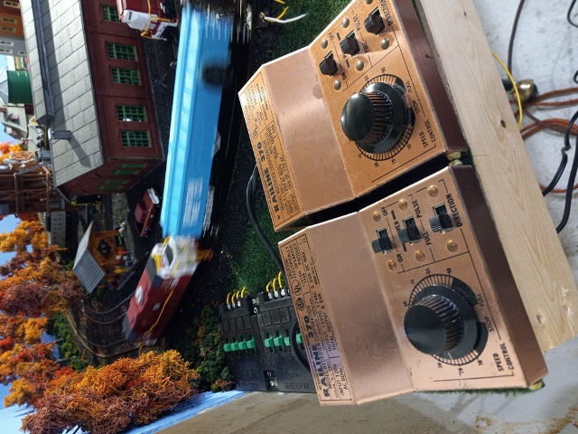

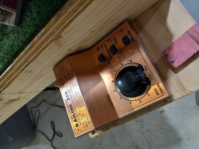

Turns out my wiring was terribly wrong. After research, I was able to wire everything correctly, thru the use of a DPDT switch. I will be putting out a YouTube video in the near future documenting my wiring process, but for now, enjoy this video of 3 EV trains running on the L at the same time!

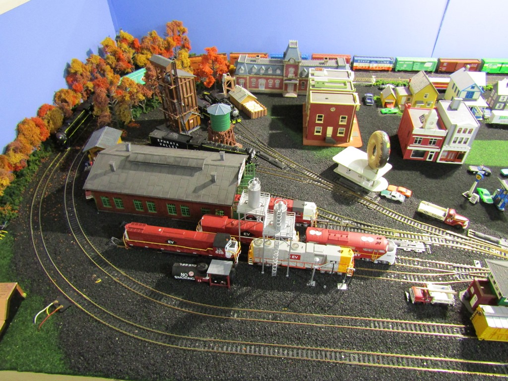

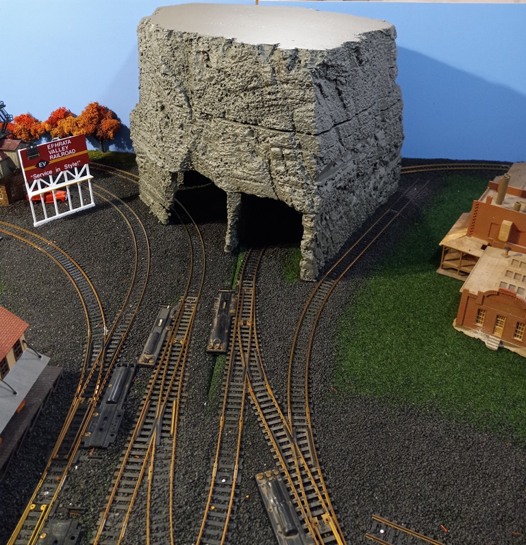

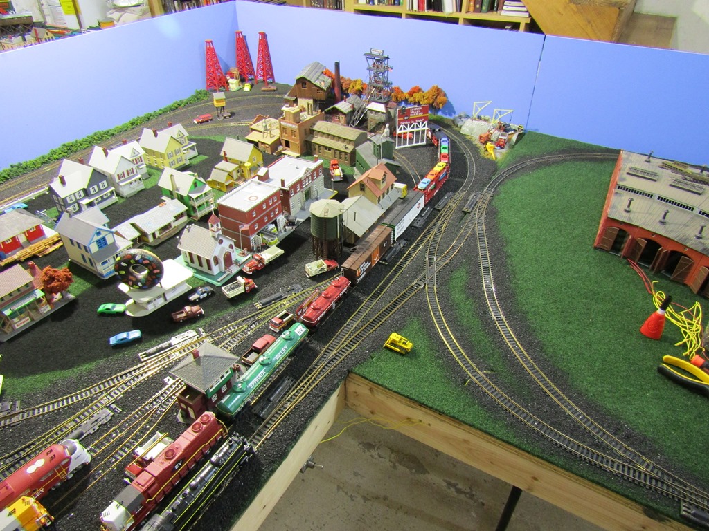

 Posted - June 09 2022 :  11:06:14 PM Link directly to this reply  Show Profile  Add RP model railroads to Buddylist
So long to the roundhouse idea...because the 4x4 part of the L-shaped Ephrata Valley Railroad will be industrial, featuring 3 sidings for 3 different industries (Spartan Tire Manufacturing being one, Putnick Salvage yard being another, with a 3rd to be determined.) There will eventually be a road that crosses the 2 tracks and enters into the industrial area (center of layout,) where there will be a water company and electric power station, for the town of Ephrata.
 Posted - June 10 2022 :  01:22:21 AM Link directly to this reply  Show Profile  Add Chops124 to Buddylist
I think this is better- visually more interesting and the scrap yard is very
interesting in an of itself. You already did a successful roundhouse, so
it's always good to try something.

What did you do that required a DpDT switch? Looking at your plan, to seems like a few Atlas Selectors should be able to take care of everything you needed to do. Is there something I'm not seeing?

Well, what I wanted to do is wire up the layouts so that I could either run a train from the 4x8 to the 4x4 and back again, or run 2 separate trains at once, using different powerpacks. Wiring is something I admit, I'm not the greatest at, but the DPDT seemed to be the simplest solution.
jward
 Posted - June 14 2022 :  07:16:38 AM Link directly to this reply  Show Profile  Add jward to Buddylist
I guess i've been wiring layouts for so long that it all seems simple to me and I often forget that it is a mystery to many.
The DPDT switch does work, but so would the Atlas Selectors. In fact, they are designed to do just what you are trying to accomplish. which is two cab operation on a set of tracks.
WIring a layout to do this is just a series of simple, basic circuits repeated as many times as necessary. Understanding this takes most of the mystery out of it. You are fortunate in that your layout doesn't need the most problematic of these basic circuits, reverse loop wiring.
I'd like to extend the invitation to anybody on the forum who needs wiring help to submit their track plan to me and I;ll see if I can come up with a simple, easy to follow wiring scheme that would allow two train operation on any track.

 Posted - June 14 2022 :  10:39:44 PM Link directly to this reply  Show Profile  Add RP model railroads to Buddylist

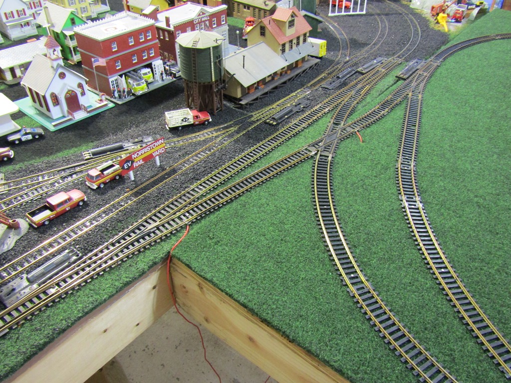

Well, I used 2 Atlas Selectors to wire up my engine yard - Norristown Yard - on the 4x8, and it was actually quite simple to wire up.
But because the track on the 4x8 is connected to the 4x4 in 2 places (due to the X-track) the use of Atlas selectors seemed more confusing to me. The DPDT switch seems to be easier, and I will wire it up as shaggy suggested.

 Posted - June 15 2022 :  12:34:26 AM Link directly to this reply  Show Profile  Add jward to Buddylist
You are using Atlas track it looks like and all switches and crossings have insulated frogs. That greatly simplifies wiring. I know it looks confusing, but the Atlas selectors would handle this just like they would in your engine terminal. The Atlas system is a versatile, well thought out system of components that have stood the test of time. They are pretty simple to wire as you have found. The most confusing part is figuring out where to put the insulators in the track. I've used them on most of my layouts for over 40 years. That includes the current one with DCC.

 Posted - June 15 2022 :  10:36:57 PM Link directly to this reply  Show Profile  Add RP model railroads to Buddylist
Originally posted by jward-June 15 2022: 12:34:26 AM
Yeah, I'm quite satisfied with how well the selectors work for controlling locomotives entering and exiting the engine yard.

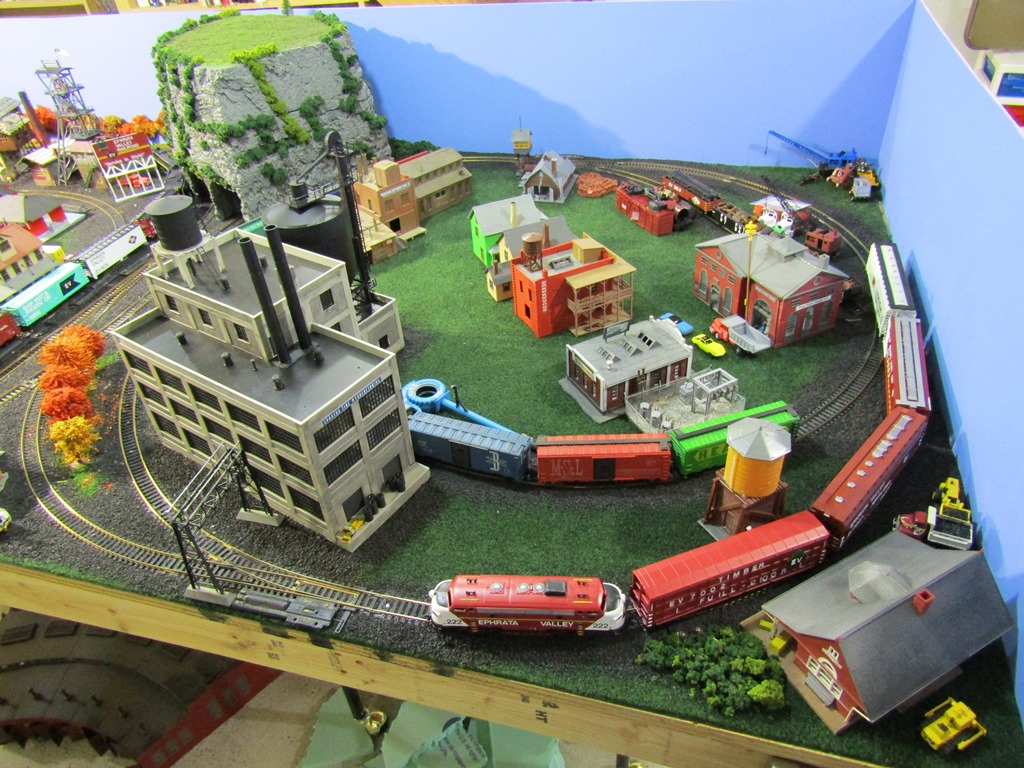

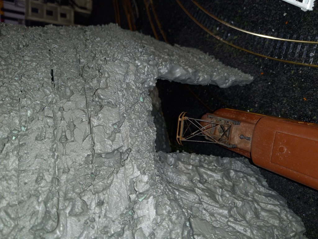

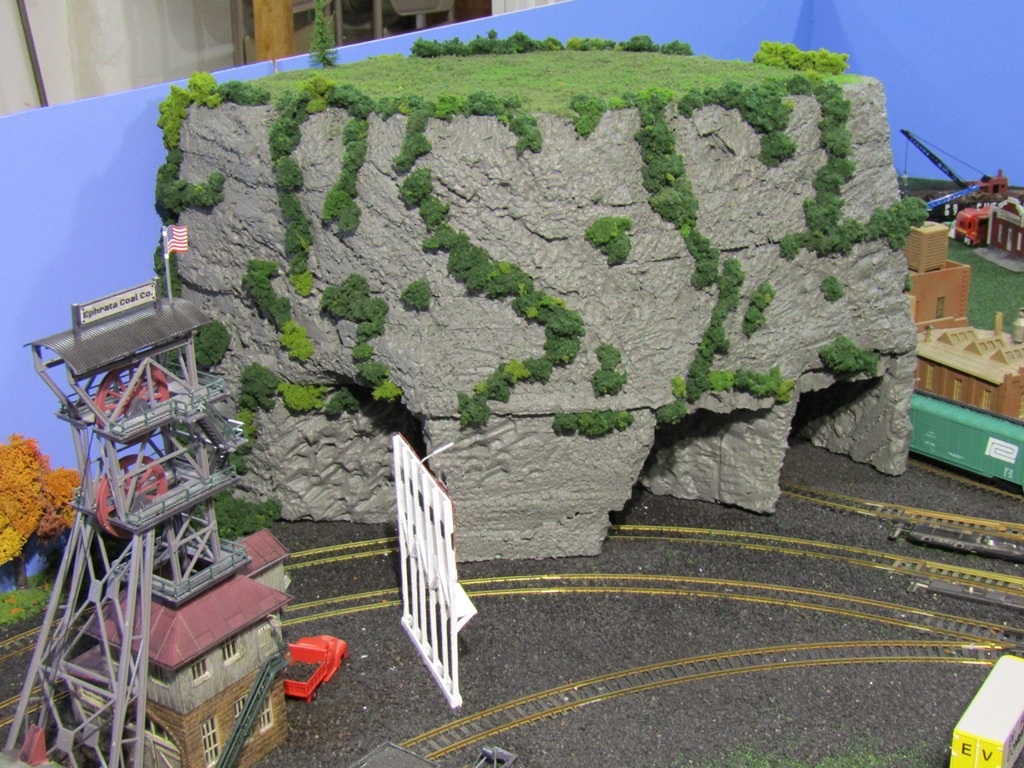

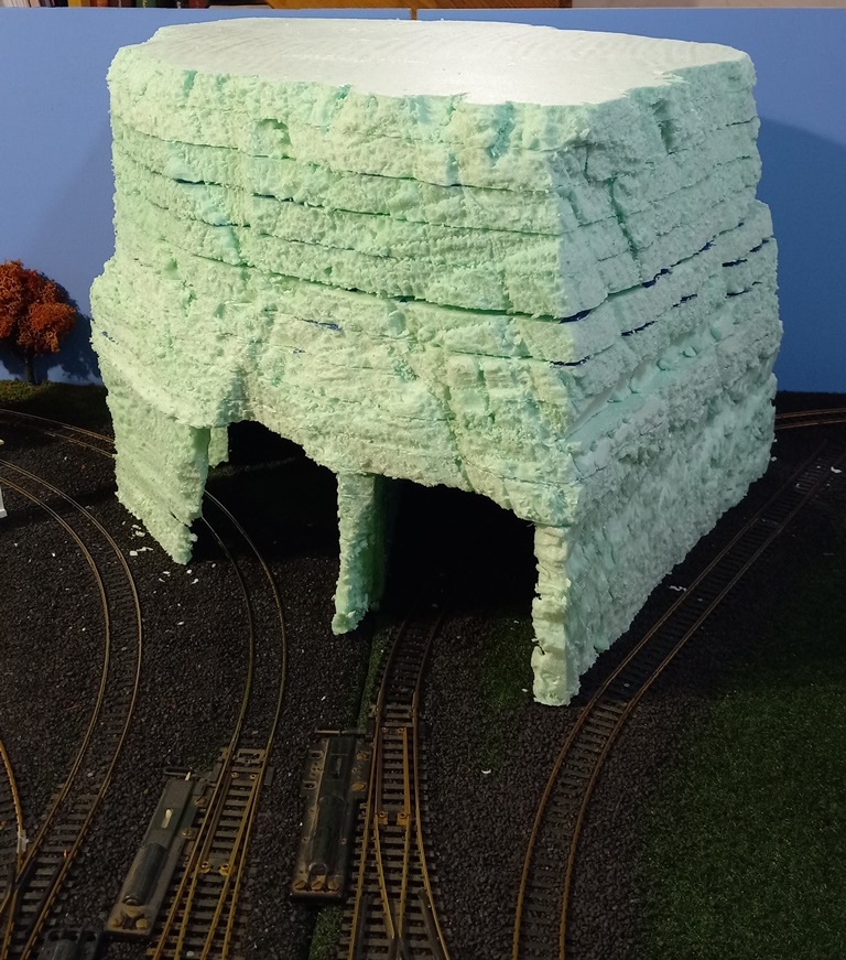

 Posted - July 06 2022 :  9:23:33 PM Link directly to this reply  Show Profile  Add RP model railroads to Buddylist

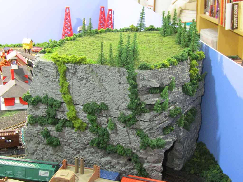

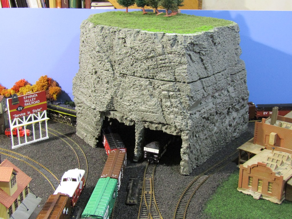

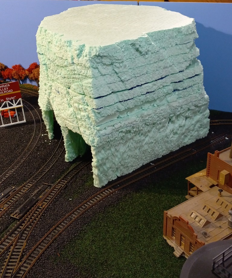

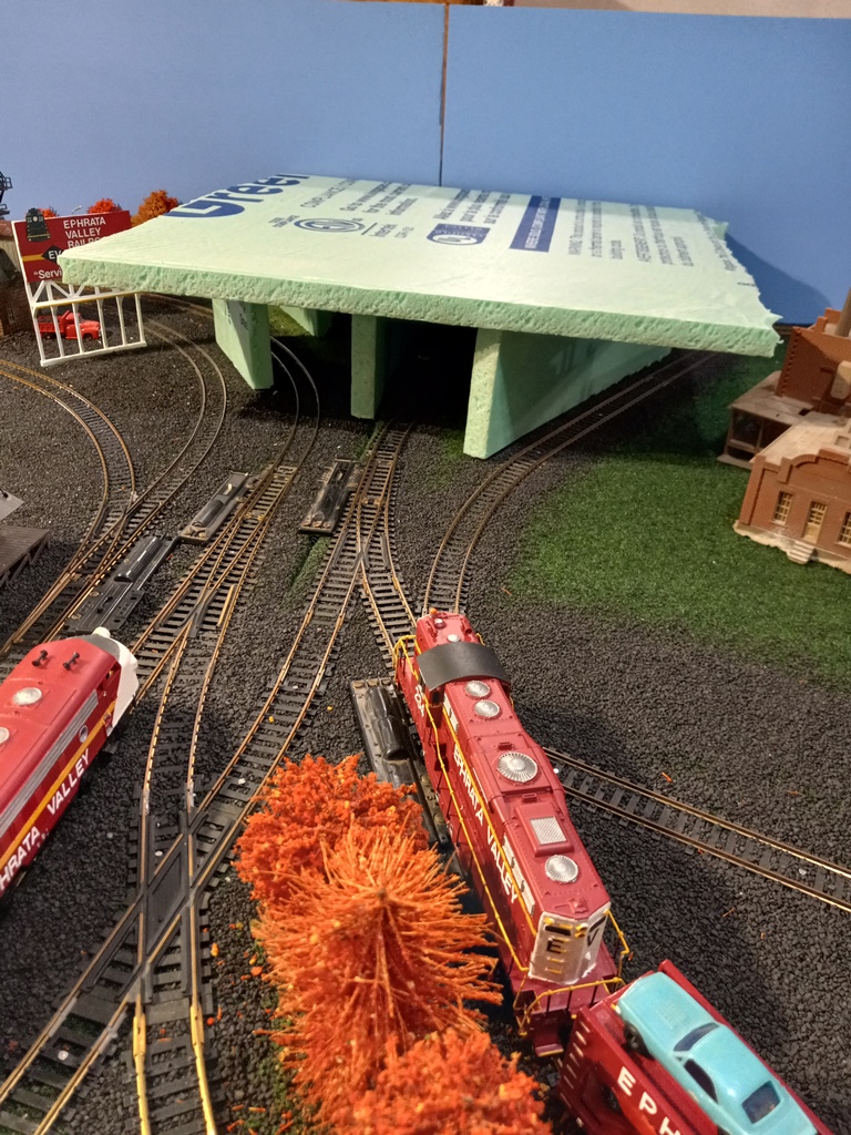

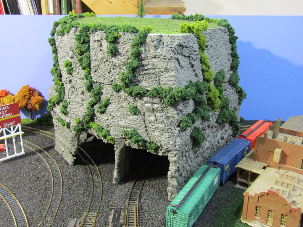

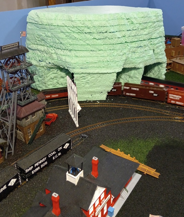

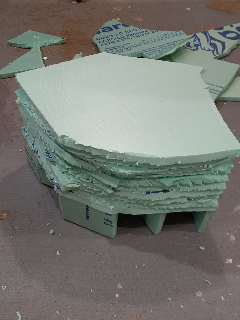

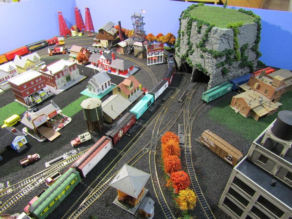

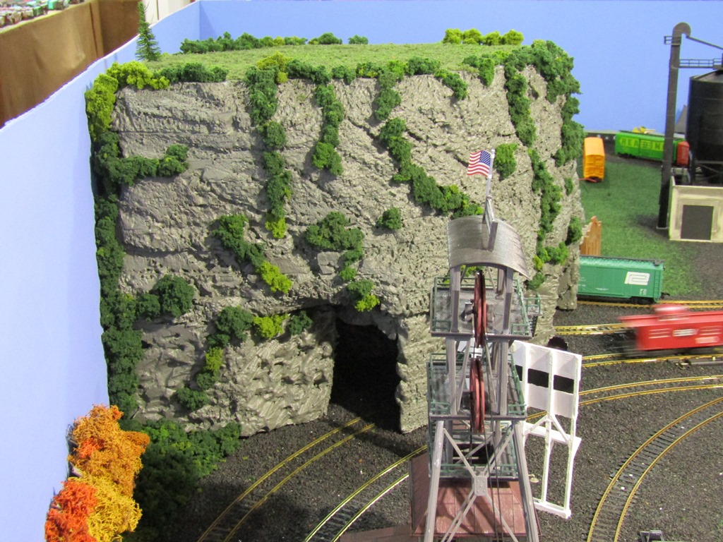

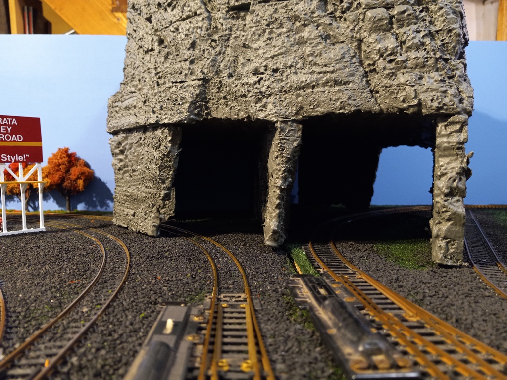

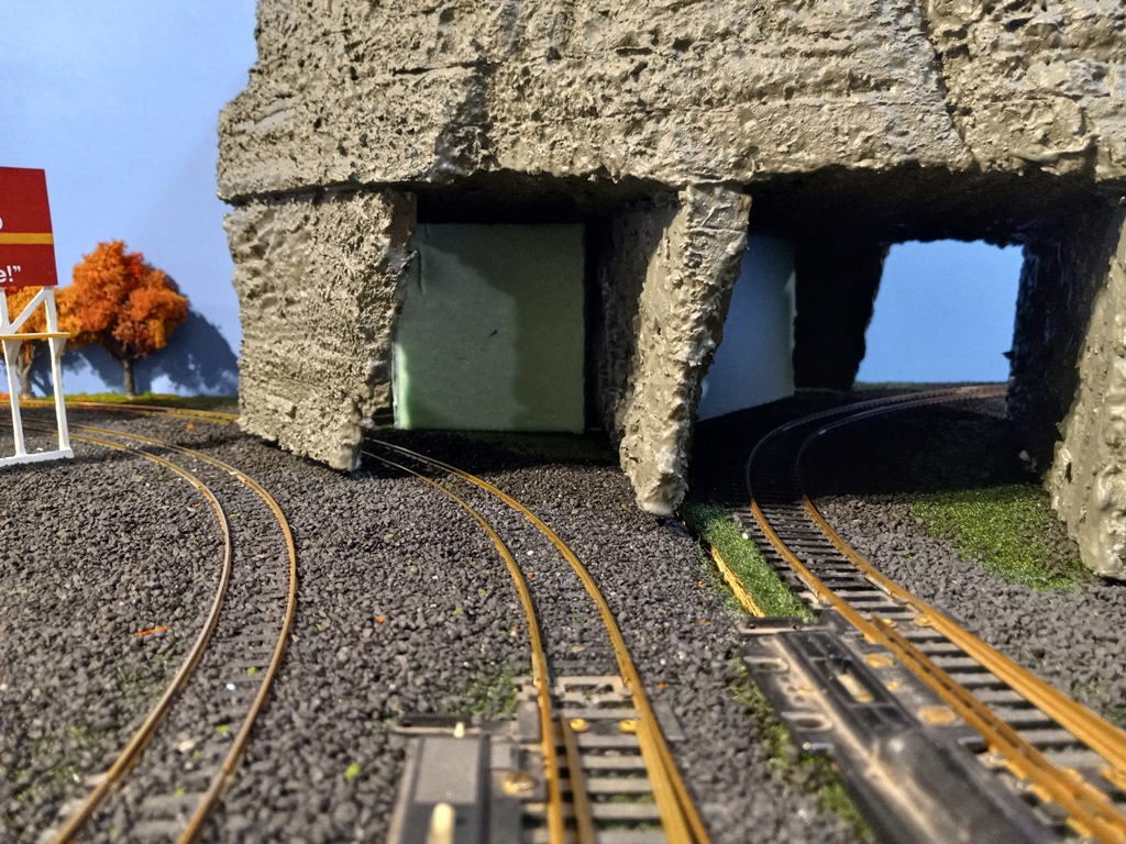

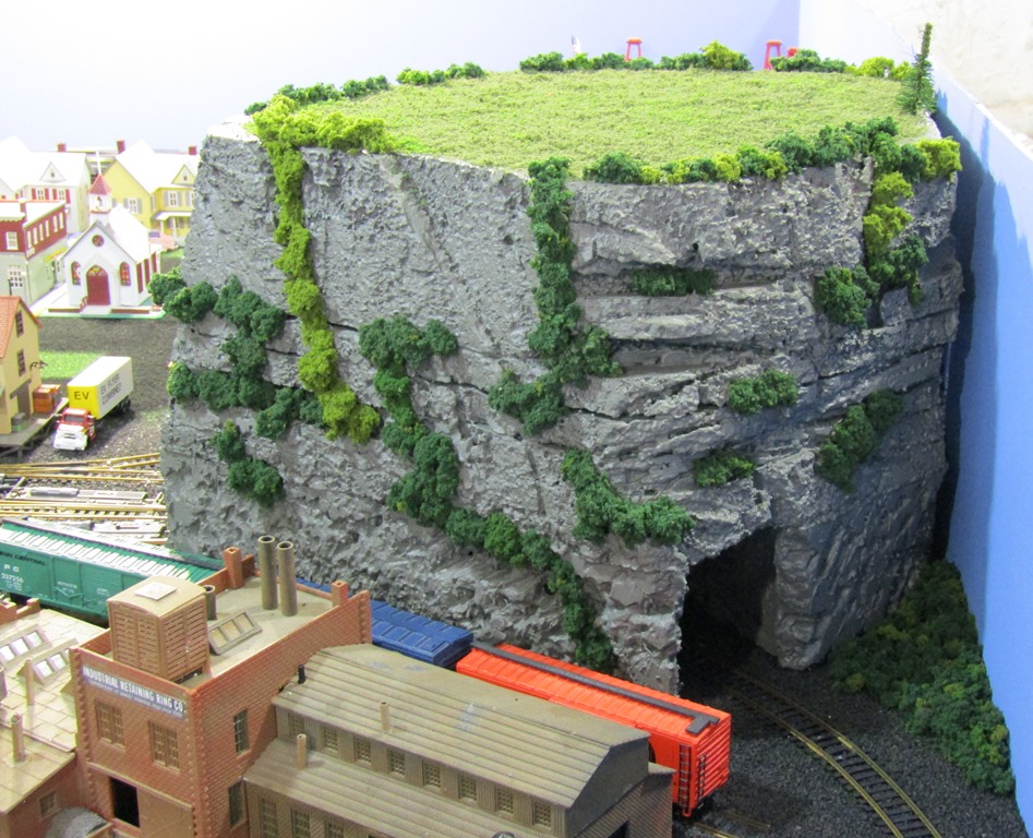

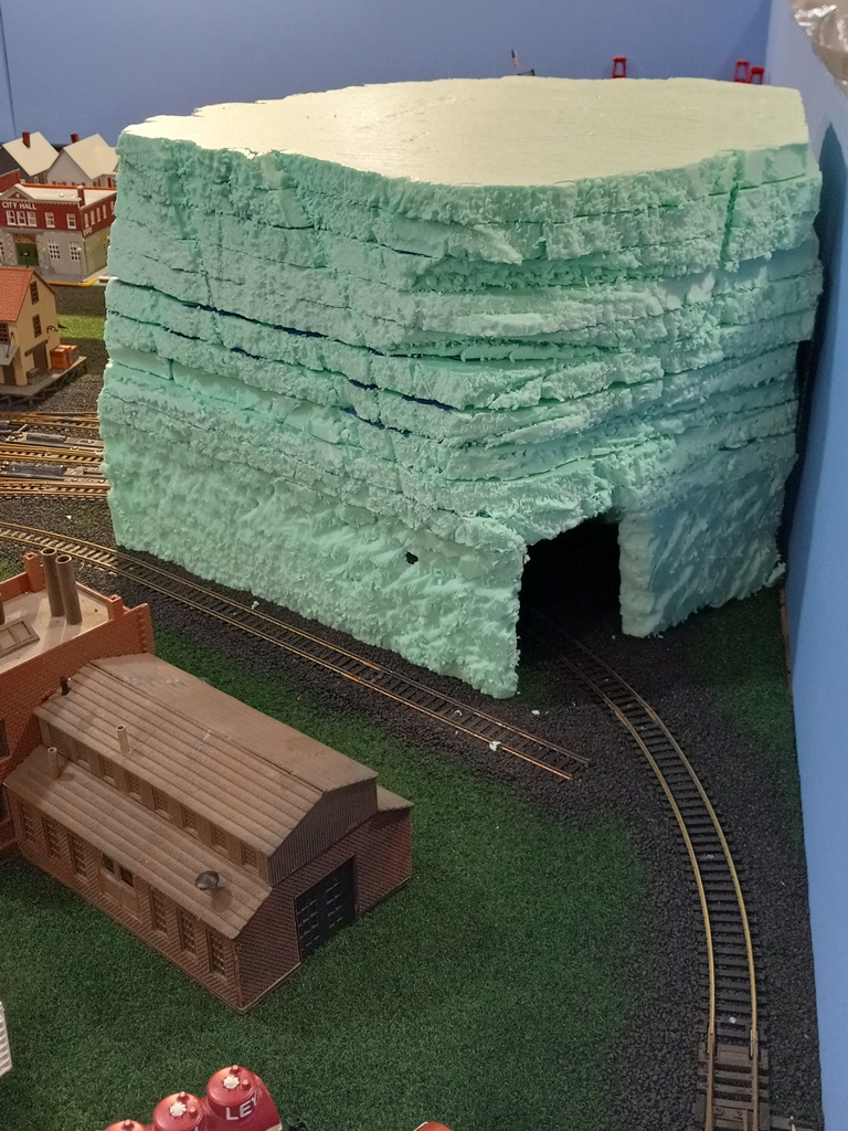

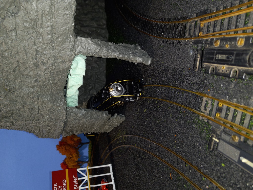

My Ephrata Valley RR layout now has a tunnel! I spent some time on July 4th creating a mountain tunnel out of 1 sheet of 3/4inch foam board - it took me 6+ hours to cut, glue, carve, and paint the mountain/tunnels. Later I realized the inside of the tunnels were too hollow, so I cut, carved, and painted 2 smaller pieces of foam to fill the gaps, and the results speak for themselves. I still have some scenery work to do, but "Mount Flat Top" looks awesome on the layout and even a Rivarossi GG1 with pantagraphs raised can fit thru it!
Now, I do realize that this mountain does not greatly resemble the Appalachian or Allegheny mountains seen here in PA, in fact it looks more like something that would be seen in the Rocky Mountains. But, considering the EV is fictitious, Mount Flat Top fits right in. In truth, I was inspired by others layouts with rough/rocky mountain scenery and tunnels, and found carving the foam to be quite fun.
Edited by - RP model railroads on July 06 2022 9:24:36 PM
 Posted - July 06 2022 :  10:31:25 PM Link directly to this reply  Show Profile  Add wks to Buddylist
Interesting concept Robert. Thanks for the update.
 Country: USA  ~  Posts: 8053  ~  Member Since: February 12 2014  ~  Last Visit: September 24 2026 Alert Moderator  Go To Top Of Page
C P L
100
 Posted - July 07 2022 :  01:41:20 AM Link directly to this reply  Show Profile  Add C P L to Buddylist
Awesome work. I steal immediately your idea !
 Country: France  ~  Posts: 70  ~  Member Since: June 14 2022  ~  Last Visit: July 08 2022 Alert Moderator  Go To Top Of Page

 Posted - July 07 2022 :  2:15:20 PM Link directly to this reply  Show Profile  Add jward to Buddylist
There exists a tunnel quite simi,ar to this not too far from Ephrata.
https://bridgehunter.com/pa/lancaster/point-rock-tunnel/

 Posted - July 07 2022 :  8:59:32 PM Link directly to this reply  Show Profile  Add RP model railroads to Buddylist
Thank You, all
Jward - Wow! Thanks! I had no clue that even existed, but Mount Flat Top does greatly resemble it. There truly is a prototype for everything.

 Posted - July 09 2022 :  11:39:50 PM Link directly to this reply  Show Profile  Add Redwoods to Buddylist
My Ephrata Valley RR layout now has a tunnel! ...
Originally posted by RP model railroads - July 06 2022 :  9:23:33 PM
The tunnels and mountain look great! I like how they turned out.

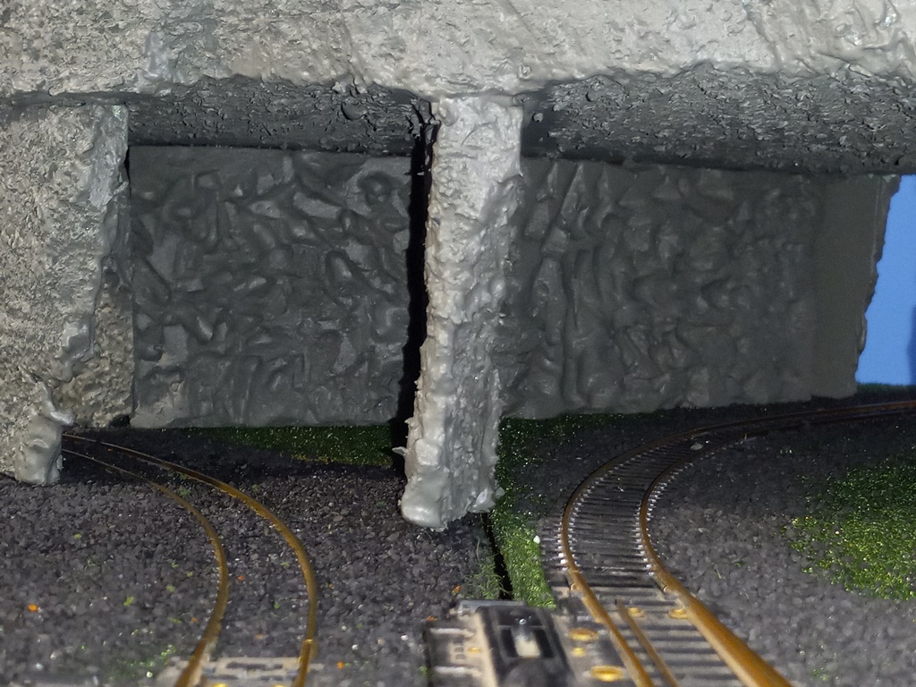

An improvement: I realized the tunnel openings were carved a bit too large (even for a GG1!) so I measured how much lower I could make the openings, and then cut, carved, and painted small pieces of foam to fit as best as possible.
After that, Mount Flat Top got a scenic transformation - I glued different shades of green clump foliage to the sides of the mountain to resemble foliage growing between/out of the rocks. I also glued some green coarse turf foliage to the top, to resemble grass/greenery growth. I'm satisfied with the rocky sides of Mount Flat Top, but the top may get more scenery in the future.
I also cut and screwed a small piece of 3/4 inch plywood to the underside of the table, so that I could place the powerpack on the "shelf" in order to use the corner for the 4th and final station on the layout.

 Posted - July 11 2022 :  07:59:21 AM Link directly to this reply  Show Profile  Add scsshaggy to Buddylist
The vegetation takes it to the next level. Lifeless mountains are rare, anywhere and probably non-existent in Pennsylvania.
 Posted - July 11 2022 :  6:49:19 PM Link directly to this reply  Show Profile  Add Chops124 to Buddylist
Originally posted by scsshaggy - July 11 2022 :  07:59:21 AM
You have not been to El Paso. The scorching sun burns off all but the hardiest scragglebush. Nevada is worse.
Camelback Mountains in Phoenix completely denuded.
What yer doing there RP is terrific! Looks really Old School! Lovin' it!!!
The three red derricks in the corner look amazing, too.
Edited by - Chops124 on July 11 2022 11:32:58 PM
 Posted - July 11 2022 :  9:45:48 PM Link directly to this reply  Show Profile  Add RP model railroads to Buddylist
Thanks guys! I wanted to make sure foliage on the sides of the mountain would look realistic, but not where it would cover the rocky face of Mount Flat Top, and I think I accomplished that.
What I didn't realize is that I unintentionally spelled a word "East" and a number "2" on the one side of the mountain....this is crazy.

Here's a video compilation of photos of Mount Flat Top, as well as a few short clips of EV trains running thru and around it.
Fir trees are sprouting

 Posted - July 20 2022 :  01:31:00 AM Link directly to this reply  Show Profile  Add Longvallon RR to Buddylist
Wonderful ! Thanks for posting.

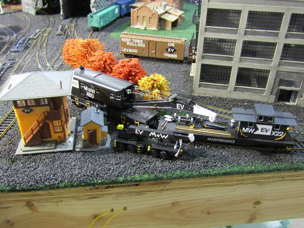

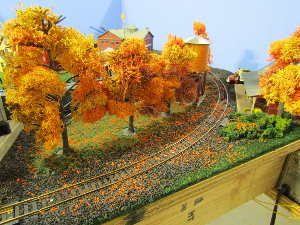

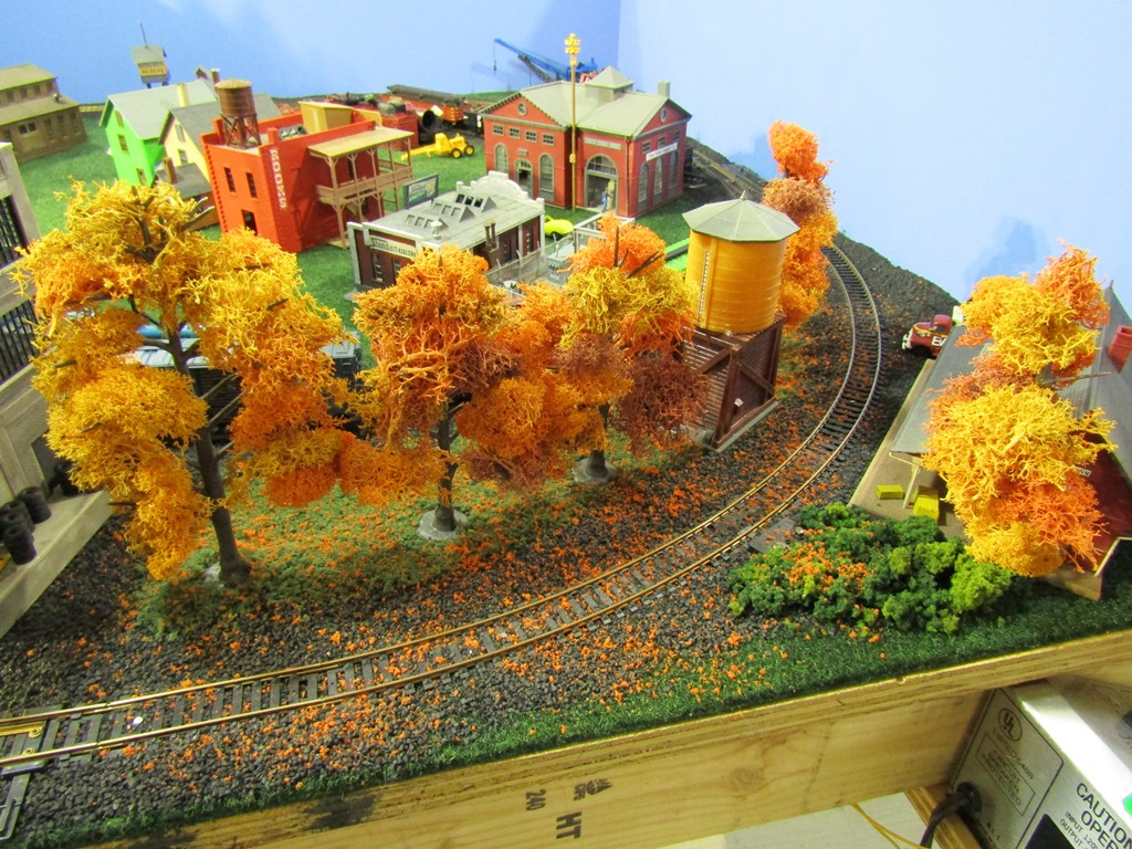

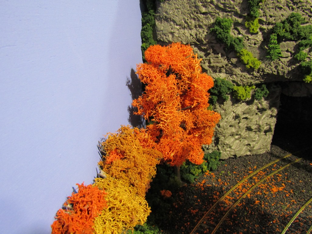

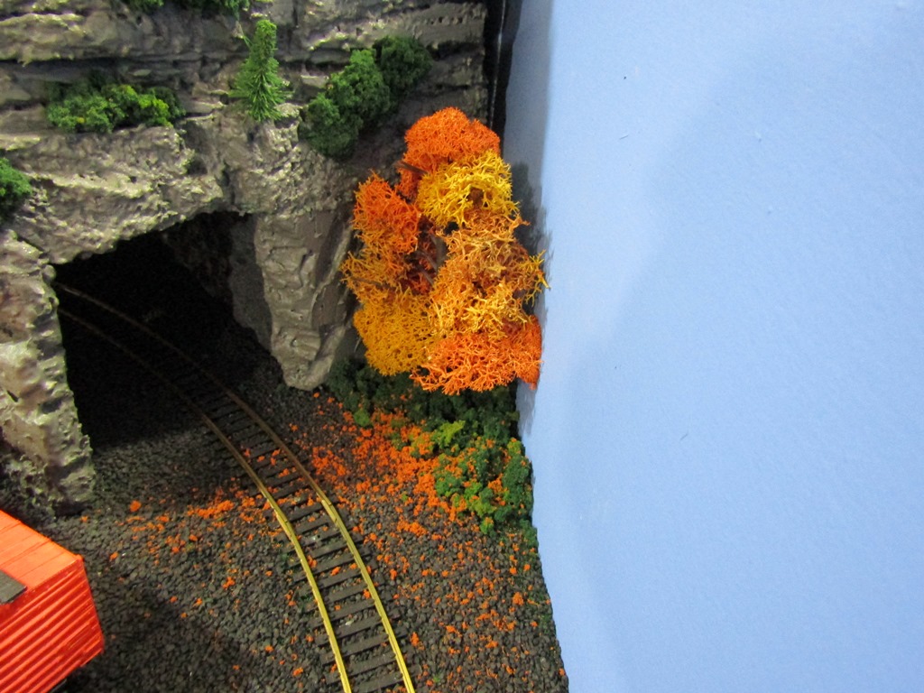

 Posted - July 26 2022 :  10:17:37 PM Link directly to this reply  Show Profile  Add RP model railroads to Buddylist
I built more autumn trees out of Woodland Scenics tree armatures and lichen, to match the others that were a big part of the scenery on the old 4x4 layout and now still make a great scene on the new layout. I placed 2 outside openings to the Mount Flat Top tunnels, and sprinkled some orange coarse turf on the ground.
I added a bunch of trees to this area, transforming the scene into a crisp fall setting right beside the new "Skippack Station" and water tower.
The perfect place to store/display an EV wreck crane when a train is not running between both layouts.
 Posted - July 26 2022 :  10:44:27 PM Link directly to this reply  Show Profile  Add scsshaggy to Buddylist
Those trees help a lot, both in blending the mountain into its surroundings and in making the line less stark between the scenery and the backdrop.

Lots of progress has been made on my Ephrata Valley Railroad layout recently, aside from the latest additions Aaron and I have been working on. For starters, I finally wired up the DPDT switch according to Shaggy's suggestion, which was an utter success. Now both the "mainline" 4x8 powerpack and 4x4 powerpack are electrically independent of one another, and I can switch between either pack.
Wires have been neatly tucked under the layout

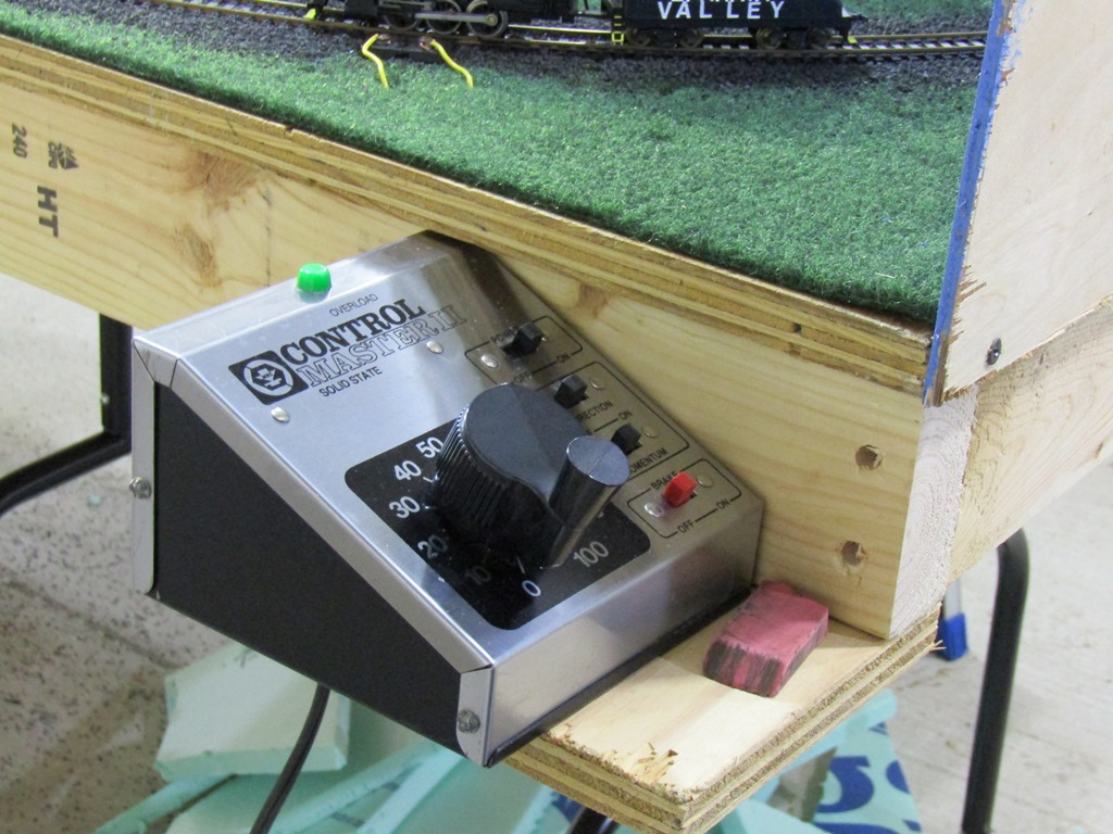

Also, my MRC Tech 2 powerpack kept having issues, so I decided to switch to all older MRC RailLine 370 powerpacks. On the OG 4x4 layout, I had 2 RailLine 370 powerpacks for at least 2 years plus, with no issues, until the one finally gave up the ghost (keep in mind these powerpacks are easily 40+ years old.) The other one, however, is still working, and has been powering the inner line on the 4x8 section of the EVRR for a while now.
