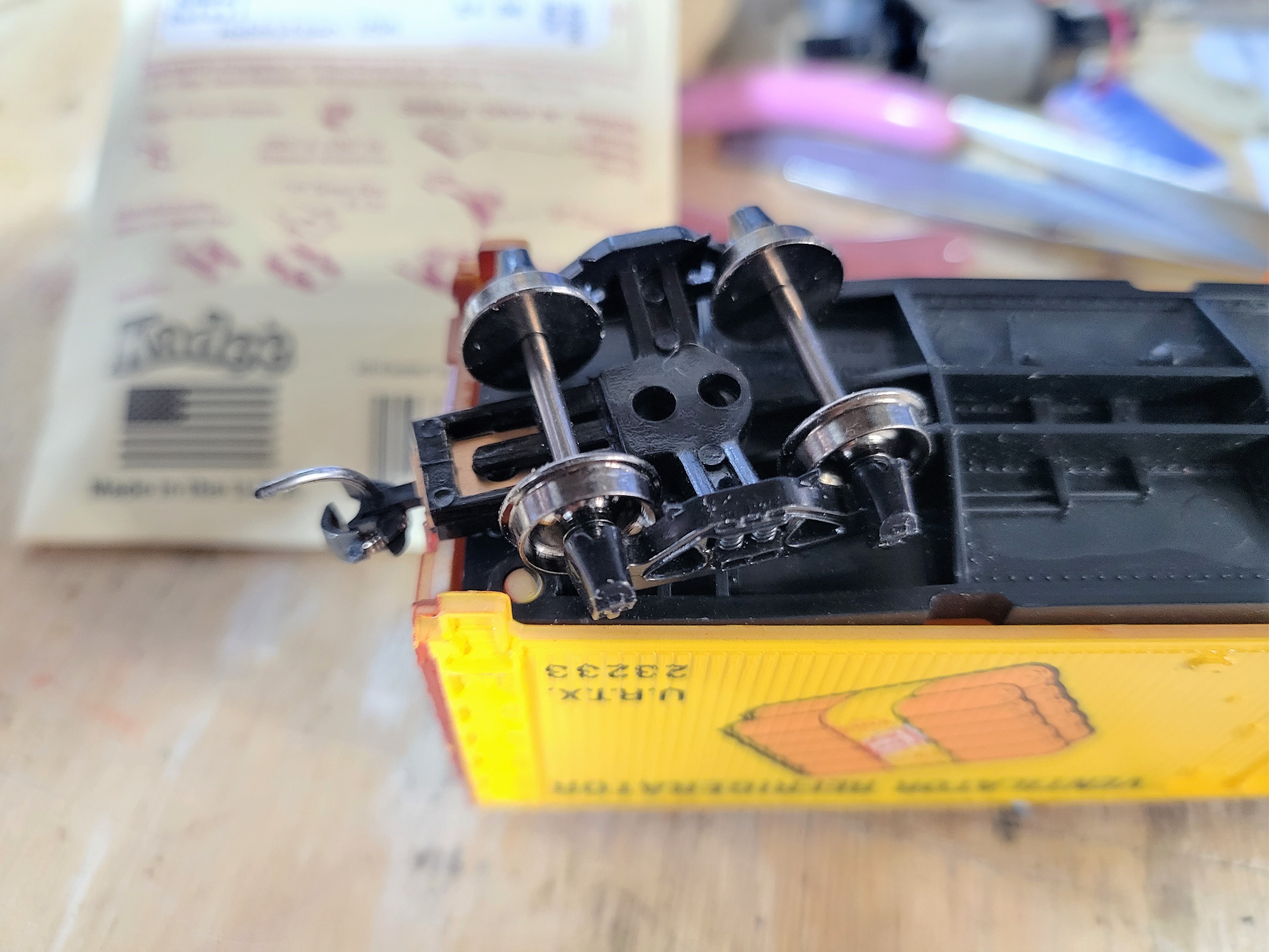

Take a short shank whisker Kadee coupler, glue the little bushing in place with super glue. On the truck, remove the tiny little tabs at the end of the Talco mount. When glue is dry lightly file the opening and pop in over the coupler tab in the truck. Done.
The Tyco "keeper", a Kadee with bushing superglued in and rat tail file to widen the opening in the bushing.
I gave up using the keeper- that's just a lot of fiddling to keep that from flying away from the work bench.
The top view
In general you need to use an underset shank to get the correct height.
By rule, when I can body mount the Kadee I do that. On triple tankers there is nowhere to do that so this has been the default.

Hello Old Bandit. I just finished doing a car last night and Tyco needs number 27 medium underset Kadee's for the talgo trucks.
