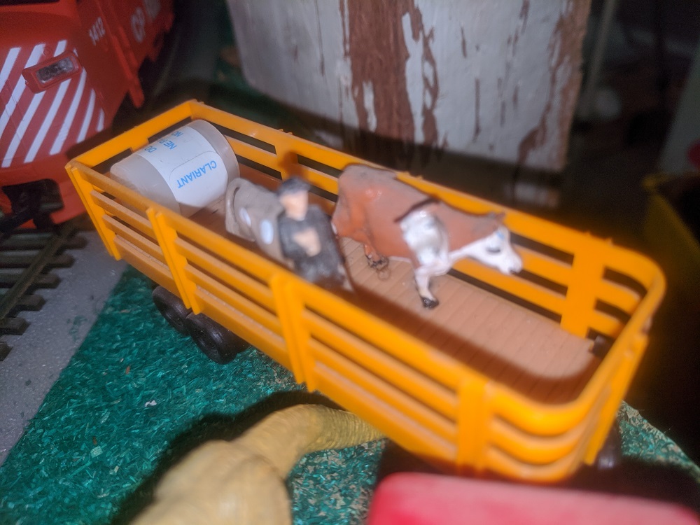

Got a Minotaur and double headed cows who were grazing too close to the Jade Fog Plant.

Love the horse trailer Chops! The yellow trailers come with the horse depot and the orange come with the cow depot! Not that matters any! Happy New Year!!
