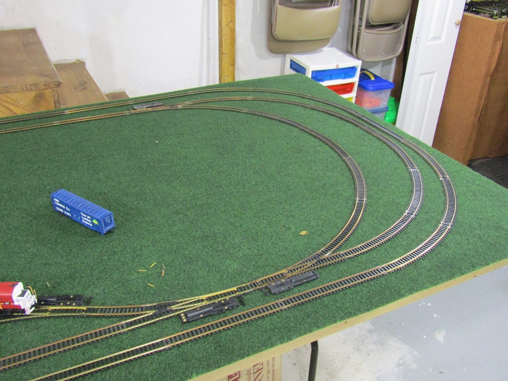

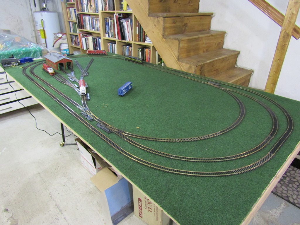

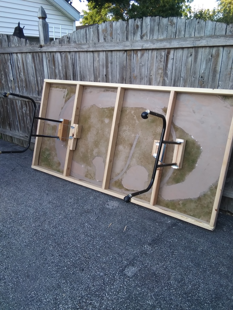

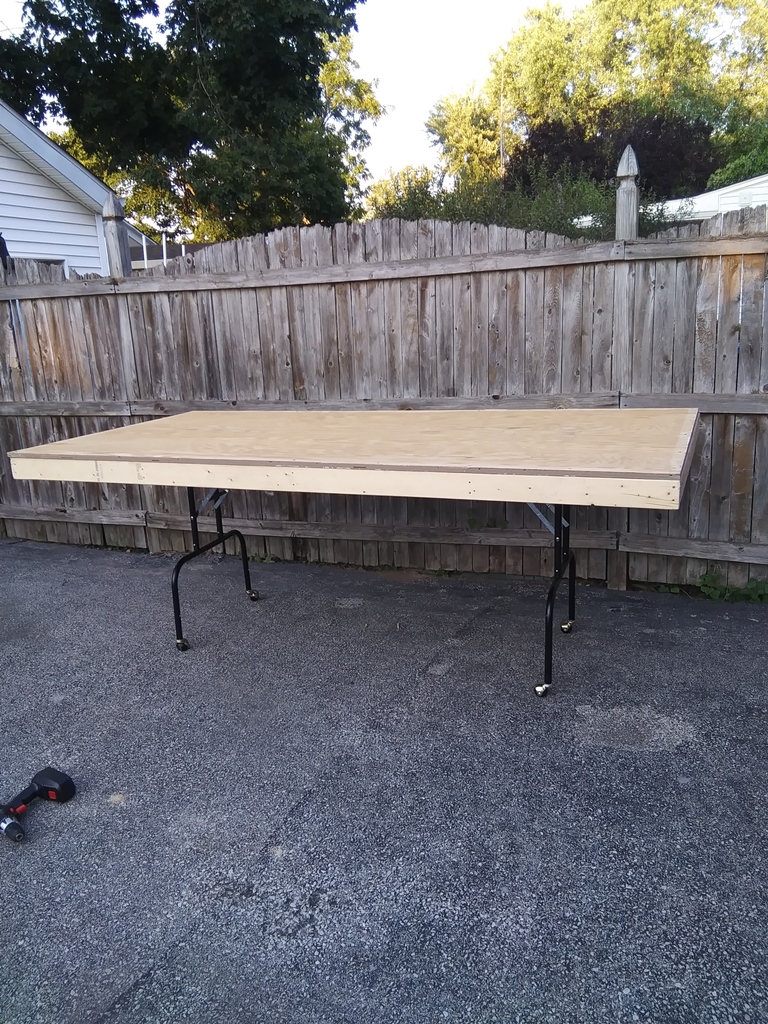

Many of you will recall the free 4'x8' layout I picked up a long time ago.....
Long story short, I pondered what to do with the layout, and developed a track plan, for a bi-level HO fictional layout, but never made any progress. The plywood sheet on top was badly warped, due to having no cross support under the tabletop. So, I built a "benchwork" frame out of 2x4's, flipped the original 4x8 plywood sheet over on its unpainted side, and screwed it down to the frame, preventing any major future bowing. Then, I installed new "banquet" folding table legs while reusing the original caster wheels (bought 1 new one), adding three extra inches to the height of the table through the use of fabricated 2x4 pieces for the table leg brackets to attach to the underside of the tabletop. The final result is a much sturdier, heavier, and non-bowed 4x8 table! The only additional costs, beside hard work, was the $40 spent on the new table legs and caster wheel - all screws, 2x4s, and the original 4x8 sheet of plywood were already owned.

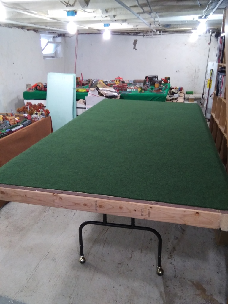

Then, thin green carpeting was cut and affixed to the tabletop with rug adhesive.
Around this time, I officially decided to name this layout the "Ephrata Valley RR Mainline" - with a rapidly increasing locomotive roster thanks to the incredible work done by the Anderson Shops, the 4'x4' Ephrata Valley Railroad has at last become too small. After selling off the N-Scale Santa Fe Paradise layout and some other train stuff, with further plans to downsize, I decided to focus on what I enjoy most about model railroading - my Ephrata Valley Railroad. With this 4x8, I plan to focus primarily on realistic railroad operations, with 2 separate lines, 1 siding, and a decent train yard with engine shed and locomotive maintenance facilities - while still keeping the autumn theme. I do Not intend on tearing down the original 4x4, simply because the layout has 6+ years of memories invested in it, not to mention countless photos and videos, and being my first HO layout ever.

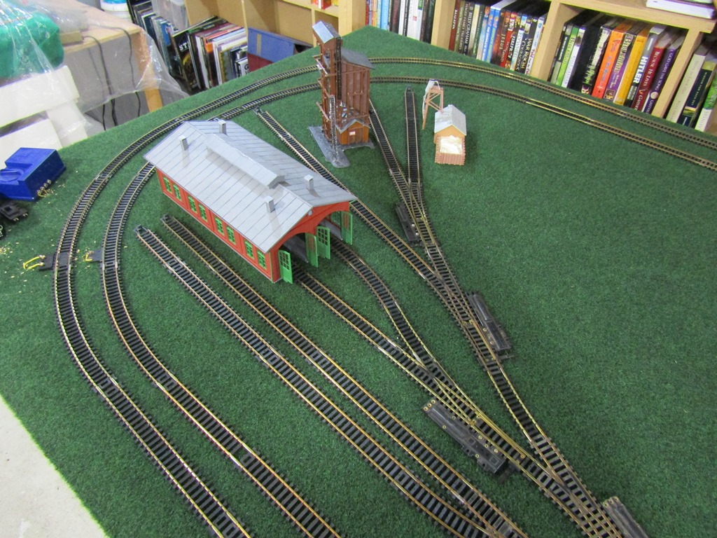

So, without further ado, here's how much track I've laid so far - the train yard is decently sized, with 6 sidings which can and eventually will, be used to store locomotives. It should be mentioned that I bought and built a Pola 2-door engine shed for the layout, which helped me to improve the train yard trackage. I still have time to change the track, as I plan to tackle wiring next, which needless to say, will be challenging - considering I want to wire-in blocks for all 6 locomotive storage tracks in the yard, as well as for the 1 siding connected to the inner line.
Thank you for reading, and I will post updates here when further progress is made.

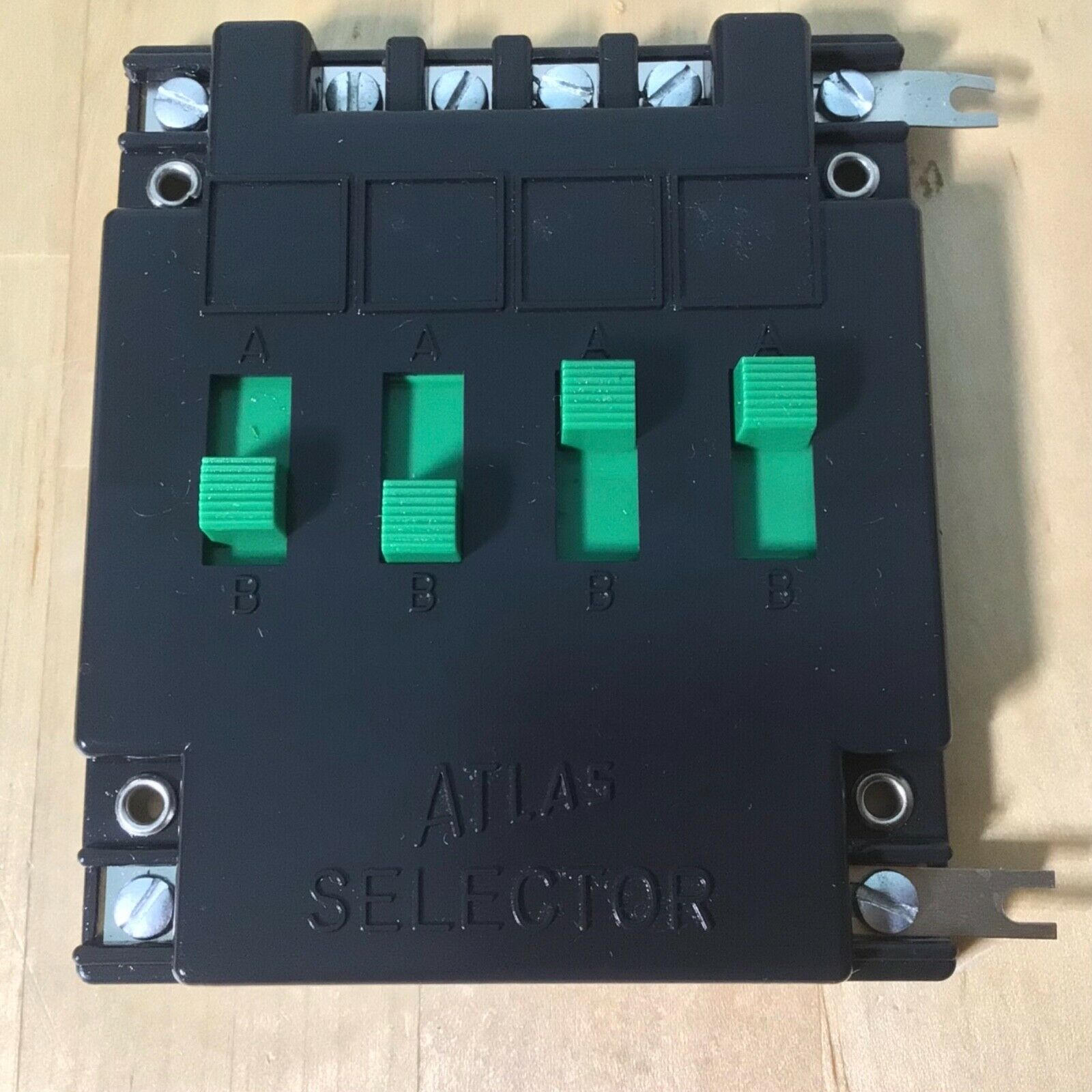

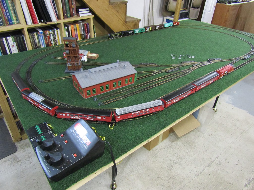

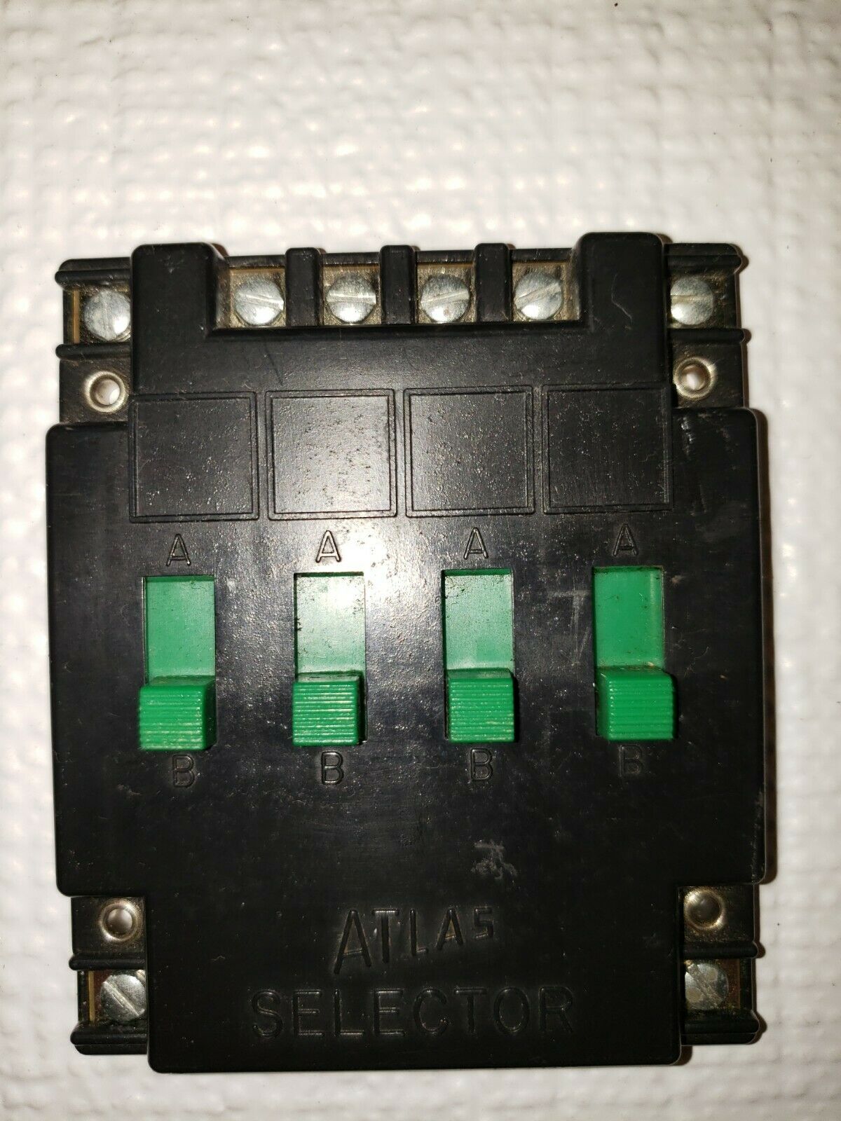

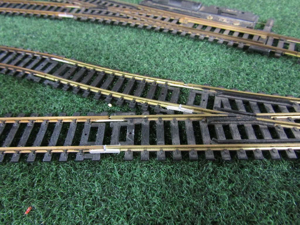

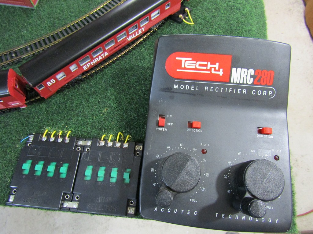

Having the day off work, I made further progress on the layout, including adding another switch track which allowed for the 7th and last storage track in the train yard. Also, I trimmed several straight tracks to the exact length I needed, to make all of the sidings in the yard even. Furthermore, I put a Tyco coaling tower (that I bought pre-assembled on Ebay from lurker43 - it was well packaged and arrived safely. Thanks!) in the yard along with a Tyco Trackside Sand House I customized a little while ago.
To make the train yard fully operational, I plan to install 8 blocks, for all 7 storage tracks and the half-circle siding (as you can see, I've already placed 1 insulated rail joiner on 1 side of the tracks that I eventually plan to wire to a block switch.) I have successfully wired up a Tyco block switch previously, for the siding on RETRO TYCO, so I do believe I know what I'm doing.....hopefully.
I am curious, is there some sort of a block switch panel I can buy, for the purpose of having block switches for each of the individual storage tracks? I don't think buying 7 or 8 Tyco block switches, and having to attach 9 different wires to the same side of the powerpack will be ideal. I have seen what appear to be mini block switch "boards" if you will, made by Atlas on Ebay, but figured I'd ask here first. Any help will be appreciated.

 Posted - October 06 2021 :  12:20:19 AM Link directly to this reply  Show Profile  Add Chops124 to Buddylist
https://www.ebay.com/itm/193600191097?hash=item2d13787a79:g:ZeUAAOSwdytfHHNf
This by Atlas. I seem to recall that this activates
an A & B block, between two transformers, but I
recall wiring up only one port, "A," to activate the
block, which is really kind of sloppy.
Also, it is a bit more more work, but single throw on
off toggle switches, fixed into drilled holes on the
side support can be used, but the support cannot
be very deep for the toggle to fit and be screwed on.
UGH. I HATE WIRING.
Here's an idea: take 8 turnout control switches, screw them
into a horizontal series, and wire only the left feed to the
insulated rail and then to the correct side of the power pack
(might take a spark or two to figure out which side. Depress
the switch button to activate the siding, and release for the
locomotive to halt.

 Posted - October 06 2021 :  12:55:41 AM Link directly to this reply  Show Profile  Add Bamos to Buddylist
The Atlas selectors are probably the cheapest option. My hobbytown has them for around 10 dollers a piece. To turn off power to the track leave the selectors switches in the center position. If you can find some single pole single throw switches cheap they will work also but are about 4 bucks piece at the local Menards.

Chops and Bamos - thanks for the advice. It seems that the Atlas selector blocks will be my best and easiest option....and I will need 8 blocks total, so 2 Atlas selector blocks should do. I am going to do some more research first and update you all once more progress has been made and if I have more questions.
 Posted - October 08 2021 :  03:29:14 AM Link directly to this reply  Show Profile  Add Chops124 to Buddylist
Selectors are fine, but were designed to switch power
back and forth from two different cabs in an age
before DCC. By wiring on side, A, or B, you
will get the desired on/off effect.

Yep. I bought 2 Atlas selectors off Ebay for around 10 bucks each, 1 of which has the plates which enable it to be "connected" to the 2nd selector, for power transfer. I think I am actually looking forward to the wiring process. Stay tuned.

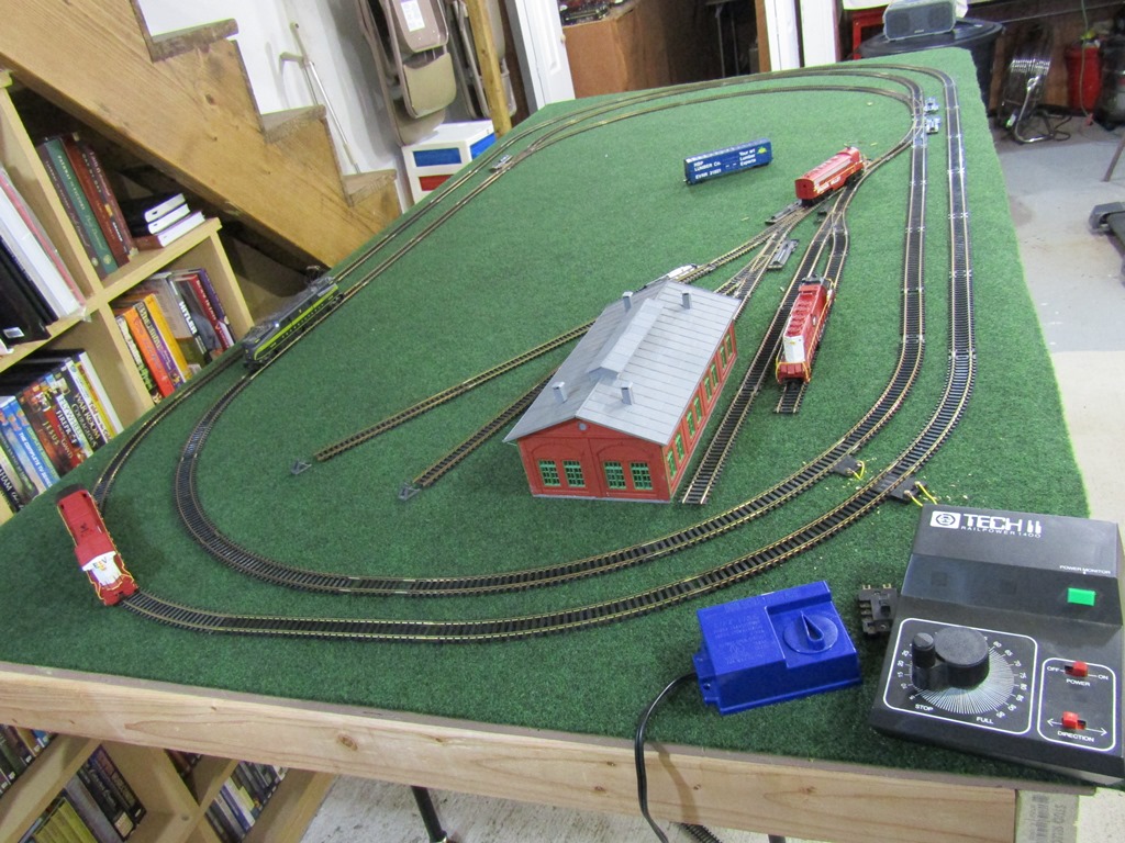

 Posted - October 26 2021 :  10:28:44 PM Link directly to this reply  Show Profile  Add RP model railroads to Buddylist

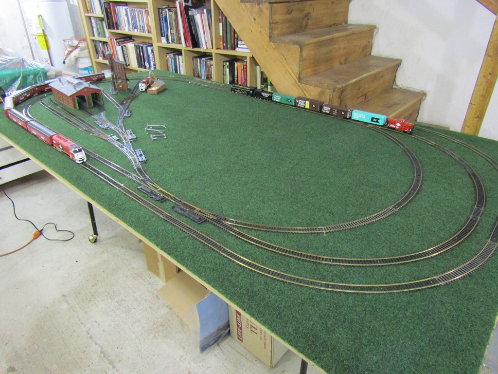

Well, I wired up the layout and nailed down all of the track, today. Rather than writing a novel to explain my progress, please enjoy my latest YouTube video:
Please be aware that I left the switch/turnout tracks manual, to keep it simpler in design and because I like manually switching the track.**

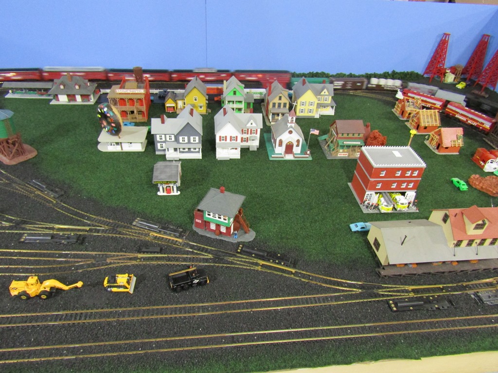

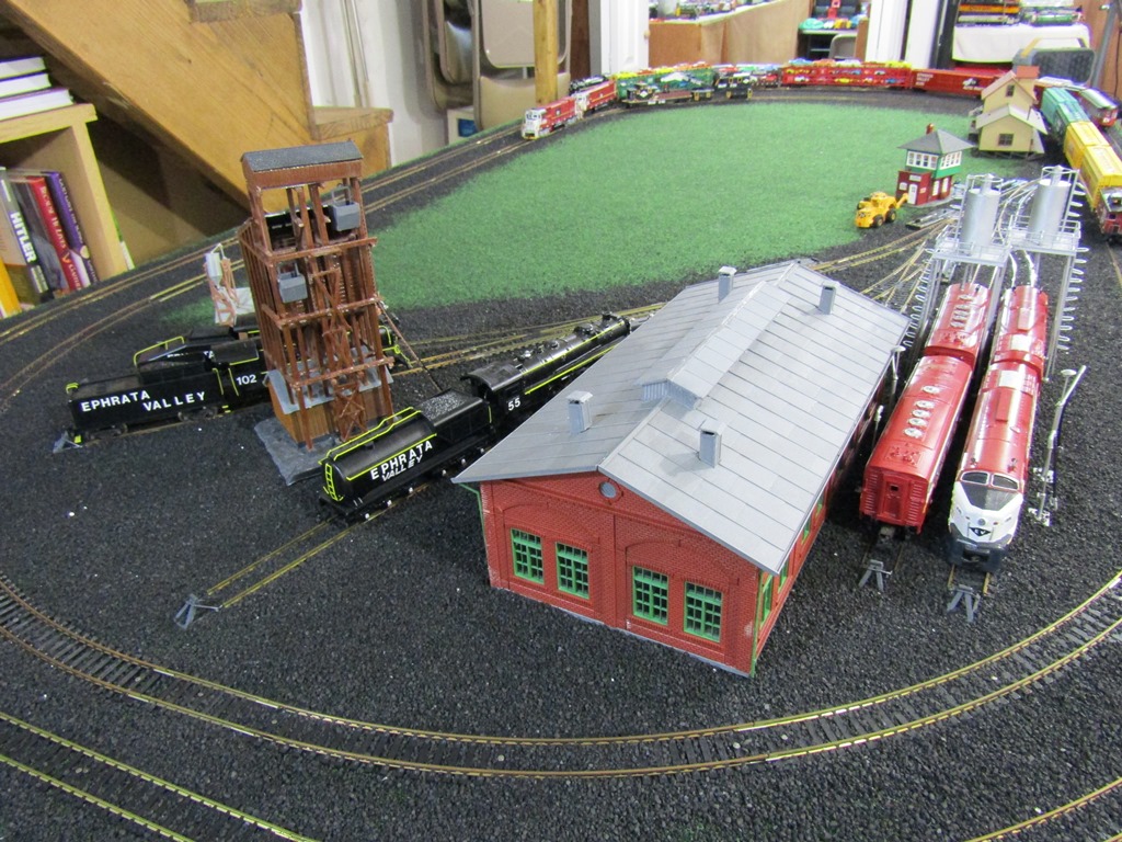

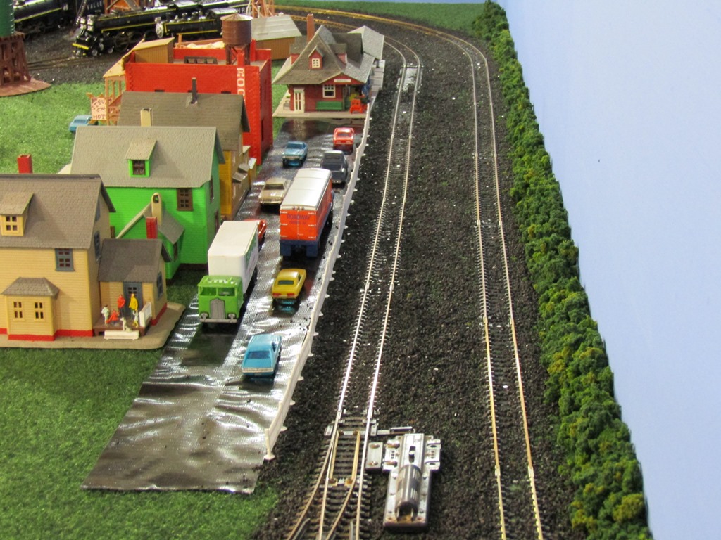

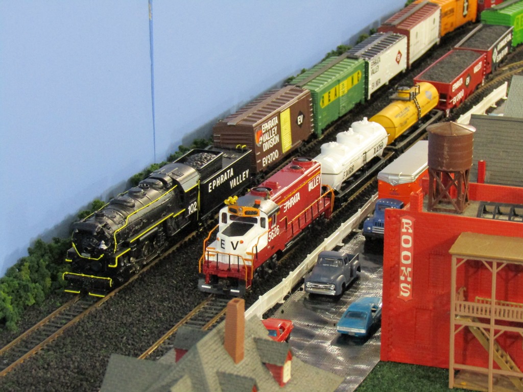

 Posted - November 27 2021 :  9:27:16 PM Link directly to this reply  Show Profile  Add RP model railroads to Buddylist

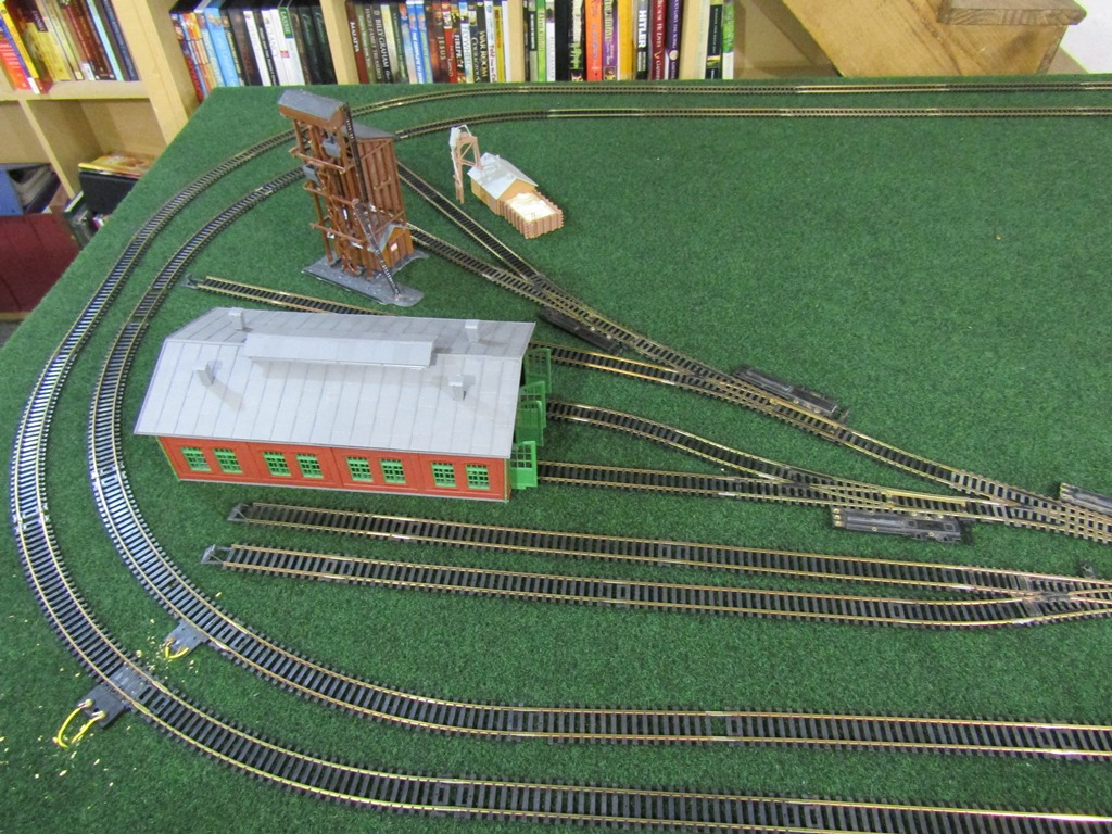

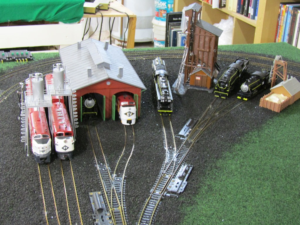

After waiting in vain for over a month for the 4 to 5 Dollar Trees in my area to get black sand bags once again, I decided to take a trip to Michael's and found a similar black stone "ballast," if you will, which I then used on the layout. The results, well, speak for themselves - the layout looks awesome with black stone around the tracks!
Here's a video of Ephrata Valley RR train action on the 4'x8' mainline - enjoy.
https://www.youtube.com/watch?v=9cC3iXItswA&t=130s

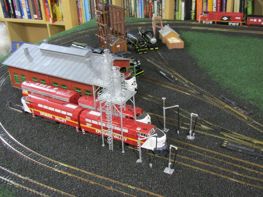

Since then, I moved the fuel and water columns from behind the diesel sanding towers, to in front, where they will be both seen better, and appear more functionally realistic. I then plan on using an old junk tank car, and customizing it to become a diesel fuel tank, to put off to the side of the tracks in the diesel servicing area.
From here on out, progress on the layout is going to be even more fun, as I focus on scenery and structures, possibly adding a siding or 2, and backdrops.

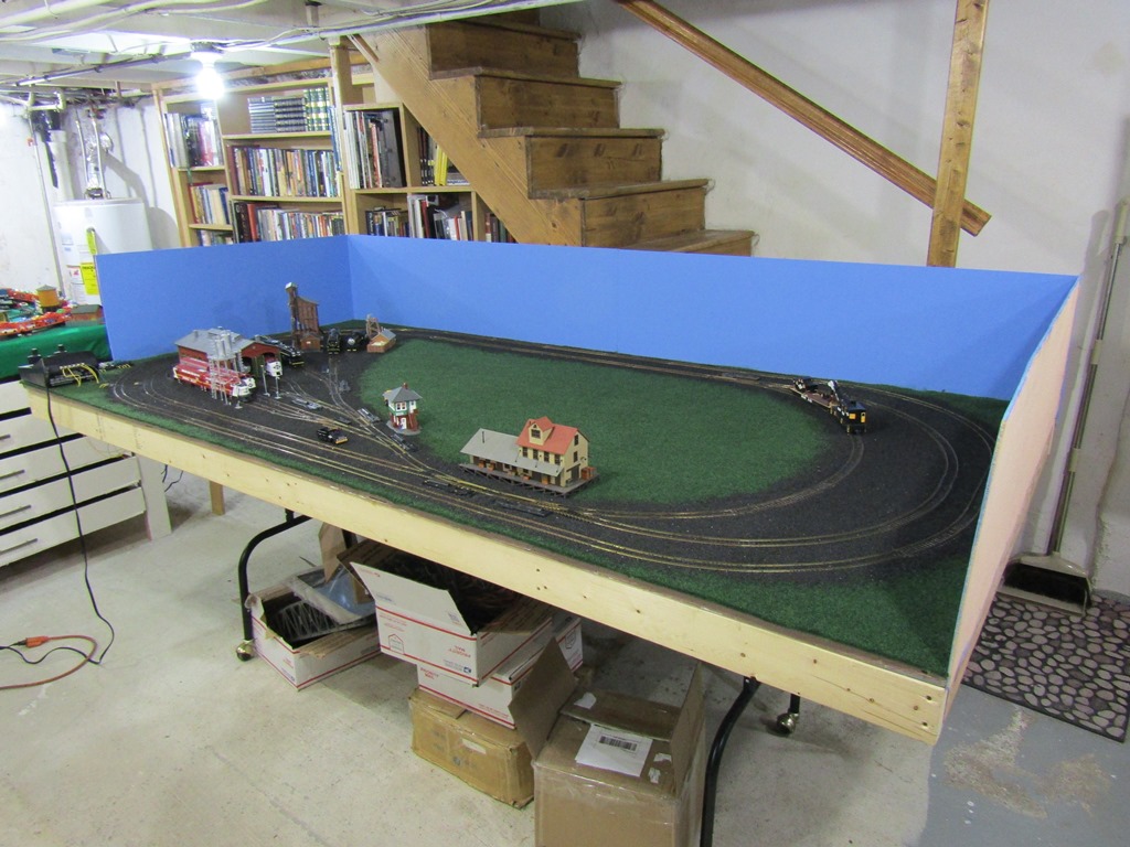

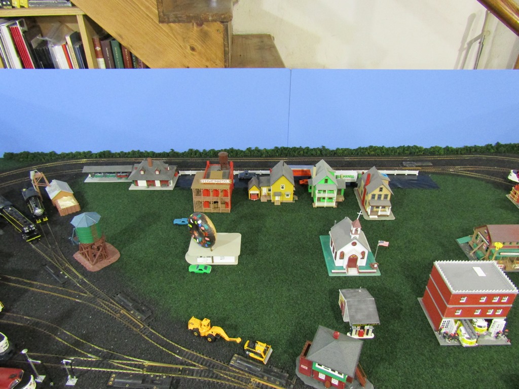

Between yesterday and today, I completed the backdrop for the layout. I used saved pieces of lauan wood - cutting a few to the sizes I needed, and then added 3 coats of blue paint. The backdrop was then nailed to the sides of the layout, and glued with wood glue in the corners. The final result looks quite good and will be a gamechanger for taking photos and videos of train action on the layout. Next up, the fun stuff - buildings and scenery.
I may paint clouds in the future.

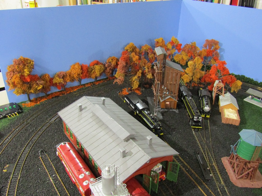

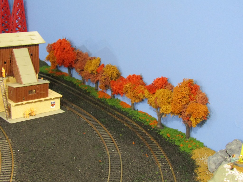

 Posted - December 12 2021 :  10:16:10 PM Link directly to this reply  Show Profile  Add RP model railroads to Buddylist

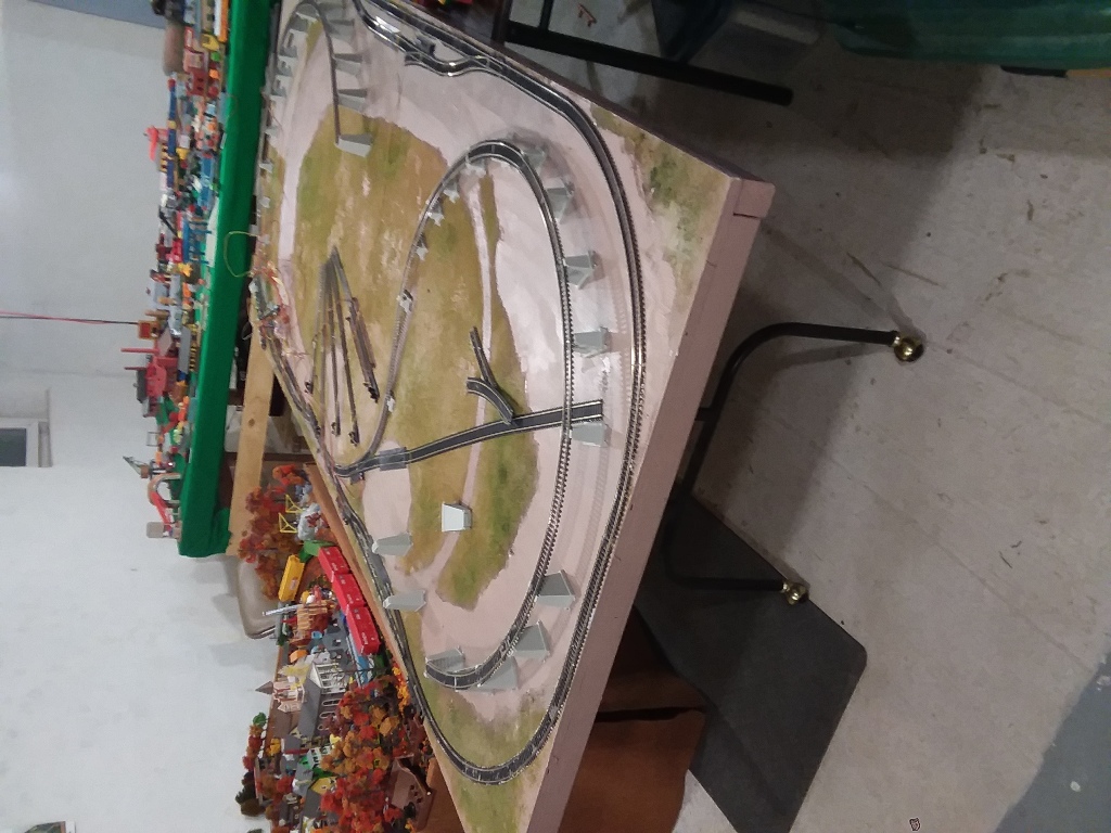

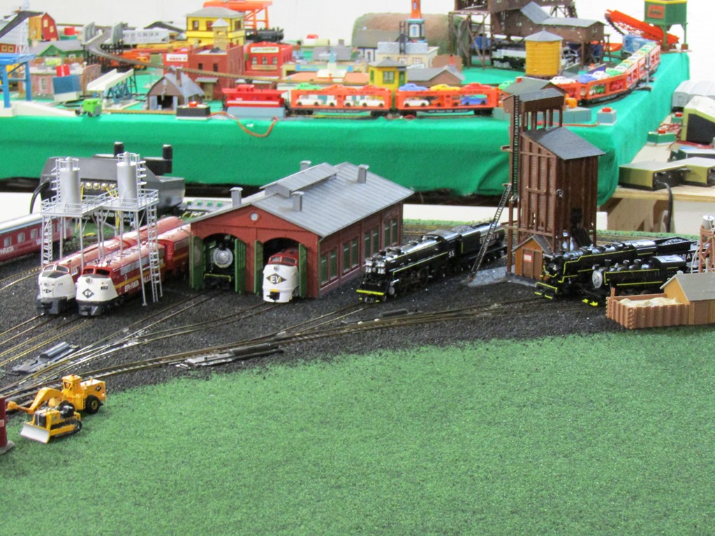

I decided to dismantle the original 4'x4' Ephrata Valley Railroad layout and add as much as possible from the old layout onto the new 4'x8'. The video tells all.
https://www.youtube.com/watch?v=kN3rve8Gd94&t=2s

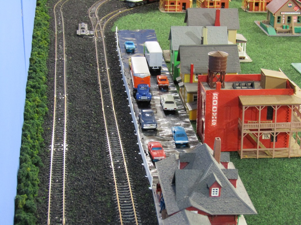

Today I worked on some scenery on the 4'x8', specifically adding tri-color green Woodland Scenics clump foliage (that I kept all this time from dismantling my N-Scale Horseshoe Curve layout years ago) to the rear of the layout and along the right side by the backdrop, where the space from track to backdrop isn't large enough for trees. I can still improve the backdrop with either a picture or rocks.....
Thanks to a tip from the Budget Model Railroading Facebook group, I picked up a roll of black Duck Tape, to use for roads. Here are my results for the road I planned on adding to the edge of town, running right along the tracks. I also found a good use for the HO Atlas white fence I've been holding on to forever, separating trains from cars. I am happy with the results, although the tape is a little too shiny for my liking - I'll try sanding it slightly to get rid of the glossy sheen, for a more realistic road. Best part about using Duck Tape (besides cheap) is it is easy to pull up, so if I need to move or replace roads, it will be a breeze.

Exactly, the many photos and videos of the layout will keep its memory alive, not to mention all of my favorite buildings being grafted on to the new 4'x8'.

thats better
don't need a ALLEY highway exactly
 Posted - December 15 2021 :  8:58:04 PM Link directly to this reply  Show Profile  Add RP model railroads to Buddylist
Nice work, RP. I enjoyed the colorful scenery on the original layout. Regarding the duct tape road, it looks a bit lumpy. You may want to get some thin cardboard (Costco, Sams, Ikea, ...) and use it as the road base, then apply the tape on top. Maybe that will help smooth out the road?
Originally posted by Brian4321-December 14 2021: 10:32:48 PM
Thanks. Yeah, I noticed that as well, and maybe cardboard would do the trick. I can cut up an old cereal box and see what happens. Best part about using duct tape is, 1 roll gives me plenty of road.
busss, there will be more roads in the town, but I specifically wanted a road on the edge of town that runs parallel to the tracks, for photo/scenery purposes.

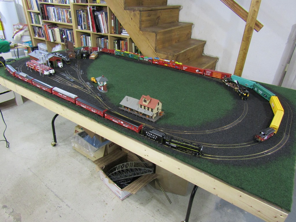

Here's a shot of how the town scene has progressed.

Looking great RP!! I really love those house kits, adding a few trees, cars, and people alongside the houses will really make them pop
 Posted - January 01 2022 :  10:19:27 PM Link directly to this reply  Show Profile  Add RP model railroads to Buddylist
Originally posted by RealBnsfIA-December 24 2021: 10:02:50 PM
Thank you! These latest houses are quite nice, and I definitely plan on adding trees, cars, and people to the town, once I get more buildings and figure out the road setup.
I saved all of the autumn trees made with Woodland Scenics "lichen" from the old layout, and after trimming some and fixing others, glued them on the 4'x8', creating a brand new "tracks thru the trees" scene in the right-rear section of the layout. I am very happy to have saved these trees and mimicked the iconic scene of the old layout, where I enjoyed taking so many photos.
