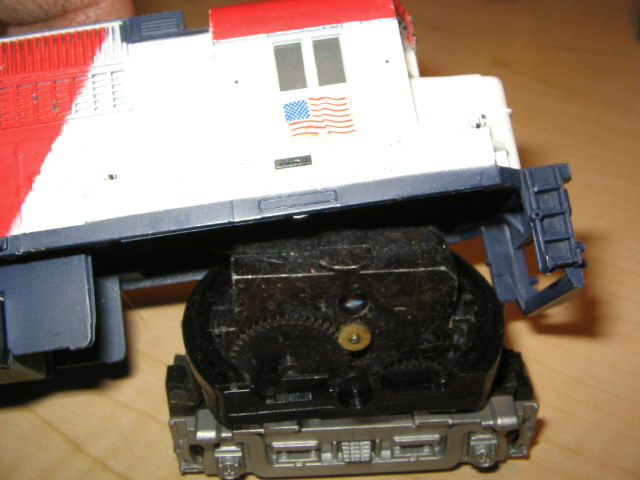

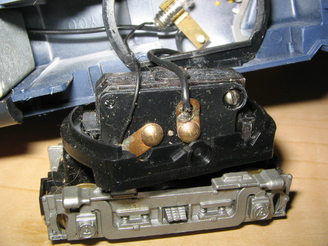

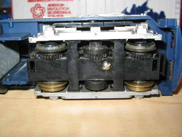

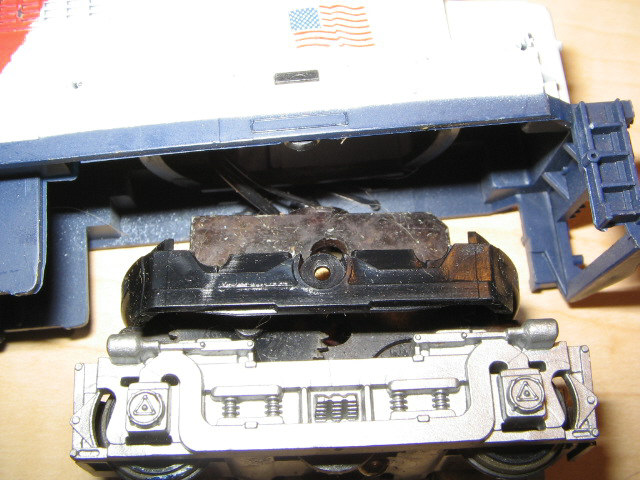

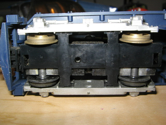

This power torque is like no other. There is only one screw holding the front truck only and the ends snap on to hold completely. This design has to be the first issue power torque truck. All other powertorque tyco's have 3 screws holding truck to motor. The rear truck is the same but screw is missing - only the snap on ends holding it. This Spirit of 76 power train in this configuration is the only one i have ever seen or owned as my collection of these is 10 with the variations. The casting for the motor is also different than other powertorques as is the rear truck casting. The coupler pocket snaps onto truck via prongs like the alco 630 early version. BTW--IT IS A STRONG RUNNER!!!
