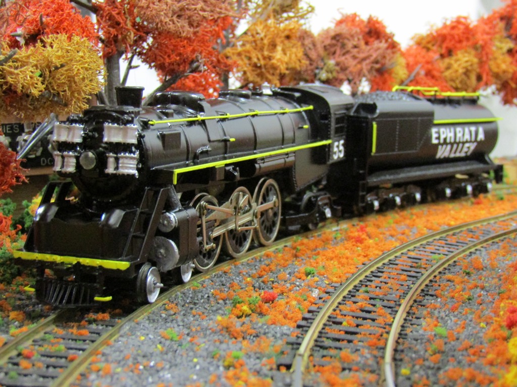

 Posted - April 10 2021 :  9:34:14 PM Link directly to this reply  Show Profile  Add RP model railroads to Buddylist
The latest steam locomotive has emerged from RP Works. Ephrata Valley RR 4-6-2 Pacific #55, aka "Double-Nickel." This is a Mantua 4-6-2 I customized a little bit on the front by installing 2 brass "flying" air pumps on the firebox front, and trimming off the rails that normally extend down to the cowcatcher. I am highly satisfied with this project, and am confident it will see much freight service, and eventually passenger service too, on the Ephrata Valley Railroad!!

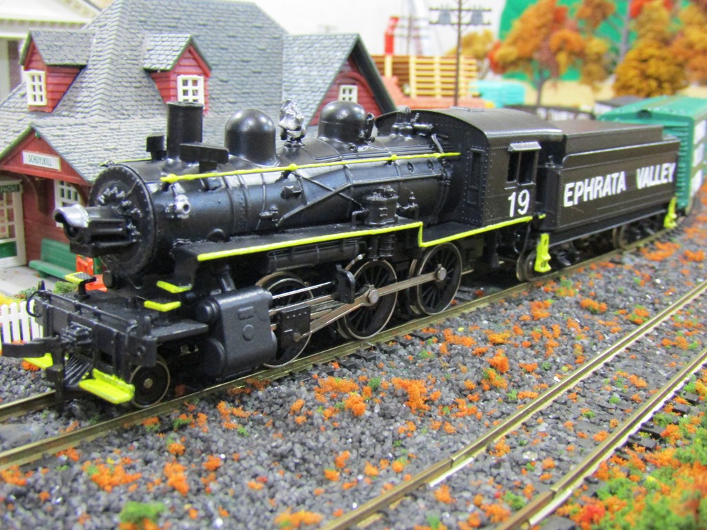

 Posted - May 15 2021 :  10:33:05 PM Link directly to this reply  Show Profile  Add RP model railroads to Buddylist
Finally finished repainting and detailing Ephrata Valley RR 2-6-0 Mogul #19 - to look more like my other custom steam locomotives - and it turned out great!!
 Posted - May 15 2021 :  10:46:45 PM Link directly to this reply  Show Profile  Add Chops124 to Buddylist
EVRR is getting steamed up!
 Posted - May 15 2021 :  11:47:48 PM Link directly to this reply  Show Profile  Add walt to Buddylist
Nice, RP!
 Posted - May 16 2021 :  10:37:17 AM Link directly to this reply  Show Profile  Add RP model railroads to Buddylist
Thanks guys!

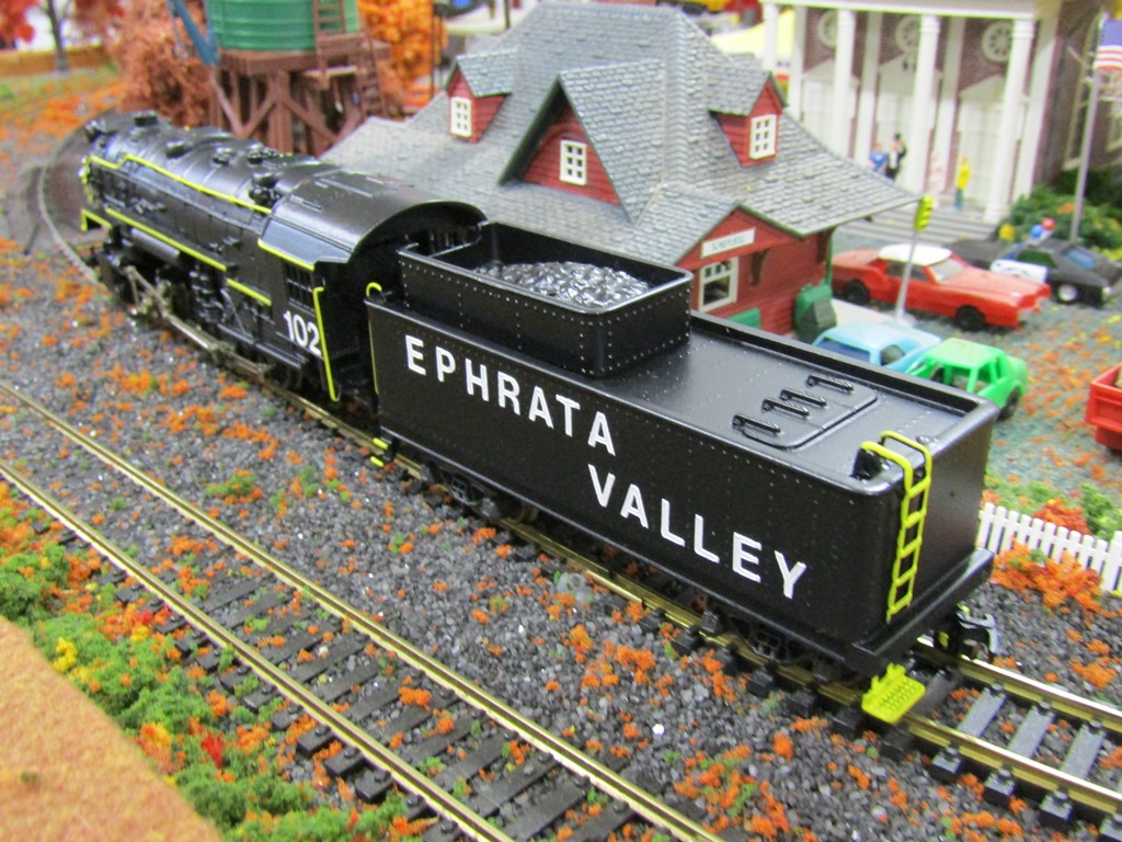

 Posted - May 22 2021 :  10:31:21 PM Link directly to this reply  Show Profile  Add RP model railroads to Buddylist
Ephrata Valley RR 0-8-0 #102, a Rivarossi steam locomotive, is complete.
 Posted - May 23 2021 :  12:29:41 AM Link directly to this reply  Show Profile  Add Chops124 to Buddylist
Another steamer hits the rails at the EVRR.

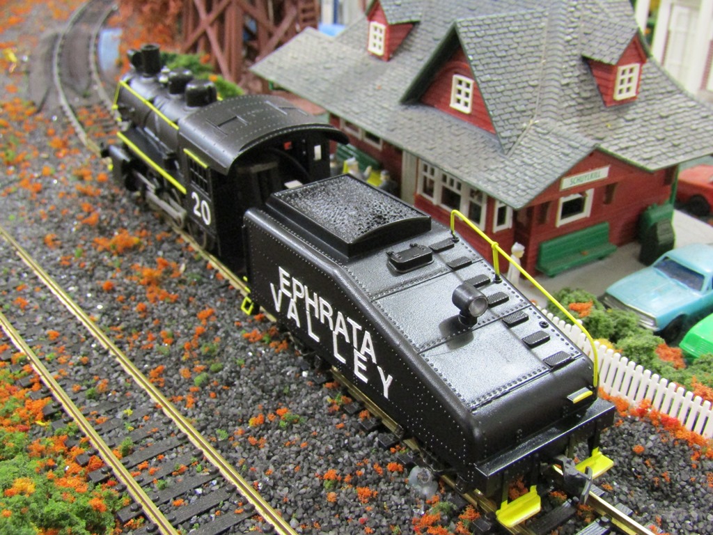

 Posted - June 15 2021 :  9:20:45 PM Link directly to this reply  Show Profile  Add RP model railroads to Buddylist
Indeed, Chops. Just today, RP Works cranked out another Mantua custom steam locomotive, 0-6-0 #20! This "Big Six" will serve the Ephrata Valley Railroad well, and will be the subject of many edited photos soon to come on my Instagram.

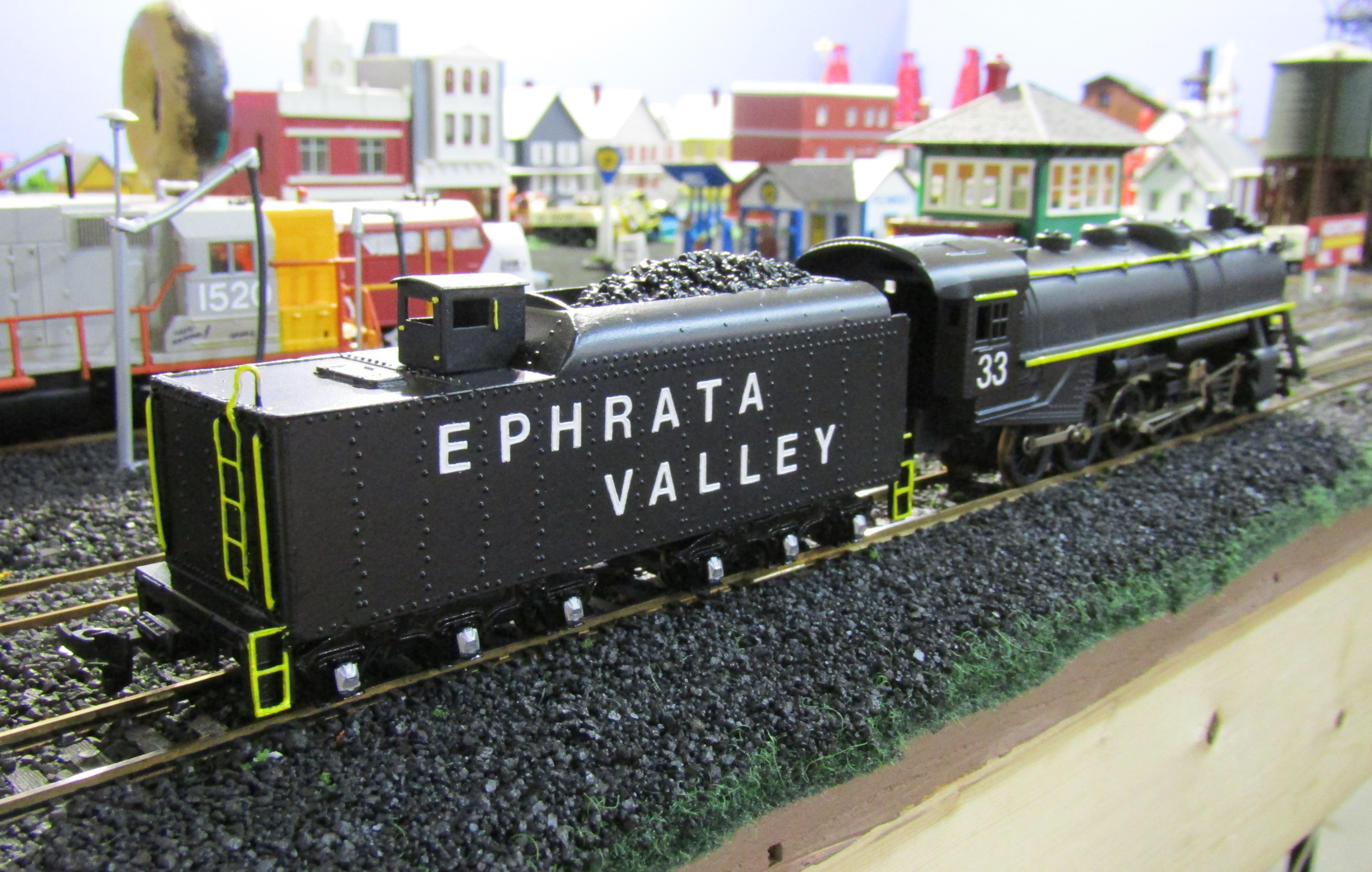

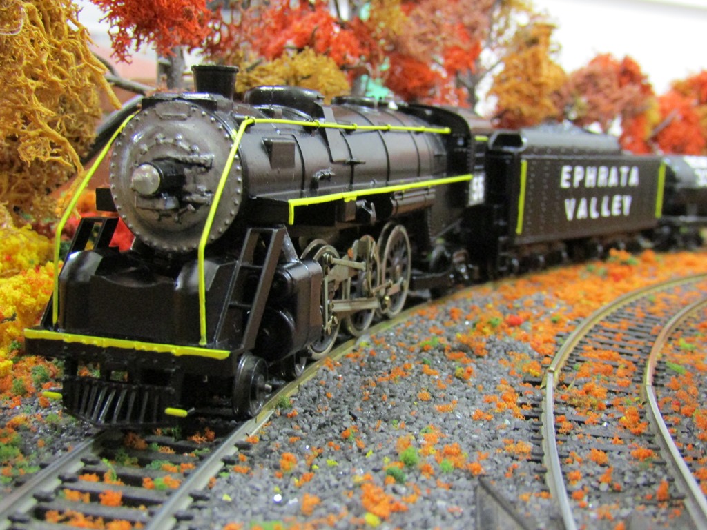

 Posted - July 19 2022 :  10:13:22 PM Link directly to this reply  Show Profile  Add RP model railroads to Buddylist
I forgot to update this.
Ephrata Valley Mantua 4-6-2 Pacific #54 - passenger/express service
Ephrata Valley Mantua 2-8-4 Berkshire #60 - freight & passenger service
Ephrata Valley Mantua 2-10-0 Decapod #33 - huge thanks to Darth Santa Fe on converting a Mantua 2-8-2 chassis to a 2-10-0.

Only suggestion would be to cut the axle stubs off the lead truck wheels, especially the pointy ones!
On the "Big Six"......I have one, Last new-from-the-hobby-shop engine I bought in Groton Conn while at Sub School in probably 1970. Still have it, on the shelf, until it gets shredded with the rest when I'm gone
Are the main rods stock or new fabrication?

If I may expand on that, I've done this, and the easy way is to nip them off with a heavy duty (hard enough) wire cutter to cut steel. Then, I have a piece of brass unrolled flat from a spent .22 caliber shell. It's got an axle sized hole drilled in it, and I put that over the face of the wheel with the nipped off axle end through the hole and file the axle end flat while the brass protects the wheel.

 Posted - July 22 2022 :  11:27:07 PM Link directly to this reply  Show Profile  Add RP model railroads to Buddylist
Good suggestion. Love to see photos of your T1.
The EVRR Big Six #20 has factory Mantua rods.

Maybe it was the camera. They just looked fatter rods than I remember!
