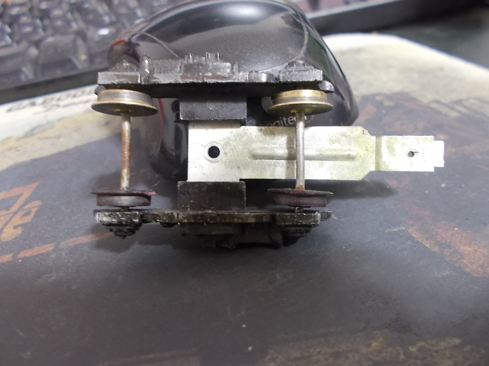

How does one take this apart?
I need to straighten the wheels

From my Tyco CN Coaches, I have pretty much figured out that one simply does not take Tyco Passenger Trucks Apart.

really? why not?
this one goes onto my Rio Grande passenger car

I only have the one passenger car or else I'd try. They seems like something that are press fit together pretty tightly. I would find a Santa Fe coach for cheap and swap the truck.

I am of the same opinion, Aaron.
However, busss, you might be able to just straighten-out those axles with a small pair of needle-nose pliers....might not be perfect, but with some tweaking, you should be able to get the axles rolling fairly straight again.

What if you gently extract the axles and slip in a
flexible pair of nylon wheel sets?

How can a set of trucks get destroyed to that degree?? I'm a bodyman and I wouldnt want to attempt to straighten that!

The side frames may come off if you drill out the 2 recessed areas.
I would use a drill that is the same size as some styrene rod so you can pin it back together later.

& Walt I stepped on it

Those axles are trash, just replace them. Also notice that the flange on the plastic wheel is also damaged.
Your best bet is replace the entire truck with one salvaged from another car.

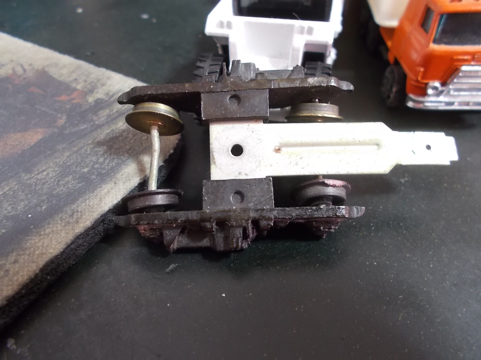

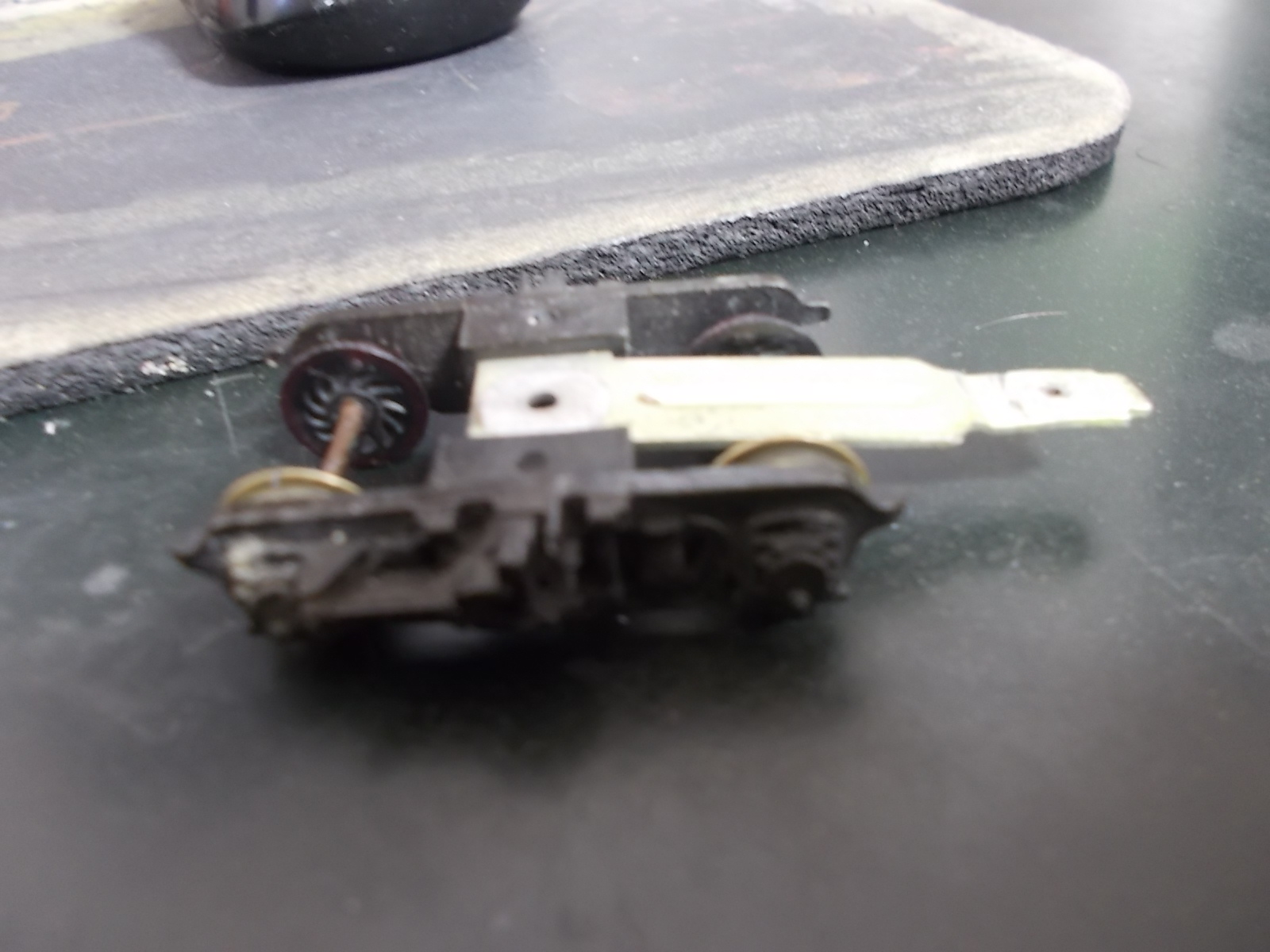

got the wheels out & got them fixed!
now how does 1 fix the coupler mounts?

Still bent Ben. I can see it in the photos... Both axles will shake your teeth out!

Simply drill out the one side. Bit should be just a little wider than the circular depression on the cast part of the truck. Remove that side and slip in new wheelsets or repair the existing ones. Put it back together with your favorite “stick to everything” glue.
Originally posted by walt - May 01 2021 :  3:27:50 PM
they ain't as bad as the 1st pix
Originally posted by microbusss-May 01 2021: 6:51:48 PM
Agreed. Way better, but you could still do some more bending.

Will probably never be right, and I've been straightening metal for many years! My first opinion was to scrap the whole thing. My now opinion is the same...

yeah course had to take out wheels as I put them in wrong
but I got them in the correct way now
