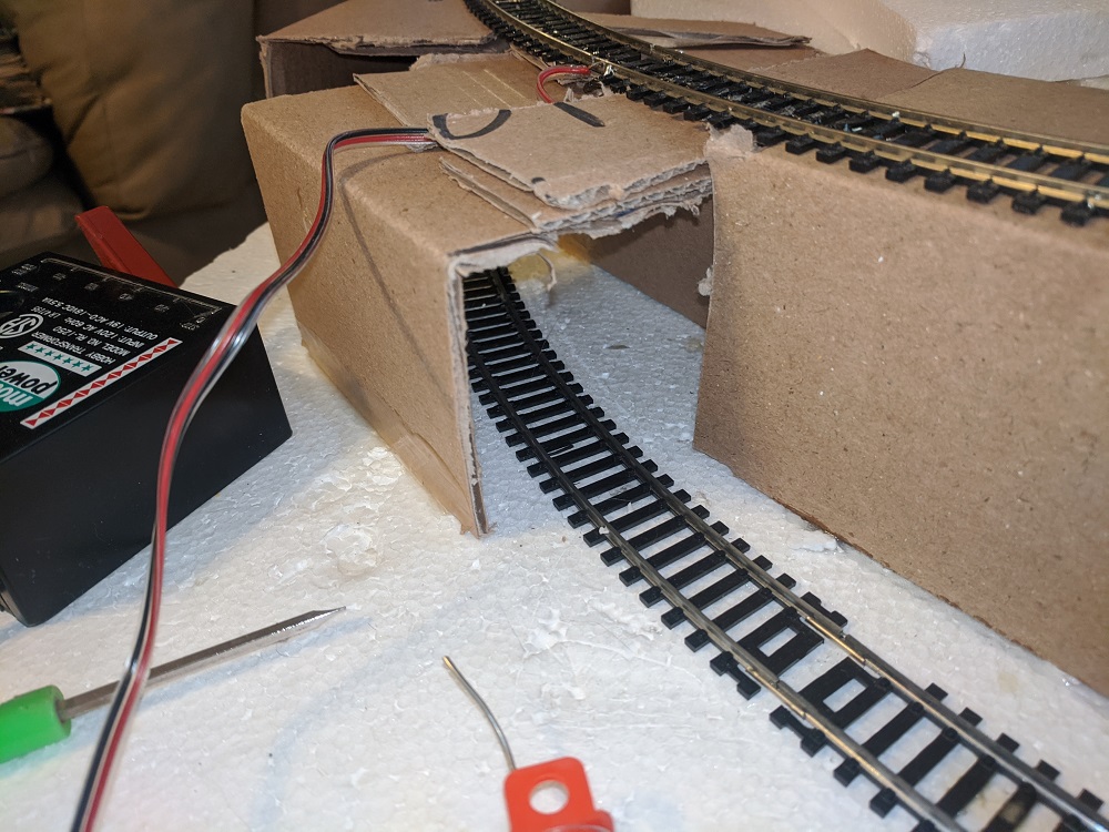

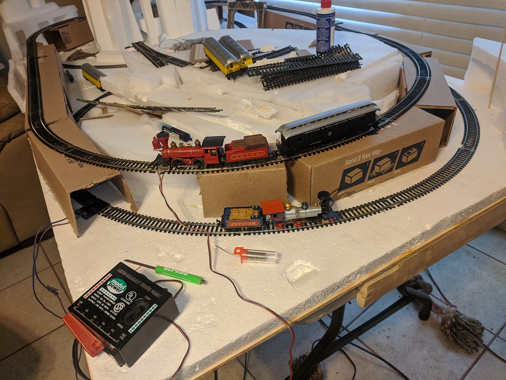

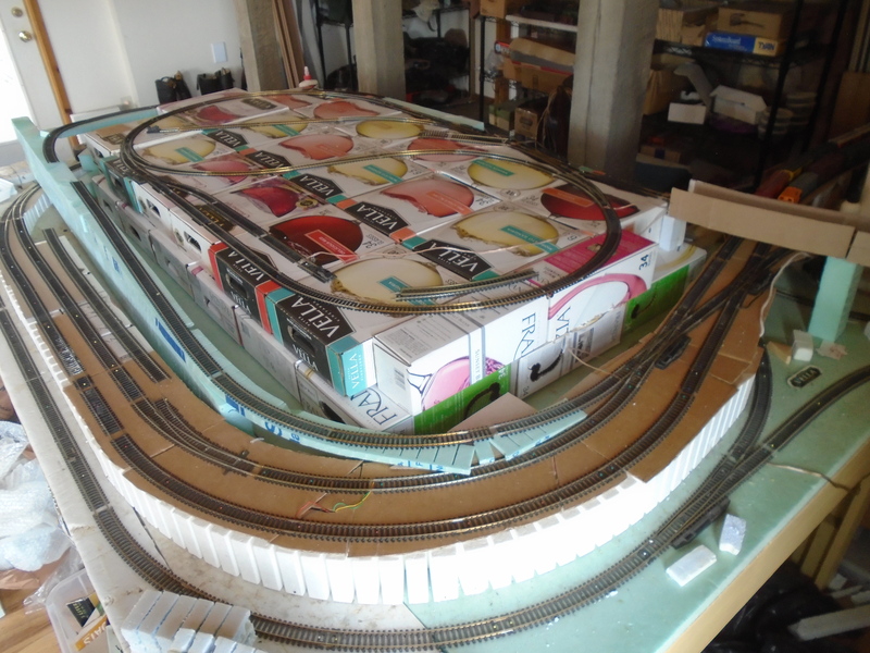

Last time, it was difficult to get an even sub-roadbed for the upper tier of track. While
standing in line in the post office, I noticed these mailing tubes, and they were just the
right height, 3 inches, and width, 3 inches, and with a little cutting up they fit the bill just
right. Tested it out, and the trains run perfectly level.

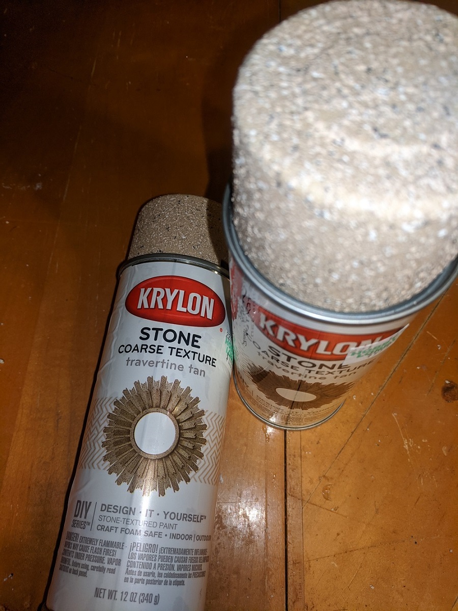

I stumbled over this texture paint, and recalled I had used a gray texture paint to create ballasted
roadbed for Henley. This worked out well. While not photo real, it look a whole lot better and be a
whole lot lighter. Especially when colorizing the vertical faces of the butte and cliff faces, this will
be a hundred times easier to apply. Apply ground cover to a vertical face is exceedingly difficult,
and thin patches will turn up all over the place. So, I think this texture paint is going to work out
real well.

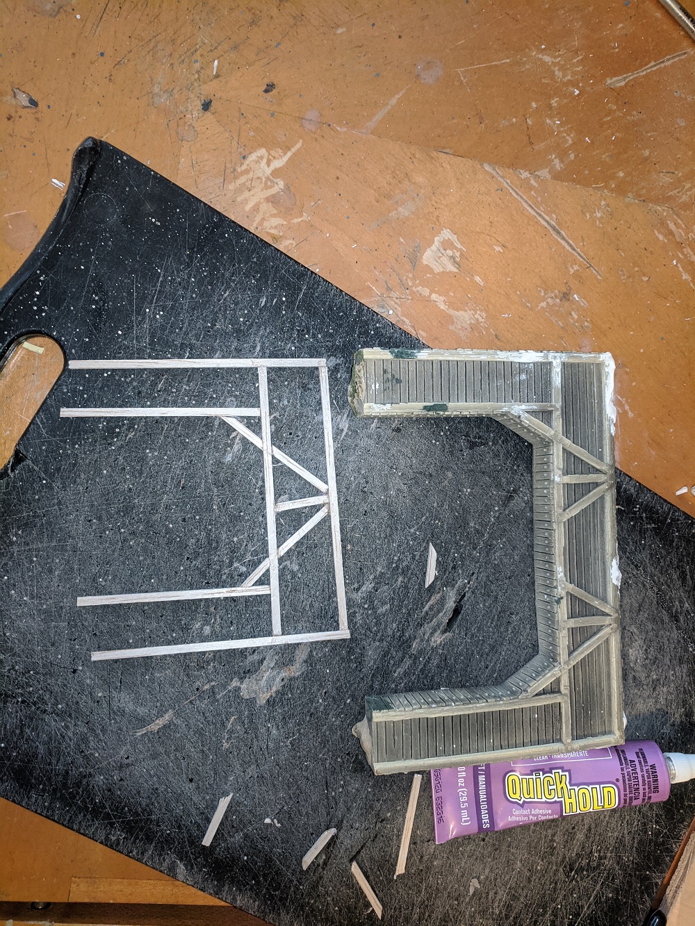

Going to be scratchbuilding trestles for the four bridges. This is actually fairly easy, certainly
within my skill level. First, Balsa beams are glued to the underside of the tracks, then a jig
will be fashioned using smaller Balsa sticks for bents, once jigged up, the trestles will be glued
together. If too tall, they can be easily trimed at the base legs to fit.

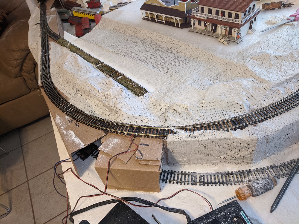

 Posted - February 28 2021 :  11:09:51 AM Link directly to this reply  Show Profile  Add Chops124 to Buddylist

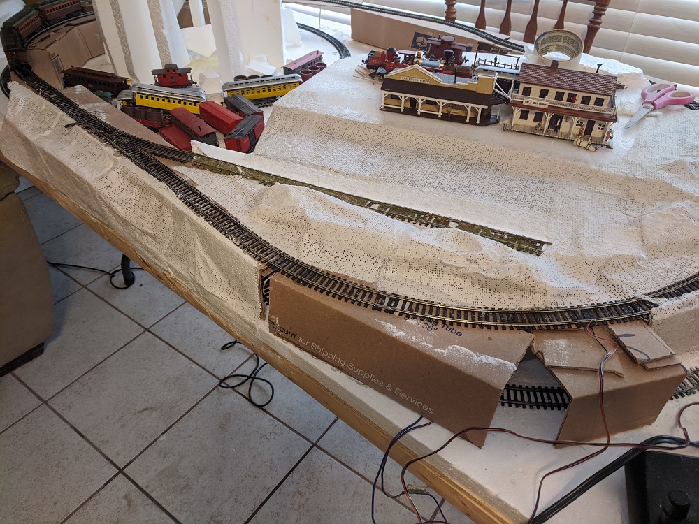

Replaced a small section of track on the "back 40." It seems endemic that whenever a section of track has problems, it is always in the most difficult to access spot. Don't know why, the track appears perfect, but
the locomotive made a "click" going over the joiners and the pilot derailed all the time. Fixed now. Now it wants
to derail on the one turnout, where before it crossed perfectly.

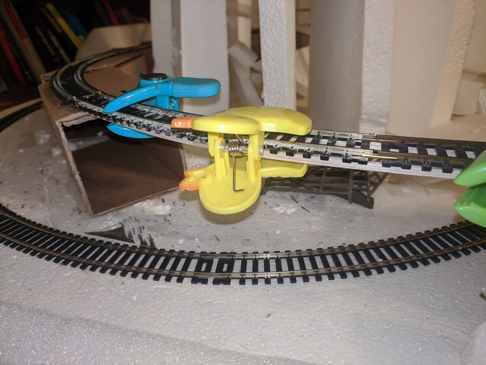

Thought I was going to need about three trestle bridges for the upper tier, but soon realized that the angle of
the lower tier radius blocked trestle placement, which would leave a grotesque forty foot unsupported span. That would make it look like Dr. Seusss's Fox in a Box train.
So, the spans are being converted to tunnels, and I found this old plaster timber tunnel portal in the junk box,
which was built for dual tracks. It is quick work to convert to single track and I'll be whipping up some later today, out of Balsa (that was purchased for the trestles).

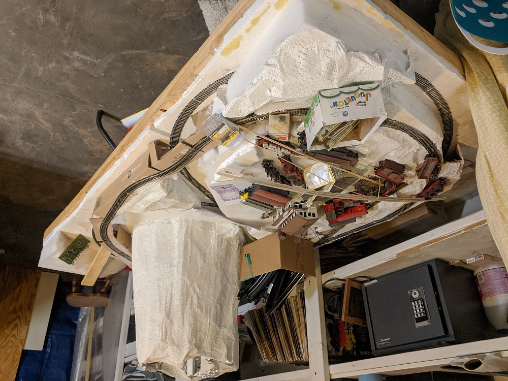

 Posted - March 16 2021 :  2:30:45 PM Link directly to this reply  Show Profile  Add Chops124 to Buddylist

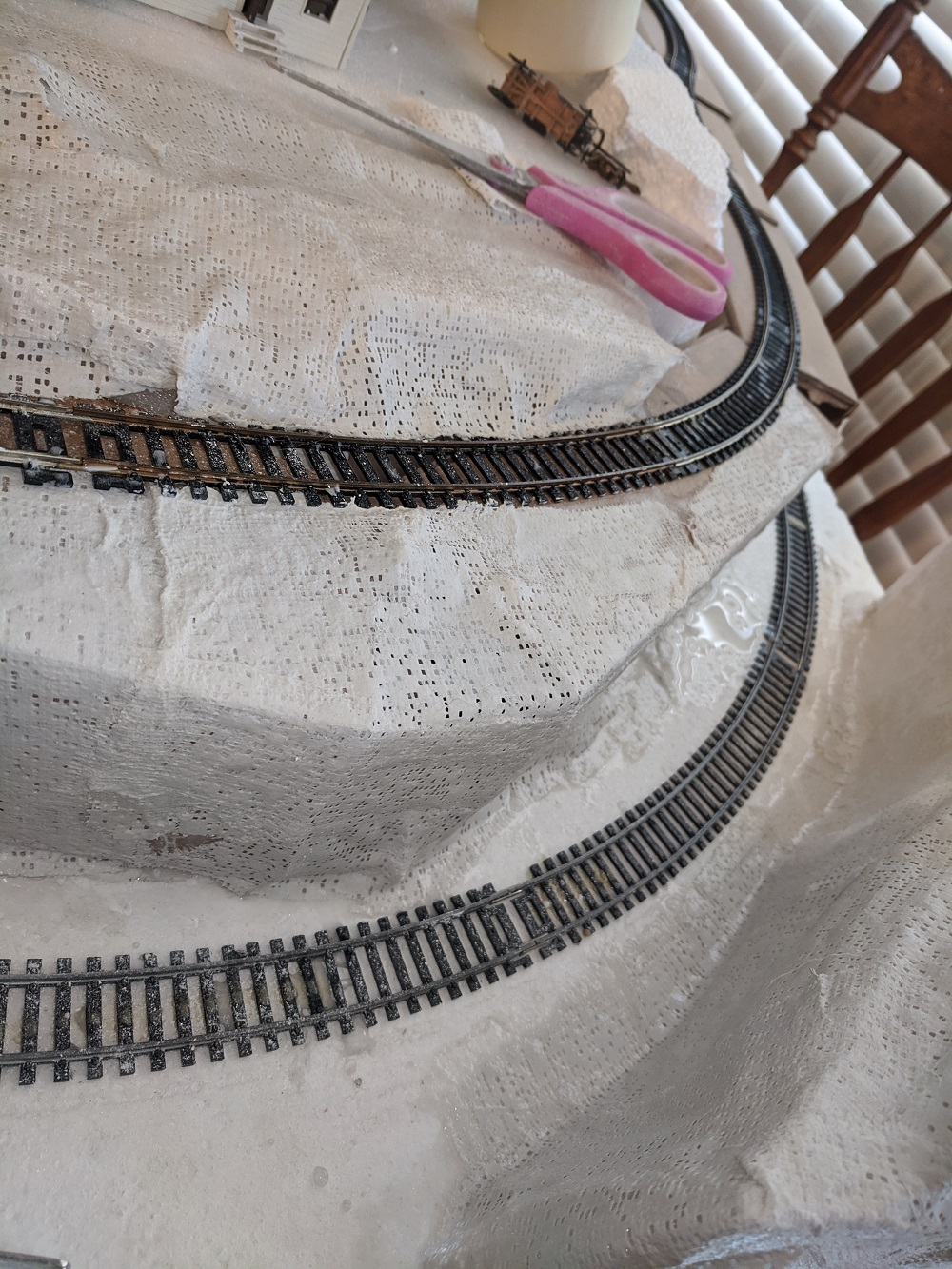

Before I go into night shift tonight, took a little time to start working in some canyons and
slopes. The plaster cloth by Woodland Scenics is so much better to work with than those days
of newspaper strips or plaster soaked cloth. The dry cloth can be laid and cut into position,
and then a light mist or brushing on of plain water is all that is needed for it to soften and
soon harden. Additional brushing with a wet brush causes the pores to wash over with plaster.
Going much faster than I had thought, I started with the town of Grimbsy and began to
work outward in test strips, which went to so well I've managed to cover about a fifth of the
layout.

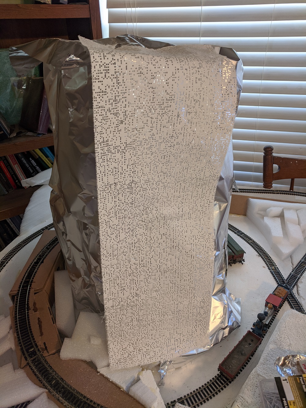

 Posted - March 27 2021 :  6:17:45 PM Link directly to this reply  Show Profile  Add Chops124 to Buddylist

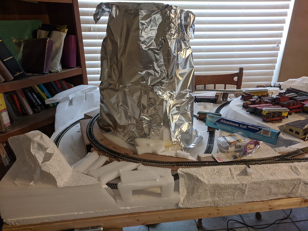

Starting to work on the butte. The vertical Styrofoam stanchions are getting wrapped in a
single layer of aluminum foil fastened by panel nails, would have preferred thumbtacks, but
could not find them, , dipped in Quick Hold cement that binds anything it touches,
but does not melt foam. This will provide a little firmness when the plaster cloth is laid upon it,
so the stanchions will be hidden, and not protrude like bones. A few dabs of Quick hold will
be laid down to give the plaster cloth something to anchor to, while it dries.

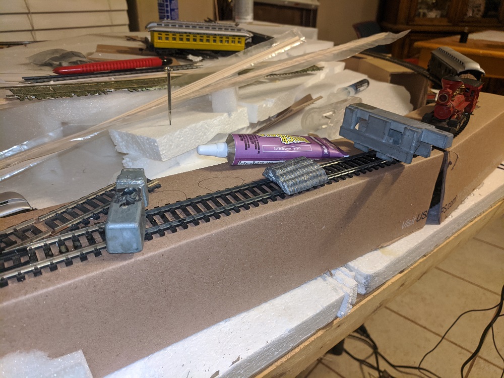

Built up another tunnel in the foreground. I had hoped to lay in trestles in these overpasses, but
soon learned that the angulation of the upper and lower tiers would make for an enormous,
awkward span between the center bents. But tunnels are good. An access port
is carved into the side, will be eventually covered by a flap if there are issues inside the tunnel.

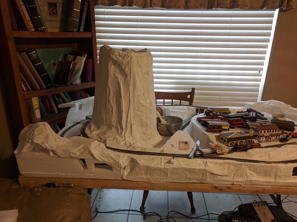

Buttes tend to have a buttress of ancient lava flow that once fueled the volcanic core, which is
coming together on the left aspect. The base is flared out a little to recreate the fallen debris,
over the millenium, that accumulates at the foot.

 Posted - March 28 2021 :  6:53:43 PM Link directly to this reply  Show Profile  Add Chops124 to Buddylist
Working on the Devil's Thumb Butte. A layer of dry plaster cloth goes on over the aluminum foil
base cover, and is glued on by this great fast drying glue called Quick Hold. After the rest of the
cloths go up, they will be wetted down and conform to the surface of the foil, held in place
by the glue. If one facet gets too concave, it can be pushed out during the wet phase from
inside the top of the butte. When it drys, it will be stiff. The trick will be adding vertical striations.
I might do this with a comb while it's still wet. Adding another layer of plaster means a lot
more weight to the entire module.

Did a little more work on Devil's Butte over the weekend.
 Posted - April 01 2021 :  9:13:16 PM Link directly to this reply  Show Profile  Add RP model railroads to Buddylist
Wow! That is really shaping up, Chops
 Posted - April 02 2021 :  12:24:29 AM Link directly to this reply  Show Profile  Add microbusss to Buddylist
heh it reminds me of Devil's Tower
 Posted - March 27 2022 :  08:11:36 AM Link directly to this reply  Show Profile  Add Chops124 to Buddylist
Haven't done much with Mormon's Gulch due to time constraints. Having the experience that EZ
track is much less temperamental, on the whole, it is being contemplated to rip out the set track
and replace it all with EZ.
jward
 Posted - March 27 2022 :  8:29:19 PM Link directly to this reply  Show Profile  Add jward to Buddylist
I suspect alot of your problems with the snap track is due to the flimsy base you've laid it on. But then, I'm an old school, third generation modeler. I tend to overbuild things, and solder my rail joints. If properly laid on a solid subroadbed, even snap track can be made to perform well. Even with EZ track, I think you're going to regret supporting that upper track with cardboard.
 Country: USA  ~  Posts: 634  ~  Member Since: December 22 2013  ~  Last Visit: October 22 2026 Alert Moderator  Go To Top Of Page
 Posted - March 27 2022 :  10:21:02 PM Link directly to this reply  Show Profile  Add Chops124 to Buddylist
Guilty as charged, the sub-base is flimsy. It is an experimental affair to seem hoiw light I could make
it.
jward
 Posted - March 28 2022 :  07:01:50 AM Link directly to this reply  Show Profile  Add jward to Buddylist
Have you considered using plexiglass sheet to support the track where clearance is an issue? It's sturdy enough to support the track for short distances, only about as thick as the cardboard you used, and pretty lightweight.
