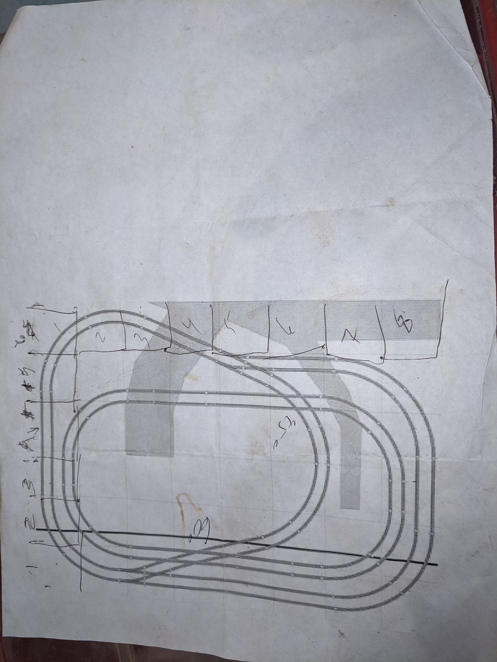

 Posted - December 07 2021 :  12:19:16 AM Link directly to this reply  Show Profile  Add Chops124 to Buddylist
This is one idea I am thinking about. What appeals to me is the relative complexity within a simplistic
format. The main drawback is being 8' x 6'. That makes for an average reach of 3', which is pushing
the limits. Putting in an access hatch is not something I want to even consider, crawling around on
cement is for the younger generation. I've done my share.
 Posted - December 07 2021 :  9:05:49 PM Link directly to this reply  Show Profile  Add RP model railroads to Buddylist
Cool trackplan, Chops. But accessing the center of the layout for scenery or updates will be challenging....like you mentioned - unless you use a stepladder of some sort.
 Posted - December 08 2021 :  1:05:36 PM Link directly to this reply  Show Profile  Add Chops124 to Buddylist
Yeah, I think you're right: step ladder.

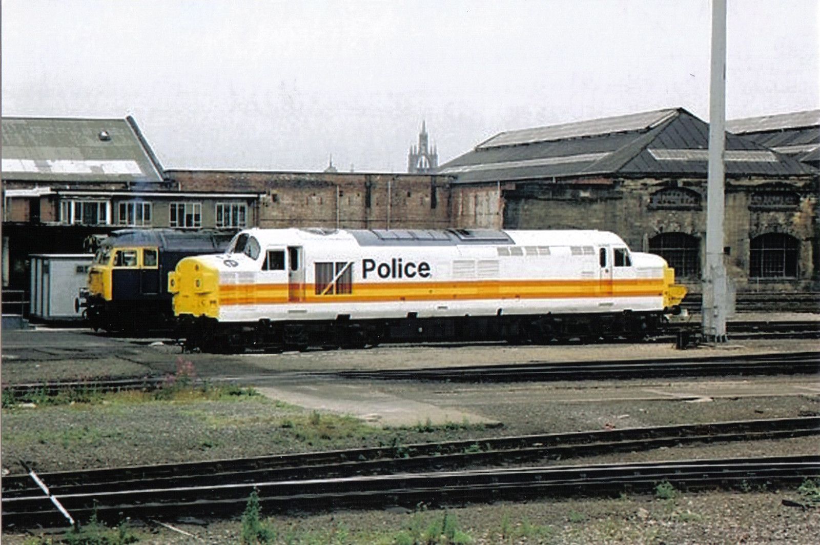

 Posted - December 11 2021 :  05:24:01 AM Link directly to this reply  Show Profile  Add Chops124 to Buddylist
So, a couple of years ago, Ben posts this British Rails advertisement. I laughed unto tears, as did a great many Britons, I suspect. The ad was so popular, that they actually kept the diesel unit in the police livery used by the advertisement, for some years, running freight.
https://www.youtube.com/watch?v=iN7naLLeB0A
Then, somewhere I heard that there was a version of this:
Which turned out to be by Lima, now part of Hornby, as a limited run. After several years finally tracked one down
and this is my rendition of the brilliant advertisement:
https://www.youtube.com/watch?v=4BPmMjtho5s
 Posted - December 11 2021 :  1:22:44 PM Link directly to this reply  Show Profile  Add microbusss to Buddylist
yeah I WANT ONE!
so jelly-oh-so now
 Posted - December 11 2021 :  11:49:04 PM Link directly to this reply  Show Profile  Add wks to Buddylist
"Yeah I WANT ONE!
so jelly-oh-so now "
Originally posted by microbusss on December 11 2021.
Which one Ben? The train model or the lady model at the end of the commercial.
 Country: USA  ~  Posts: 8117  ~  Member Since: February 12 2014  ~  Last Visit: November 18 2026 Alert Moderator  Go To Top Of Page
 Posted - December 12 2021 :  11:09:36 AM Link directly to this reply  Show Profile  Add microbusss to Buddylist
"Yeah I WANT ONE!
Originally posted by wks - December 11 2021 :  11:49:04 PM
the Police loco!! *Grabby Paws!*

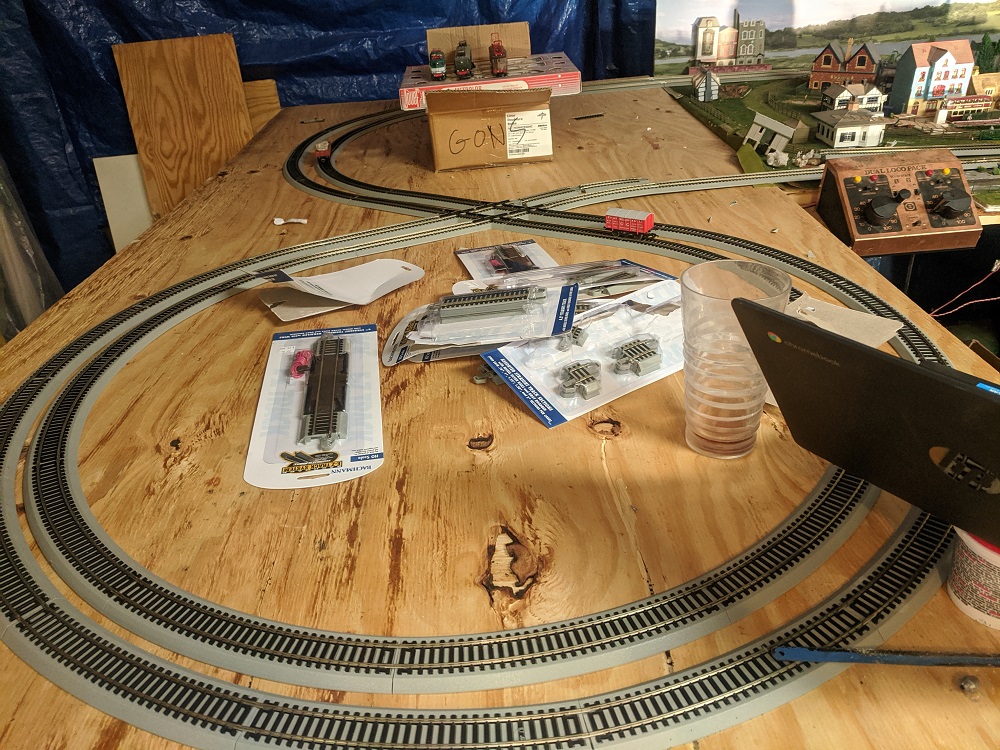

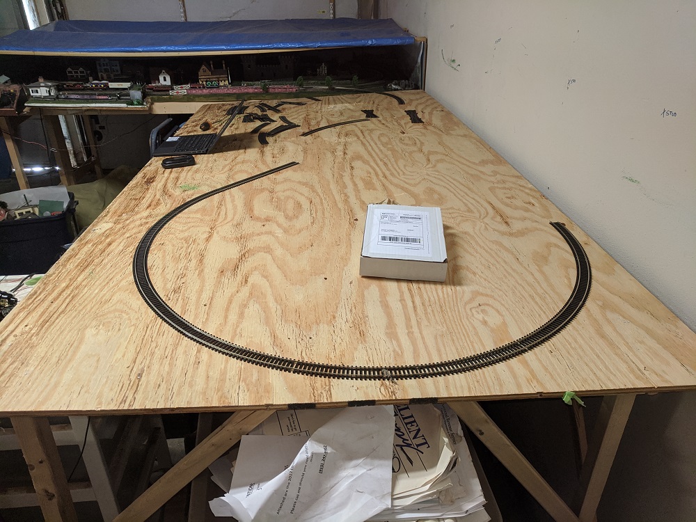

 Posted - March 20 2022 :  2:50:13 PM Link directly to this reply  Show Profile  Add Chops124 to Buddylist
Henley's Big Expansion
The old Henley, or Ye Olde Henley, if ye prefer, is the 4x8 covered with the blue tarp in the center.
Having discovered how useful Bachmann EZ track is, I went from a modest expansion of maybe
two feet by eight feet to adding on two 4x8's. The two boot legs will feature double track that will
fold over on themselves to reconnect to Henley proper. Additionally, a point-to-point branch line
using the excellent Bachmann automatic reversing track is planned. If I can relay the wiring in
such a way, the branch will cross the mains at different points, requiring additional attention from the
operators.

 Posted - March 21 2022 :  7:48:10 PM Link directly to this reply  Show Profile  Add Chops124 to Buddylist
You read my mind, Jward. I am always amazed when I see British modellers
do that. I need to either get low and have the rail line get on top, or gain
elevation and climb up to it. I just can't see a way in.
Any suggestions?

 Posted - March 27 2022 :  12:08:19 AM Link directly to this reply  Show Profile  Add Chops124 to Buddylist
That is an interesting thought, JWard. This evening I struggled to get the baseboards up on the tables
and up on the concrete blocks to align all the heights as near to exact as I could.
The thing with a high line is that I have planned a complex junction consisting of 4 level diamonds
on the right, and four on the left. That, and I run a number of passenger trains, which is a lot more
done in the UK than in the US, and this may cause challenges for which I care not to trouble shoot.
But I need to take your idea and dwell on it, as sometimes the answer reveals itself, and viaducts
are of great fascination.
I tried downloading AnyRail to my work lap top, and it went in easily enough, unlike this desk top that
I am now working on. The vexing problem is that I cannot, not, not, not find my way into the index page
that allows one to set up the initial parameters. Probably something stupidly obvious, but for love or
money I cannot see it. Will need to take some photos of what I am seeing and get some advice, that way.

A couple of design elements:
1. No turnouts, yet. Eventually, maybe. Bachmann turnouts have a sketch reputation for starters, though I think this can be traced to a floating guiderail from improperly fastened rivets. I'll throw myself off that bridge when I come to it.
2. Convential wisdom is the more complex a design, and the more turnouts, the more interesting it is to run. From the club's layout I gradually learned that too many turnouts leads to too many derailments and too many electrical issues and can be so confusing that people just end up safely running in giant circles, which is a little tedious, sooner or later.
Thus, there are two junctions composed of a total of eight sixty degree crossings. This means two operational main lines will need to clear the junctions with the operators paying attention to a. priority of his train, b. speed of his train, c. and where he needs to be to avoid a delay, or worse, a collision. This is going to keep it interesting.
3. I don't care for carpentry. Some people do and are quite good at it. For me, I never liked it, and my results were OK, but not show stoppers, other times I got sagging and warping that made reliability very hard. So, with this, I got a couple of 3' x 6' folding tables and tossed 3/4" plywood slabs on top. That's it. Doneski.
The EZ roadbed absorbs all but the worst of variances in surface.
This layout will feature trains of differing vintages, but mainly, what I now know is that they will all run smoothly and strong without annoying derailments (OK so I stink at laying track) and peculiar stalling (my track is clean, but little warps cause big gaps in conductivity). It is the reliability factor that allows me to move forward with this Big Enchilada.
4. I don't enjoy wiring, either. Two leads for the entire set up. For now. That's it. Doneski.

 Posted - May 04 2022 :  7:09:54 PM Link directly to this reply  Show Profile  Add Chops124 to Buddylist
Put in the Golden Spike today. After all was said and done, I only ended up short two nine inch straights and
two fitters, all of which I was able to get from spares.
The area on the right will make for a useful passenger station and perhaps a goods yard, all of which will be in very accessible. No more reaching or scampering to throw turnouts. The low speed shunting spurs should be fine for the Bachmann #4's.
Also yet to come is a single branch line, point to point, that will bisect all the mains from one end to another,
using the Bachmann Auto Reversing track. That stuff works really, really well. A small RDC will perambulate back and forth, just enough to screw up through traffic on the mains. This will require at least another four crossings if I do it like that, or maybe just separate it from the mains, anyways. Got plenty there to keep me and another engineer very busy.
The wiring for this is gong to be the epitome of simple. Two short feeder wires to two terminal tracks, period.
Not going to do any grades, either. For one thing, I've got a couple of single wheelers that can barely drag three coaches on the flats, let along any gradient. Second, grades use up a lot of real estate. Three, if not done perfectly, grades cause a lot of derailments.
At the very, very most I might put in a viaduct along the back wall to run the branch line, but no rush on that.
To secure the roadbed to the baseboard? Nothing. Experience with Jimmy's layout demonstrated that not only is this unnecessary, it can create all kinds of surprising problems, such as nail heads working themselves up and fouling couplers. No thanks. The track has a certain heft to it, so nailing stuff down is not called for.

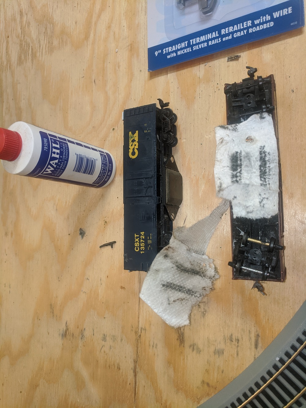

First surprise came in that the outer line, which is laid to a 22 inch radius, would be become the inner line, before re-emerging as the outer line gain, which initially made me wonder if I had somehow contrived to mislay the track. No, it just does that. Having tested my long passenger coaches on Jimmy's 18 inch radii, I have no fear that it will run perfectly well.
The next run was using a double headed track cleaner car, one to lay down Wahl's Hair Clipper Oil, and the trailing car to wipe off the excess. Again, no problem, and these cars love to derail and foul because of the cleaning pads.
Well, enough for one night. Take a siesta and have at it again in the morning.
