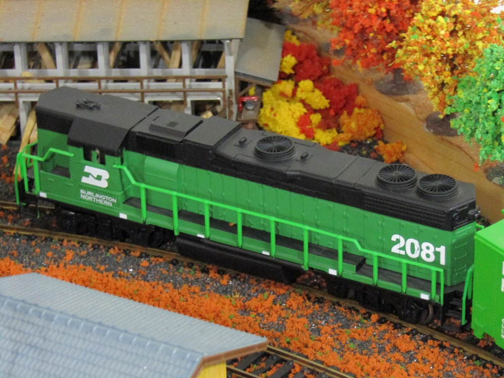

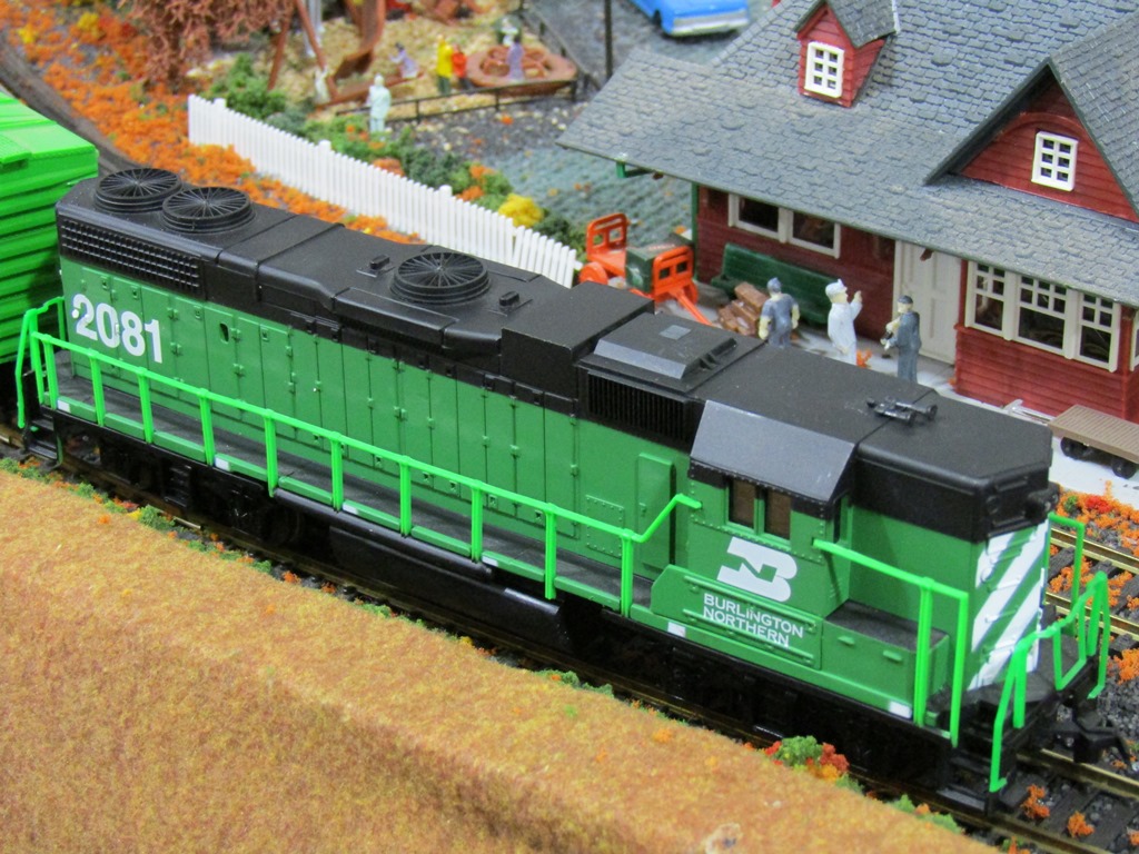

 Posted - January 03 2021 :  08:47:32 AM Link directly to this topic  Show Profile  Add RP model railroads to Buddylist
My LOTW offering is this LifeLike Burlingtion Northern GP38-2 "High-Hood" diesel.

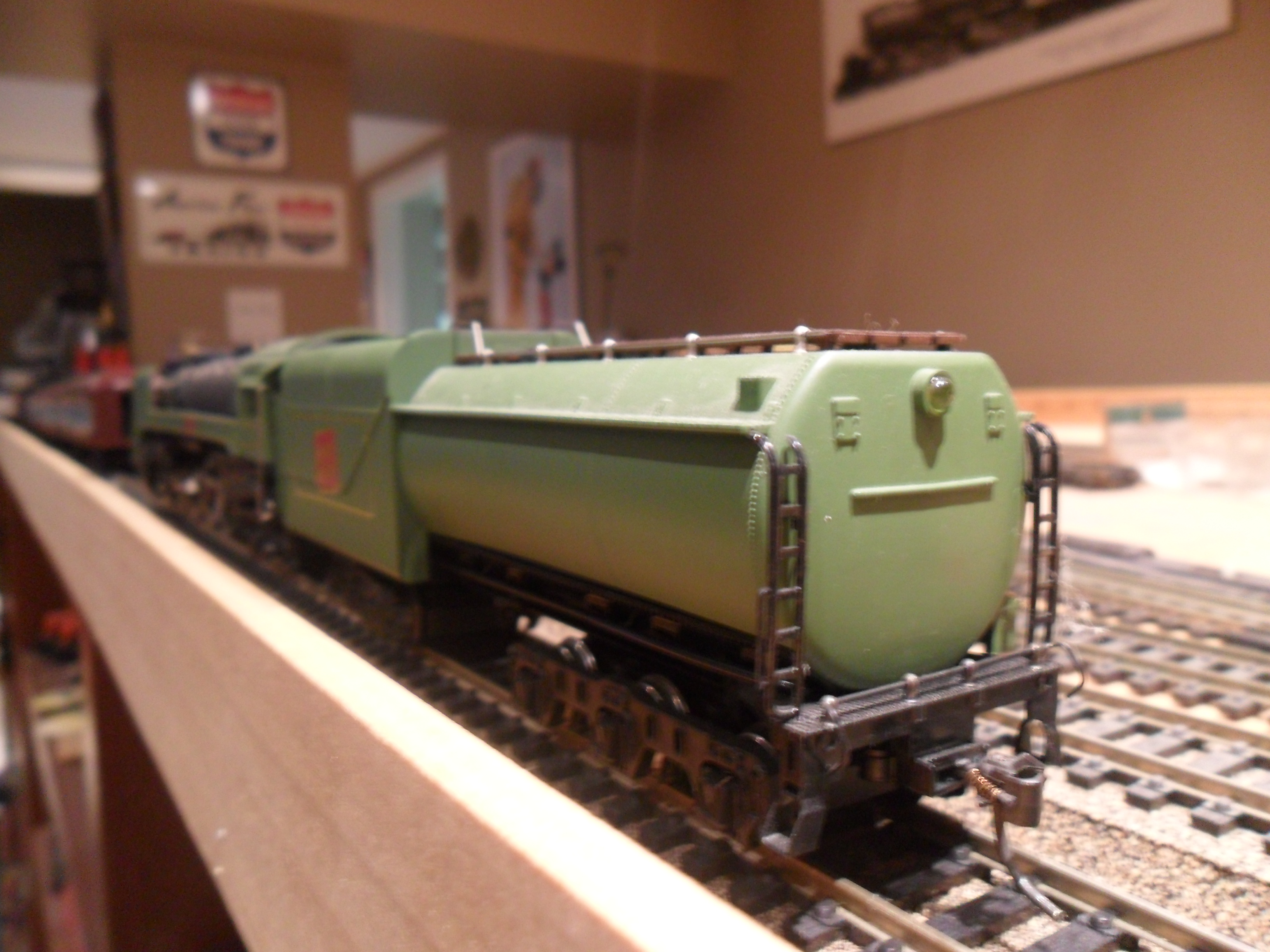

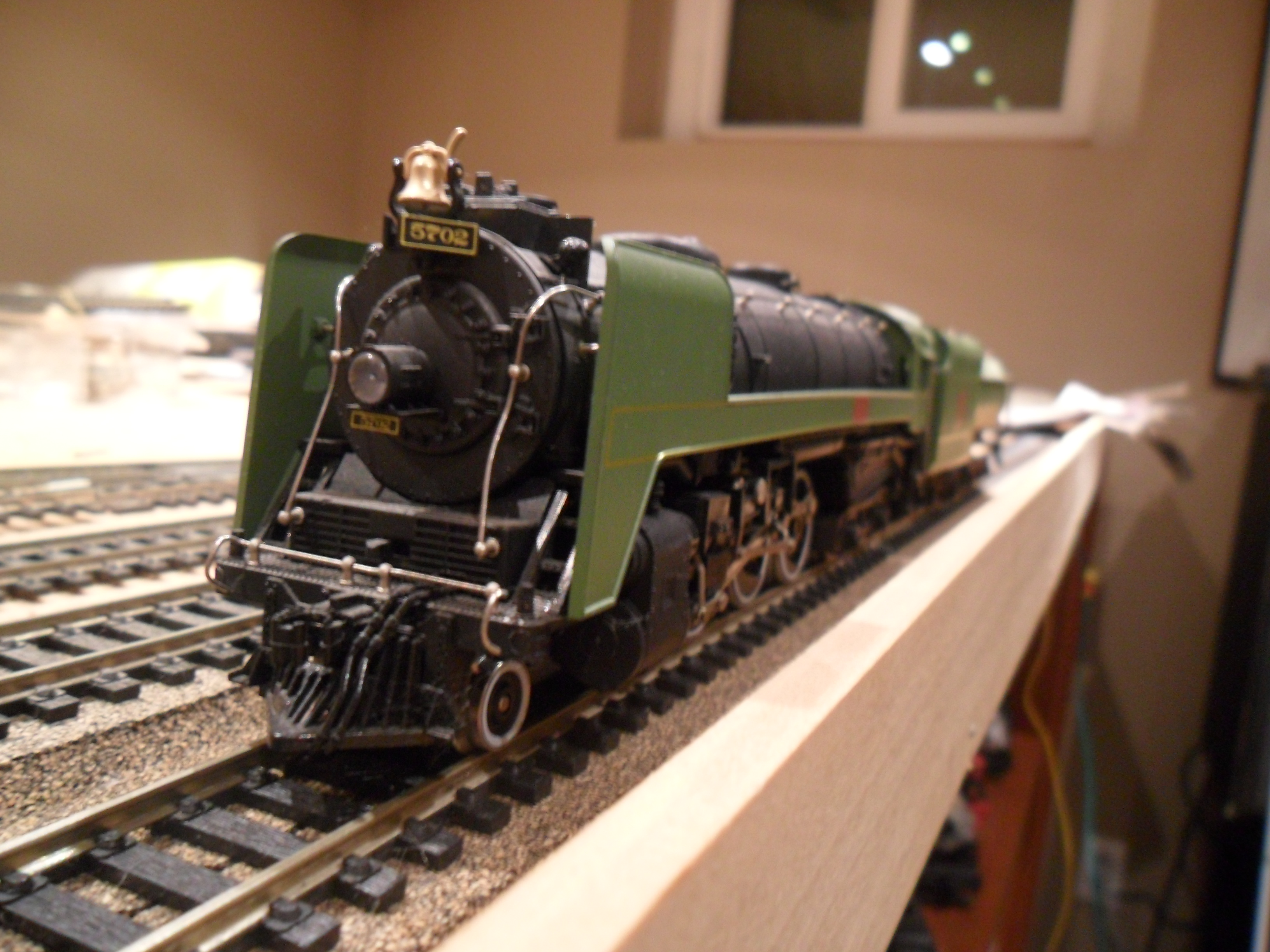

 Posted - January 03 2021 :  10:03:49 AM Link directly to this reply  Show Profile  Add A-A-RON to Buddylist
My LOTW will be my new Bachmann HO 4-8-4 Northern I recieved in a trade from RP. This is one of the nicest Bachmanns I've ever seen truthfully. This locomotive runs flawlessly, and actually features a functioning smoke unit. Thank you RP, as this is a fantastic addition to my roster.

 Posted - January 03 2021 :  3:35:39 PM Link directly to this reply  Show Profile  Add A-A-RON to Buddylist
I opened the bottom up and checked it. I have a cracked axle, so down the road I'm going to either have to repair or replace it. I can probably figure it out though. I just won't run it too hard. I'm guessing I can fix it though.

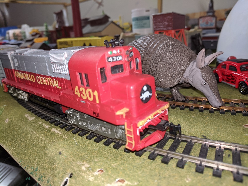

 Posted - January 03 2021 :  5:04:05 PM Link directly to this reply  Show Profile  Add Chops124 to Buddylist
Fresh from the Anderson Paint Shops, a C430 blows into town. Armadillo Central, dontcha know.

A strong glue can usually fix the problem, RP repaired his consolidation by gluing them back together. There are also replacement axle centers on shapeways
 Posted - January 04 2021 :  9:00:37 PM Link directly to this reply  Show Profile  Add RP model railroads to Buddylist
Originally posted by BlaxlandAlex3-January 04 2021: 3:16:26 PM
Yes, Testor's Liquid Cement (which I basically use for everything) worked perfectly on my Bachmann Consolidation -- all you have to do is put a little drop of glue on the crack, and then spread it over the entire crack with a brush, and allow to dry. "Capillary Action" will draw the glue into the crack and fill it best, thru brushing it.
All you have to do afterwards to make sure the wheels are "quartered" properly.....before putting the bottom plate back on.

 Posted - January 04 2021 :  9:38:31 PM Link directly to this reply  Show Profile  Add A-A-RON to Buddylist
Yeah. I have a tiny Crescent adjustable wrench to remove the bolts on the driver with. I just have to find time and place to store a dismantled engine for a day.
