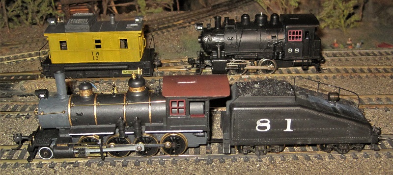

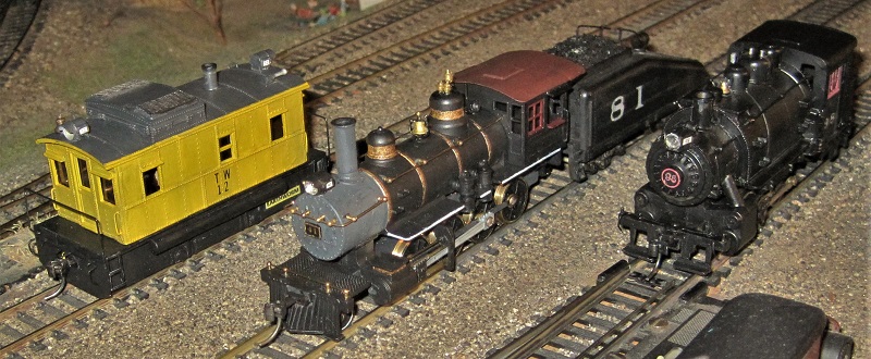

With the local swap meets cancelled for the COVID-19 lockdown, I didn’t have new projects coming from new purchases, but had a hankering to tinker with a project. In the various parts boxes were bits and pieces of incomplete locomotives. Why not cobble them together into something.
An old Marx power truck became the heart of a boxcab diesel whose shell came from old caboose bodies. I had ignored that power truck because the gears didn’t mesh properly. One of them was a bit cracked, and I blamed that, but it turned out to work okay with a little shim under the motor.
I had bought the broken hulk of an MDC Old Timer Consolidation to scavenge the motor from it, but then I took it as a challenge to see if I could get it to run. A little fitting and filing made a stiff mechanism move more or less freely. The old motor I replaced with the one from this engine could be coaxed back to life. The broken cab could be patched up and a variety of missing and broken detail parts were replaced. I had an engine, but not a tender. Pending something better, an old slope back tender was borrowed. It looks odd on what is basically a mainline engine, but it’s been done in real 12 inch to the foot railroading. When swap meets resume, I’ll have an eye out for something more normal looking.
Left over from another project was the chassis of an 0-4-0T. I also had bits and pieces of various locomotive shells, one from a saddle tanker and another with the smoke box I needed to lengthen the tank engine shell. Some cutting and pasting with some added detail parts gave me a complete locomotive.

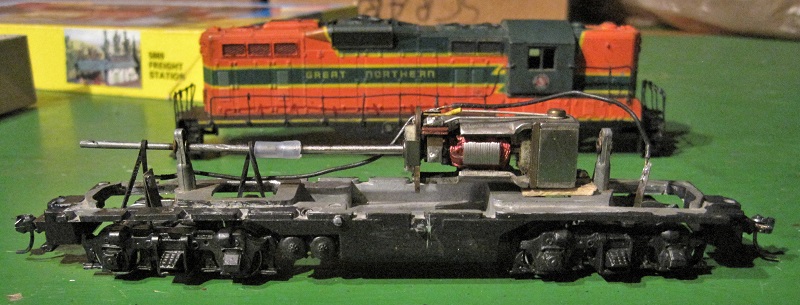

As a kid I got an old Athearn Hi-F GP7 from a friend who was getting out of model railroading. It was missing the motor, the hand rails and one horn. It sat around in a box for decades, while I occasionally thought of powering it. I never had a narrow enough motor with a shaft at both ends, but I did have a narrow motor lying around. That, a bit of steel shaft, some model airplane fuel line and some Goody's hair bands made a cobbled up drive for one truck. There was not enough traction for the drive bands on just one shaft, so I coated it with a little Shoe Goo. Couplers were broken, so I cobbled up the mounting for some Kadees.

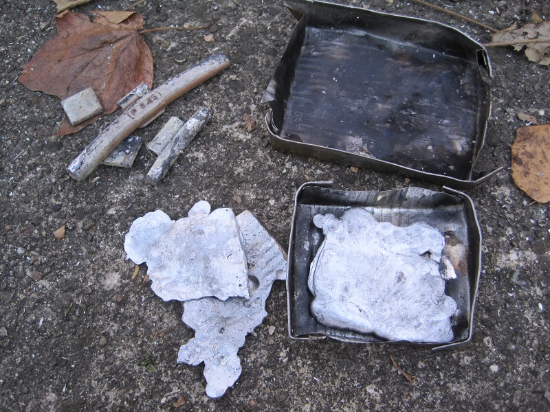

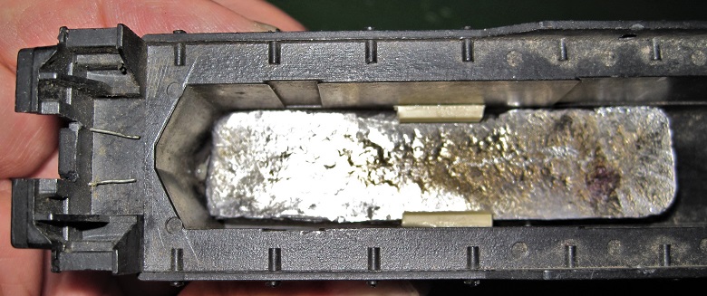

Now, with enough traction in the drive, it could slip its wheels. There was a space 3/4" x 3/8" x 3" in the hood above the drive. If I could cast a lead weight, perhaps the engine would have traction enough between wheel and rail to get out of its own way. Odd bits of lead from tire balancing weights, fishing sinkers and whatever else I could find were put in a steel can and melted in a fire. Here, you can see that one weight turned out not to be lead, but there was enough in the pour for the weight, plus a little left over. Tip: The lead will only melt if you fan the fire.

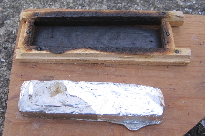

The mold was a wooden form, lined with aluminum foil. The wood scorched a bit, but held up okay.
Leftover lead was poured into flat steel pans to make slabs that could be cut into more weights. Candle soot served as a mold release. Metal that was not lead, but had been mixed in was fished out.
A couple blocks of plastic, glued inside the hood, hold the weight in place.

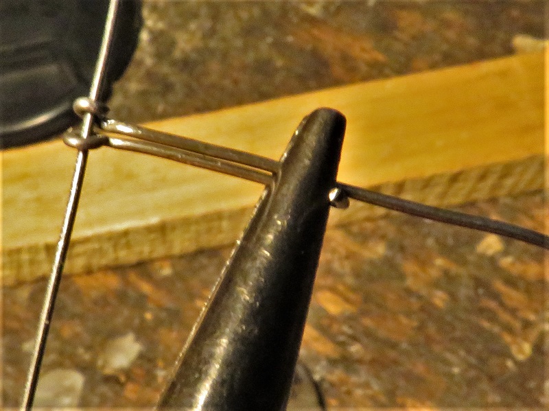

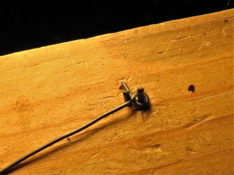

As a kid, I'd bent some railings out of tinned copper wire which was too soft and the results were not good, so I set about making stanchions for a new set on this jig. The two pins (track nails with heads removed) brace the wire for a tight loop and reversing curve to hold the railing.

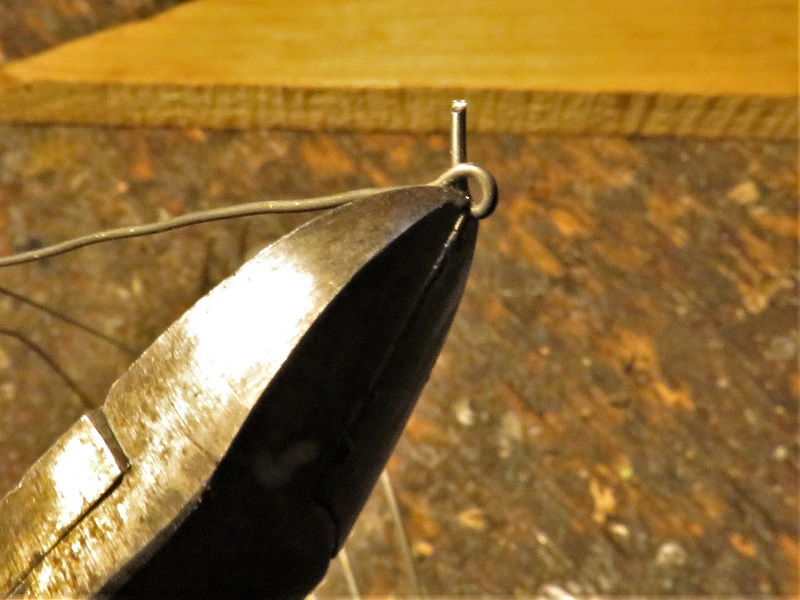

The excess wire from the end of the loop is cut off.

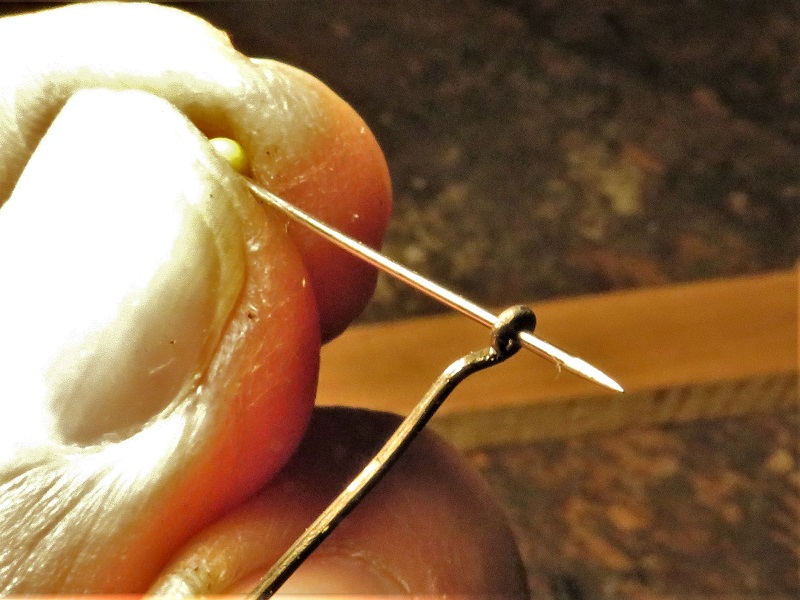

The loop is squeezed down to the diameter of the railing around a straight pin.
One finished stanchion serves to measure the bend for the rest, so they're all the same height (more or less).

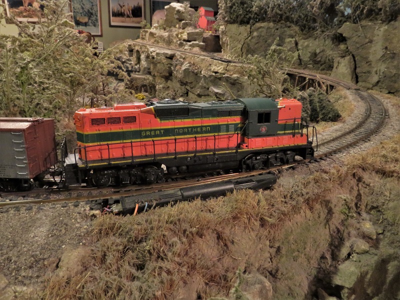

New railings are bent from piano wire for better stiffness and the railings and stanchions are installed. Seen close up, they kind of reek of home talent, but at a casual look, they give the sense of railings present. Painting them black helps make imperfections less conspicuous.
That gleaming horn sticking out the front of the cab is turned from a brass sprue off of a cast detail part. I don't think that the Great Northern ever mounted horns this way, but it's how they were on the really old Athearns.

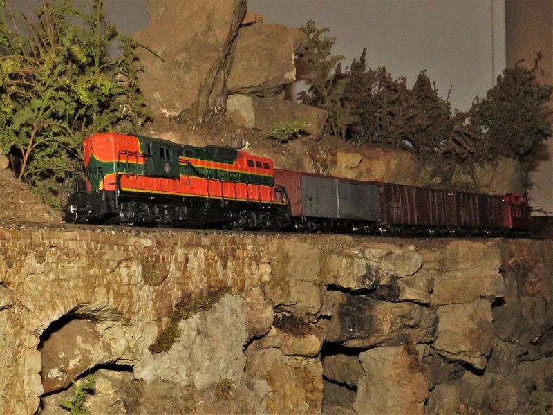

It's pulling a short train, but with only one truck powered three cars and a caboose are a real load on the ruling grade of the torture track. Compared to a geared drive, it's not a very smooth or powerful runner, but the tinkering was fun, and just for the sake of doing it, I've sort of wanted to do this for years.
