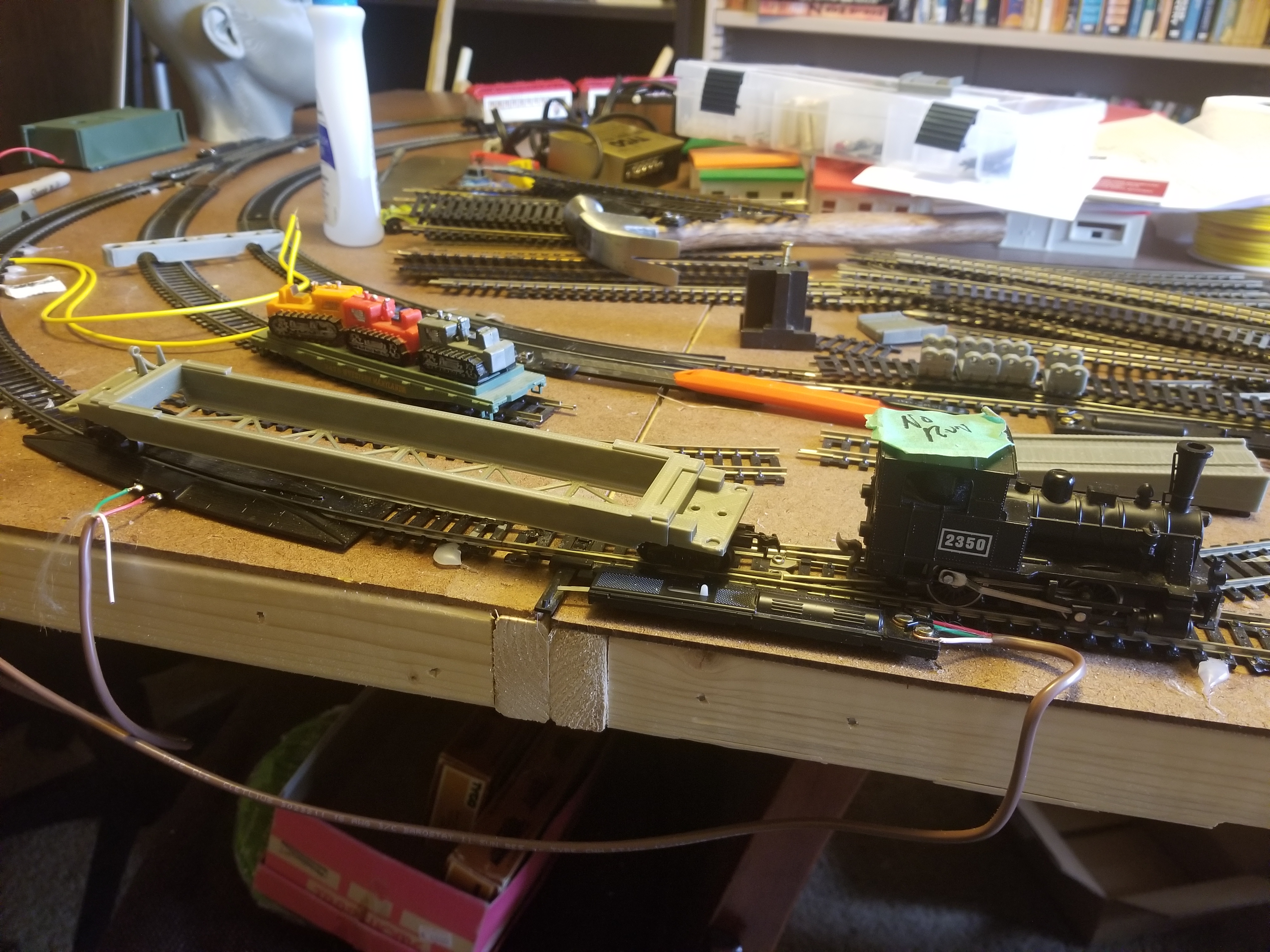

8 hour print, about $1.00 in materials
model link https://www.thingiverse.com/thing:670492/files
I asked "what is this car called" in another subforum because I wanted one as we have a number of them on the local tracks often
very nice model, maybe light on fine details, but that makes the overall model print better
currently printing the shipping container. 6 hour print, about $0.75
I have numerous stuff being delivered today including ebay auction lots of "stuff" that might have trucks that I can scavenge for this
(all pics upload at large resolution so you can click on them and get really good closeup views of all the dirt and dust on my layout)
meant for screwed in trucks, have it sitting on tyco trucks, might drill them out to fit

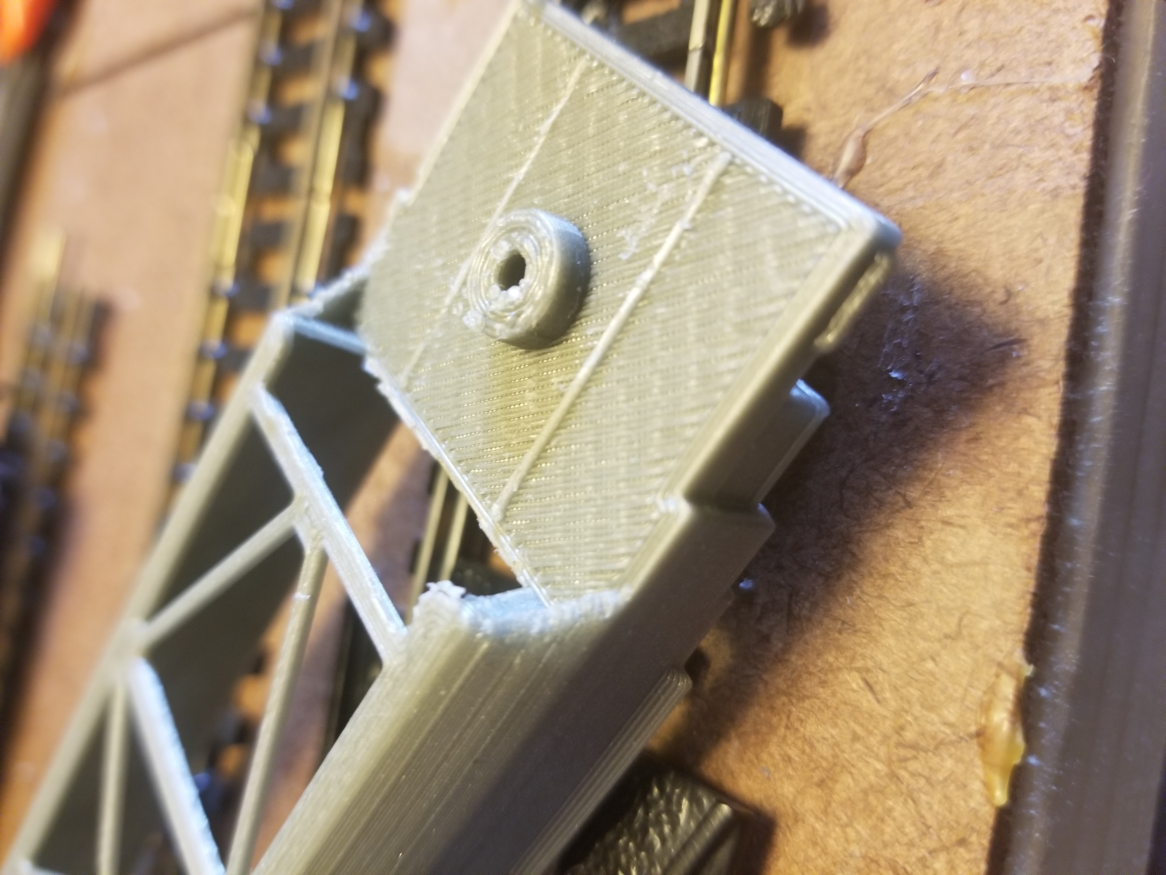

worst details here, all on the underside so you wont see them unless you look real hard. a superb model tweaked for printing
then again, I expected this to print uglier than it did nothing was supporting this, these parts were layed on as you see them

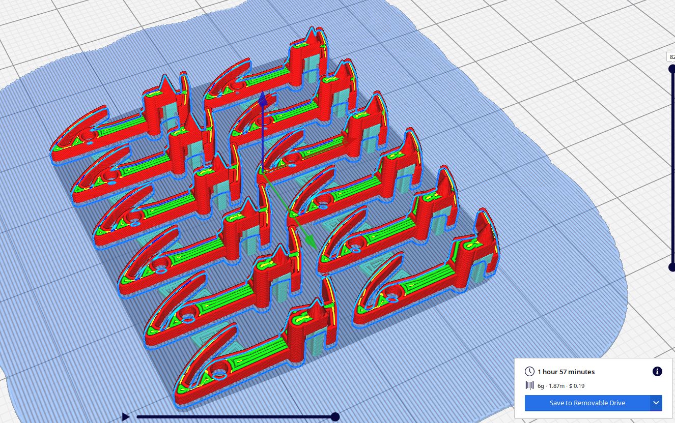

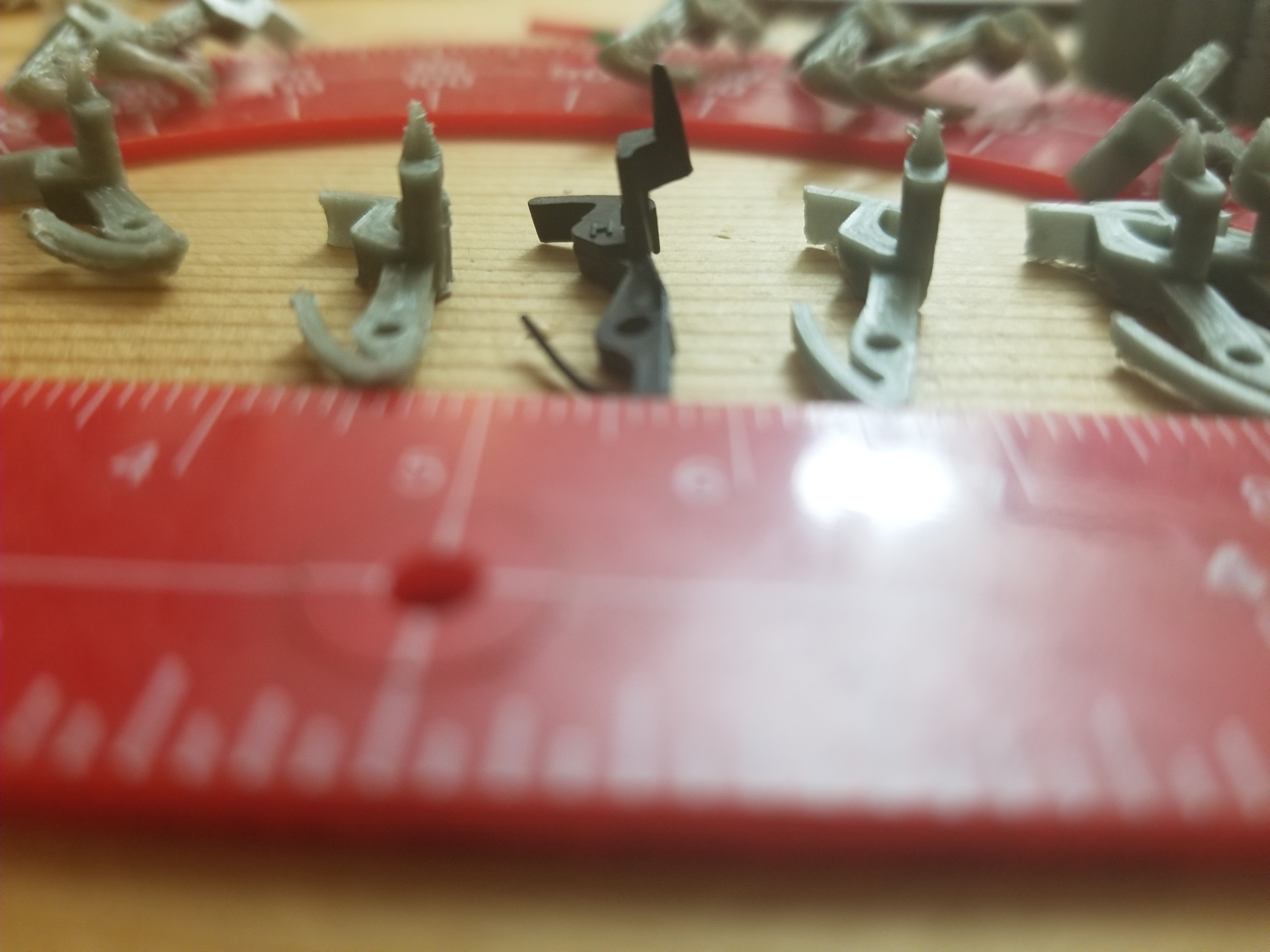

the tyco hook STL file I have is printed (with .1 layers and .4 nozzle)
the springs are too long
the main body is too narrow
the hole fits
and it does couple, but real stiff
I am going to need to scan and redesign it
ordered .2 nozzles for my monoprice v2, which I've been planning on making a dedicated fine parts printer, as it is direct drive and works well once the frame is properly adjusted(it flexes every time i move it)
I have .2 nozzles for my cr-10 mini, but I like keeping that one for quick printing
but the sunlu s8 might be replacing it

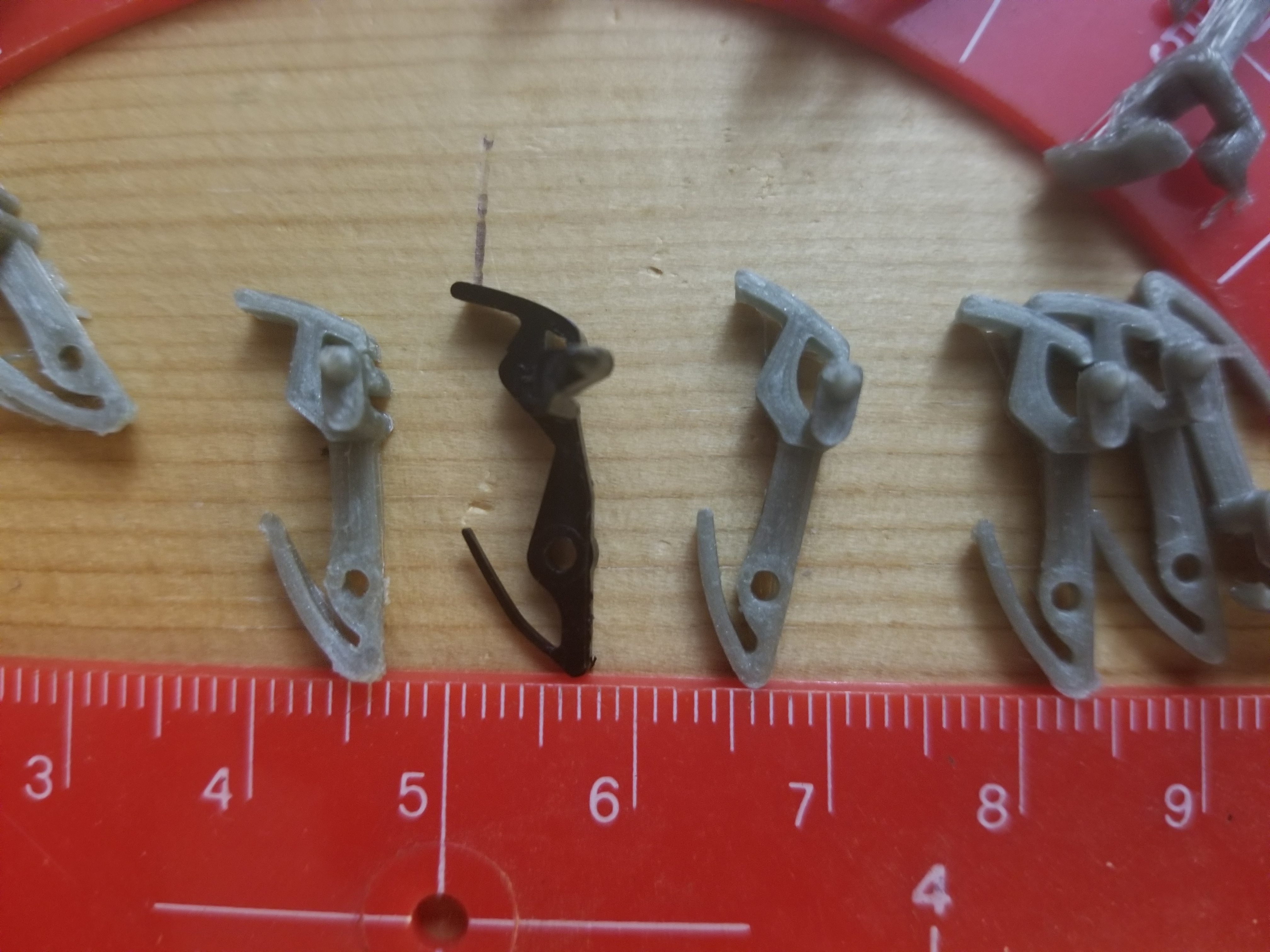

no, I am pretty sure it is because of the wrong thickness where the hook fits in the pocket
so yeah, measure, replicate, and alter in fusion 360, print, test, adjust, reprint
the springtail inthe model I found is thicker/stiffer than a normal horn hook, but i think the difference in plastics makes up for it

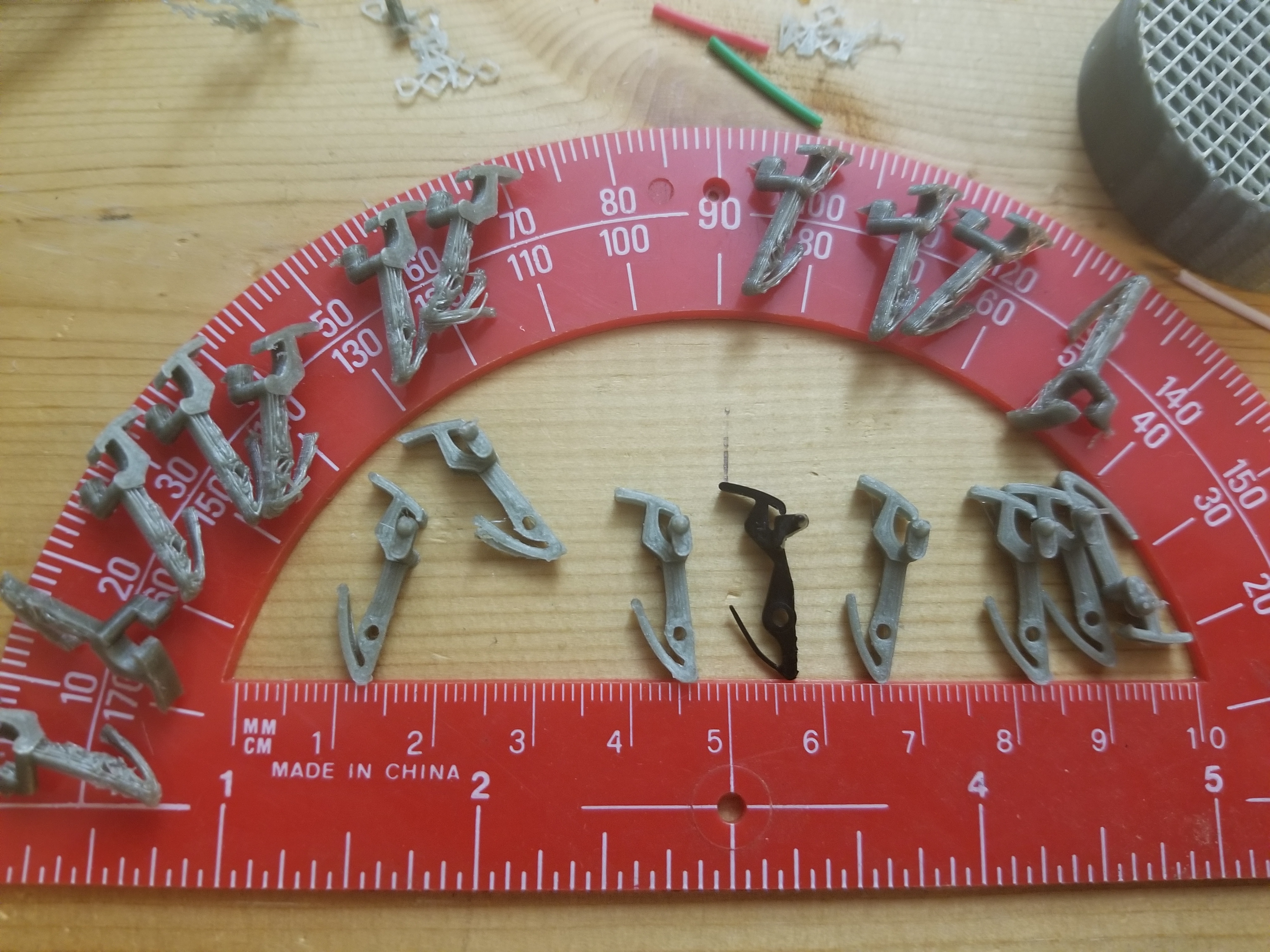

heck, lets have some pics
left is what is called printed on a raft, right is printed with a brim
the ones on the raft had rougher top surfaces, but the springs on them came out better, I thinkI am going to print that way from now on for tiny parts
black is a tyco hook for reference
now to confuse you, the ones on the left are printed with a brim, see the nice glass smooth tops of the hooks?
(click for stupid-high level zoom)

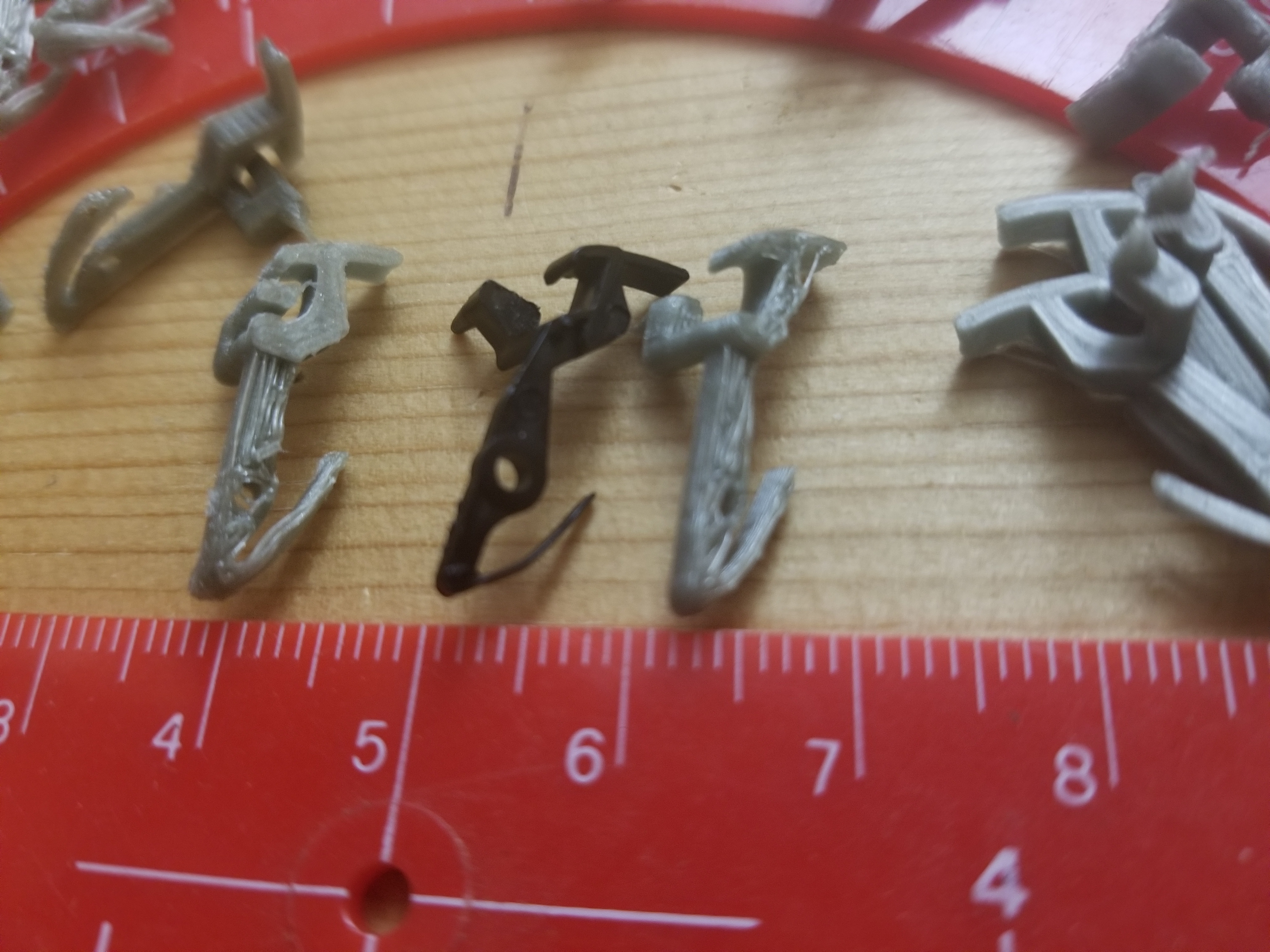

the ones on the right are on the raft, notice how all of them got rough spots on the tops of the part that goes into the pocket, that is what is snug, and not easy to sand at this size
notice the springs in the hooks in the upper left
extreme close up notice the one on the right has a more consistent shape on the spring
also notice the decoupler peg is not in the right spot? try to run that thru a decoupler
end view, look off?
other side, nice and close, you see that the top of the hook is a different level than the rest of the part, this causes a mess as can be seen, it'll be one of the spots I experiment with in design

The couplers look surprisingly good for a 0.4mm nozzle.
 Posted - November 04 2020 :  08:51:29 AM Link directly to this reply  Show Profile  Add RP model railroads to Buddylist
I see what you mean regarding the couplers, and that more trials are needed. But so far, so good.
 Posted - November 04 2020 :  08:52:55 AM Link directly to this reply  Show Profile  Add scsshaggy to Buddylist
I think that the bracket that holds the uncoupling peg also keeps one coupler from slipping out the top or bottom of another. I don't know if it's a design feature or just a fortunate side effect.

Again can Plasticville parts be far away?
Originally posted by thesiding - November 04 2020 :  10:36:05 AM
not at all, just need pics with rulers for reference
should also be able to do prototypes, the only issue is that (ummm) the smallest available detail that can be reproduced will be (does math)...an inch?
assume .4mm resolution, times 87 for scale, then divide by 25.4 to get inches
that sounds wrong. I would guess that 3-5 inches might be the smallest detail you could see. 1 inch would mean that you could print a face and have the ears show, and I know that is hard to do at 64 scale (d&d figures)
how big are sharknose air horns, the skinny bit?
 Country: USA  ~  Posts: 170  ~  Member Since: October 09 2020  ~  Last Visit: October 12 2026 Alert Moderator  Go To Top Of Page
 Posted - November 04 2020 :  2:28:01 PM Link directly to this reply  Show Profile  Click to see DaCheez's MSN Messenger address  Add DaCheez to Buddylist
What parts are you looking for? Details like doors and window frames could be handled by the current generation of home resin printers. Larger stuff like walls and roofs could be done on FDM printers with a slight loss of detail. For instance, if one wanted to reproduce the walls of the Plasticville Motel it shouldn't be a problem. The printer likely wouldn't be able to capture the dimpled effect that the original walls have, but otherwise the dimensions would be the same. An FDM printer could probably do the windows and doors as well, tbh.
For reference, here's an HO scale bus done entirely on an FDM printer. Note the detail of the doors. It isn't perfect, but the small windows and gap between the doors came out fine.
