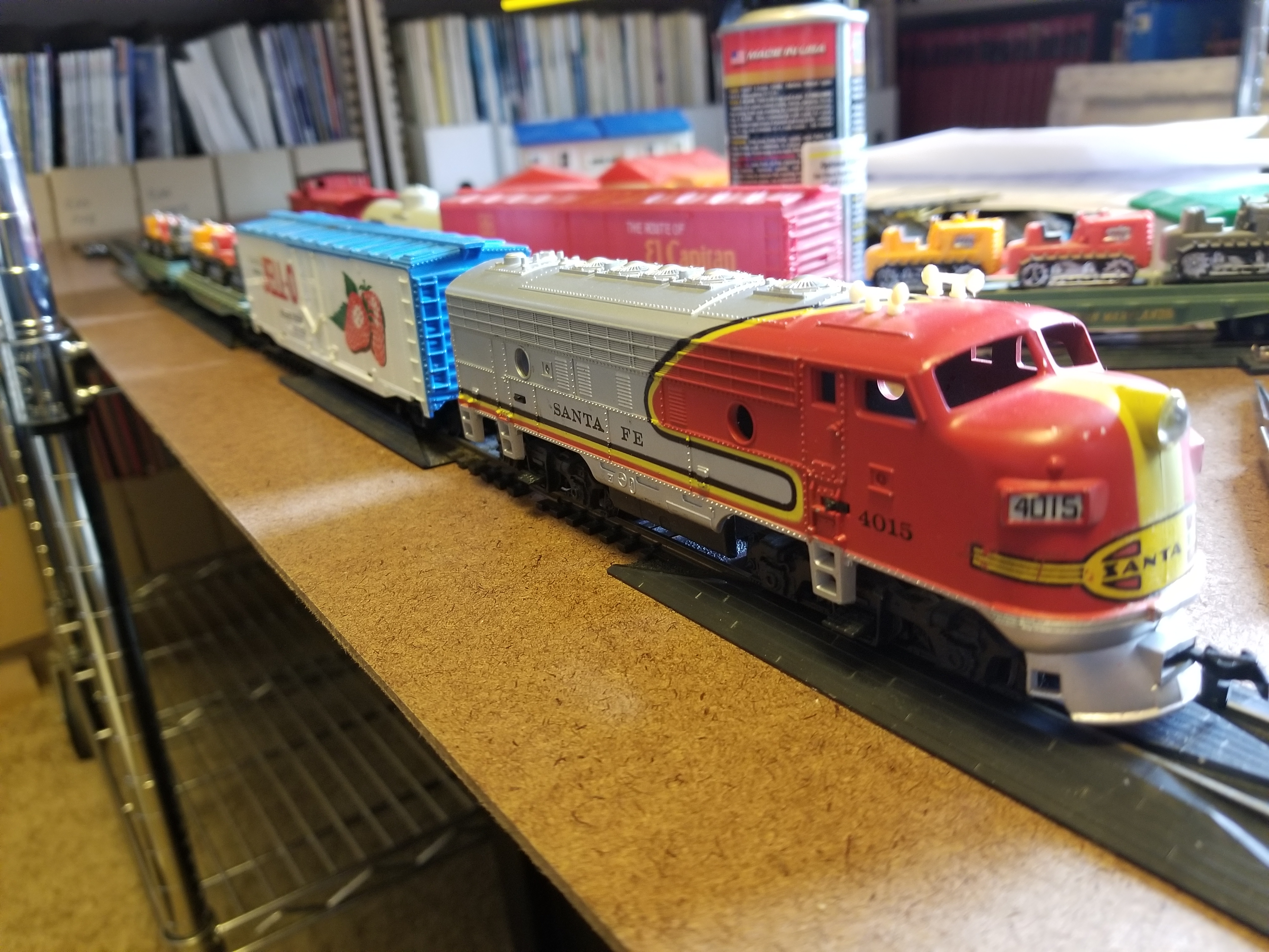

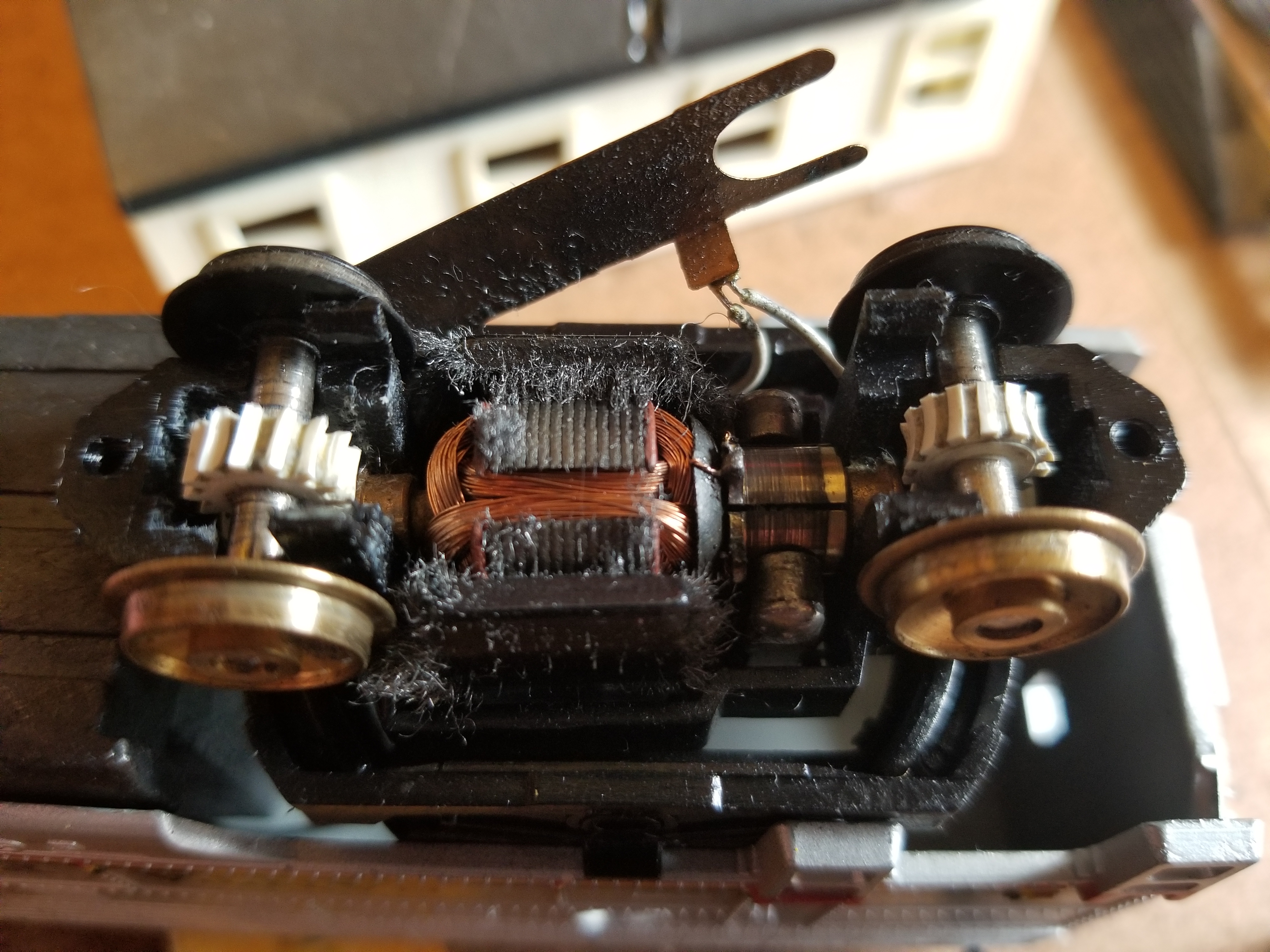

I got the f9 pair, powered and dummy

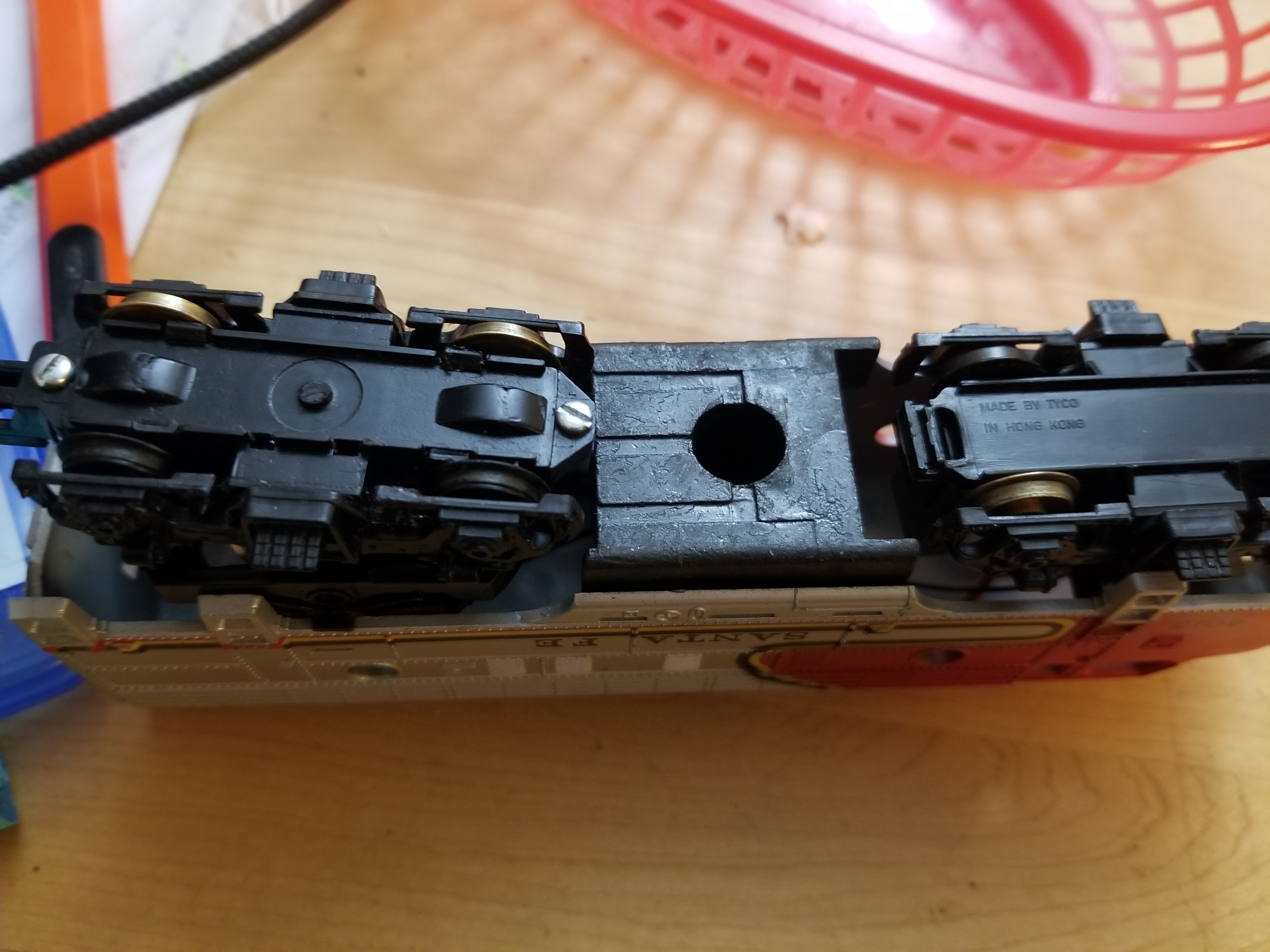

why is the dummy weighted?

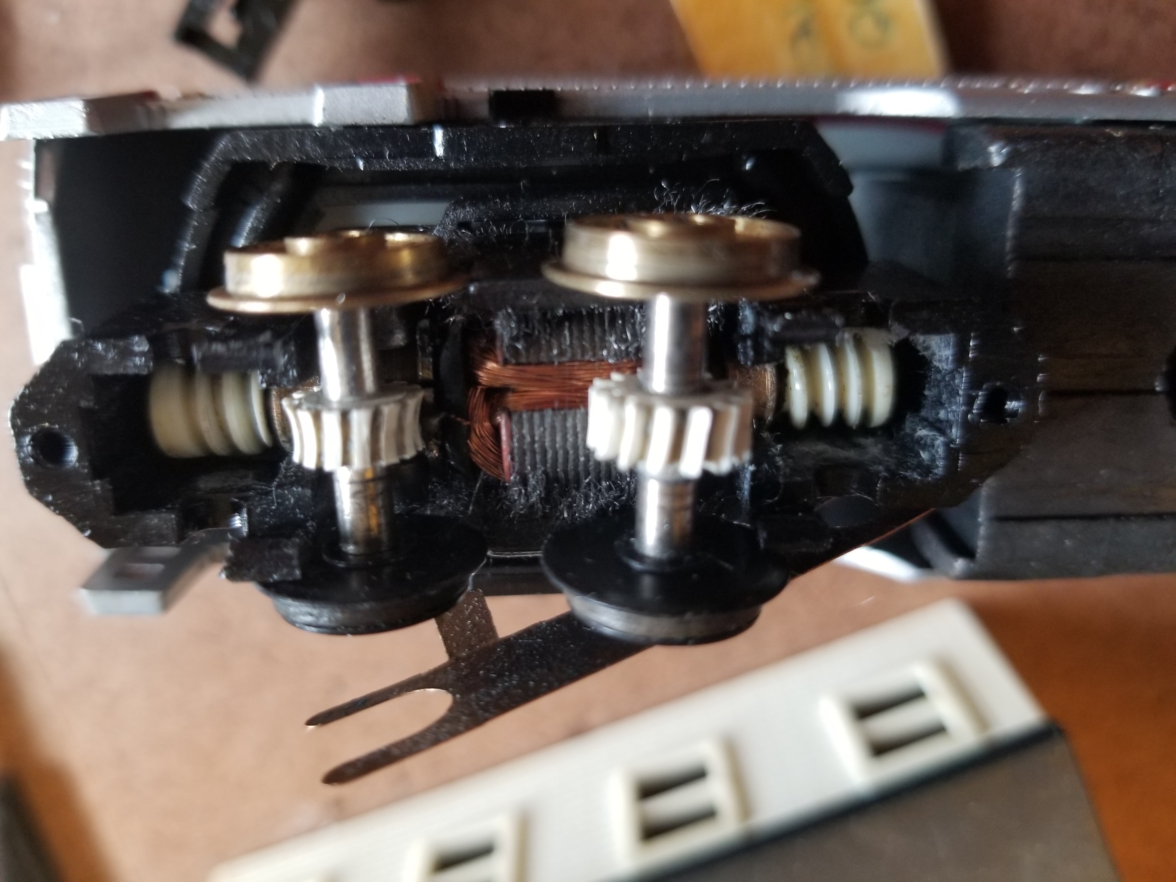

the powered has a stripped axle gear, what's the best option, keep the rest as parts and grab another f9 or are axles a thing that can be gotten, anything special about them?
I also need to get some track joiners and car couplers (let me play with the stock tyco ones first, then preach kadee later), anything to look for or avoid(aside from stock tyco couplers, see previous parenthesis)
online or hobby shop? I'd prefer online until a vaccine is out

The dummy is weighted, or extra weighted by its former owner, to keep
it from falling off the track, particularly through curves and switches, when
the lateral forces pull hardest upon the flanges.

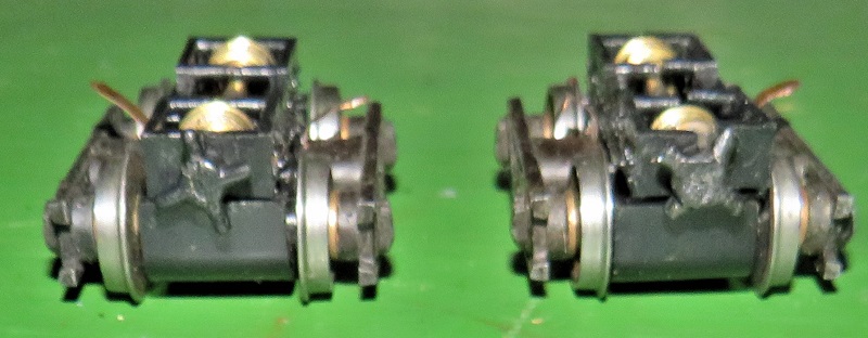

Tater, here is a pair of split gears, the gear on the upper right, if you look close, has a crack in the
barrel, which then allows it to slip freely upon the axle with the worms on it. Trying to seal the crack
and get to stick to the axle is impossible, partly because the gear is compressed onto the axle, and
that energy is now released with the crack, and the metal is too slippery to bind with any adhesive. Now,
RP says he gets away by buffing the metal axle, I've not had luck with that, but in theory that could
work. Maybe if the axle was filed so that it created a shelf, that could bind. RP, did you want to weigh in on this?
Junk or scrap, how much do you like to fiddle with things is the question. I was able to take two
undamaged wormed axles and swap them out to make one working unit.

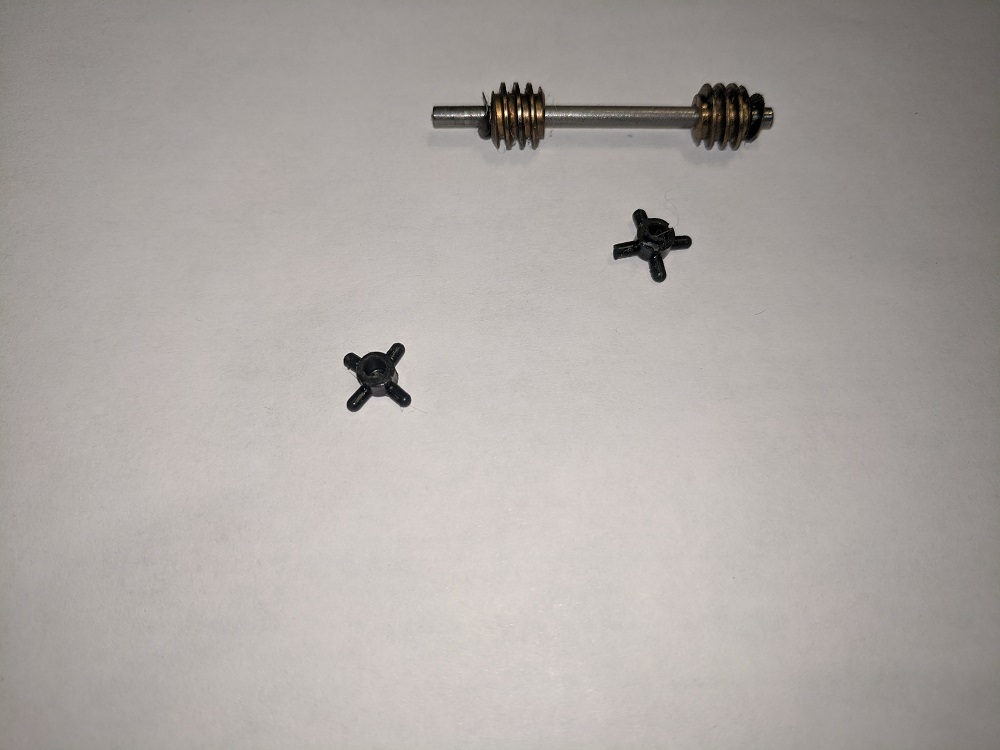

Honestly, I really don't try to do any gear work on my locomotives, and in the event of a Tyco PowerTorque gear popping off, I just liquid-cement it back on, which has worked on several occasions. Not entirely sure how fool-proof it is though.
I also am a fan of horn-hook couplers, and hate Kadee's. I get that Kadee's are more realistic, but I just love the retro look of horn-hooks.
Returning to the subject of gears, different manufacturers had different gear problems, such as Tyco with the notorious PowerTorque pinion gear slip issues. Others say old Bachmanns have problems with split gears, yet I own several vintage Bachmann diesels, and so far the gears haven't let me down.

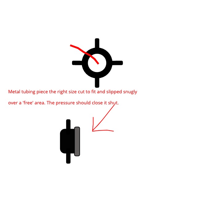

Chops, off topic a bit, try hunting for some metal tubing that fits snugly over the cracked gear. I have seen it done before.
Of course, I can't find the pictures I had seen now, but I'll search a bit more later.
Edited by - BlaxlandAlex3 on October 20 2020 11:57:49 AM
 Posted - October 20 2020 :  12:24:35 PM Link directly to this reply  Show Profile  Add Chops124 to Buddylist
Blax, the shaft on those gears above couldn't be more than a 2 mm. I cannot
imagine what you describe, but then you do some of the most remarkable work around here. I am thinking maybe if I was to take a file and file a
step on the metal axle that could do it, with some JB Weld.
BlaxlandAlex3
Jupiterpfp2
 Posted - October 20 2020 :  1:05:50 PM Link directly to this reply  Show Profile  Add BlaxlandAlex3 to Buddylist
I know, they're pretty dang tiny.
I'm now noticing there isnt a whole lot of free area where you could put the tubing, no matter how thin. Try the JB weld I guess.

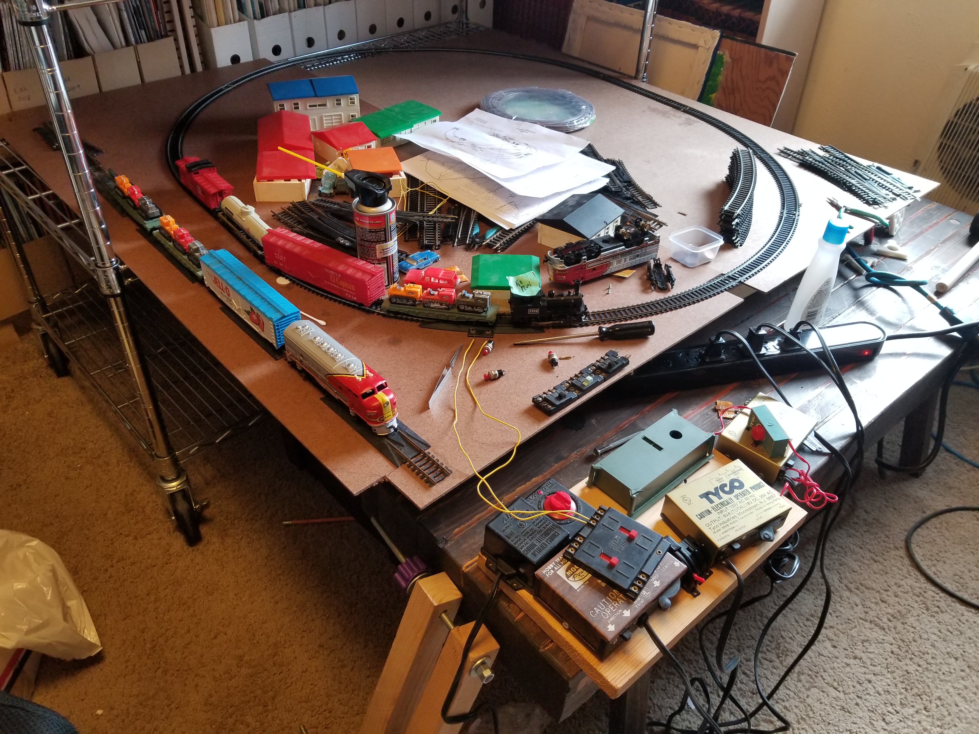

 Posted - October 20 2020 :  2:14:49 PM Link directly to this reply  Show Profile  Add tater1337 to Buddylist
Oh, BTW, we'd love to see photos of anything or everything you get/got.
We love this old junk!!!
Stripped axle gear? Unless it was specifically sold as a junker, I'd demand
my money back. Fixing it is either an interesting project for a guy like
Blax, or a headache for someone like me.
Originally posted by Chops124 - October 19 2020 :  11:45:47 PM
ebay, and I am not going to argue with seller, it *does* run, but only drives one axle. and I got (more than) what I paid for
and I don't mind tinkering
also, replies on here *look* like you think I am talking about a worm driveshaft. I am talking about the axle
pics as you requested
nothing is nailed down, glued or even leveled
dummy engine, bonus cars "parked" dummy engine is waaay to heavy, I'll need to modify
axle pics(right axle is bad, maybe both 2nd pic shows worm axle, might be bad too or poor tolerances)
I DID **NOT** USE STEEL WOOL, IT CAME THAT WAY

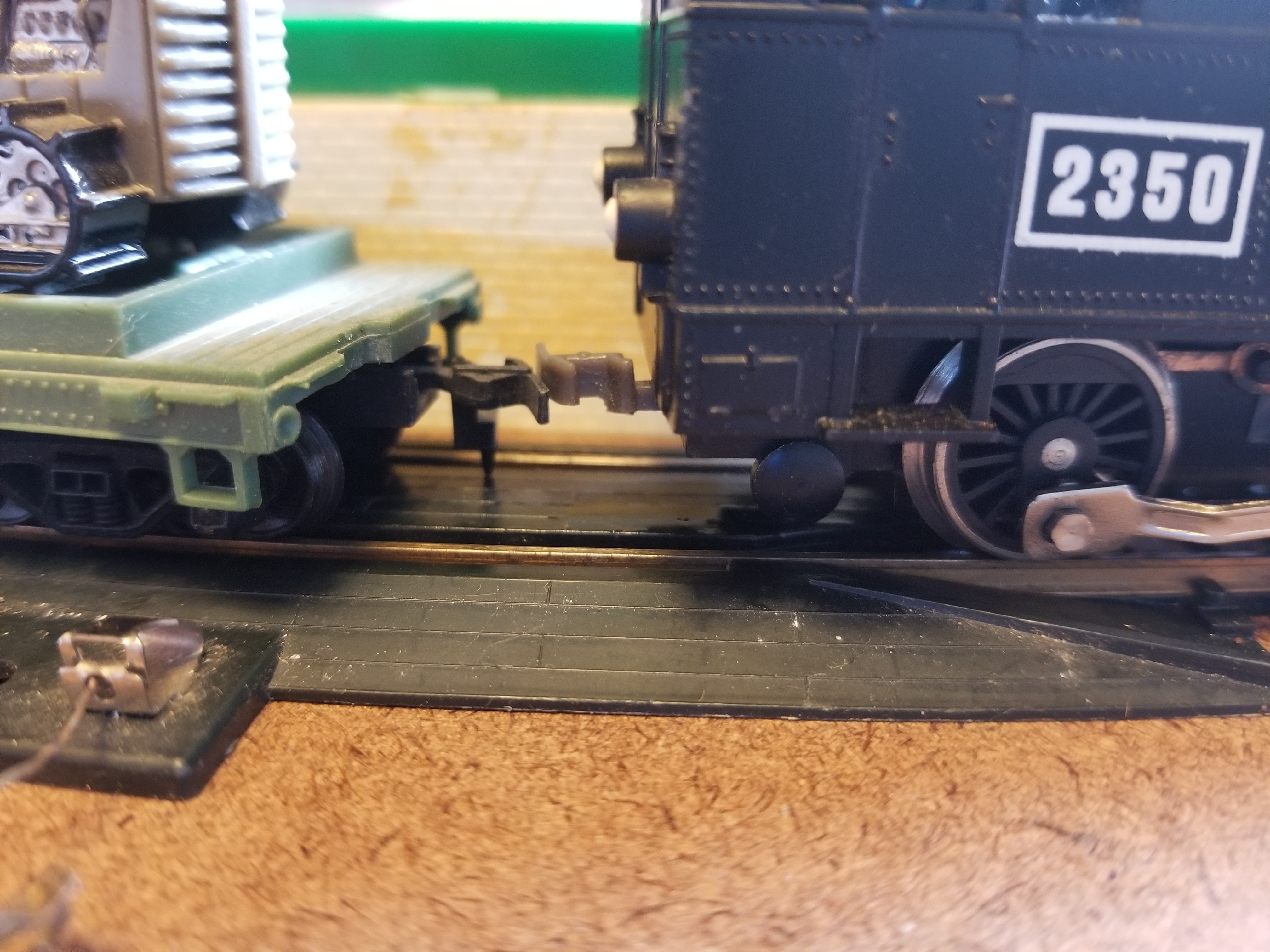

and chuggy boi doing stuff a chuggy boi shouldn't. derailing caused by mismatched coupler heights and loose track and unbalanced wheels(stuff I'll attend to after I get a more solid setup)
https://youtu.be/R9v5BGJGts0
coupler height comparison(less than half of the coupler grips, so any wobble disconnects, see unbalanced wheels note above)

Play art couplers are trash. Replace with a spare horn hook. Notice how it doesn't have that post the other coupler does.

are you sure it's not a tyco? (the F9, not chuggy boi)
it really looks like a MU motor, except
bottom is plastic not metal like some MU.
bottom is held in with 2 screws and side clips
front wheel assy has made by tyco - in hong kong
weight in dummy engine is definitely wrong, so heavy it causes excess friction on the wheels, and is identical to the weight on the powered engine.
weight screwed in with a bright brass WOOD screw, not black metal screw like powered engine
and the peg for the screw is broke
and weight is actually being held in by glue
which makes me thing that maybe the power unit is not tyco, but it matches so well
cleaning will help, but only after I get a new axle and gear, look again and you'll see the one is worn down and freewheels when assembled
oh, tyco part number 25125 from hoseekers parts list scans, but already got other F9's on my ebay watchlist to see if I can get one working one (bet the next one I get works flawlessly)
probably need to get a worm too, as that one looks rounded

Thanks for the photos. I am thinking I might have such an
axle in my junk box. If you want it Just PM me you address and I’ll send it out by week’s end- if I have it, it may be wrong have to give it a good look and let you know.

Thanks chops, look hard, that's a helical gear, I've seen others almsot like it that were not
Like I said, already got bids on a whole replacement engine, for less what others are trying to sell the driver units for <shrugs>

 Posted - October 22 2020 :  10:00:40 AM Link directly to this reply  Show Profile  Add scsshaggy to Buddylist
Originally posted by Chops124 - October 20 2020 :  02:47:00 AM
This part is reasonably easy to just make a new one:
On the left is the original part. On the right is one pieced together from pieces of plastic sprue.
The nubs are pieces of thin sprue glued in holes in a larger diameter piece of sprue. A hole is drilled up the middle of the large sprue for the worm shaft. I have used this and it has held together.

 Posted - October 23 2020 :  9:46:47 PM Link directly to this reply  Show Profile  Add Chops124 to Buddylist
That is an interesting repair job on the round house universal gear. I’ll need to remember that. I think I might try Blax’s
tube over method first, see if I can make a decent sleeve from a bit of brass tubing. It could be over by a mm or two.
Originally posted by Chops124 - October 23 2020 :  9:46:47 PM
if you ever get a spare for it, let me know, I got some casting technologies I wanna try out, if they work you can have all the bits you can send me
in fact if ANYONE needs some spare small bits, let me know, I wanna start blueprinting some of the harder to find parts so I can either 3d print parts or 3d print blanks so I can make molds for either injection molding or reinforced resin. I might even be able to reproduce parts from photos (done it before, but not at something as small as HO scale)
