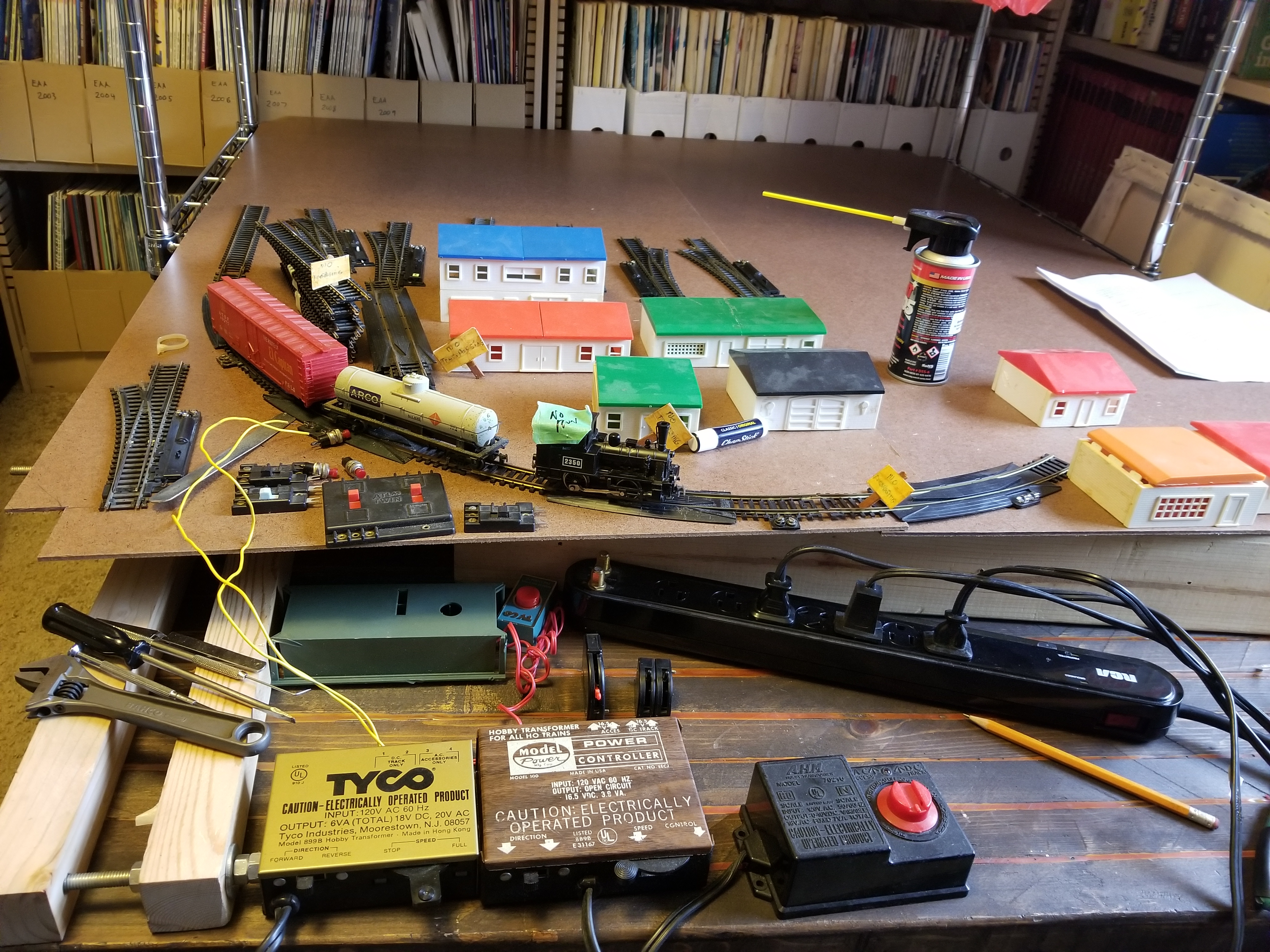

decided to look on facebook for any Ho scale sales, and found one private owner and a used toystore to check out

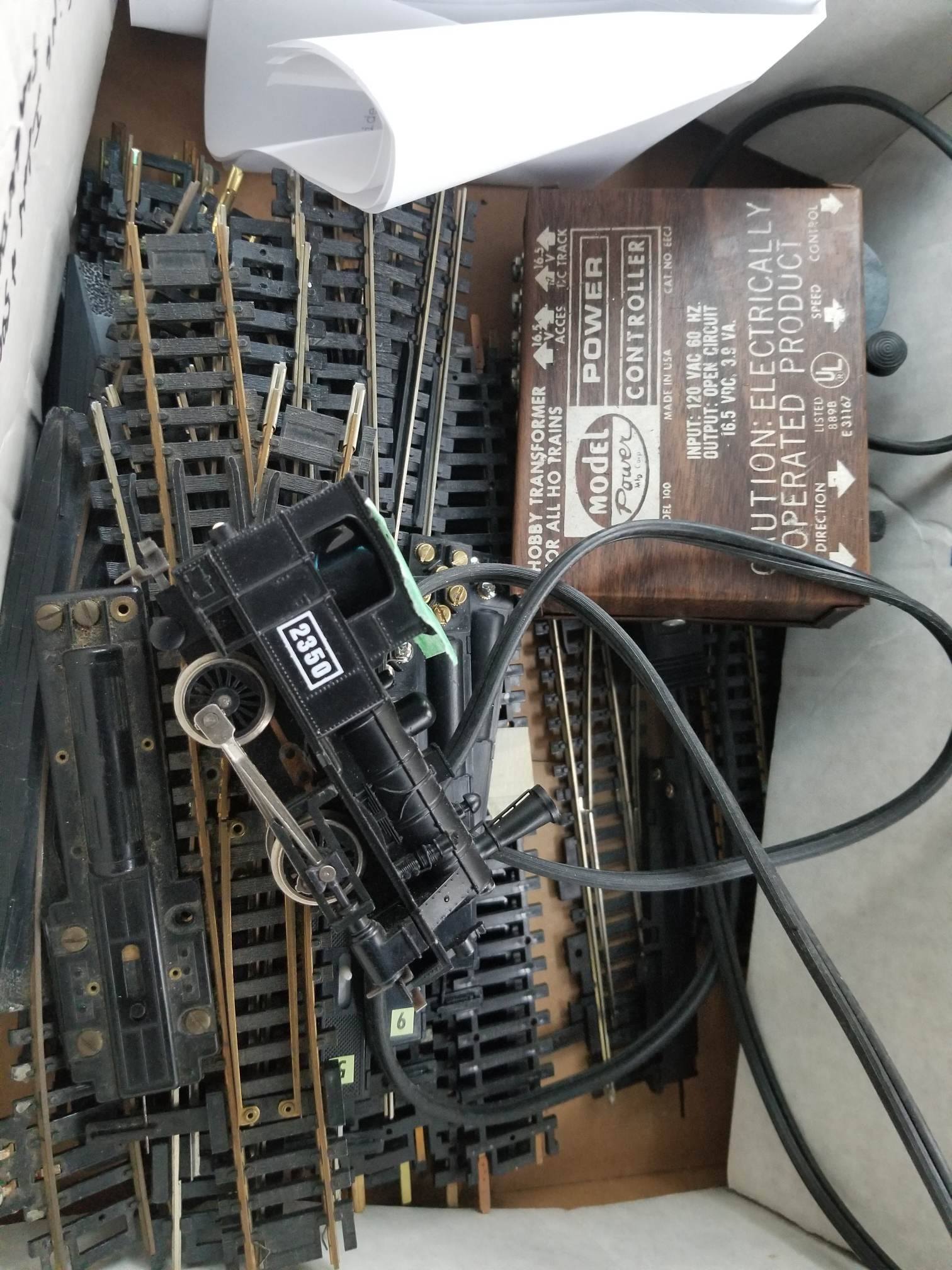

I have three auctions I am waiting on delivery of two sets of tracks engines and some cars, but I did have a list of extra track I wanted
no run, so got it cheap, did get it to almost run, needs more cleaning
had time before the actual store was open, so stopped and looked at this
and then was held up by this
but finally got this
and testing and set up, more track en route via ebay, so not much fussing. most of it i'll end up replacing with upgrades

buildings came with a box lot. not sure if meant for actual scale use. I think not

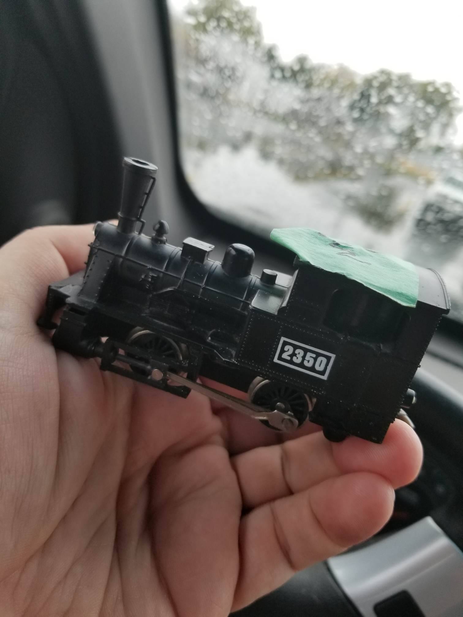

Got an interesting assemblage of bits, there. The transformers
are not known for their good speed control. The locomotive appears
to be a French brand, sold under the name of "Playcraft," or "Jouef,"
is my best guess. I have one of those locomotives, and I can tell
you they are not the best quality, so don't expect much from it.
The track is a mix of brass and steel, I think, and
should perform well enough with a rub down of acetone nail polish
remover, or rubbing alcohol. I much prefer Wahl Hair Clipper Oil.
Track cleaning has many different methods, all of which are
hotly contested as the best. I've tried about everything. I like
Wahl's.
The grimy appearance, particularly of the brass, has to be removed, mostly
on the rail head, to achieve proper electrical conduction, the locomotive
might spring to life if that is done. Also, try to clean the locomotive's drivers off a bit, that may also help.
The buildings appear to be Plasticville, by Bachmann. No really great examples there, but might have a limited interest on eBay, if you want
to sell them for pennies on the dollar and deal with the hassles of eBay.

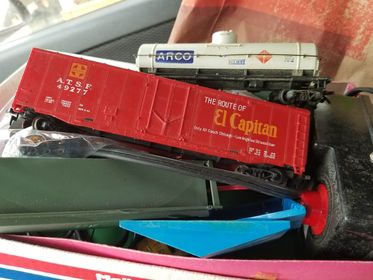

I see you found your Arco!!

yep a playcraft
train motor runs fine
if the wheels are in the right spot I can get the power wires to run the train
the wheels definitely have dead spots, not the track, but the track needs cleaning anyway. when I get my curved track in I'll have video. can run at full tilt along five sections of track, as momentum pulls the pickups past the dead spots on the wheels
got a nearly full gallon can of acetone, will be putting it to use
hollow core door is my storage shelf in the basement ;) twisted minds think alike
will have to order some wahl oil, saw that mentioned somewhere else

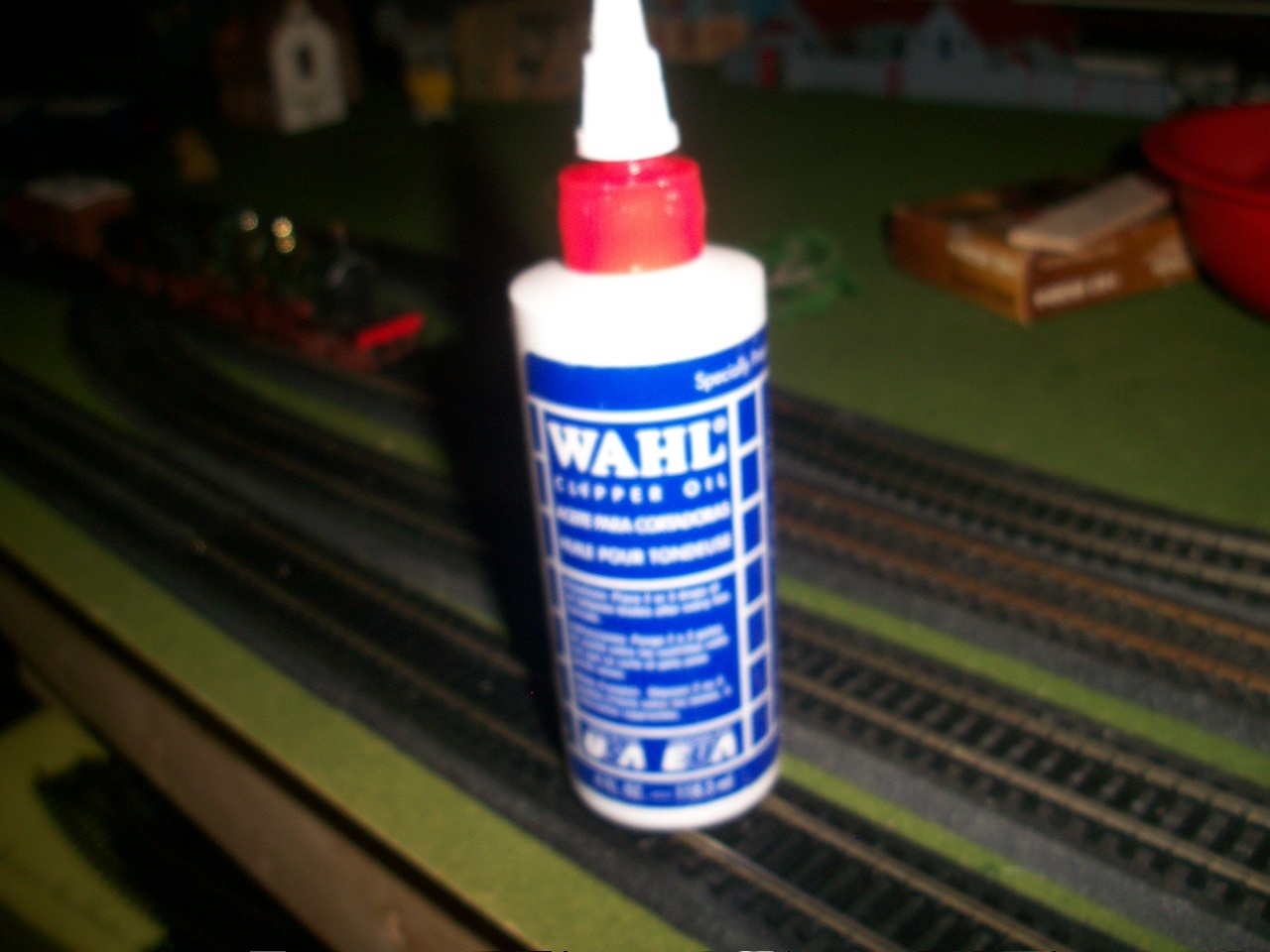

Everybody has their own favorite track cleaning method. This is mine. People might think it crazy to
apply an oil to an electrical rail, but the guy who first proposed it, Lionel Strange, was a world class
professional model railroader, so I gave it a try.
Not only does Wahl's lift dirt and grime like magic, it lays down a protective coating that resists
the arch enemy of model railroaders: oxidization.
Other solvents, like wood alcohol or acetone, clean, but do not protect from O2.
Wahl's is easily found in any beauty supply shop. Costs like $3 for a ten year supply.
 Posted - October 18 2020 :  07:26:07 AM Link directly to this reply  Show Profile  Add scsshaggy to Buddylist
Part of the success of the clipper oil is that it has a low dielectric coefficient. I'm not sure what exactly that means, but it helps prevent arcing. That black powder that builds up on the rail is a kind of ash from arcing. If you can prevent arcing, the rails and wheels stay clean much longer.
Other solvents that suppress arcing are mineral spirits, kerosene and automatic transmission fluid. I've been using mineral spirits for a while and it's an improvement from what I was doing.
Solvents that promote arcing would be water and alcohol. I know many people swear by alcohol, and it does clean very well, but it does nothing to suppress arcing.
Before I found out about the whole arcing and dielectric coefficient business, I had locomotives that were of no use to me because they arced like mad and dirtied their wheels completely in about 1 scale mile of running. Now that I use mineral spirits, I can use those locomotives.

 Posted - October 18 2020 :  10:23:56 AM Link directly to this reply  Show Profile  Add Chops124 to Buddylist
For a micro layout, 4x4 or less, a simple rag daubed in a few drops of Wahl's is easy and quick.
One good treatment can last months. A dry rag can be used to remove any residual oil, but still
leave a protective microfilm.

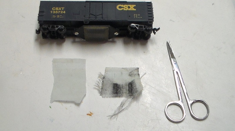

For the longer reaches involved in Armodilloville and Henley I use this Model Power box car with its
abrasive block covered by a square of linen rag, and it really does the trick. I can mop up residual oil
with a dry square of linen either in tandem or seperately.

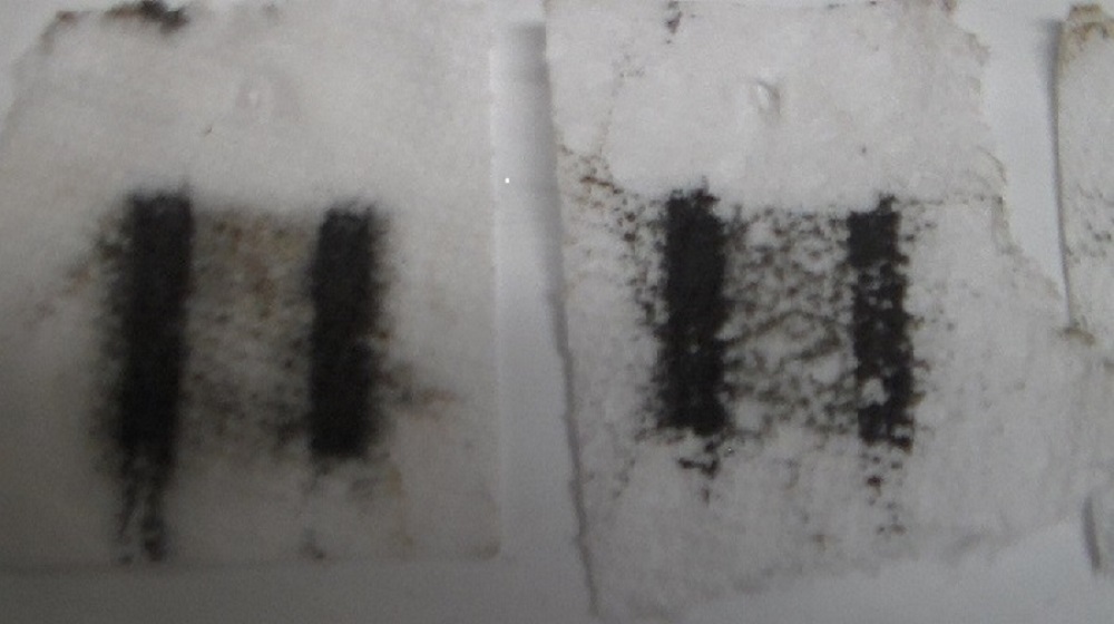

My belief about abrasives, Model Railroader agrees, is that use of abrasives, like a birght boy, might
be good for removing a heavy layer, but overuse will carve micro grooves into the railhead thus
inviting more micro arcing and sparking, which attracts more oxidization. The micro film of Wahl's
retards such arcing and sparking, as well as providing a protective micro barrier.
The model train industry has conducted laboratory experiments on this subject, as it is our greatest bane.
Additionally, laboratory studies demonstrated that metal wheels have no inherent advantage over cheap
plastic Tyco wheels when it comes to track hygiene. They may track better, as the diameter is more precise,
but they do not keep track any cleaner.
I have spent money on various cleaning cars of other types and found them worthless, worthless because
unless the cleaning pad can be changed quite often, then it becomes hopelessly gunked up and merely
smears the grime down the rails, accomplishing nothing.
Above all, never use Goo Gone, or any other citrusy type cleaner. This stuff leaves a terrible residue.
Lastly, track cleaning methods are closely held, and there exists many opinions. My opinion is based on
reading laboratory research, Lionel Strange, and decades of trying different methods and cleaners.
