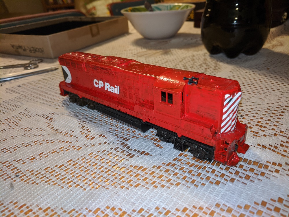

The CP SD9, or something. The stripes are not perfect, the paint is so-so.
If I want to try again it will be necessary to strip the whole thing down.
Jury is still out on that. Needs numbers. Found air horns in my junk box
for this and six other units missing airhorns.

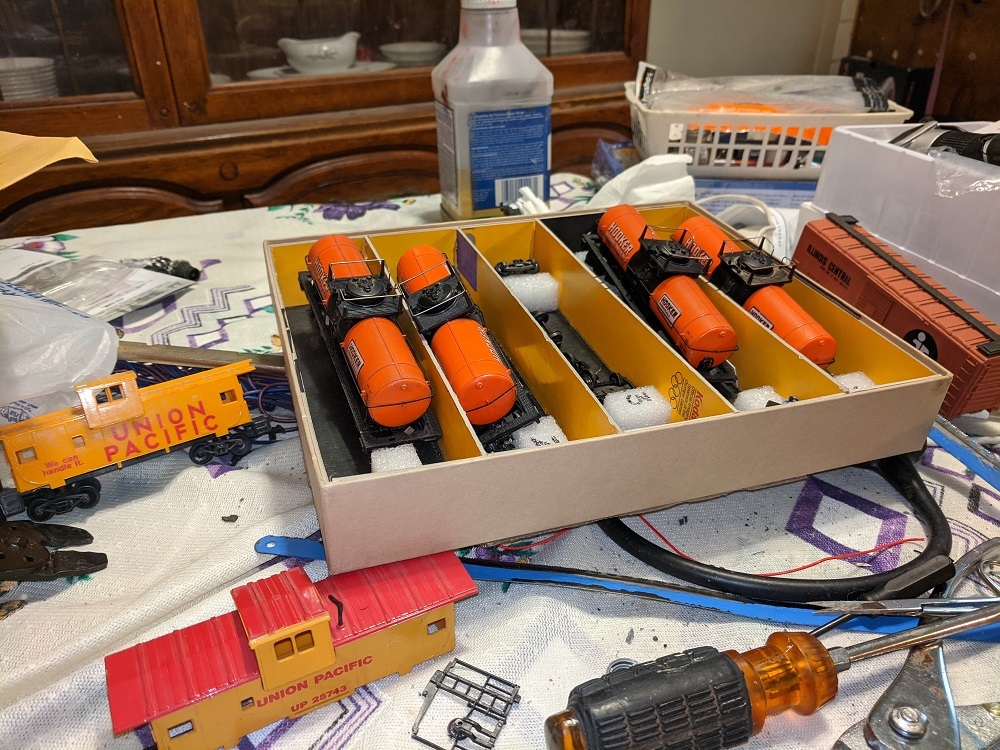

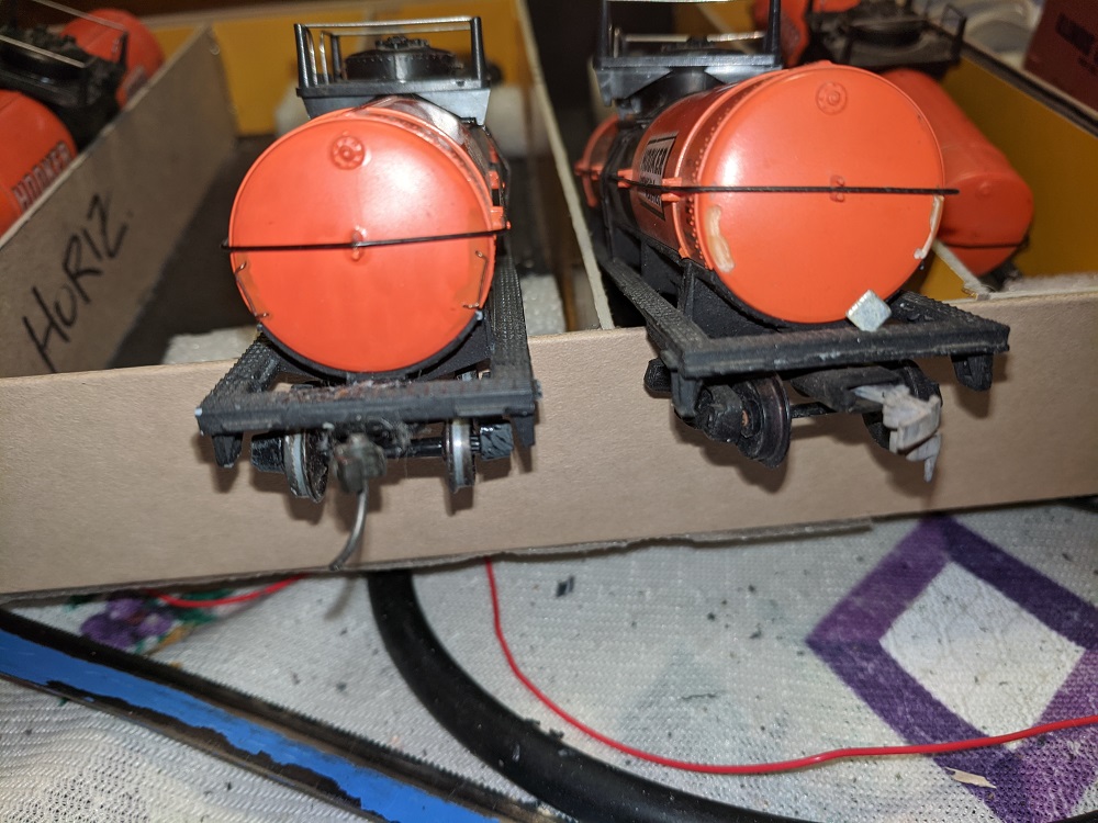

Working on the couplers for this Hooker Chemical set I recently got.
Most of the stock has Kadees, which normally I don't mess with, too much
work and I got enough to take care of as it is. Since I have three other
Hooker chem cars, with horn hooks, I am changing one coupler on two cars
to adapt to the horn hooks. Talk about lazy!!

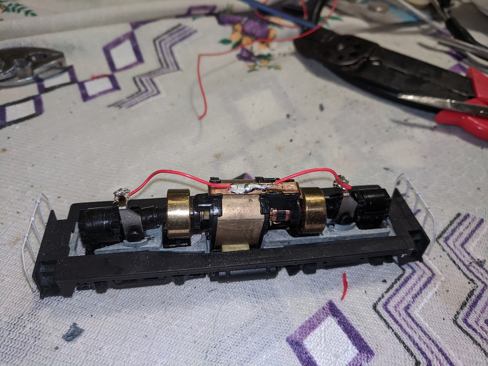

The Hooker locomotive had the motor out of the chassis and missing the
connector and a sideframe. Reached into the junk box and on the first
try pulled out a suitable Athearn side frame that popped right in. The
insulated motor mount was missing a few of its pegs, so that got put
in with epoxy, and a couple wires to connect up the pickups. Runs fine!

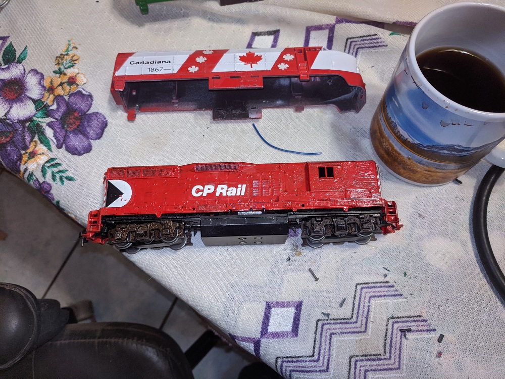

Ah yes, the Shark Canadiana! It was the deuce to extract the shell, which
had been superglued onto the chassis, but I did it without ruining it.
Then it was to go onto a heavy Model Power fly wheeled chassis, but that
required getting out my dull hack saw and trimming about a 1/4 inch of
the chassis so it would fit. Then I had to go back inside the shell and gently
saw out these vertical ribs molded in by the Tyco people so it would
fit laterally over the MP chassis.
But NO! I couldn't find where I left the MP chassis!!! Spent 45 minutes
hunting for it, no dice, so found a working AHM F unit chassis, needed a
cleaning and traction tires, not a superb running chassis, AHM rarely was,
but I needed to make all kinds of cuts to the plastic chassis to get it to fit.
That's when I found the MP chassis! In a @#$%@# shopping bag I had
carelessly set aside.
Mannnnnn, I need to get organized one of these days.
