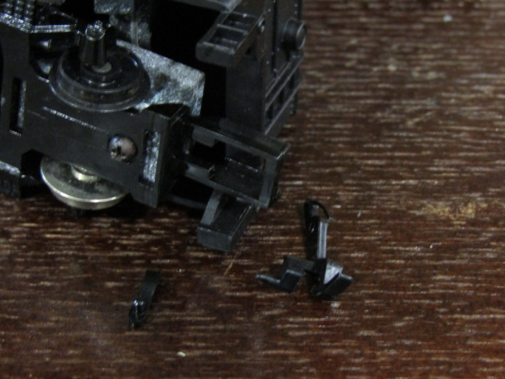

I don't know exactly what to call this, but I need a new bottom plate that goes on the rear of the last truck on Tyco's 2-8-0 "Consolidation." The little thing that holds the coupler in place broke off when the coupler got jammed up, and I can't replace the coupler without replacing this entire screw-on plate.

Can you show me a picture of the truck cover as it is now. If it's the Chattanooga style tender motor. I'd say take out the PT screw, use a small flathead to pry off that truck cover. Use a pair of snips to cut out the glued out coupler. Modeller's cement usually isn't that hard to break apart. At worst you're gonna lose a coupler, but it will be cheaper than replacing the whole thing.
Aaron Anderson
 Posted - August 02 2020 :  9:27:42 PM Link directly to this reply  Show Profile  Add RP model railroads to Buddylist
[quote]I started using toothpicks for glue and it greatly reduces screw-ups.
Originally posted by A-A-RON-August 02 2020: 3:26:50 PM
Another good tip. Will use next time.
Originally posted by RP model railroads - August 02 2020 :  3:51:18 PM
[/quote
Originally posted by A-A-RON-August 02 2020: 7:25:56 PM
Yeah, I can do that. I'll grab a photo tomorrow of the aftermath.

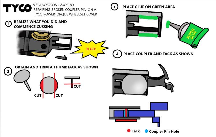

Here's the fast and easy way to fix it. I'm guessing with your consolidation rear truck you just have break the glue on the coupler and remove it from the tab, then follow these steps.
Aaron Anderson
BlaxlandAlex3
Jupiterpfp2
 Posted - August 03 2020 :  7:22:47 PM Link directly to this reply  Show Profile  Add BlaxlandAlex3 to Buddylist
That's a really smart method, Aaron!
Love how BLARX is getting around!
 Posted - August 03 2020 :  10:12:46 PM Link directly to this reply  Show Profile  Add RP model railroads to Buddylist
Wow! Nice instructions. I'll follow them and post updates here - I would have never even thought of doing that. So simple.
 Posted - August 03 2020 :  10:27:36 PM Link directly to this reply  Show Profile  Add scsshaggy to Buddylist
That's a resourceful repair! Figuring out that sort of thing is a useful skill for people using all discontinued products.
