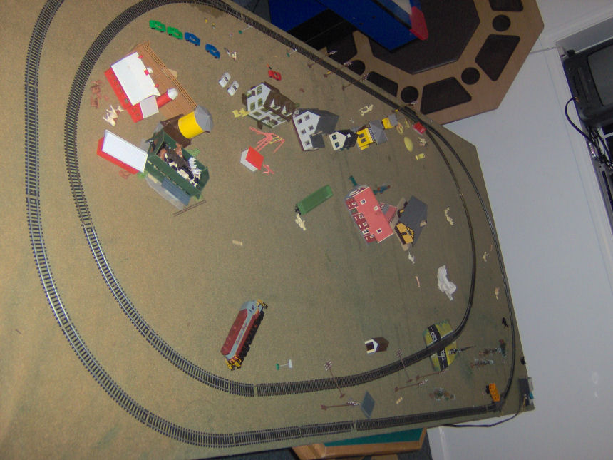

ok, some more information. I'll post a picture as soon as I figure out someplace to host it and how to upload it here.
My set is a mix of track types - about 5 runs of 3' brass, and the rest looks to be standard 9" straight and curved sections of nickel-silver, since it looks "shinier" than I would expect steel to look like. The nickel-silver is, indeed, 18" radius. The brass looks like we used it in a flexible manner to make small curves and such to make the track connect nicely to the silver-nickel sections. Although whether it was designed to be flexible like that I don't know from 20 years ago...
The ties are black. I found some tyco documentation, so I assume the orginial base set is a tyco. I just replaced the engine with the one choice from the one local hobby shop - we started it up after a year or so of disuse, and the engine ran about a foot and then died (smoking and burning smell...). Figuring it was just the engine, we bought a new one locally, since the kids were all excited about it and we didn't want to wait. Sadly, then we discovered the remote switches were broken, the one section has a bad connection (train slows down almost to a stop), and the train derails on several spots, no doubt due to loose/distorted track.
So, I'm still pondering ideas at this point. Hopefully will post the picture soon, and again, thanks.

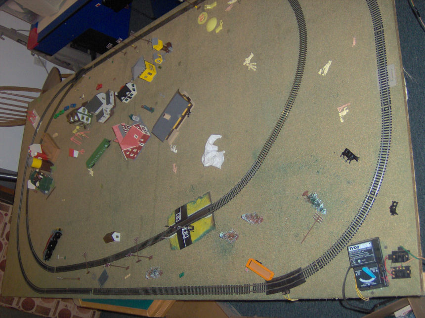

ok, 3 pictures, two of the set from different angles (this was late at night and there was no one to help me move it, so I had to contort myself to find a decent shot), and my transformer, which seems to be working ok, except it buzzes sometimes (if it buzzed all the time or none of the time I'd feel better)...also the engine I just got is a DCC version (not even realizing it at the time, but maybe all engines are dcc these days?), which just by readng the box I assume if I replaced it with a new digital version we could do wonderous things with the train, but that's just another factor in all this.

You picked a good road name for your locomotive![:D] Is that a Bachman? (should say on the bottom of the fuel tank)
 Country: USA  ~  Posts: 83  ~  Member Since: June 07 2007  ~  Last Visit: October 21 2009 Alert Moderator  Go To Top Of Page
 Posted - July 27 2007 :  12:54:04 PM Link directly to this reply  Show Profile  Add GoingInCirclez to Buddylist
Hi,
The pics are fine... nice to see what you've got. I'm going to address what I see, point-by-point; I'm sure others will chime in.
1) Your turnouts look like they were wired correctly. You can double-check and make sure the wiring is still OK. Beyond that, don't be surprised if they do not work. They were operated by solenoids that could burn out easily, especially if you held the button for a long time. It may be possible to replace just the solenoid as they have not changed much; you will need to work with a good hobby shop.
2) Your inner loop.... the narrow end looks like it has too tight of a curve. 18" radius really is a minimum, and that's what the corners of your outer loop is made of. Too tight of a radius will invite derailments and other issues.
3) The mix-and-matching of track (brass with steel and/or nickel-silver) isn't normally a problem. But given that the brass seems to be flextrack, and was laid with too tight of a corner, you might should replace that. If you look at your outer loop, the curves at the ends have a straight-track spacer in the middle. So you could make the inner loop out of 18" radius track and still fit it in there.
4) DCC locomotives. Unfortunately, those will NOT run with your old Tyco (or any other) plain power pack. DCC would allow for some bonus features but you'd have to upgrade a bit more to appreciate them. So, I would stick to standard locos for now. Athearn blue-box or RTR, or the non-dcc Bachmann line that Tony Cook recommended.
Here's what I would do. See if you can clean your steel track. Inspect the connections between sections and see how well you can get the train to run. Once you inspect the track and repair what you can, you'll know what you should replace. (As for steel vs. Nickel silver - the nickel-silver looks a lot like silver. It can be hard to tell steel vs NS if you've never seen them side by side before).
At the very least, if it were me, I would replace the entire inner loop and probably both switches as well.

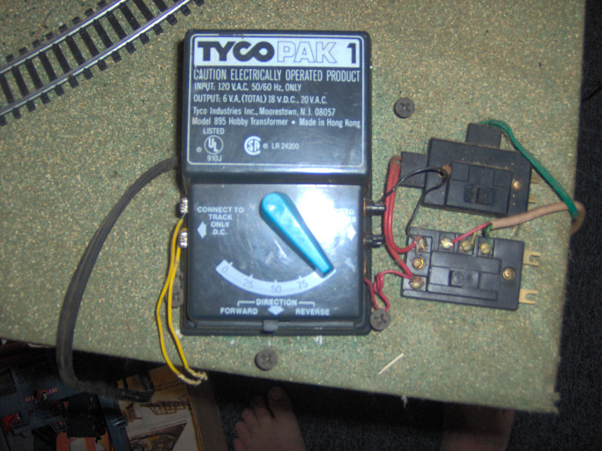

 Posted - July 27 2007 :  1:28:43 PM Link directly to this reply  Show Profile  Click to see DaCheez's MSN Messenger address  Add DaCheez to Buddylist
I don't have a Tyco transformer, so I could be wrong about this, but I don't think it should be buzzing. I used to have an old transformer that started buzzing, and about a month later I smelled something that smelled like marshmallows burning...well you can guess what was burning[B)]... Anyway, a new transformer would definitely be a good idea.

Yeah, i'm worried about the transformer, since the buzzing is intermittant...always on/always off I'd suspect it was normal, but sometimes yes/sometimes no is a soon-to-be-problem. Oh well, the good news is that I can get a digital transformer of some kind and then my dcc engine can do strange and wonderful things. I hope.

I have one of those power paks. They are not supposed to buzz. They do have a built in circuit breaker so if they get a short or over heat, they will shut off. Unplug and allow to cool and they come back on.

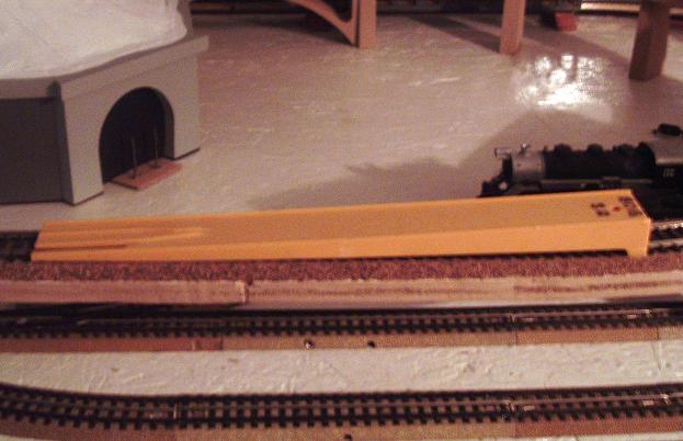

There is a straight-track piece like the one you describe. Look for a "Rerailer"' or a "terminal rerailer" (they are the same but the terminal version has power pack connectors). The straight track might be easier for them to handle.
There are also ramps made to roll rolling stock onto the rails. One if made by a company called "Rix" and they call it the "Rail-It". You set the ramp on the rails, then put a car on the ramp and let it roll down. But I don't know if it would work well for a locomotive. Way I see it, most locos don't roll freely, so it they might just slide down and thunk onto the rails more by luck, and then you'd have to move the ramp to set the back wheels down.
pjmvermont
 Posted - July 30 2007 :  1:42:23 PM Link directly to this reply  Show Profile  Add pjmvermont to Buddylist
A striaght rerailer sounds exactly like the answer. I agree, not sure about the ramp thing, but let's start with the standard solution and see how that works for the kids.

This is the ramp Tony is talking about. You simply set it on the rails in the two slots, then roll your cars down it. Works like a champ.

thanks for all the help from people...I've got a part of the new track up and running, as the pictures show (only some of my kids would be in the pictures...teens were reluctant as they often are..oh well.

 Posted - August 18 2007 :  5:00:42 PM Link directly to this reply  Show Profile  Add shaygetz to Buddylist
Whew...that last camera angle gave me a 70s flashback...[:D]
pjmvermont
 Posted - August 18 2007 :  5:08:27 PM Link directly to this reply  Show Profile  Add pjmvermont to Buddylist
yeah, well, like most things in my life I have 3.5 seconds to do them or I lose my window of opportunity, so I ran down, took some pictues, and moved on. The kids loved the sound-enabled transformer - we heard train whistles for hours :). Fortunately, that is our basement, so the sound didn't drive us tooo crazy...
 Country: USA  ~  Posts: 11  ~  Member Since: July 26 2007  ~  Last Visit: August 18 2007 Alert Moderator  Go To Top Of Page
 Posted - August 18 2007 :  6:57:08 PM Link directly to this reply  Show Profile  Add shaygetz to Buddylist
Roger that...I have two of my own[:D]
Is that Bachmann EZ Track? If so, I have a right hand switch and 3 pieces of straight that were part of a box lot you're welcome to.
