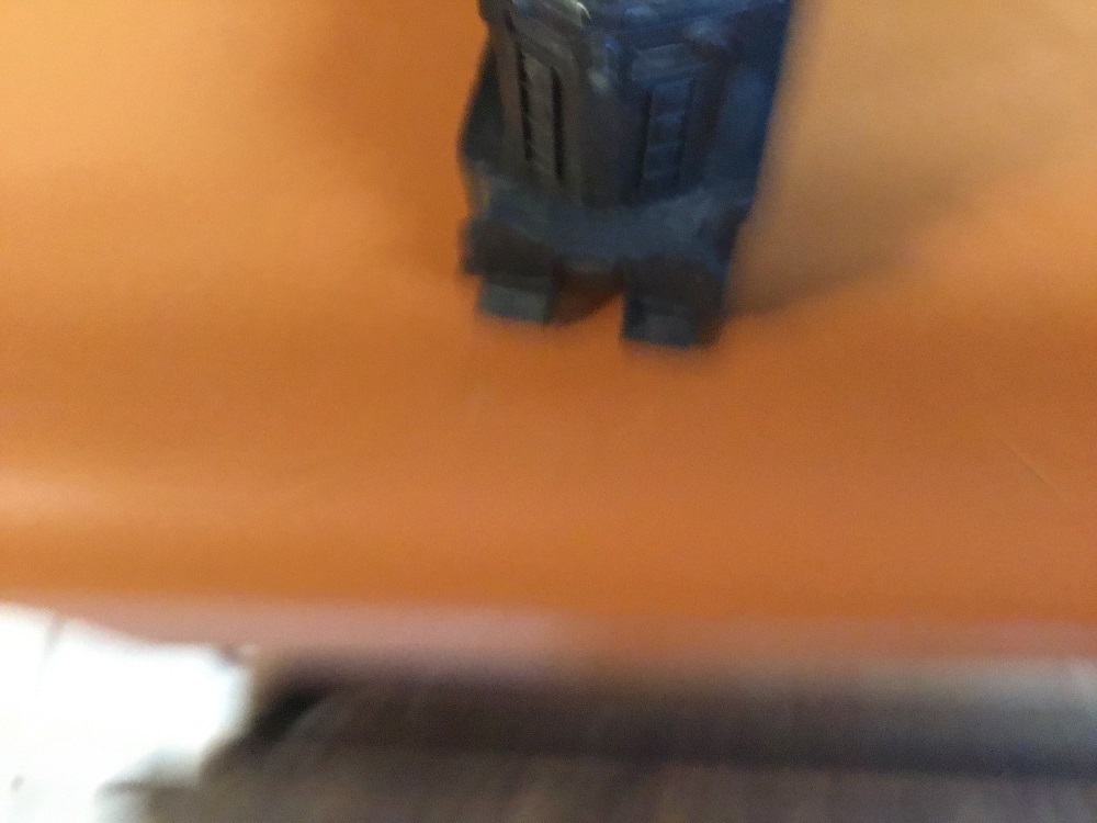

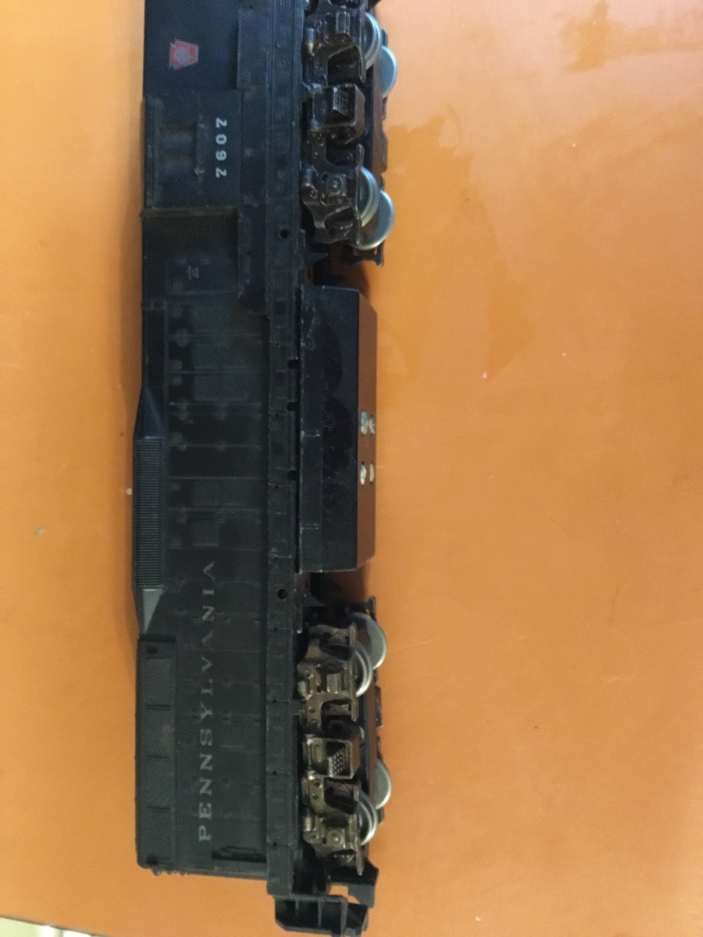

While poking through my junk box while talking to WKS, I stumbled over first the chassis, and then
unable to find a matching shell, discovered this PRR shell in another box. Fits like a glove. At first
I wanted to paint it red and slap on some CP Pac Man decals, but got to noticing the details like
pipes and ladders, were cast on, which makes me think this is old. Is it? Also, can anyone kindly
tell me if this a GP 38 or Alco or whatever, my trainspotting is terrible.
Struggling with Windows 10, I cannot upload the photo of the roof, but the pipes are cast on.
I'm not sure if to keep this, though I don't do anything with PRR, or continue on with my original plan
to make it a CP unit, real or fantasy. Longer I look at it, more I like it!

According to the internet it is a SD9 unit.

Looks like a Athearn model according to eBay listing.
Maybe someone here has a CP unit for sale or trade Jeff.

That's quite a mongrel. Trucks look like older Athearn EMD GP and F trucks which have metal sideframes with axles riding in bearings in those sideframes.
Locomotive frame has fuel tank shape, and motor mounts, of Athearn's frame for GE U28B, U30B, U33B, locomotives.
Where those triangularv posts are at each end of fuel tank there would have been a crosswise air tank there.
Body is an EMD SD7 or SD9, looks like one made by Athearn with the mounting holes each side.
Here's an SD9, https://www.railpictures.net/photo/233528/
And a GE U30B with stock trucks used by GE https://www.railpictures.net/photo/201969/
And a GE U30B with EMD trucks which GE would have used from a EMD locomotive the buyer traded in as part of the purchase from GE, https://www.railpictures.net/photo/529978/

 Posted - May 26 2020 :  08:08:51 AM Link directly to this reply  Show Profile  Add wks to Buddylist
I copied your photo of the engine you mentioned Jeff.
Looks like a match to me. SD9 it is.
 Country: USA  ~  Posts: 8092  ~  Member Since: February 12 2014  ~  Last Visit: October 14 2026 Alert Moderator  Go To Top Of Page
 Posted - May 26 2020 :  08:10:32 AM Link directly to this reply  Show Profile  Add wks to Buddylist
At least the shells match. I know you swapped out the chassis.
 Posted - May 26 2020 :  08:12:52 AM Link directly to this reply  Show Profile  Add wks to Buddylist
Almost a match. Numbers on yours are white. Other model has them in yellow.

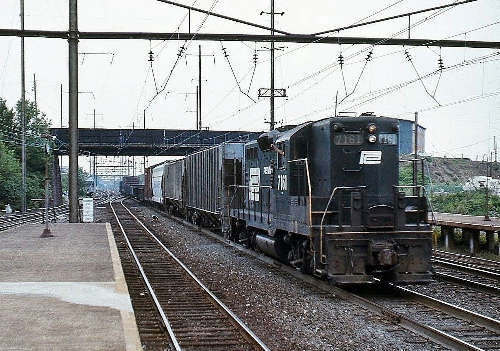

 Posted - May 26 2020 :  08:16:22 AM Link directly to this reply  Show Profile  Add wks to Buddylist
An idea is to letter your unit for the Penn Central.
A quick impromptu look just like they did back in 1968.

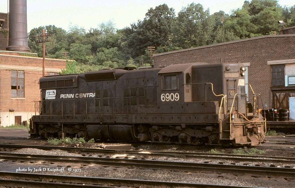

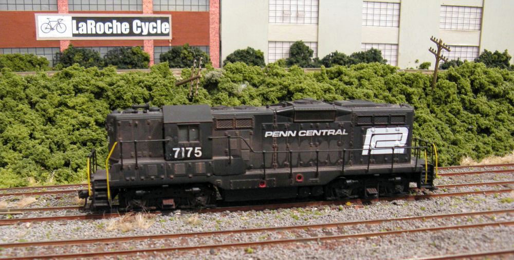

 Posted - May 26 2020 :  08:44:18 AM Link directly to this reply  Show Profile  Add wks to Buddylist
I see your revised unit looks like a GP9 which is a four axle loco.
SD9 are six axle. I also am a novice in identifying locomotives.
Some ideas for your locomotive.
From the internet. Not meant to derail your CP ideas.
