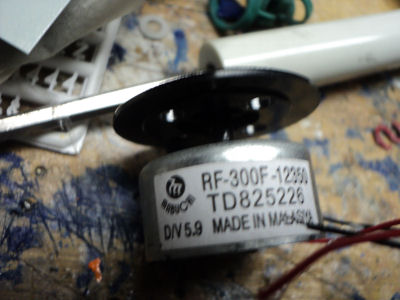

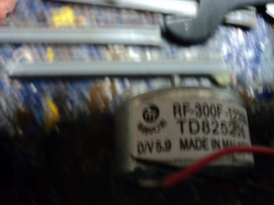

One of the many projects Ive got going right now is finally rebuilding a couple power torques and finally managed to find a couple mabuchi motors here stateside rf300 fa 12350' s from a company out of miami. but these twits show a picture of the motor without a spindle wheel but of course they shipped this I don't wanna have to return these too much hassle. Anybody on here got any ideas about removing these spindles? I looked on line for info about pulling these off you tube internet etc.Not much out there dont wanna buy a puller thought using just a dremel and a cutting wheel and just cutting the durn thing off but concerned about damaging the shaft it rides on.Anybody got any ideas or suggestions to removing it would surely be appreciated.

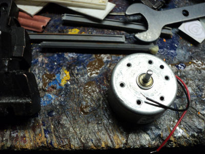

kb1857

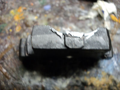

 Posted - March 21 2020 :  12:18:04 AM Link directly to this reply  Show Profile  Add kb1857 to Buddylist

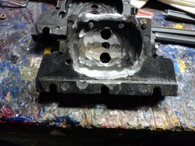

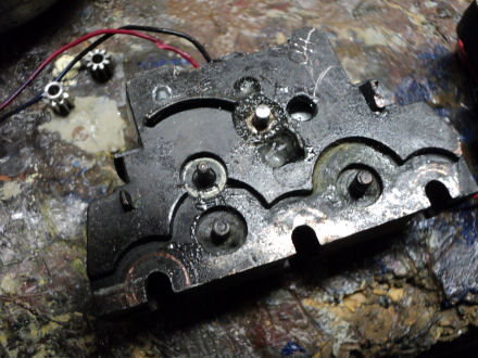

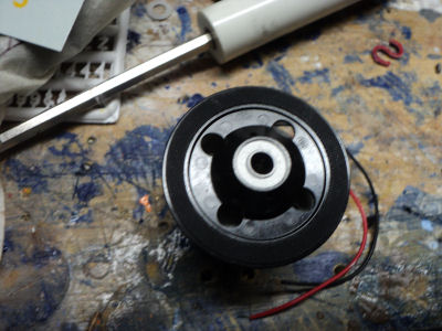

Okay I was able fo pop the spindles off with a screw driver,this is the project that I am working on amongest many is a power torque rebuild using this motor Igrabbed the dremel and ground on the block friday night for a while to keep busy.If I keep at it every day should be up and running by next week.

 Posted - March 21 2020 :  5:45:38 PM Link directly to this reply  Show Profile  Add Chops124 to Buddylist
So, you had to grind out the housing to make it fit? What will you be
using for a pinion gear?

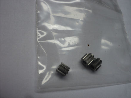

 Posted - March 22 2020 :  12:27:26 AM Link directly to this reply  Show Profile  Add kb1857 to Buddylist
I plan reusing the original pinion gear if possible if I cant then i'll have go to a slot car place and get one of the pinions they use.I saw a link on here with one of the power torque rebuilds where someone was able to match up pinion that from a slot car with the right kind teeth on the pinion its self.No the biggest issue that I see is gonna be drilling out the bushing that is in the block itself.What I mean is drilling out the bushing or bearing just enough to get the motor shaft through.Ive already done that I was able to drill out dead center on another block I was trying to convert to one of these small motors.But I screwed up the other side of the block when I bent one of the pins the plastic gears rides on.Bent the sucker slightly by virtue of the way I was mounting the block in the bench vise to do my grinding.So Iam more conciously aware of this now when I Secure it to the bench.

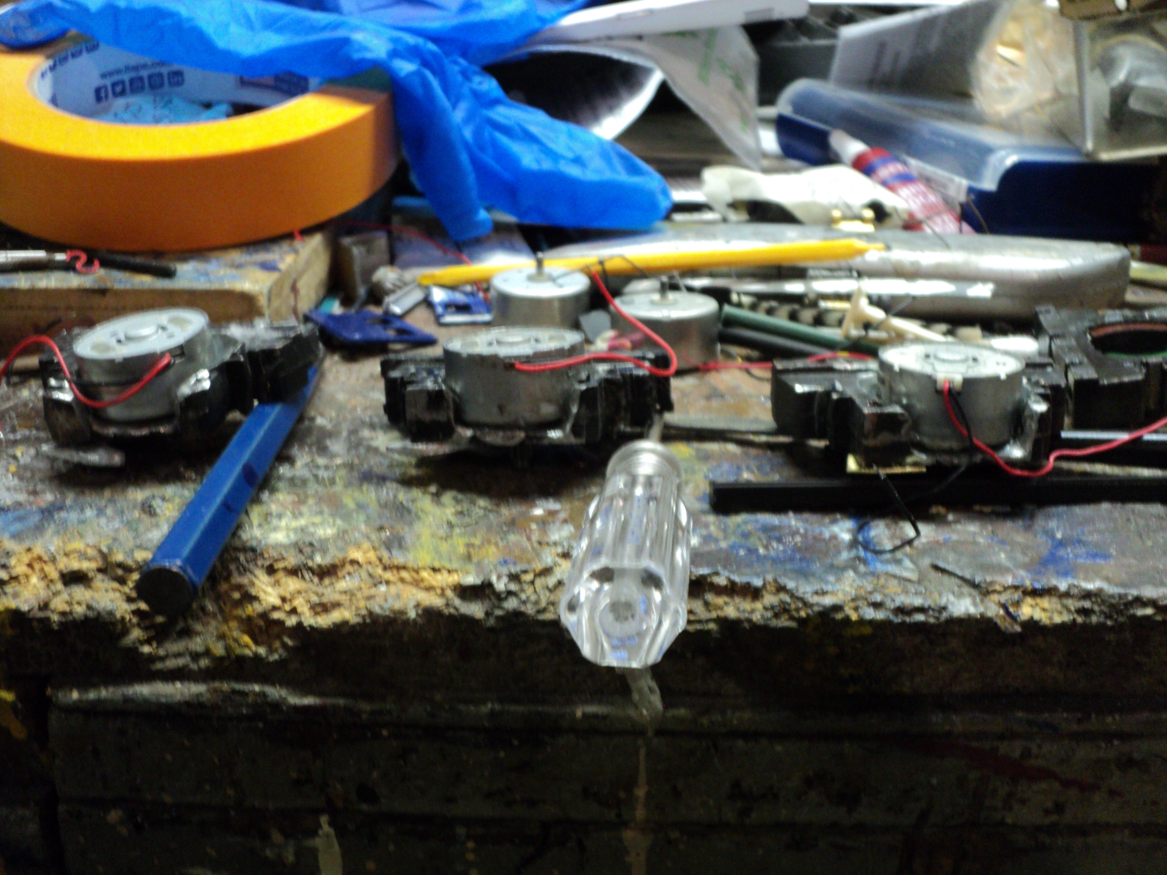

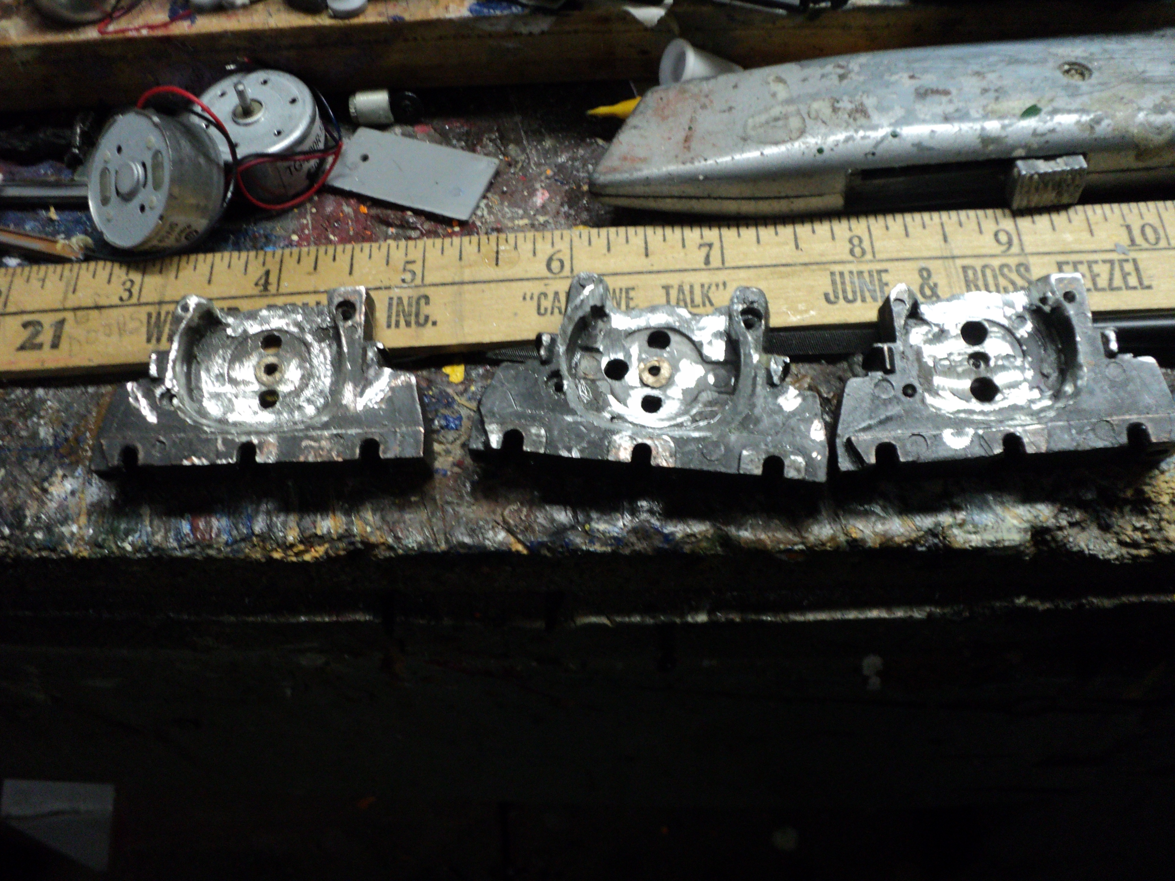

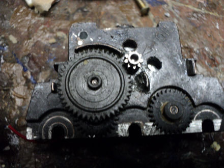

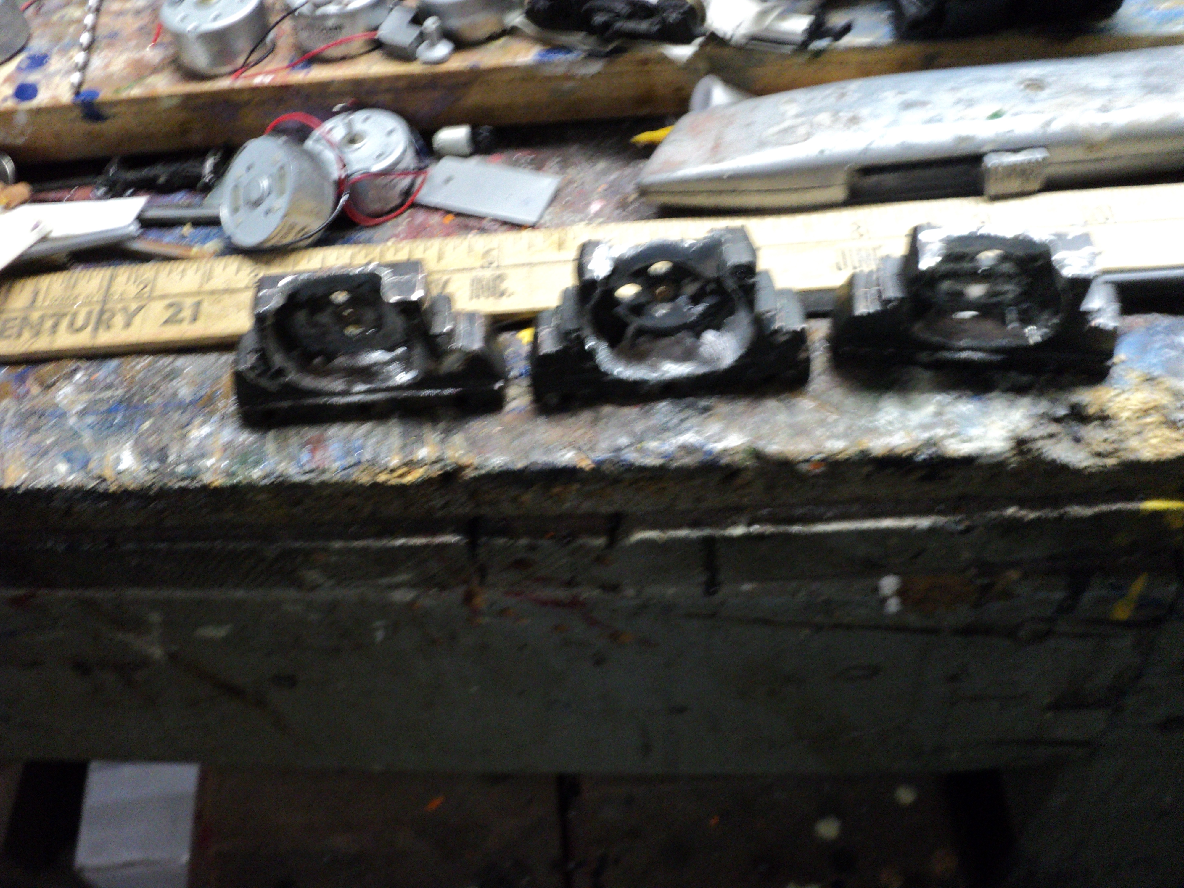

 Posted - April 03 2020 :  3:55:29 PM Link directly to this reply  Show Profile  Add kb1857 to Buddylist

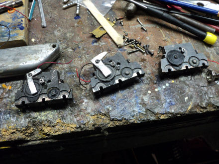

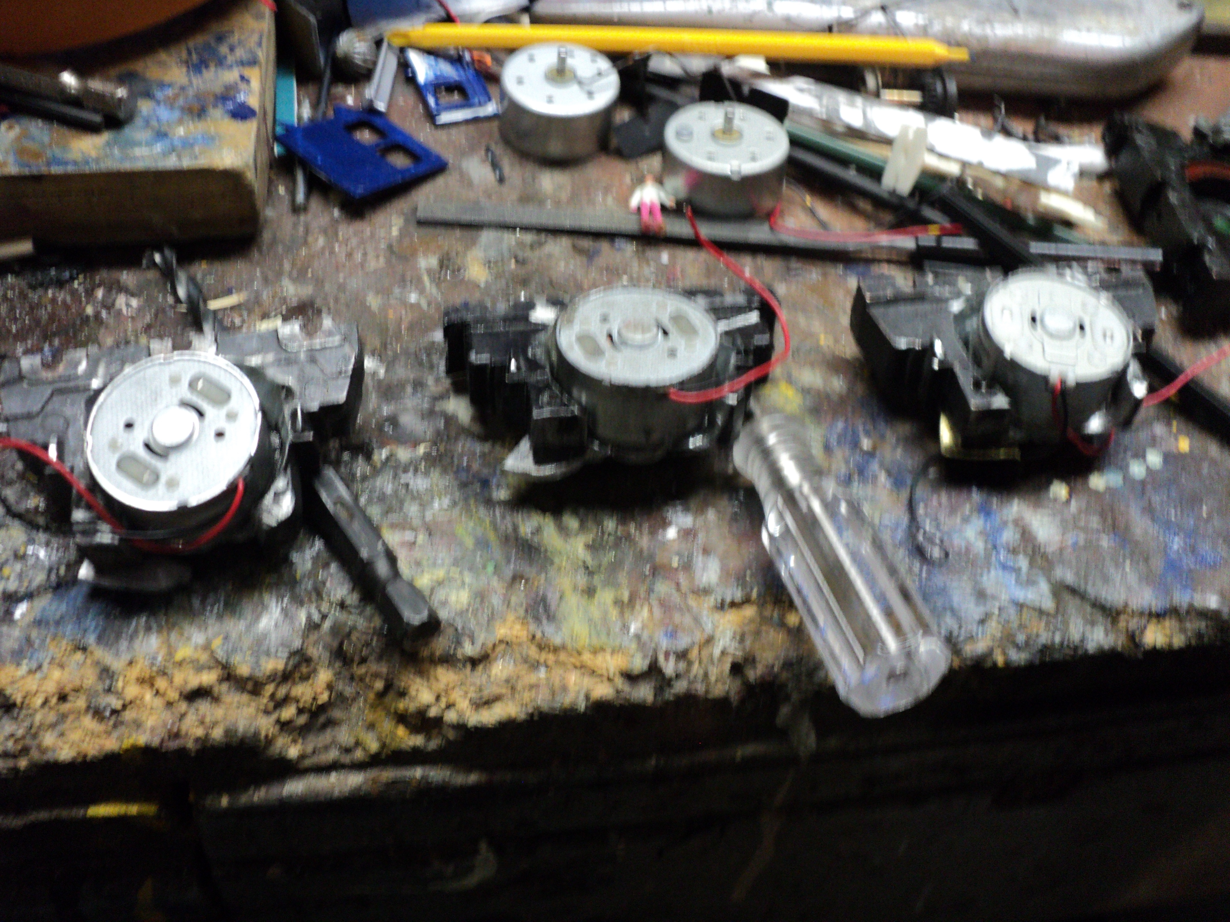

Okay gang,got three power torque blocks hogged out and the motors to fit .Now all I am waiting for is three pinons gears I ordered from an slot car shop .I opted to try something that I had read in past posts in this forum that these would work provided I make up something of a clip or retainer that will keep the big gear from walking off of the pinion.These are 9 tooth 64 pitch pinions. So I gotta get me some brass sheet from some where to make that retainer and I gotta figure a way to secure the motor into the block jb weld maybe? wish me luck

 Posted - April 03 2020 :  8:01:16 PM Link directly to this reply  Show Profile  Add Chops124 to Buddylist
Best of luck. The transmissions on these Tycos can be
quite challenging. Look forward to what comes next.
kb1857
 Posted - April 03 2020 :  8:44:39 PM Link directly to this reply  Show Profile  Add kb1857 to Buddylist
Yea I hear ya chops,IVE been read and rereading all the past articles on doing this type of project.It can be done but Ive gotta do it right and just take my time.Theres gonna be some hicupps along the way.But Ive got about ten or 15 of these power torques that are basically Doa in my estimation.Ive tried everything possible to get them to run,completely disassembled.cleaned them up,replaced brushes,springs even the magnets in some cases and its done absoulutly no good.Now it could simply be that I am not getting the brushes and springs right in that cover so they hit that old comutator just right.Iam getting better at putting them back together lol and not losing the brushes and springs to the shag carpet.But you cant belive the condition Ive found these power torque blocks in,A couple were cooked black from oil and abuse,had to soak em in wd40 and alcohol and tooth brush plus elbow grease.One of the blocks had a gear pin so worn down I cant even figure out how it held the gear to the block.But wer'e under stay at home order here in ohio so time is something Ive got lots of TO RUN TRAINS!!!lol

 Posted - April 04 2020 :  06:23:32 AM Link directly to this reply  Show Profile  Add Chops124 to Buddylist
Big gear walking off the pinion. Yup. That’s about where
I get in trouble. Well, let’s see if your retaining clip does
The trick. JB Weld usually cements everything, but takes
Overnight to cure.

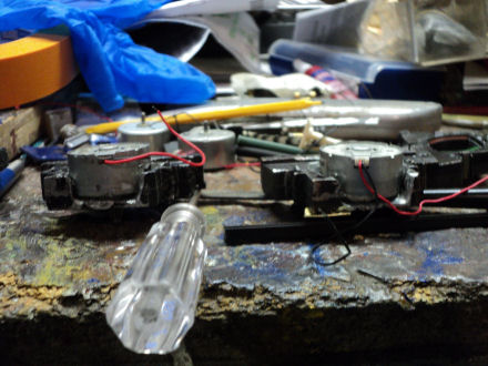

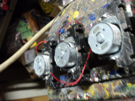

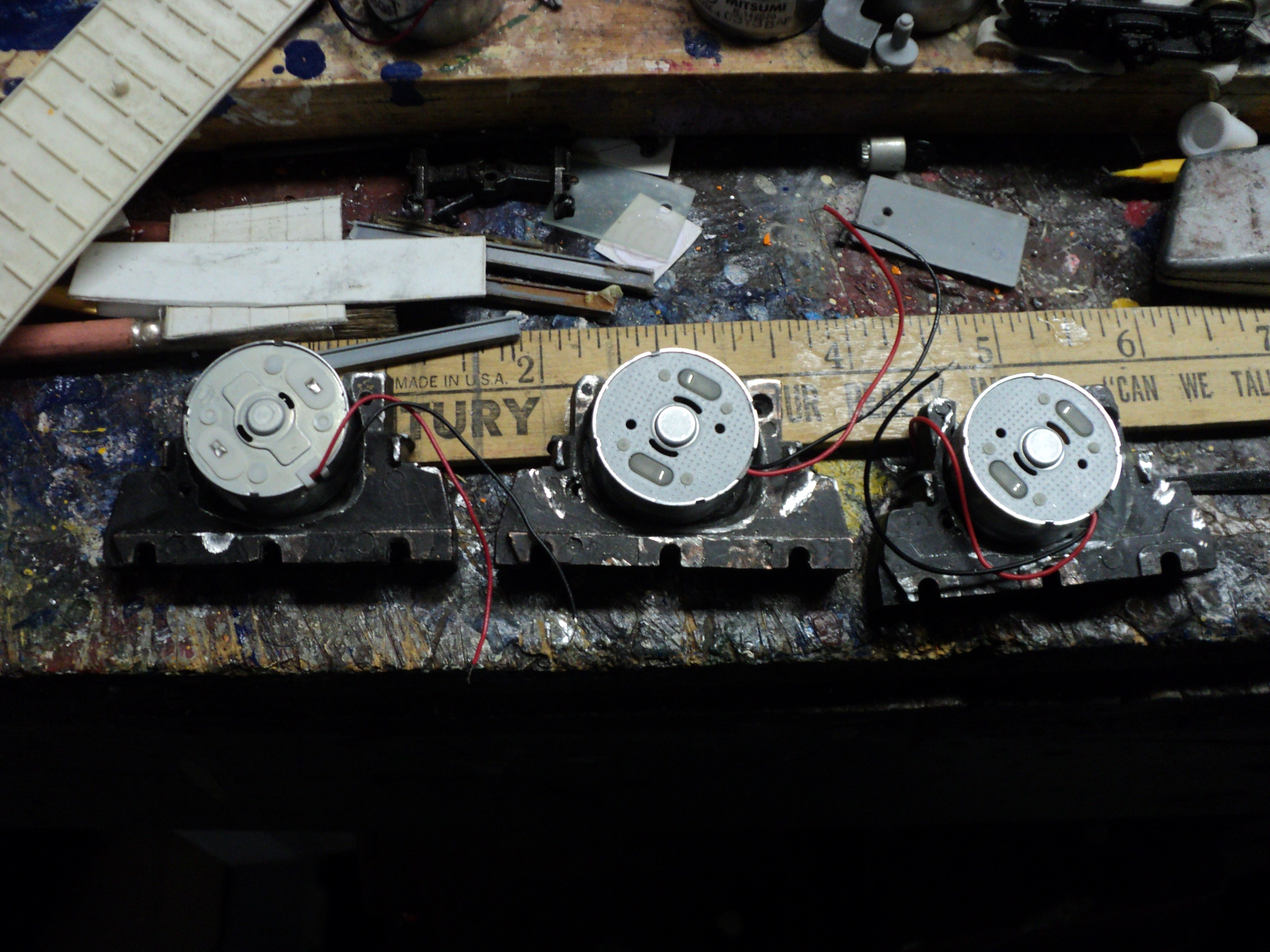

 Posted - April 07 2020 :  7:14:34 PM Link directly to this reply  Show Profile  Add kb1857 to Buddylist
Well gang my pinion gears arrived in monday's mail and monday evening I cemented in the motors in the hogged out power torque blocks with JB Weld,nasty smelling stuff but Id use horse manure if it was an strong adhesive lol.Had to wait for a day for that to set. This morning I ventured out to my closest hardware but they didn't have any brass so I had to settle for aluminum strips to use for L angle brackets that I can fabricate to keep the big gear from walking off the pinion.More to come later wish me luck.

 Posted - April 07 2020 :  10:56:29 PM Link directly to this reply  Show Profile  Add Chops124 to Buddylist
Hate to ask, but if the big gear wants to walk off,
Is it also slipping?

 Posted - April 08 2020 :  4:15:10 PM Link directly to this reply  Show Profile  Add kb1857 to Buddylist

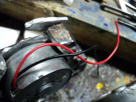

In ansewering your question chops best I can, without using the old pinion that had a lip on it to hold it on its gonna slip regardless hence the clip installed slightly above the center of the gear to make up for no lip on the pinion.Its the fix somebody else in this forum used and its seemed to work we will see.

kb1857
 Posted - April 08 2020 :  4:59:17 PM Link directly to this reply  Show Profile  Add kb1857 to Buddylist

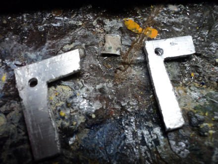

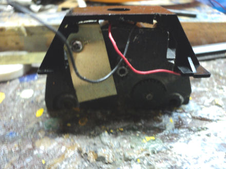

Got the brackets cut and holes drilled in both the bracket and the power torque block,gears and pinion on,pinion is a good fit so I am not gonna cement it on atleast not right off,still gotta smooth the rough edges on the bracket and bend ,manipilate the metal a bit to fit. I am gonna cement a 2-56 screw to hold it together.My biggest concern is getting it to fit in the mounting bracket of a geep 20 gonna have to forgo for now using it the 630 because of the middle axle issue bogging up the turn radius in the shell.I am gonna have to do some modifying of shell and the bracket itself.Iwill have to find a smaller motor to use in this setup for the 630.

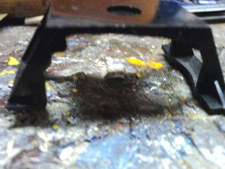

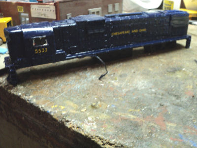

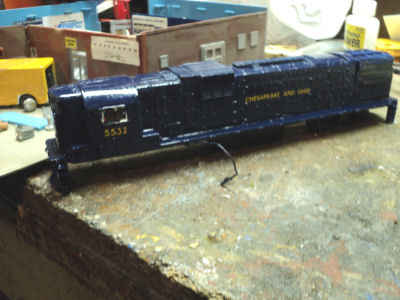

Yea walt,this is the 630 I want to restore I repainted the old girl chessie blue and renumered it 5532 but I'll have to find a smaller motor that can fit up in it after I cement the block to it so I can run the three axles and have no problems with turning radius on it.But I got a couple GP 20s that I can slap these engines into and they'll run.got these two finished,haven't put the juice to them yet and Ive gotta make some modifications to the shells,The third of these I did I had to remove the motor and hog it out some more with the dremel to get it to fit the block better.So Its sitting on the bench after I recemented with jb weld.Don't know yet if these aluminum brackets are gonna work and I might have get brass to make this work.

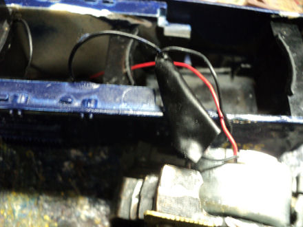

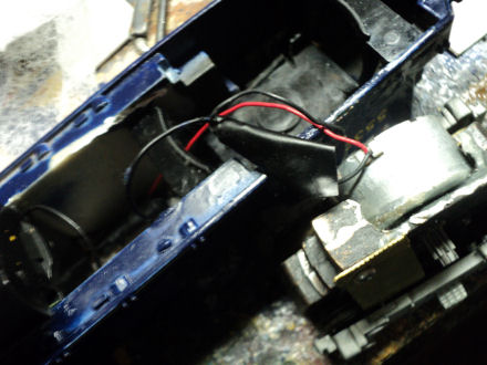

 Posted - April 26 2020 :  6:18:27 PM Link directly to this reply  Show Profile  Add kb1857 to Buddylist

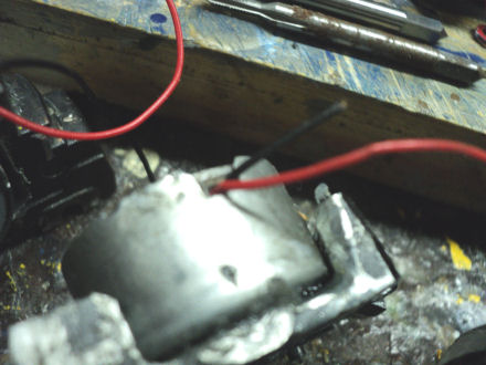

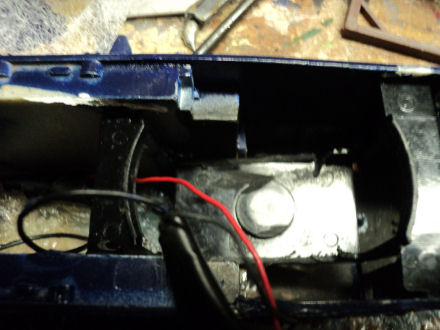

Okay this where my motor rebuild program is at.Ive' hit several snags.Finished four motors total including the fouth one was small enough to use in the Alco 630 and come to find that I did have some brass sheeting to make a L shaped bracket four the fourth and final motor. If you look closely to motor on the right it was the smallest That I could find for a fit in the 630 and be able to swivel. I tryed to cut a small portion of the mounting bracket used to mount the motors in the 630.Well here's where Ive run into problems with this project.I cant find a way to mount this motor into the shell,The bracket tyco used is a snap in fit not much can be cut away with out cracking or breaking the bracket itself.What little That I was able to grind out so the motor was able to swivel some but still snap into the shell.Heres where the problems began.This bracket will not support the power truck its self,and the area is so small and tight no way I can frabricate something out of plastruck to cement into the shell itself .So for the time being I just decided to hook up the wires axles and just let the shell ride on the truck just to get the darn thing on the track.Trying to hook up the wires off these motors is like trying to drink coffee with a fork.Very small whisper thin wire I am not even sure what guage,never hooked up something that small,skinned a small part of the of the wire back as well as stripping some off a original tyco wire running running to the back truck.twisted the two wires together then soldered them together and wrapped electrical tape to protect the soldering job So put it on the track and of course nothing no power no light up nothing zilch, zip, nada.So Ive no way of knowing if I soldered these two wires together or not nor do I know of any other way to attach something like this together,butt connectors? heat shrink tubing?I am out of ideas and very discouraged because I cant put power to these motors to see if they work. Tryed to put power to the other motors using just a power pack and broke off a small portion of the wire red positive but just enough that ill be hard pressed to attach it to something else.So I am very frustrated at this point.

 Posted - April 26 2020 :  10:08:43 PM Link directly to this reply  Show Profile  Add kb1857 to Buddylist
Thanks for the pep talk chops,I just get discouraged because Ive put a fair amount of time in this but I'll take a few days off from this work on something else.Got any ideas about connecting these wires together? or anybody else in the forum wanna chime in it would be appreciated.
