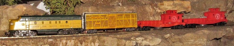

Occasionally, I run this train on the mainline:
The engine is a good puller and needs to be. The cattle car has a Masonite pad under it to polish the dust and grit off of the rail head. The two red cars are old LifeLike track cleaning cars with felt pads underneath. The first felt pad is dampened with mineral spirits. The second felt pad is run dry to wipe off the mineral spirits, and hopefully the dirt suspended in them.
On those same occasions, I wipe yard tracks and industrial spurs with mineral spirits on a rag, and then wipe them again with a dry rag.
On shorter intervals (maybe after a few hours of operation), I run the engine and one felt pad car just to dust off the black dust that forms on the rails. I also drag my finger tips over the yard tracks to dust them off. Often, I just need to do this on the tracks that see the most traffic, such as ladder tracks and drill tracks.

Sscshaggy, I like your MOW consist! Looks like a very aggressive
dirt buster! Do you, or do you not, find the Masontie pad might
redistribute accumulated dirt? I favor a small square of linen
that I change out to prevent spreading the gunk back down.

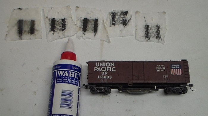

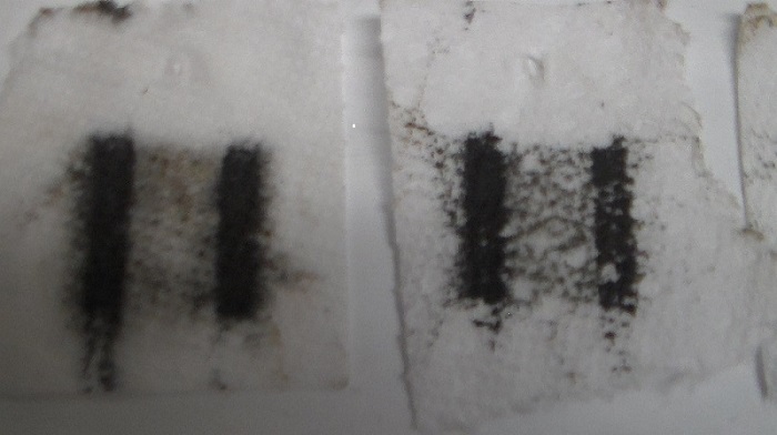

Mr. Fugate brings up Wahl Hair Clipper Oil, an idea promoted by the
professional model railroader, the brilliant Lionel Strang. Several aspects
became apparent when I used it:
1. It does create a slightly oily film, and yes, it may attract a little dust,
but a few passes with a rag attached to the track cleaning car wipes
it up clean. The oily film does not greatly cause slippage, if it does,
a quick pass with the dry rag removes the excess easily.
2. It has a solvent quality, stripping off black gunk with alacrity.
3. The overall effect lasts for up to three months, with intermittent wiping
should I fail to replace the dust cover.

Do you, or do you not, find the Masonite pad might redistribute accumulated dirt?
Originally posted by Chops124 - November 16 2019 :  8:43:53 PM
It probably does, a little bit. There's a little history behind my even having it. The late, great Wizard of Monterrey, John Allen used to have them under various cars that roamed the rails on the Gorre and Daphetid. They helped keep the dirt knocked off the rails, and people who use them report some success.
I set up such a car for my layout, and used to run it all the time on one of my manifest freights to periodically clean the track a little. I got tired of seeing the big lump of Masonite under the train all the time, so I stopped doing that. Afterwards, I would occasionally run the car around the layout behind an engine, by itself. Usually, I'll take a lap or two, clean the pad off and run another couple of laps with it. Now, as part of the larger train, I run it in case the dirt needs to be knocked loose, but I have no idea whether it makes any kind of difference, at all.
If it is just spreading the dirt, the other track cleaning cars, behind it, take care of that.
