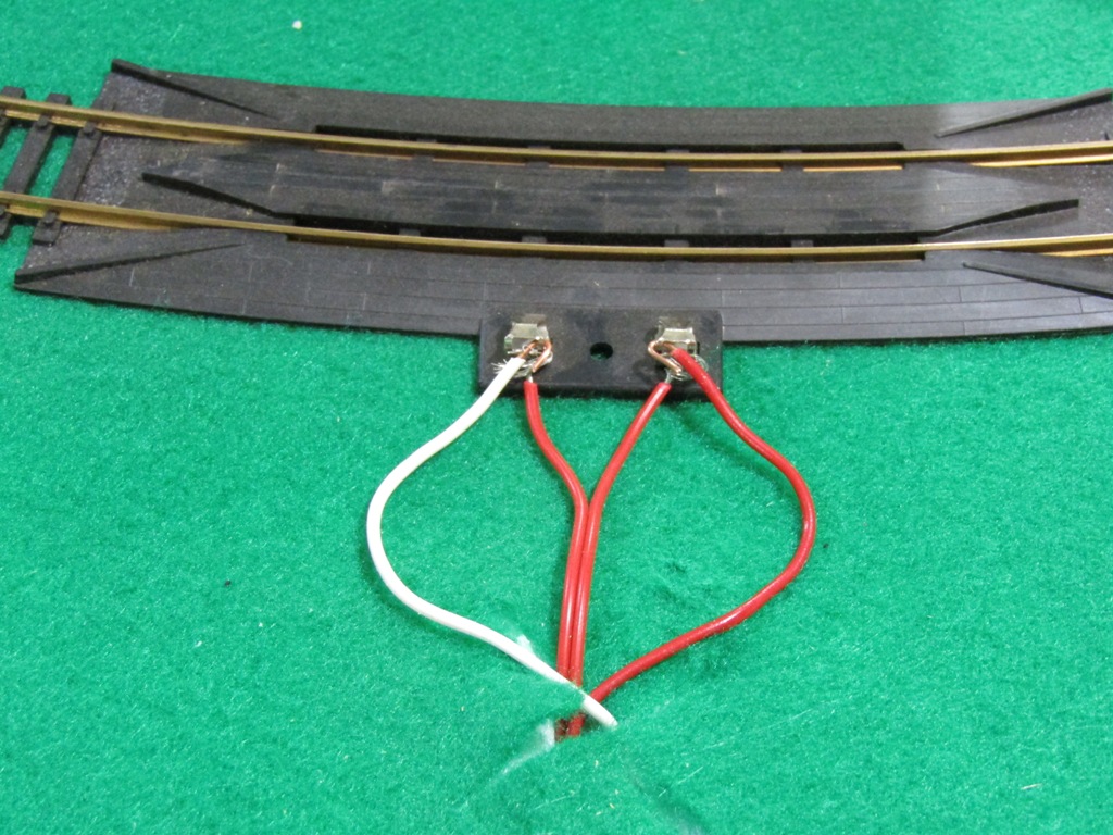

Below are photos of my current wiring work. As of right now, the train will not run unless the button is pressed and when it does, it runs in reverse. (I know that running in reverse is definitely due to the wires being wired-up backwards on the terminal track - easy fix.)

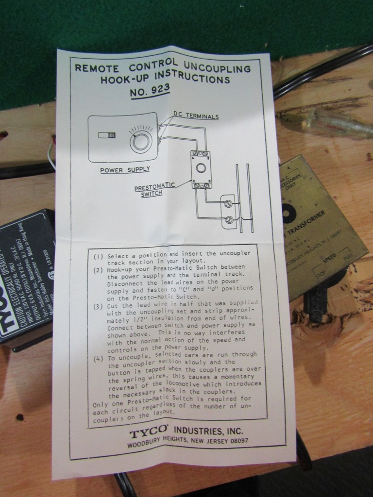

The diagram in the instructions doesn't seem to match the directions themselves (at least to my brain) and in all 4 of the Tyco Remote Control Uncoupling Track accessories that I have, there's no "lead wire" that was supposed to be "supplied with the kit."

Trust the diagram. The written directions seem vague and confusing. It doesn't look like there should be any wires twisted onto the contacts of the switch. Only the soldered on wires appear to serve a purpose. One pair of them should go to the power pack terminals and the other pair should go to the terminal track terminals.
It shouldn't matter which pair goes to which place.

I understand a bit better now how exactly this button is supposed to work. I'll wire it up later exactly as the diagram shows, and try again.

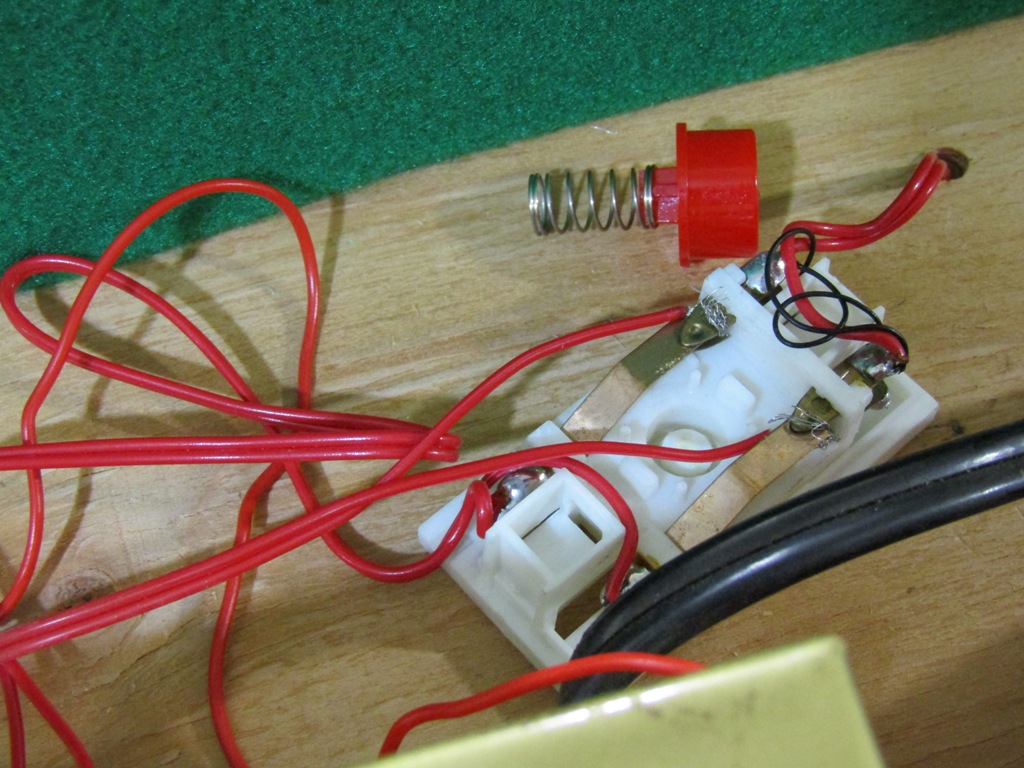

UPDATE: I wired up the switch exactly as the diagram shows (2 wires connecting to the DC-side of the powerpack and 2 wires connecting to the terminal track.) I still got the same result -- the locomotive will not move until the button is pressed & held down, and if the button is released, the locomotive will stop. It is as if the switch is doing the exact opposite of what it should do.

Pushed down, the engine should go backwards. Released, the engine should go forward, so the contacts are apparently not making contact when the button is released. I wonder if something is keeping the button from going all the way up. If it's sticking so that it's always a little way down, that could cause the contacts to never make contact to go forward.
I noticed in your AOTW posting that you have four of these buttons. Have you tried one of the other ones? If another one worked right, then this one might have a little glitch in it.

Tonight I tried one of the other Prestomatic buttons and wired it up directly from the powerpack to the terminal track. Success! Except....the button does not cause the train to "momentarily reverse" as the directions state.
Rather, once the desired train cars have rolled-over the uncoupling track, then the Prestomatic button is pressed, which stops the train completely. Upon releasing the button, the train starts moving again, and the train cars are uncoupled by remote control! Truly cool.

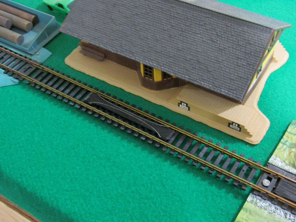

I installed 2 of them on RETRO TYCO....one on the inner line and the other on the outer line. These accessories do, however, require some pretty good precision in stopping the train over the uncoupling track at just the right time...so that the right train cars uncouple.
Here's a short video I assembled of the Tyco Remote Control Uncoupling Tracks in action.
***Note: I think I know what caused the first button to malfunction. When I took off the top cover to access the wiring inside the button, the spring on the bottom of the actual red button itself popped off. I tried jamming it back on, but that was obviously a miserable failure. That should be the only problem with that button, so a "proper" fix in the future should solve that.

All of my trains were either derailing or running really rough over the uncoupling tracks. Upon closer inspection, I noticed tiny plastic nubs (most likely from the factory) sticking-up off the edges of the actual uncoupling section of the tracks -- these were catching the undersides of the locomotives as they ran over the uncoupling tracks and causing issues. So, I simply used my finger and popped off those nubs, and sure enough, no more rough-running locos.
