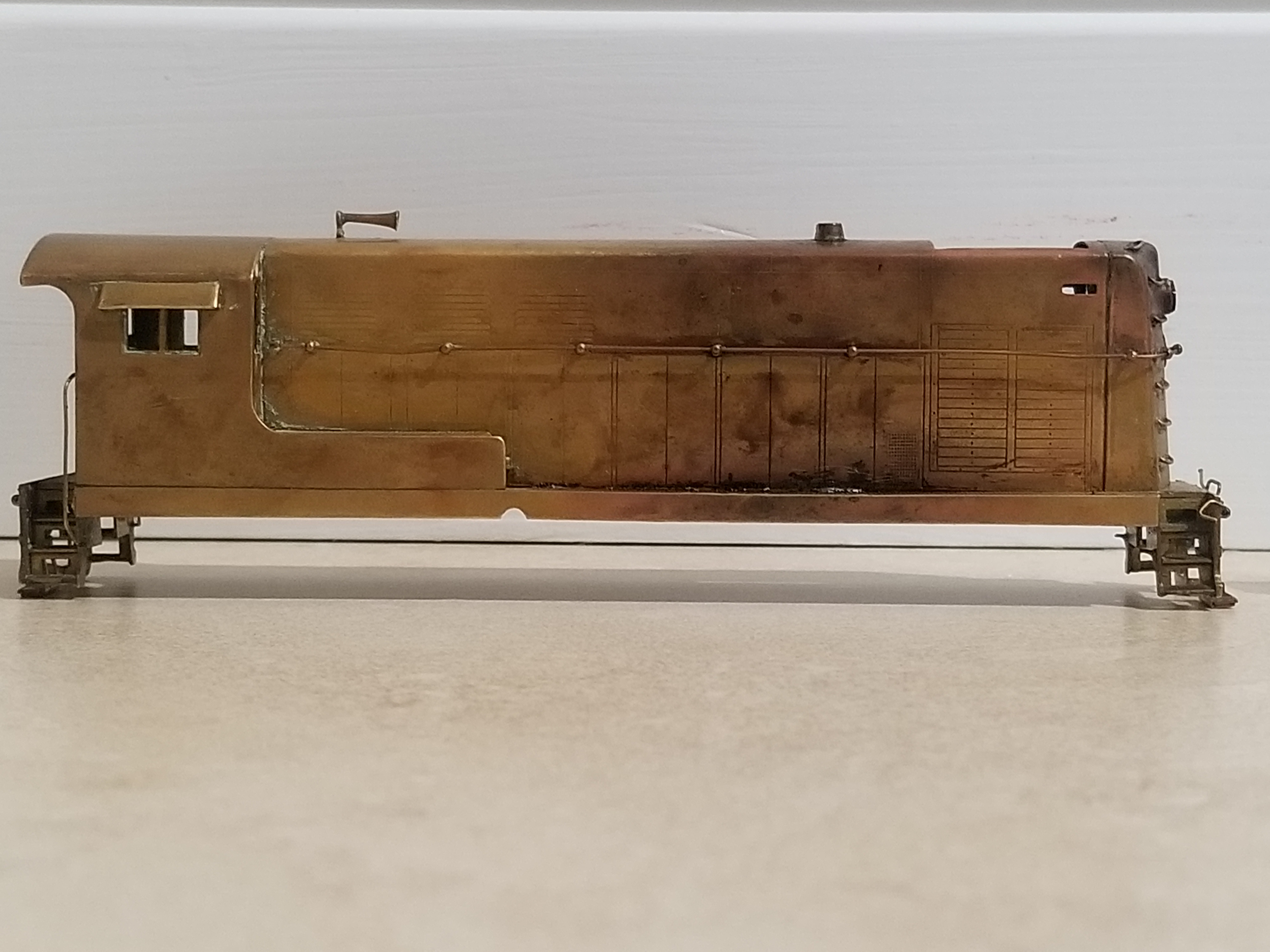

I got the hood and everything aligned!
...... With the extent of a blowtorch to melt the solder.
Uhhhhggggggg.
I feel really bad about this. Especially since I BURNED my only brass locomotives shell. I'm sure I can get it off, but we live and learn.
I honestly think it looks kinda cool, like weathering!
I'm going to try and fix it up using the advice in the link chops sent me, thanks!

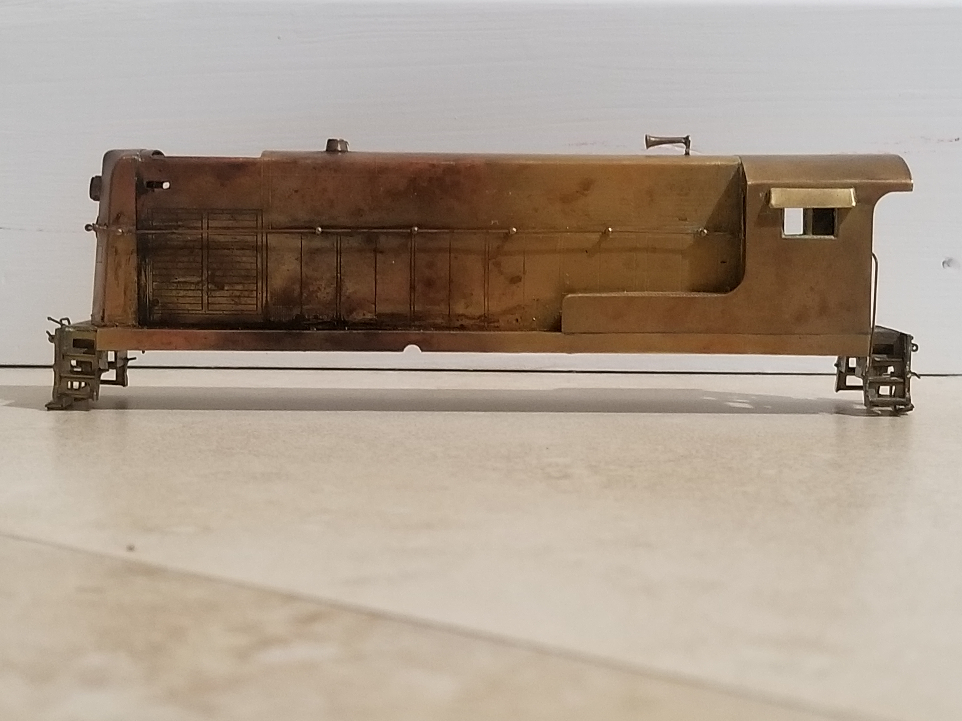

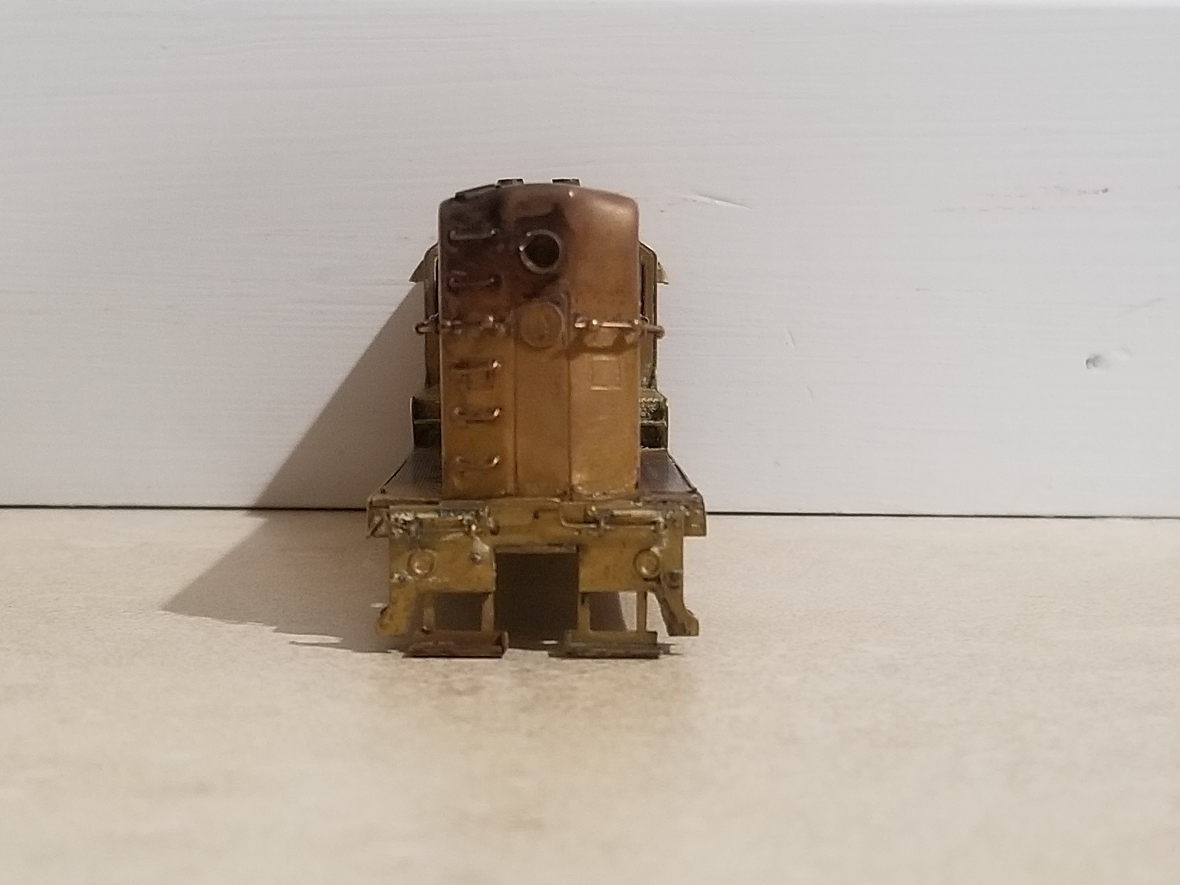

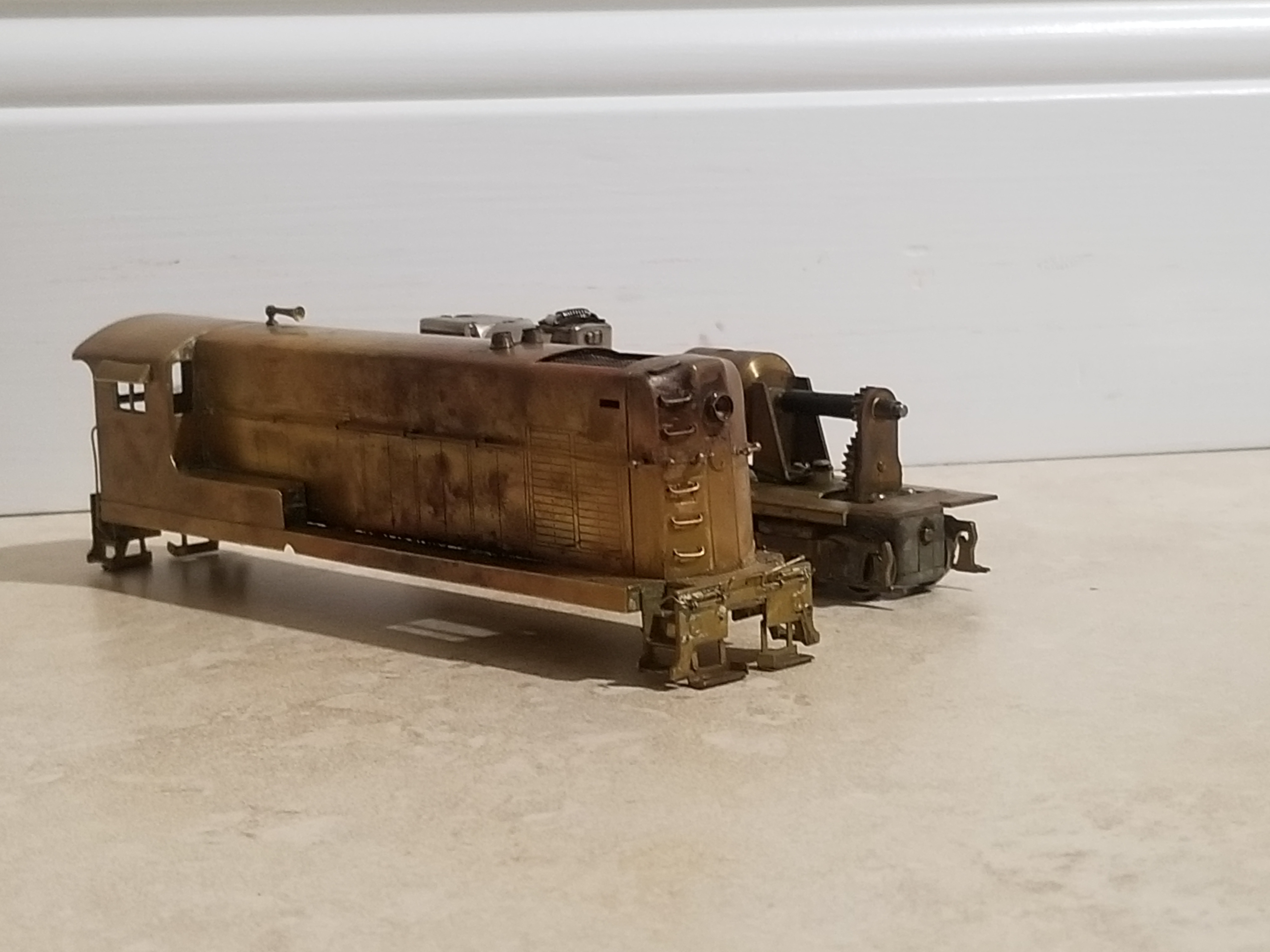

 Posted - November 04 2019 :  08:13:27 AM Link directly to this reply  Show Profile  Add BlaxlandAlex3 to Buddylist
We have made progress! "Fairbanks" now is all clean, most of the notable areas of brasso gunk are gone, and I fixed some imperfections in the chassis with the trucks. A test run yielded that everything is A OK! I screwed the shell onto the chassis for the first time since my dad bought him for me at my first train show. Over 7 years ago! Now it is time to work on cosmetic stuff. I will have to find suitable brass wire to make the handrails. Shouldn't be too hard. Brass wire is easy to bend.
Does anybody know where I can get some?
Pics to come later

 Posted - November 04 2019 :  10:34:08 AM Link directly to this reply  Show Profile  Add scsshaggy to Buddylist
In the picture, your model appears to use a hand rail stanchion that's common across a lot of brands and is usually drilled for .020" wire, so I assume that's the size wire you need.
Clover House has straightened brass wire and coils of phosphor bronze wire. The Phosphor bronze is springy so it's a bit tricky to get bent just how you want it, and coming in a coil, it won't make as straight of a railing. On the other hand, it comes in .020" diameter. The straightened brass wire comes in .018" which is pretty close, and would be easier to shape.
http://cloverhouse.com/Cart/
K&S Precision Metals has round brass rod in .020", that really amounts to brass wire that's nice and straight and is a good starting point for hand rails. If you have a local hobby shop, it may have a selection of K&S products. Many do. Otherwise, you can order online from K&S.
http://ksmetals.com/

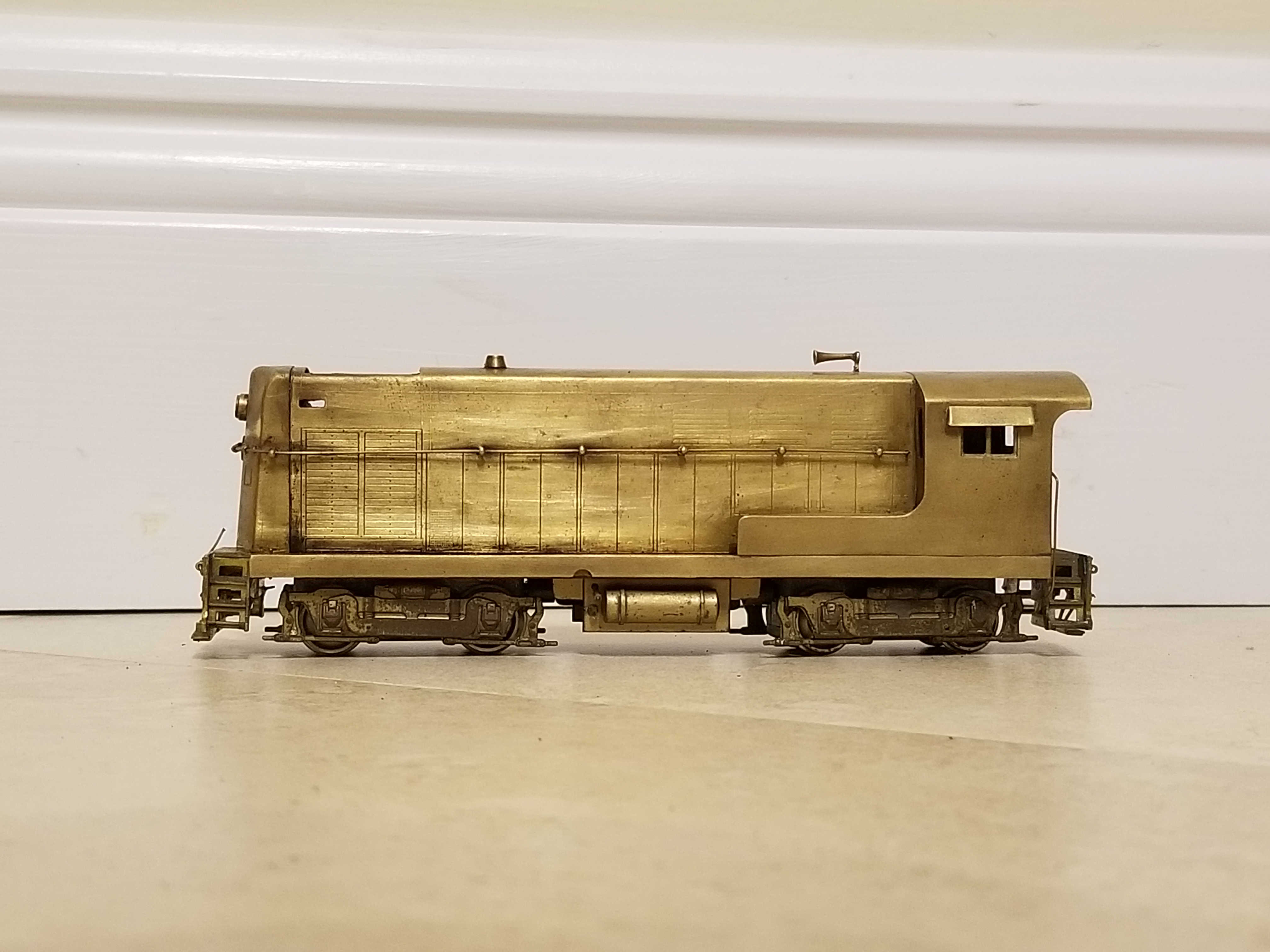

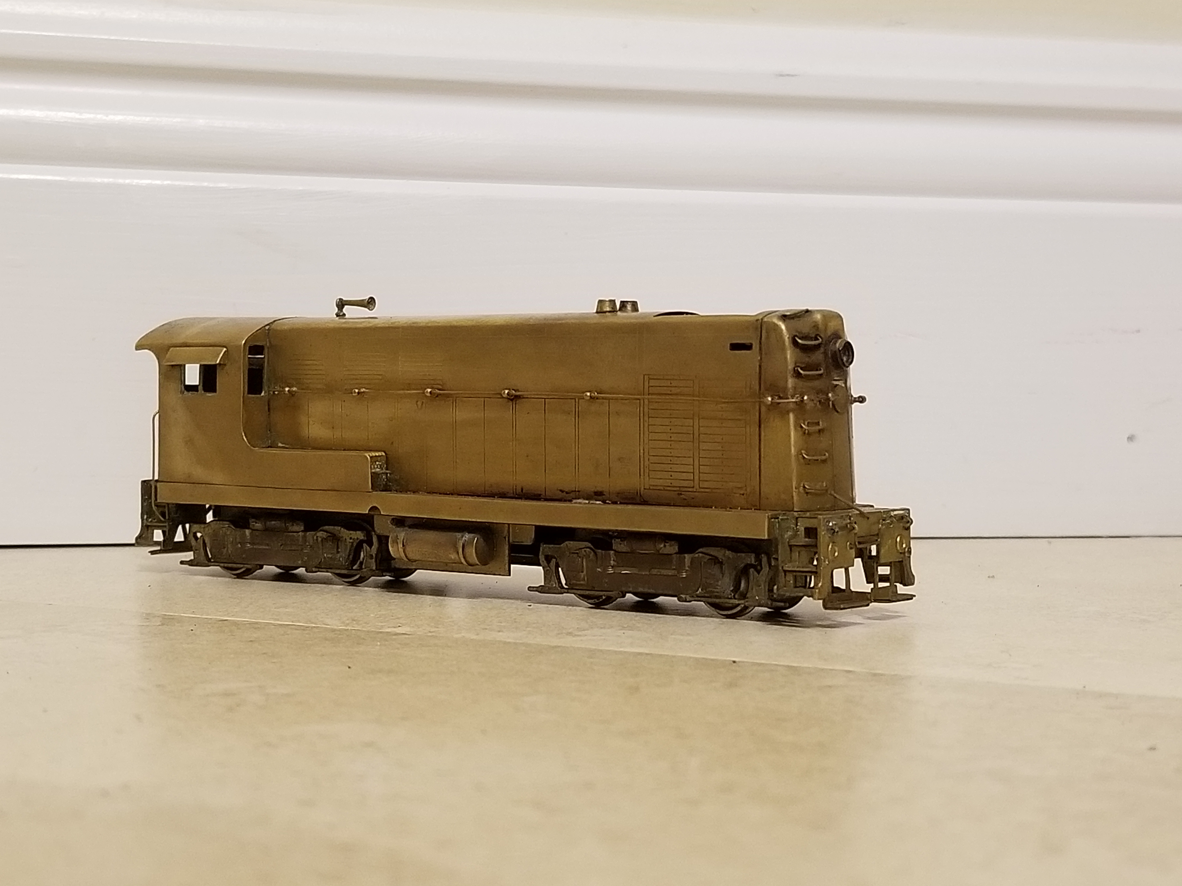

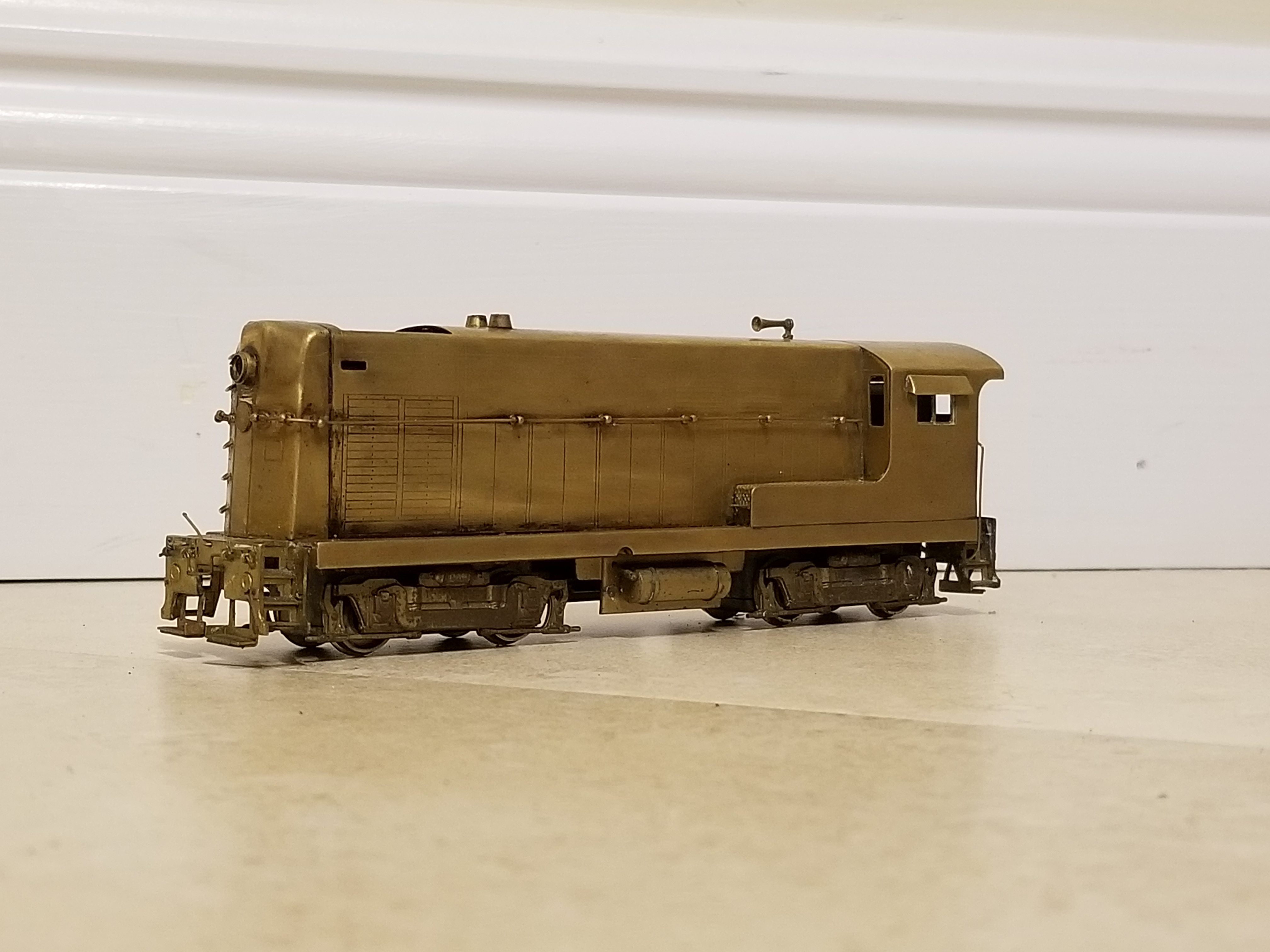

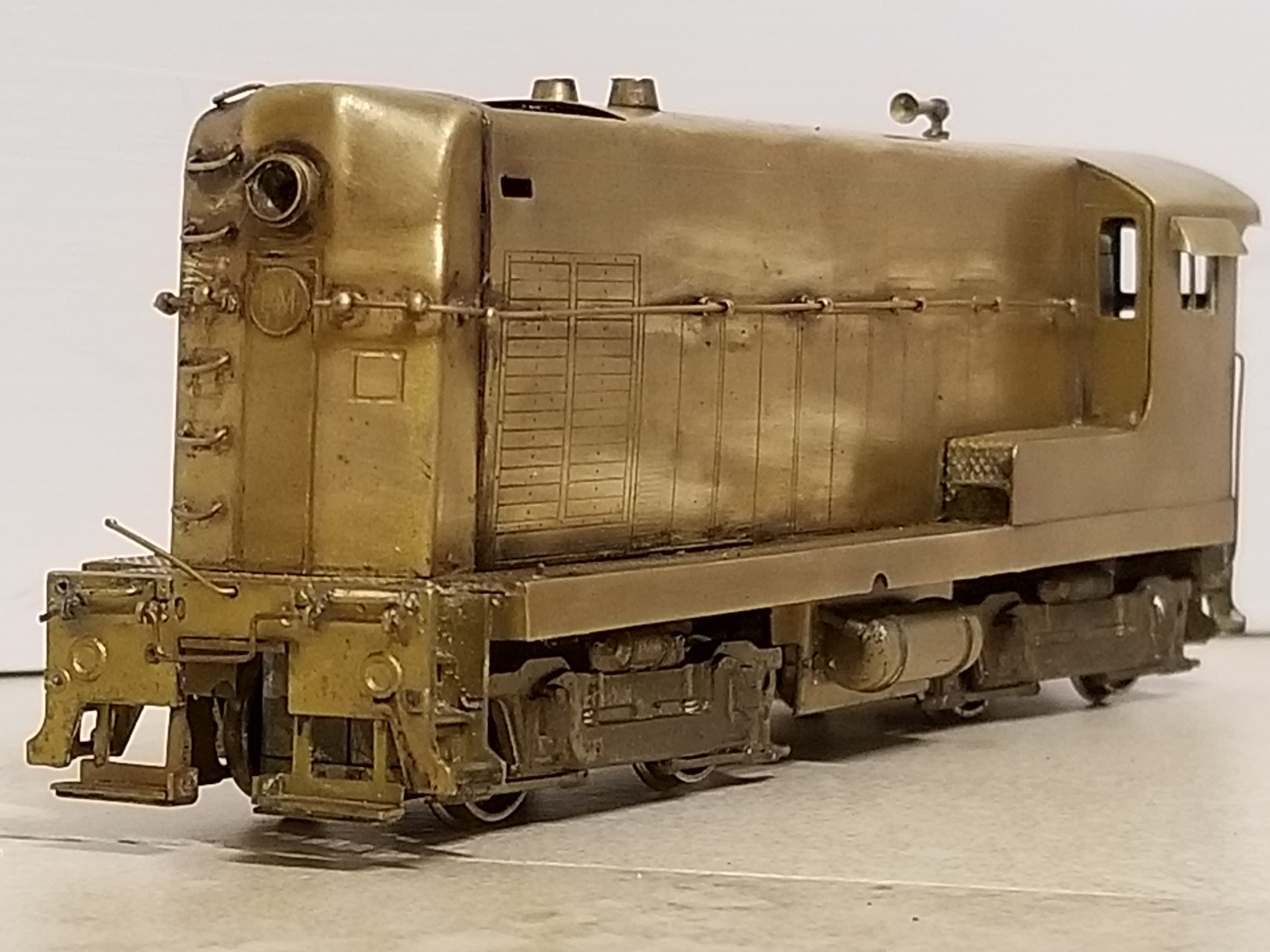

 Posted - November 04 2019 :  5:05:10 PM Link directly to this reply  Show Profile  Add BlaxlandAlex3 to Buddylist
Here's the pictures, as promised.
I'm not TOTALLY concerned with making him shine, because in the series, Fairbanks is the villain, so he should look a bit grubby. The burn areas I couldn't get actually look a bit like weathering!
All that's left now is to take care of the missing handrails!

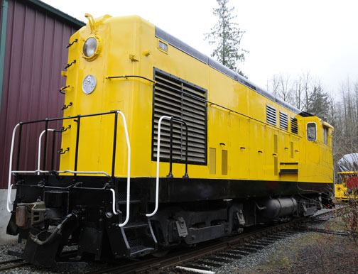

I think your handrails are mostly already installed. It would be good to check prototype photos first. Many first generation diesels did not have handrails along the outside of the walkway. Rather, there was just one long grab iron running along the hood of the locomotive, as is shown on your model. This may seem rather odd at first, but keep in mind that the direct predecessors to these first generation diesels, steam locomotives, also did not have handrails on the outside of the running board, but rather just one long grab iron running along the boiler. Railings on the front and rear decks, and next to the steps would be good to add.
See this photo of H 12 44 Fairbanks Morse Weyerhaeuser #1 at Snoqualmie, WA. https://www.trainmuseum.org/images/locomotive%201.jpg

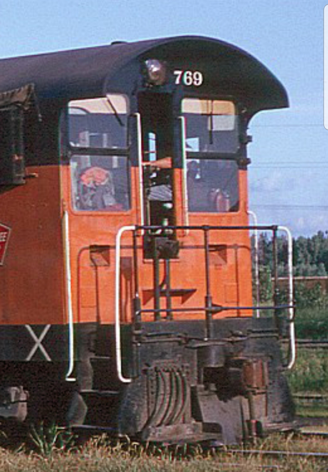

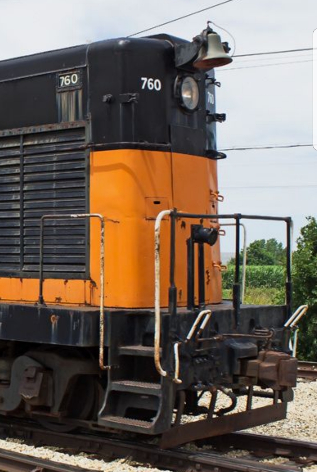

Yes, I am aware. Sorry i did not clarify. the handrails I mean are the ones that gi across the front and back, and there are two other small ones that are at the front as well. No, I am not putting them along the entire running board. Here are some pics showing which ones I mean.
BlaxlandAlex3
Jupiterpfp2
 Posted - November 05 2019 :  07:03:15 AM Link directly to this reply  Show Profile  Add BlaxlandAlex3 to Buddylist
Originally posted by weekendrailroader - November 04 2019 :  10:32:44 PM
Yes, I am aware. Sorry i did not clarify. the handrails I mean are the ones that are across the front and back, and there are two other small ones that are at the front as well. No, I am not putting them along the entire running board. Here are some pics showing which ones I mean.
Originally posted by BlaxlandAlex3 - November 05 2019 :  07:01:48 AM
You can even see a small brass wire sticking up out of the front from where they used to be.
