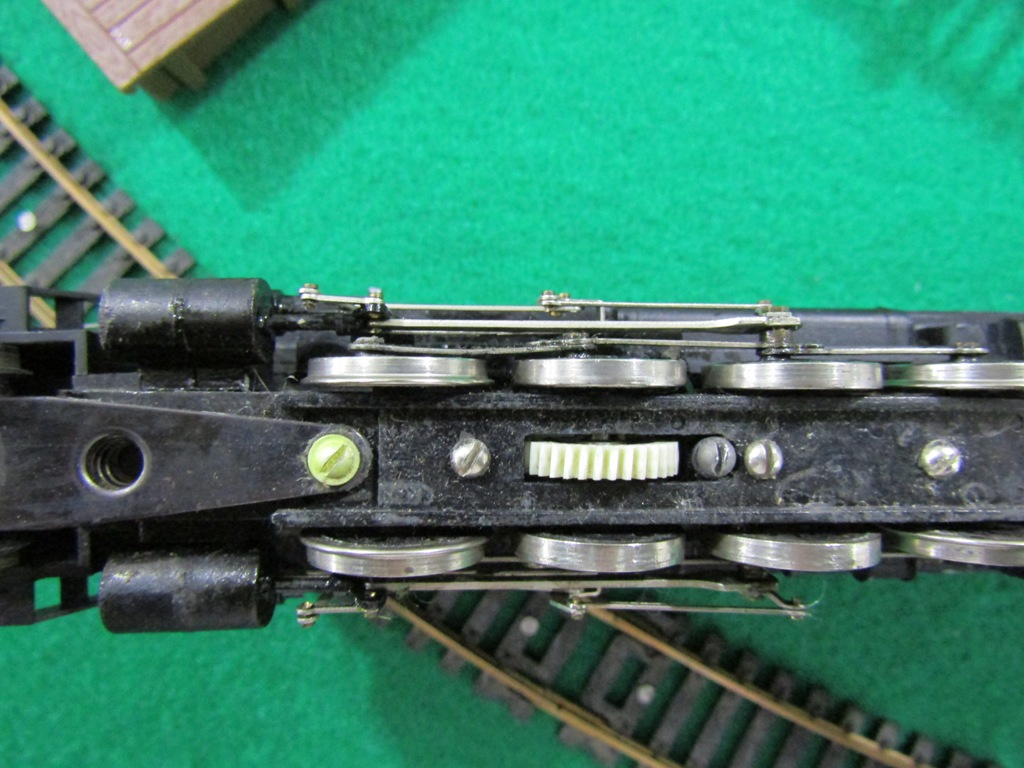

Good evening all,
So, I just received an awesome early Brown Box Era Tyco Steam Locomotive in the mail today that I purchased at a good price off of Ebay (not going to reveal the type just yet ) however, I am having a major issue. For some reason, my steamer will barely run - it crawls along the track even at the highest speeds, and is prone to just stalling. All of the contacts are fairly clean, I lubricated the gears and pistons, and even tried adding magnets to the back of the motor, but all to no avail.
Any help/advice would be appreciated.

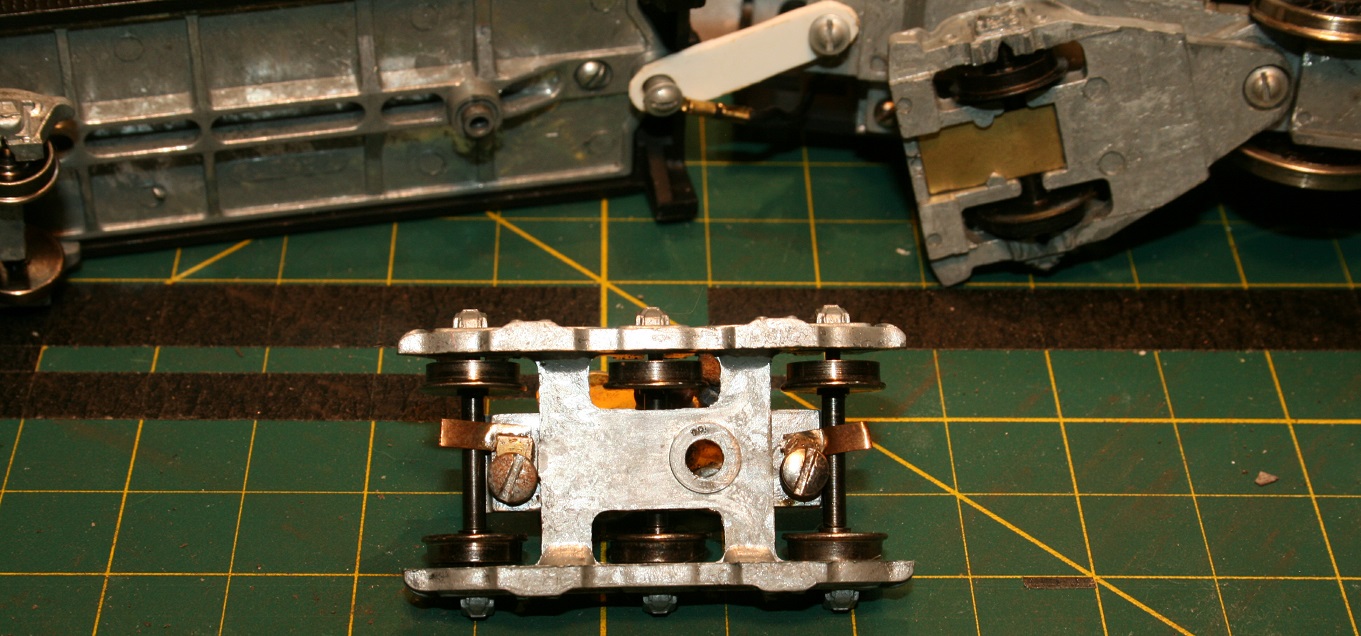

I suspect the problem is the power pick-up from your locomotive's tender,
I have had several Mantua steamers with the same problem.
Try running your locomotive at full throttle for a few minutes and then check
to see if the journals on the tender's trucks feel warm to the touch. If this is
so, the electrical current from the rails is meeting resistance where the tender
wheelset's needle point axles interface with the truck side frames.
To solve this problem you will need to add phosphor bronze wheel or axle wipers to
provide proper electrical contact so that electrical current can pass freely from
the tender's wheels to the tender frame.
The photos above show how I modified my tender trucks, the phosphor bronze axle
wipers I used for this modification were made by Tomar but any phosphor bronze stock would
work.
Good Luck

 Posted - October 13 2019 :  10:03:19 PM Link directly to this reply  Show Profile  Add RP model railroads to Buddylist
Just ran my....okay...gonna reveal it...Tyco Pennsylvania RR "Mikado" 2-8-2 tonight, and even after 30 minutes of running, the speed barely improved. I lubed up a few more joints, and instead, the motor just got hotter and hotter, as well as the contact screw-points on the tender wire.
Running out of options now.... Srenchin, that makes complete sense - Thanks! Will add "axle wipers" to my wanted list.

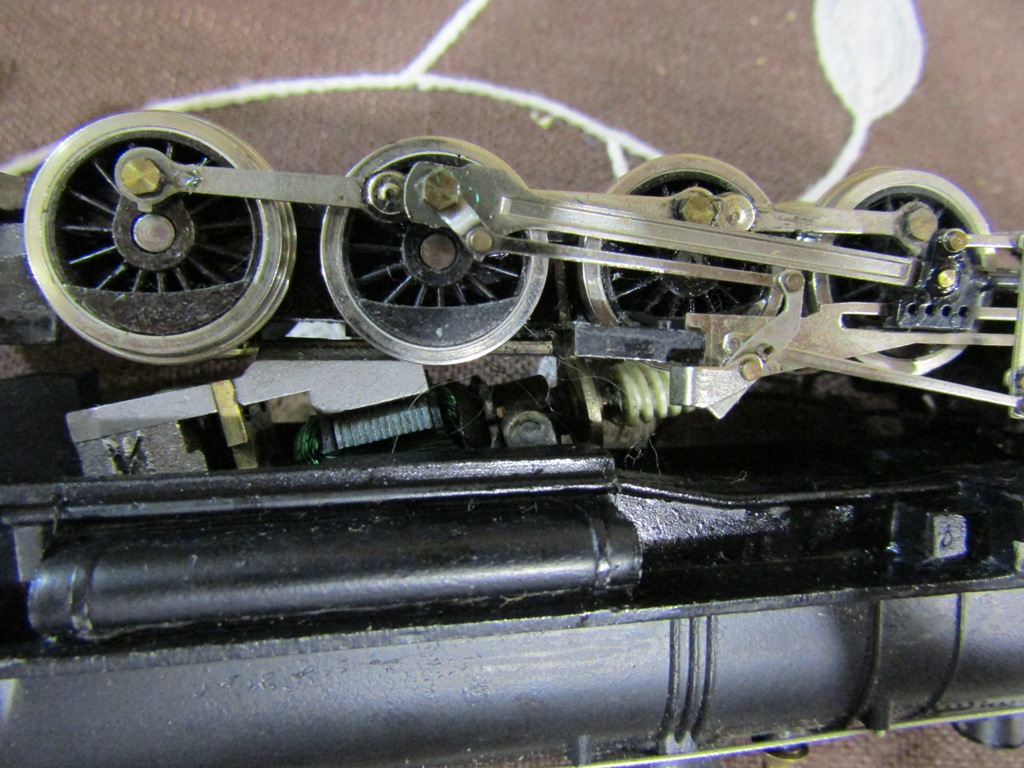

While analyzing my "Mikado" a bit more tonight, I discovered one of the rods was bent in....I bent it back out, but that did seemingly nothing.
Now what should I do? I did notice some hair wrapped around the drive-axle (above the worm gear)...perhaps that is causing the trouble.

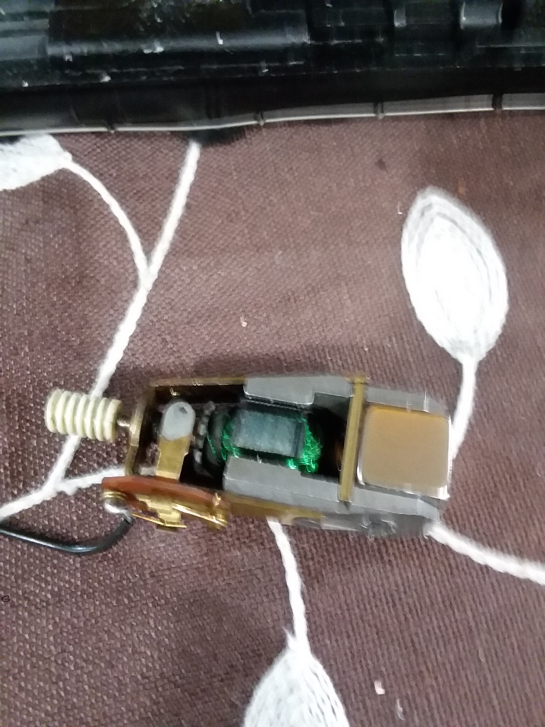

Anyhow...I accessed the motor tonight, and the actual copper wiring windings look pristine, therefore the motor is quite healthy. Upon trying to rotate the motor with my hands, it was a little rough, so I lubed-up both bearings, which worked great. I then removed the hair wrapped around the drive axle and reassembled everything.....to get the same performance as after adding the contacts in the tender trucks - no better/no worse.
I then decided to test the magnet, and sure enough, it is weaker then I expected, as compared to other Tyco MU-2 style motor locomotives I have. Now I'll begin hunting for new, stronger magnets that hopefully will improve performance.
Here's a shot before I removed the hair....

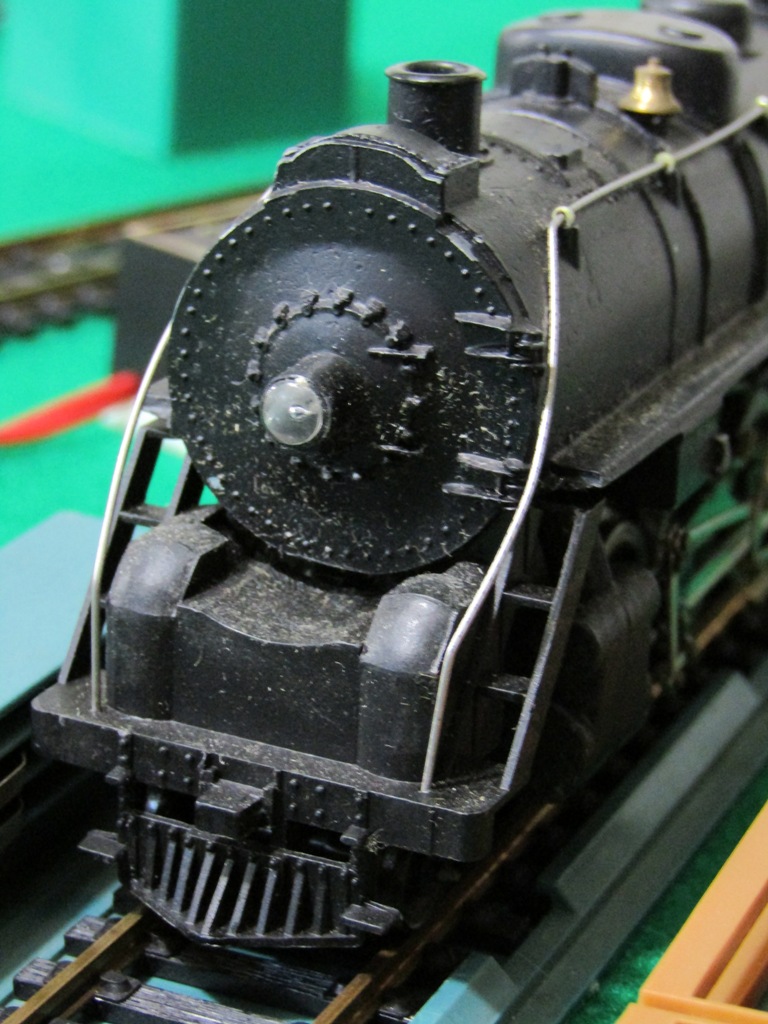

Finally received the magnets in the mail today, and got right to work tonight.
I first tried to be lazy and just attach the magnet to the present magnet - and it did nothing (as expected.)
I then proceeded to unscrew everything, and using a metal bit, drilled-out the rivet holding the old magnet in place, removed the rivet, and installed one of the brand-new earth magnet "cubes." I then re-assembled the Mikado, put it on the rails, and low & behold, it ran a LOT better. However, it was running in reverse when it should have been running forward, so I disassembled everything again, and switched the magnet poles around. Problem solved.
Unfortunately, the light bulb wire got disconnected somewhere in the 1st disassembly process, so if anyone could please tell me where that wire goes, I would greatly appreciate it.
I will definitely publish a video of my Mikado running on RETRO TYCO II sometime soon, so stay tuned!
