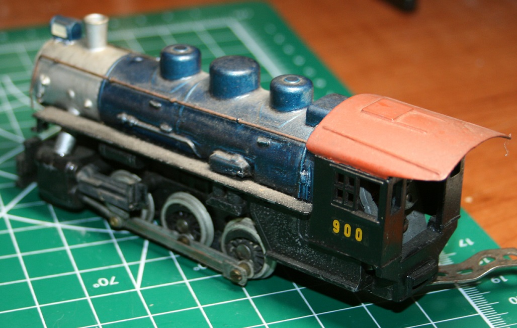

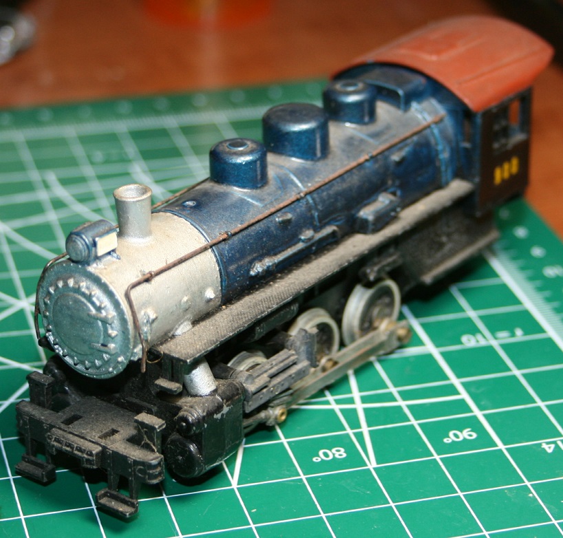

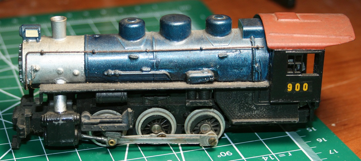

Today while checking out my local hobby shop's used
HO equipment shelves, I found this peculiar looking
0-6-0 switch engine. I am usually pretty good at
identifying model manufacturers products but this one
has me stumped. I can't find a makers mark anywhere
on it and the tender is missing. Does anyone out there
know who made this????
This model currently doesn't operate, as a matter of fact it short circuits my
transformer when I connect power leads to it. It would be nice if I could
get a hint on who made this thing at least!

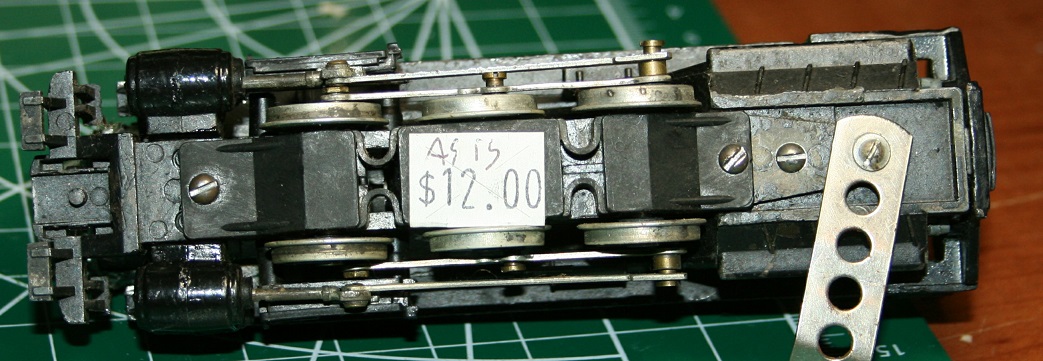

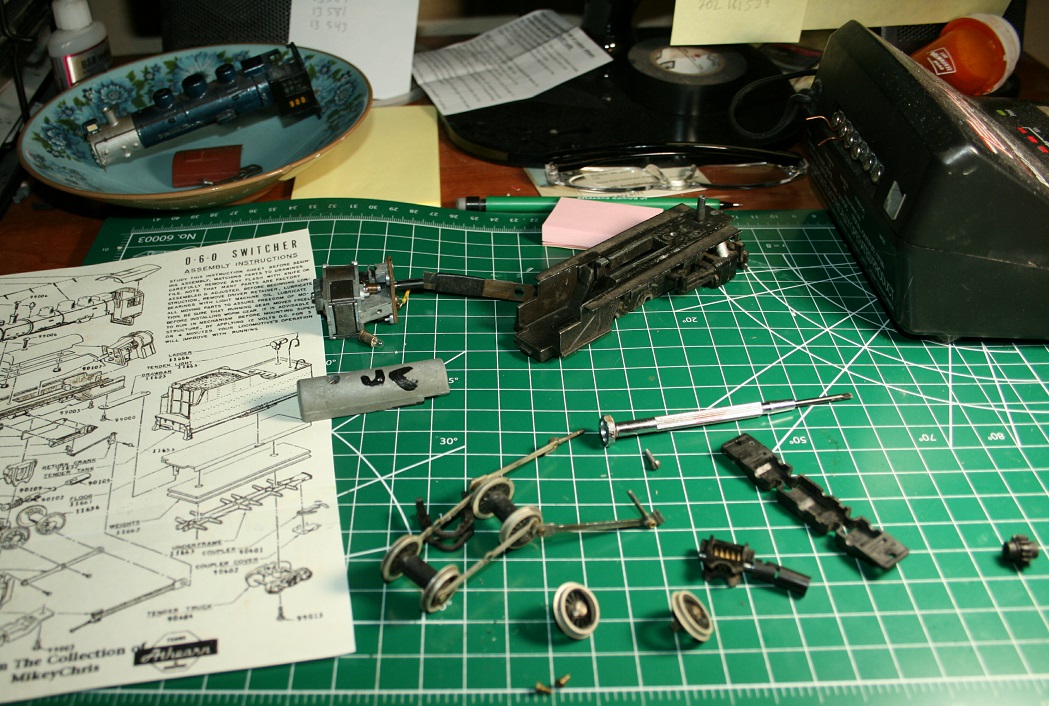

As you can see from the next two photos, I went to "HO Seeker"
to print out an instruction sheet for this model and then disassembled
it to see why it wasn't running....

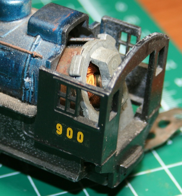

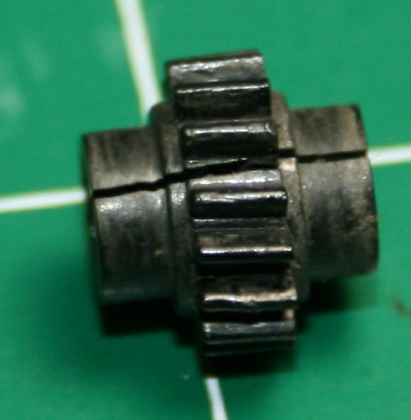

After taking the model apart, I confirmed that the motor was
in working order so that wasn't the problem. It was only when I removed
the gear box that I found a problem. The axle gear is cracked...
Of course this doesn't explain the electrical short, but with a broken axle gear
this locomotive is not going to move under its own power. I don't suppose
someone out there has an old geared axle part 11641 they are willing to part with?

I wonder if a metal ferrule on the plastic sleeve on either side of the gear would pull the crack shut enough to make the gear work. A short stub if metal tubing that's a tight press fit onto the outside should do if the right size could be found.

That cracked drive gear is what killed Athearn steam locomotives. It is common to all of their first steamers. Then with their Genesis 4-6-2 and 2-8-2 having the same problem. I bought 2 of each and only one mike Would run. The inability of athearn to make a gear of a steamer and even 50% reliability was unattainable for them. They refused to seed me replacement parts. So since that day I refuse to buy anything new with their name on it. For me that has been a long time. Also at $12 you overpaid for a useless piece of junk. The only use for it is in a HO junk yard. From what I see of yours you won't even have to weather it.

That gear looks like the one the use in their new diesel locamotives.
