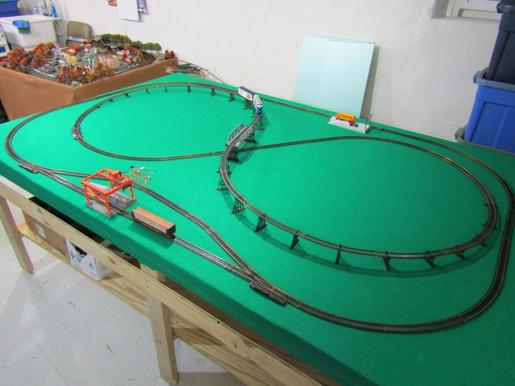

I am considering purchasing a Tyco Block Switch to use on RETRO TYCO II.....in order to "park" a locomotive on the siding on the right-side of the layout-in-concept.
Photo credit to Original Photographer
However, I'm a bit confused as to how to properly wire the Block Switch - do you need "powered" switch tracks???
If anyone could provide photos/instructions, that'd be great.

Well...I think I solved my problem. Just bought a Tyco Blocking Controller, with original box and instructions off of Ebay at a great price. I definitely will scan the instructions and post them here for anyone to reference.

EZ PZ, just put insulators on one side of the rails at each end you wish to block, like your siding. Add a feeder wire to that blocked rail with an on/off
toggle off your choice, and from the toggle to the regular DC output on
your transformer.
This way you apply power or turn off power to one rail in that block,
thus controlling the train's activity.
How you run that on/off feeder wire can bed one using one
terminal of a standard power track, or by using a soldered
rail joiner. Just be sure if you use a terminal track, that
the feed wire is to the one rail that you block.

Ah ha! That makes sense -- thanks Chops!
