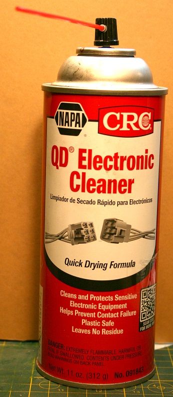

I agree, old hardened gear lube will not only cause
poor operation but could also cause permanent damage
to the mechanism. Tyco incidentally was notorious for
over lubricating their locomotives at the factory. If
your old engines have never been properly cleaned,
old gear lube may be causing your problems.
Whenever I acquire on old locomotive that has not
been run in a long time I clean it out with a
PLASTIC SAFE electronics cleaner.
This is a picture of the product I use....
You can buy this product from you local auto parts store.
Make sure which ever brand you use, it must be
PLASTIC SAFE . Also, do not run
voltage through the motor while spraying the cleaner into
it, this stuff is VERY FLAMMABLE and WILL set your
locomotive ON FIRE if you spray it into an energized mechanism.
This stuff will dry quickly so just wait a few moments for
the cleaner to evaporate before testing you model with power.
Good Luck, let us know how it goes.

Would it be QD on the copper on the core? Both sides had some dark streaking/dirt. Magnets? Brushes?
I plan on OxGuard on the core (as in the video), 3 in 1 (or what else?) on the shaft on the core, and not sure about oil or grease for gears and wheels.
