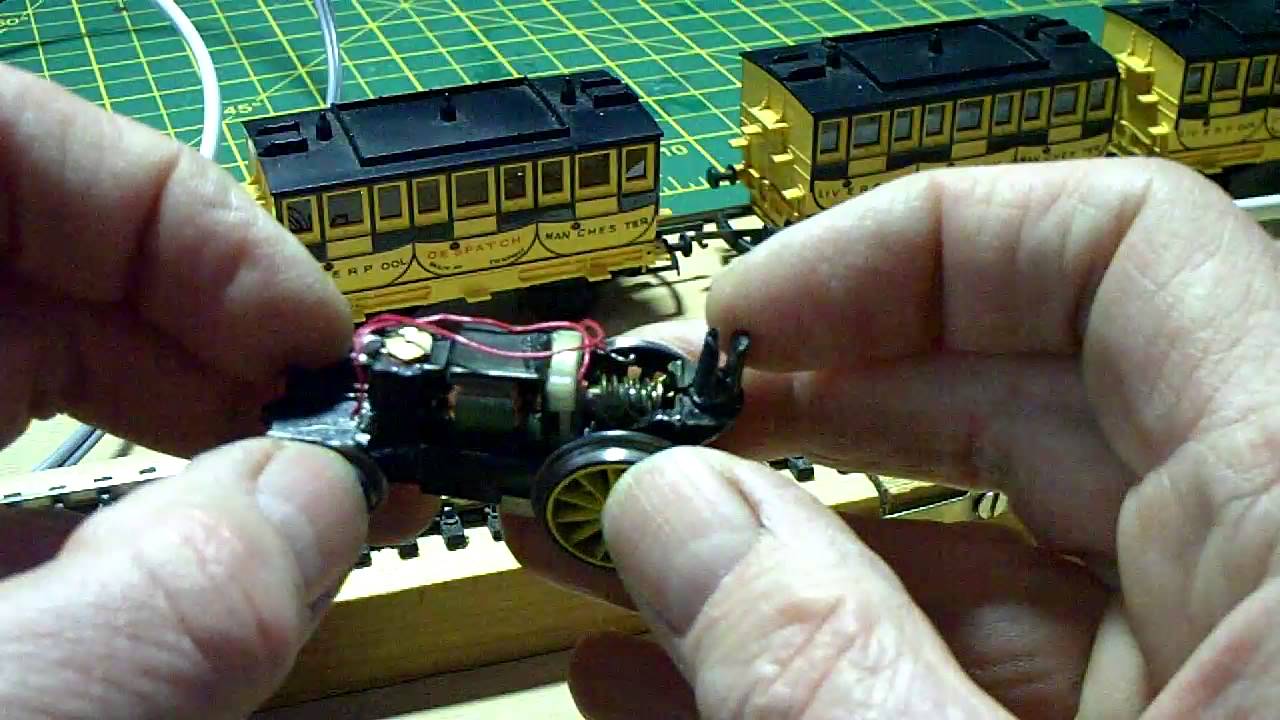

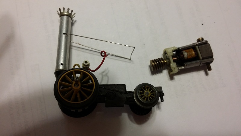

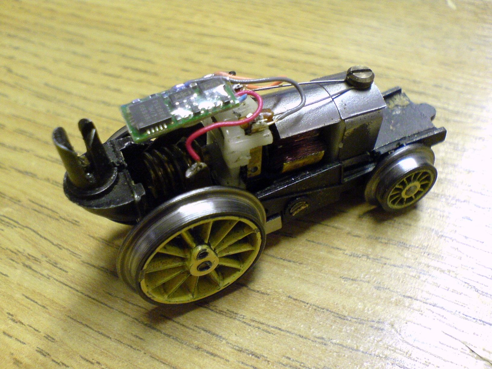

As I'm by no means an electrical expert...here are photos I found on Google that do a good job of showing where the wires connect (the first one is illustrating how someone DCC'd a Rocket.)
Hope this helps...somewhat..

These are sweet little beasts, made in the early 1960s and then again around 1979/80, but never since. Sadly they are little tempremental, as I am sure you already know.
The X500 Motor is bespoke to this model, it was similar to the later Minic Motorways Jet Speed motors, but had a longer shaft and was wound differently. I bought a spare motor direct from Hornnby in the early 80s as my model had also failed. They have not been available for some time and I have never known anyone to be able to commercially re-wind these
The model has a split chassis, which was an early use of this type. So essentially you need a connection from each side of the chassis going to the brushes, which seem to be missing, along with the brush spring, brush spring insulation and connecting rods.
Here is the service sheet for the motor: http://www.hornbyguide.com/service_sheet_details.asp?sheetid=253 <http://www.hornbyguide.com/service_sheet_details.asp?sheetid=253>
And here is the one for the complete Loco - http://www.hornbyguide.com/service_sheet_details.asp?sheetid=252 <http://www.hornbyguide.com/service_sheet_details.asp?sheetid=252>
Here is a later service sheet for the loco, which I think is a little clearer: http://www.hornbyguide.com/service_sheet_details.asp?sheetid=127 <http://www.hornbyguide.com/service_sheet_details.asp?sheetid=127>
You will note that the early service sheet shows a Suethe type smoke unit in the chimney whilst the later one now shows some hind of supressor..
To specifically answer your question - The motor is held into the bigger half the metal frame by the long screw that is still present. The scew head end is also the anchoring point for the kind of V shaped brush spring. One side of the spring is insulated with some sleeving and the red wire goes to a tag that clips in here with the brush. On the other side the bare metal of the spring touches the brush directly and makes the second electrical connection.
Whizzzzzz! Off you go, or quite possibly not, given how awkward these things can be, but sdaly that is all the help I can offer.

 Posted - June 11 2019 :  12:42:47 PM Link directly to this reply  Show Profile  Add Chops124 to Buddylist
Thank you for that, it is not split down the center, but
does seem to be split down one side with a thin layer
of plastic, or something, separating the two halves.
What I see in your image might appear to be
an N scale decoder, not sure at all, really, as it
has only two, not four wires.
None the less, all the bits that were last in it when
it ran are there. The only thing is the red wire is
disconnected, and maybe that is the root of the
entire problem...
Thank you for the diagrams, which I just looked at,
and the brush assembly appears to have vanished.
This may end up being a display piece, after all.
