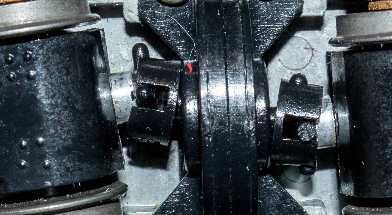

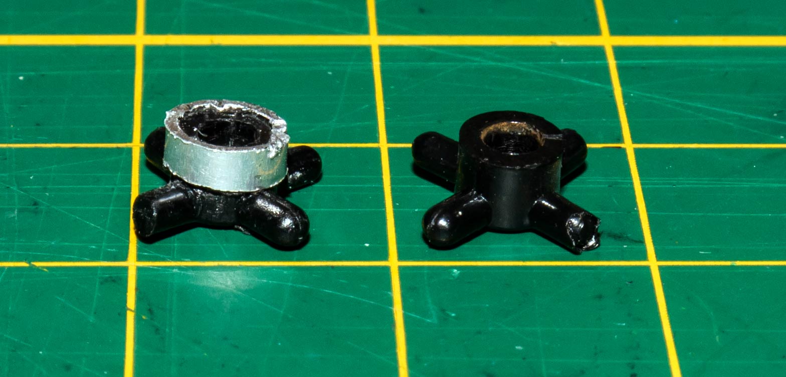

how many here suffer from cracked gears etc on boxcabs,thanks to 2 guys,1 who posted it,and one with the idea here it is,using K&S Metals #8104 a perfect solution was found,check it out
ps the collar in photo was tidied up,this was just a trial run photo

 Posted - March 03 2019 :  09:17:47 AM Link directly to this reply  Show Profile  Send catfordken a Yahoo! Message  Add catfordken to Buddylist
K&S 8104 12in 3/16 round aluminium tube .014 5522010
fits perfect and tightens the part in question,
if i can do it,anyone can

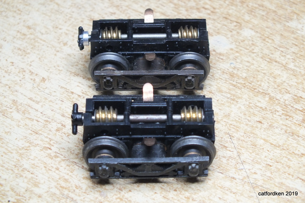

 Posted - March 03 2019 :  1:01:28 PM Link directly to this reply  Show Profile  Send catfordken a Yahoo! Message  Add catfordken to Buddylist
Bit dark,sorry but it shows they work well
bit better but blurry batteries going
