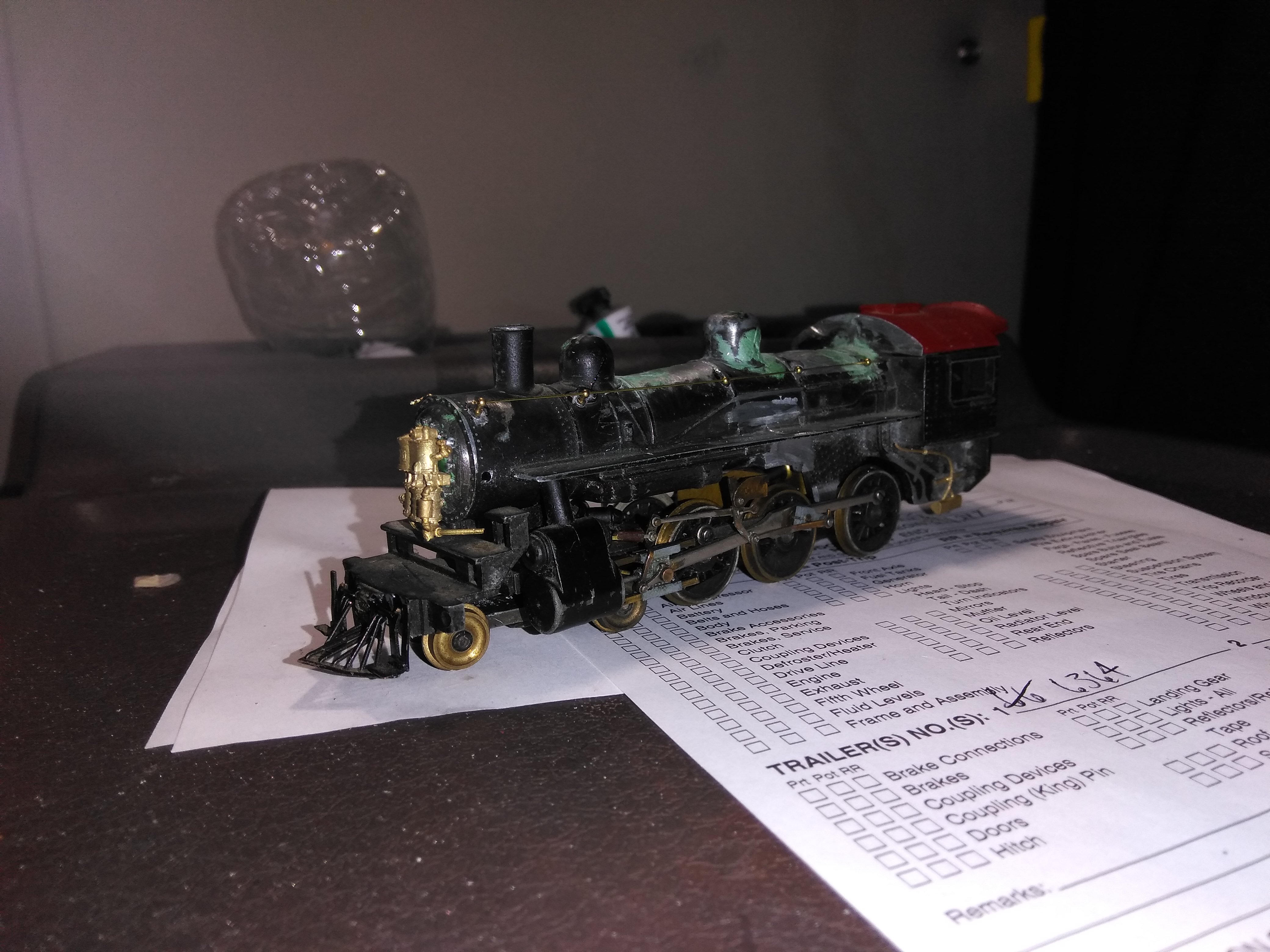

A Varney 4-6-0 under the knife. I since then replaced the pilot as I wasn't satisfied with it how it looked. I added blow down mufflers and a air compressor. I decided to install it on the smoke box door for a different look. I removed several cast on details with a Dremel and files.

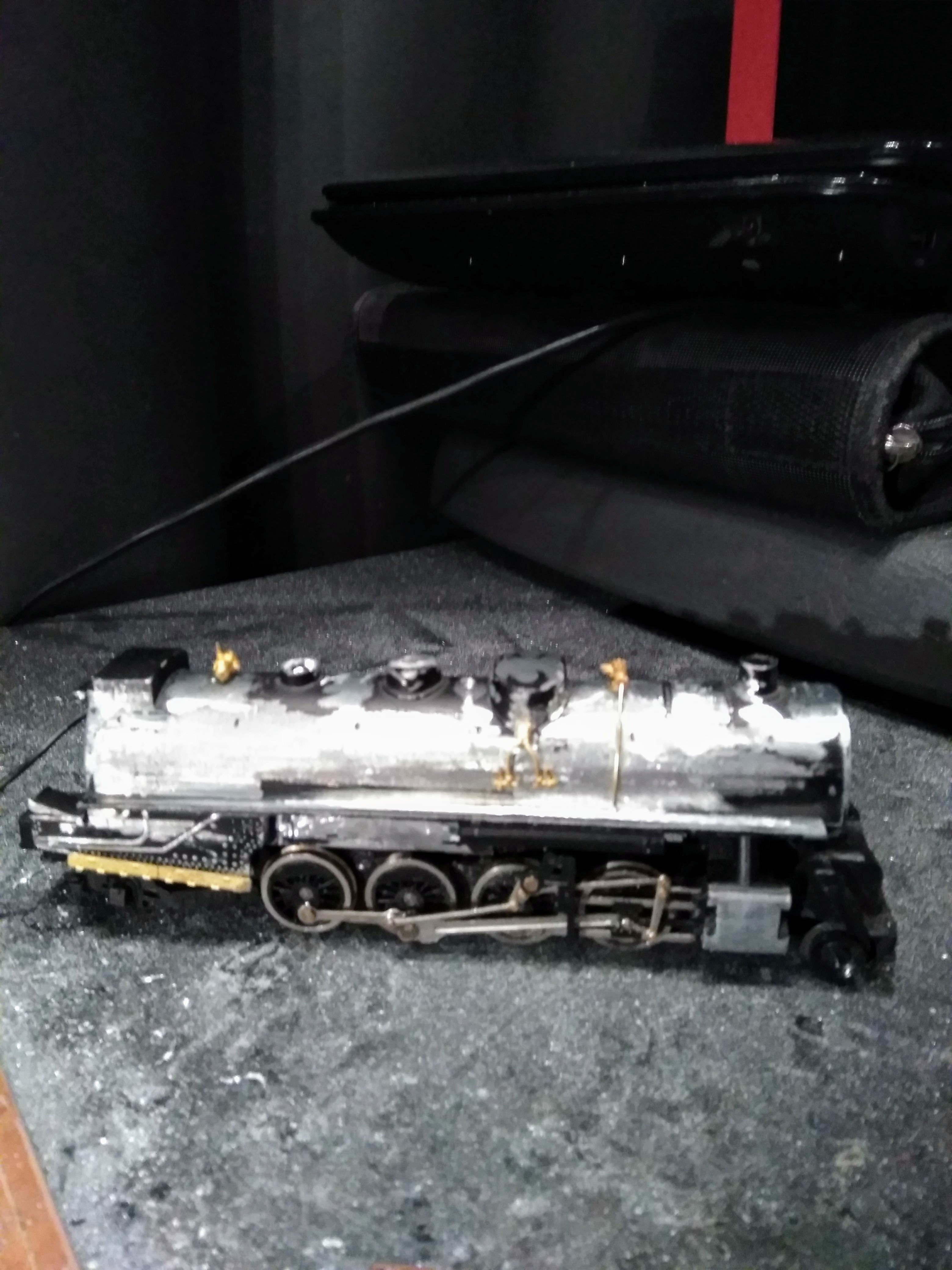

 Posted - October 19 2019 :  10:26:20 PM Link directly to this reply  Show Profile  Add Redneck Justin to Buddylist
Bowser 4-6-6-4 Kitbash in progress. Added Cary dual front mounted air compressors and a Cal Scale Elesco feed water heater. Have to buy some wire and plumb it. I found a trailing truck and installed it today as well.

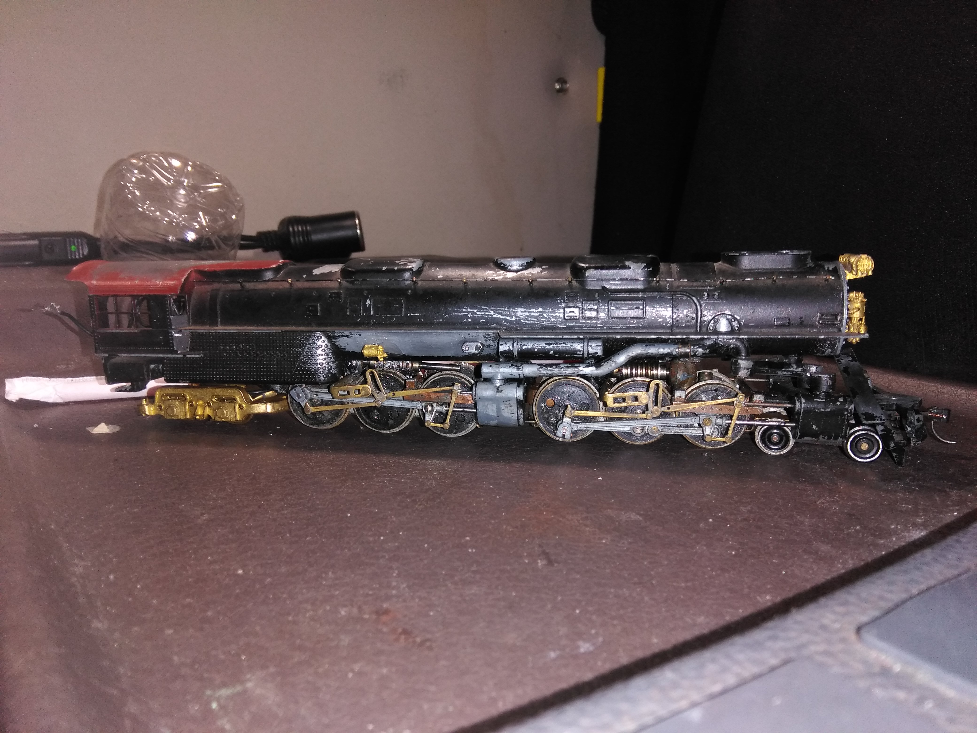

 Posted - January 18 2020 :  12:46:44 AM Link directly to this reply  Show Profile  Add Redneck Justin to Buddylist
Challenger Redo. My last one took a nasty fall and I about cried! Never sit them to high, forget it's there and take off down the road. Ouch! I bought 2 off eBay before Christmas and started right away on its new identity. It came with a long haul Pennsylvania Railroad tender from the I1s class 2-10-0. I mocked up a new coal bin wall to give it a very different look. Now to build the bin! I'm gonna build 2 possibly and make them different. The other one will receive a centipede tender. Hadn't decided what details I'll add.

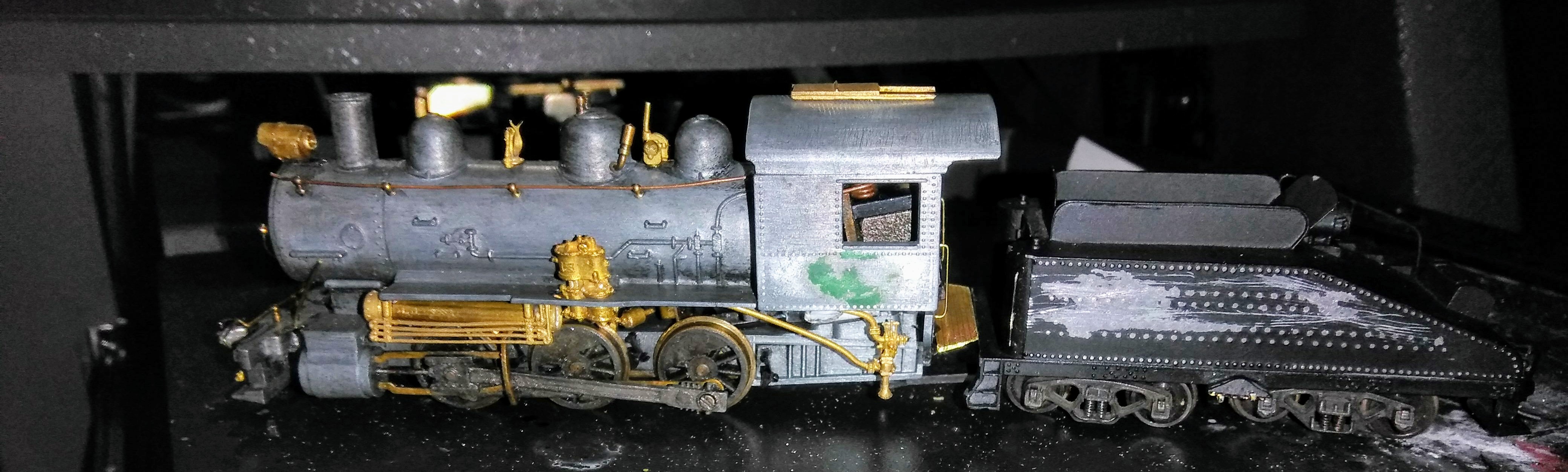

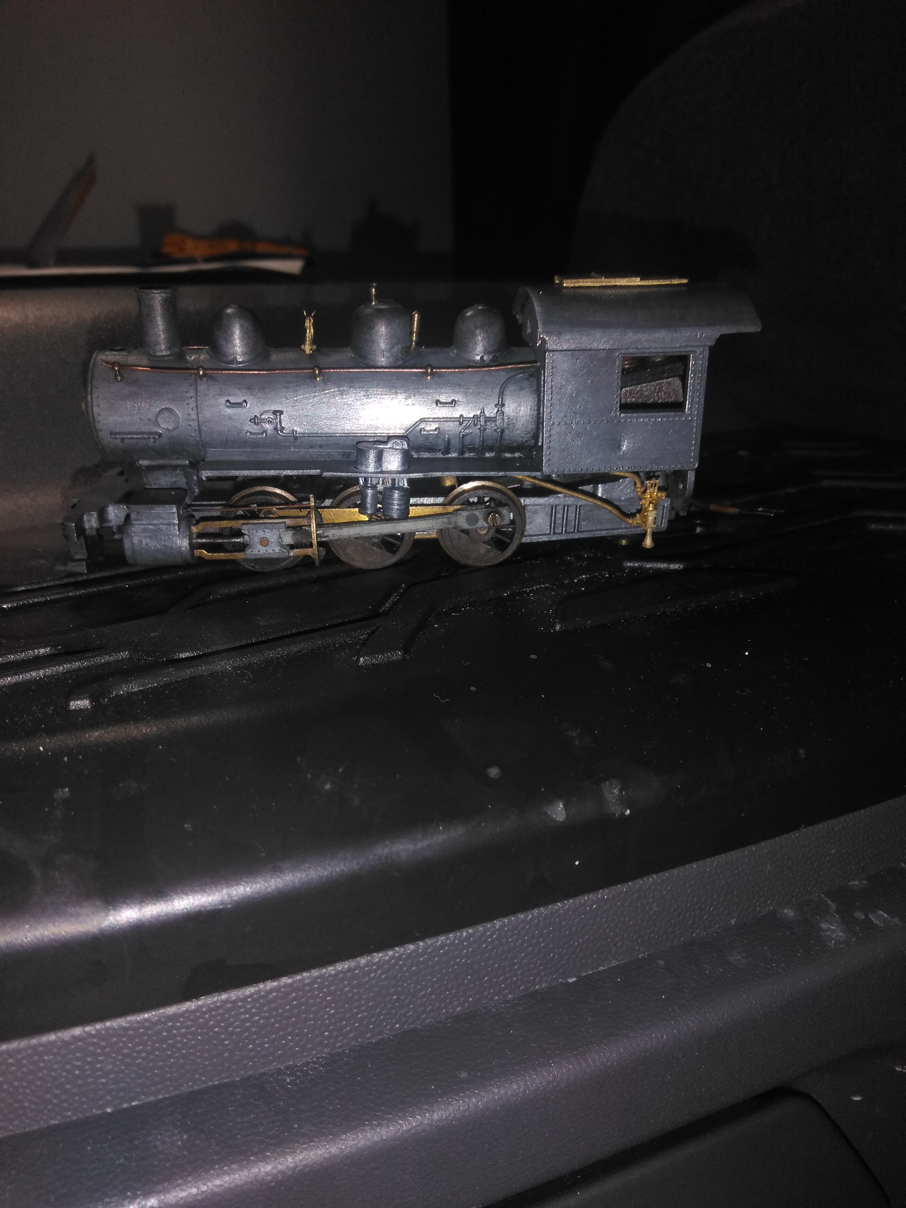

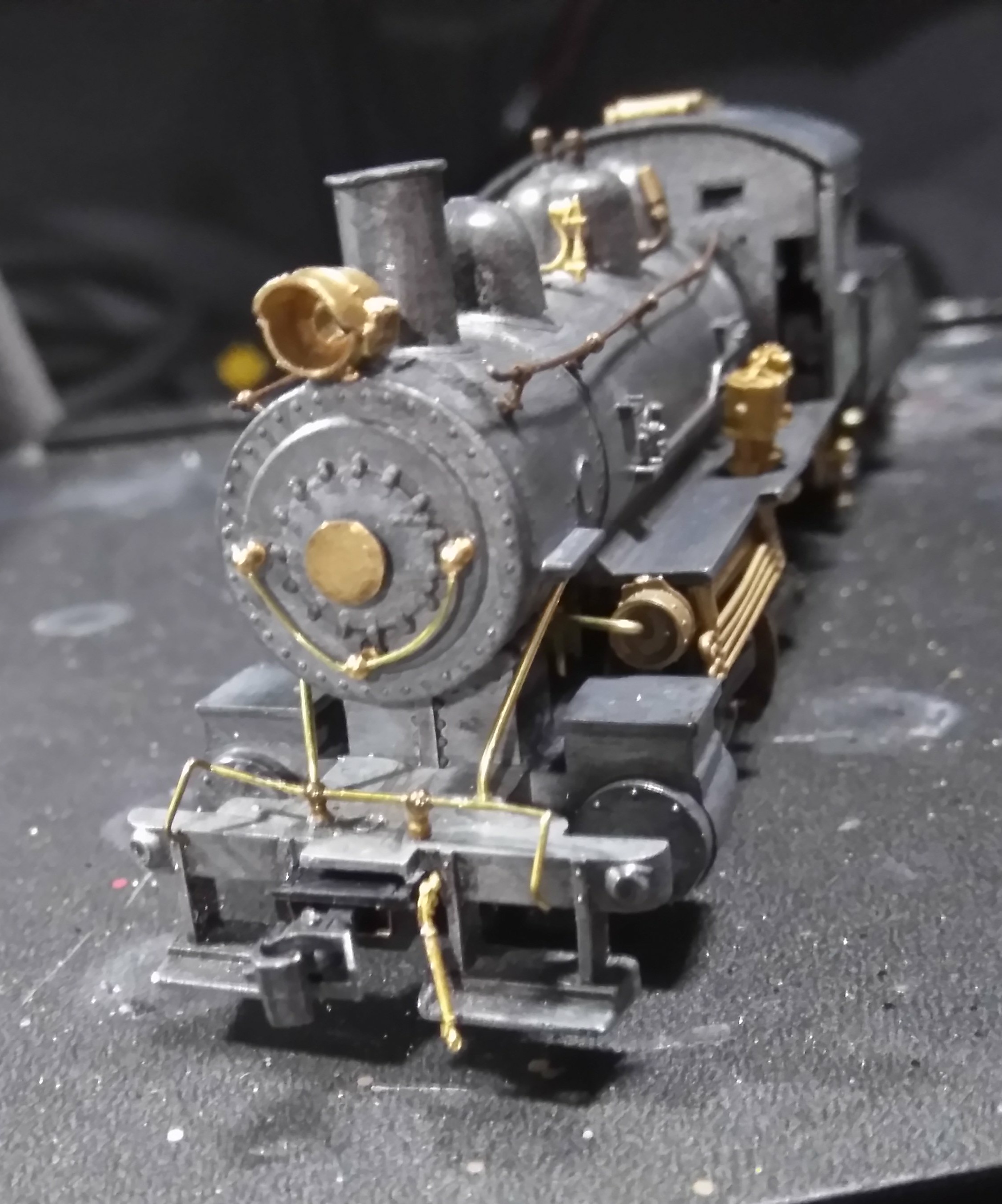

 Posted - January 29 2020 :  11:58:23 PM Link directly to this reply  Show Profile  Add Redneck Justin to Buddylist

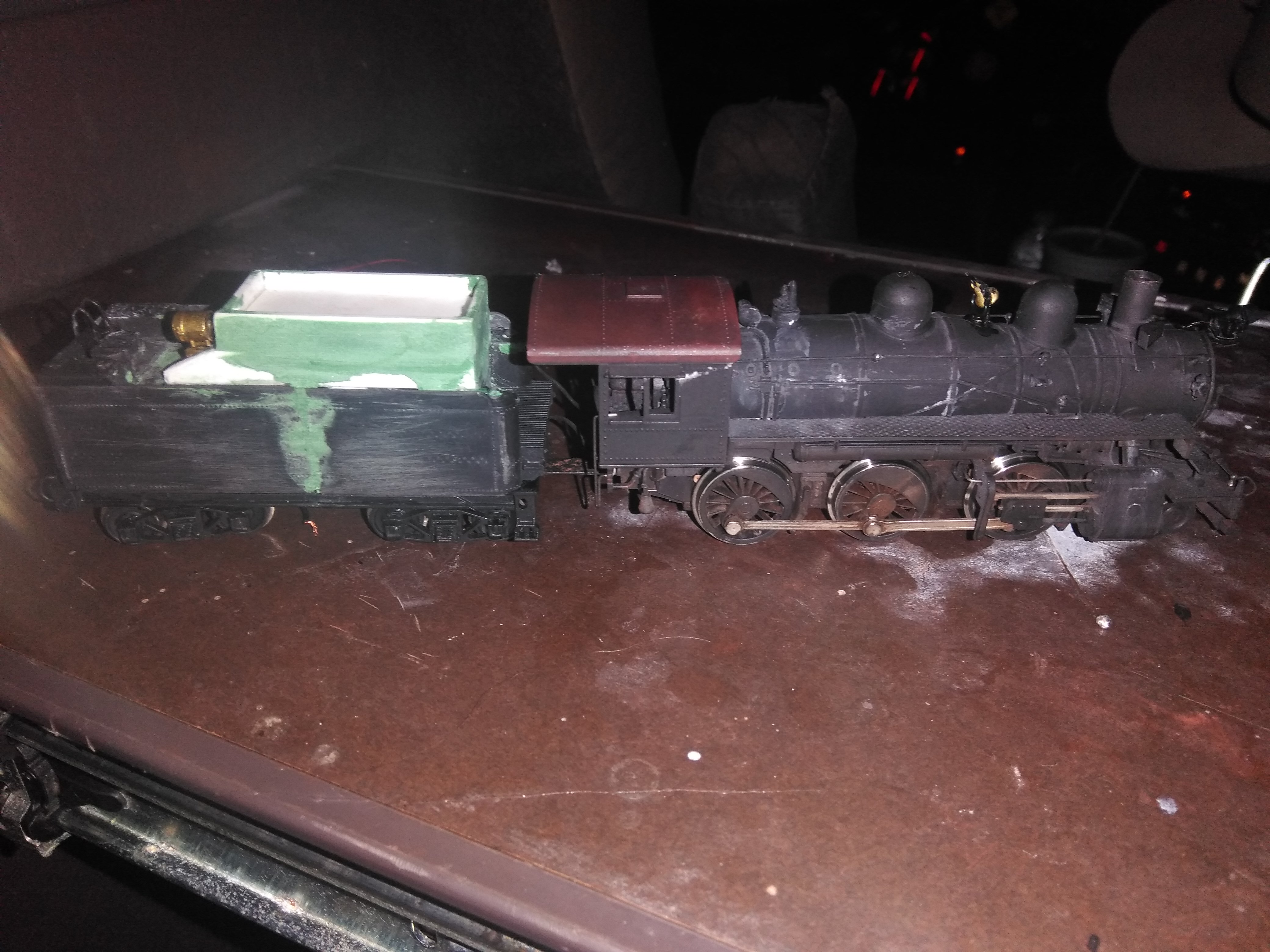

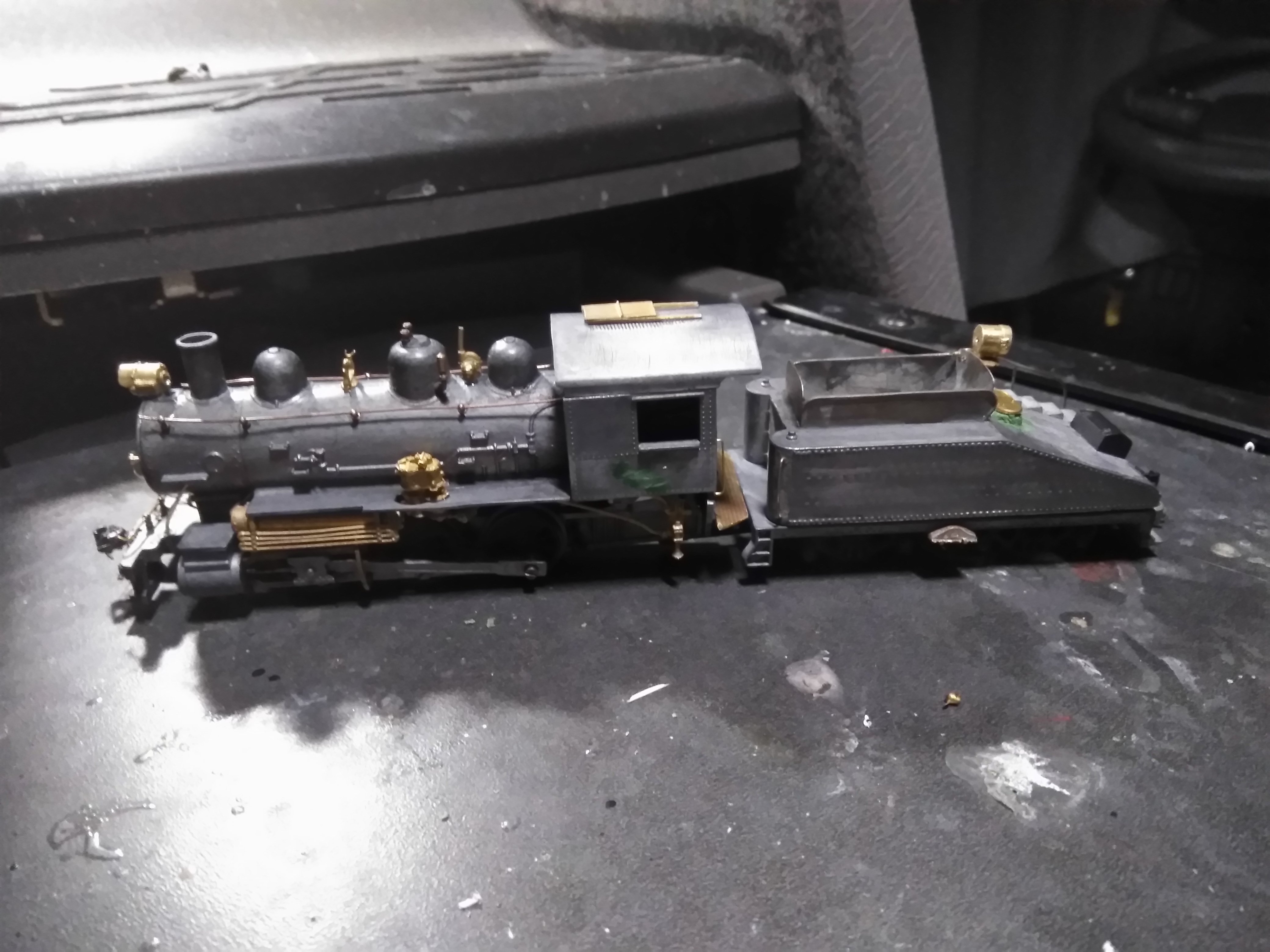

Transformeration of a MDC 0-6-0. Bought it a while back because I liked how the tender looked. It was done by the previous owner. I stripped the paint on the shell before I started. It was a awful glossy black paint job. Here is it before I start work and after it was stripped:
Here it is with no tender and some details. It has a bell bracket installed, a roof hatch and a non lifting injector installed. All parts are by Cal Scale. I have more to install. Air tanks, cooling coil, brake shoes, leaf springs, etc. I have all the parts now just about. Couple more I forgot to order. I didn't intend to go this far until I really studied the model and found it's very plain and lot of daylight between the boiler and frame!
 Posted - January 30 2020 :  2:12:02 PM Link directly to this reply  Show Profile  Add Chops124 to Buddylist
This will be amazing. Looks like a blank canvas now...

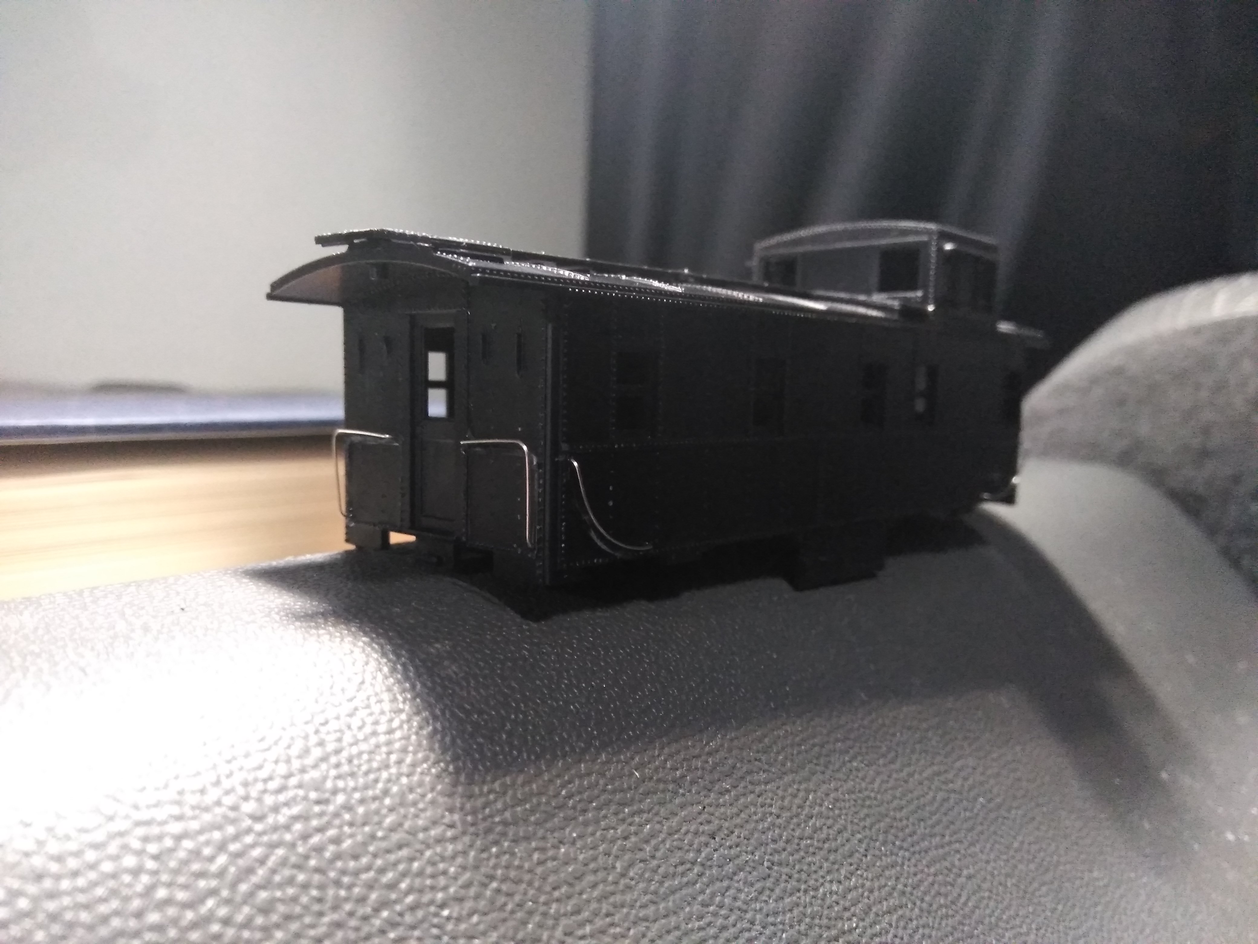

Having fun with a Athearn caboose. I added several details to the model as I always felt it was too plain. The car is a blank canvas at the moment. The coupler cut levers were very finicky to install. All the wire details came from Detail Associates and the air hoses are from Cal Scale. It'll eventually get painted and lettered for my fictional road. I will also install lit lanterns to model and window glazing. Anyone remember the lit lanterns from Utah Pacific?

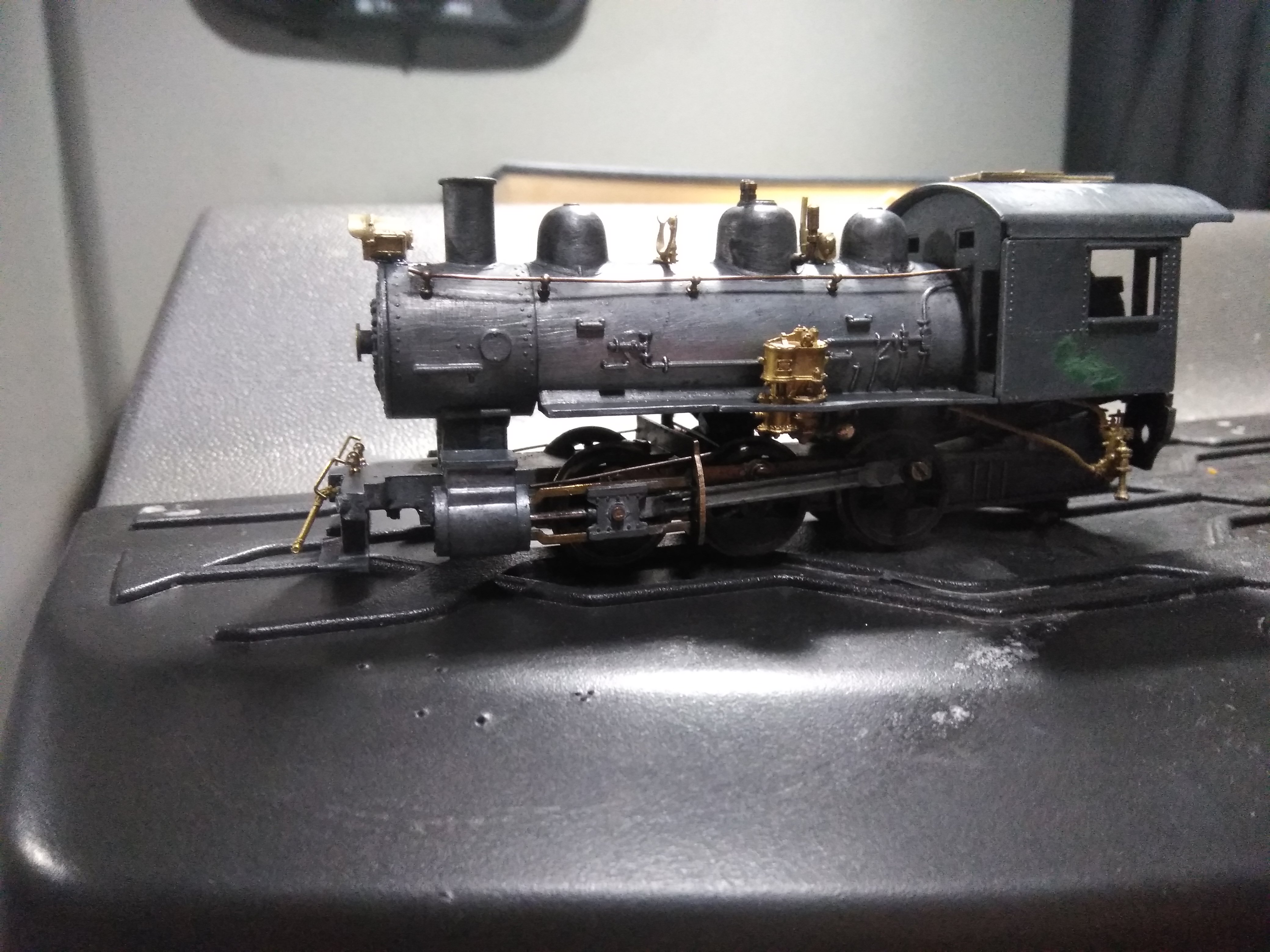

 Posted - February 26 2020 :  7:18:41 PM Link directly to this reply  Show Profile  Add Redneck Justin to Buddylist

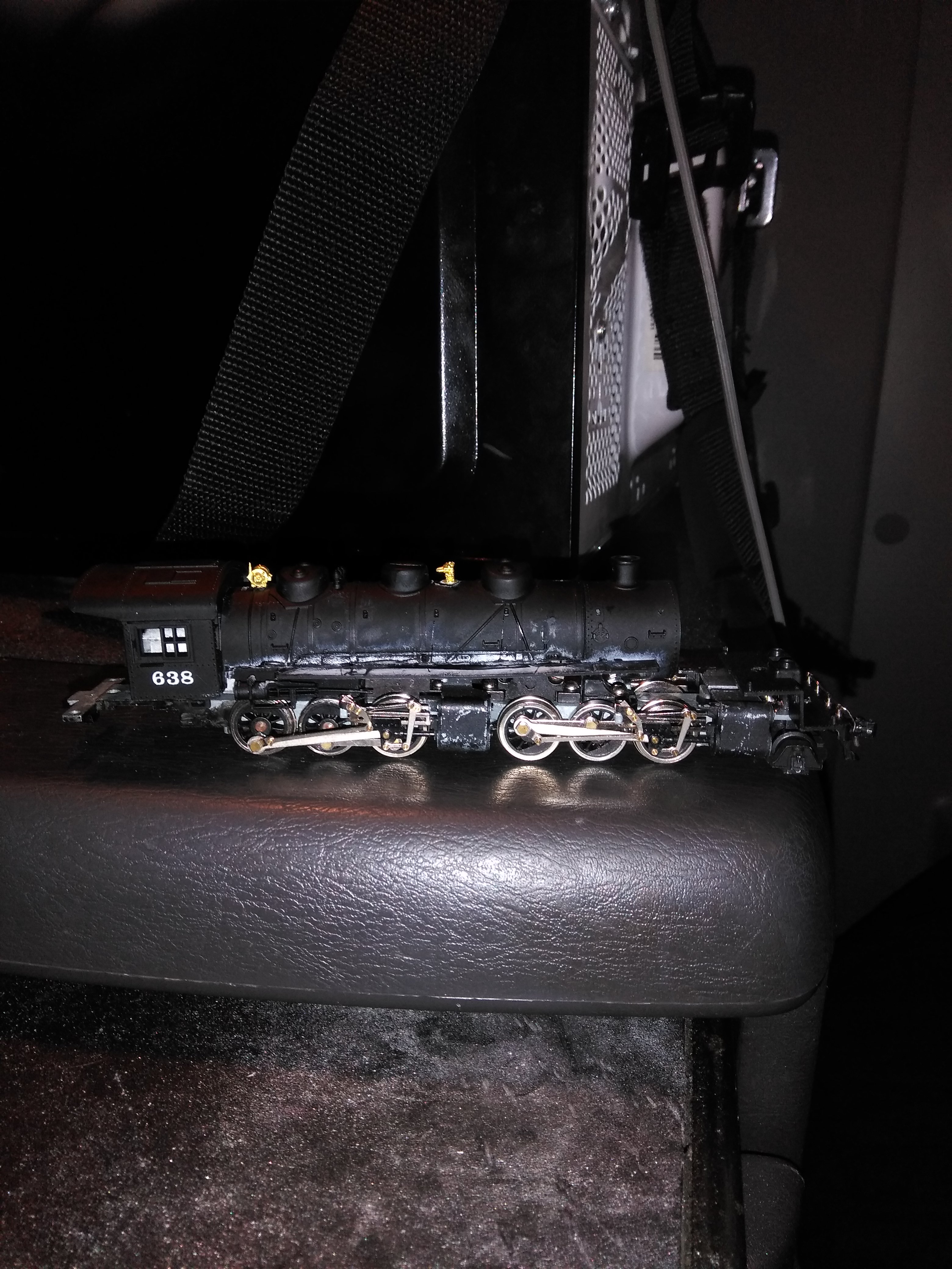

Started detailing the 0-6-0 again. Gotta order some drill bits to finish the job. At least I have all the details parts haha. Joys of working with metal and tiny drill bits.

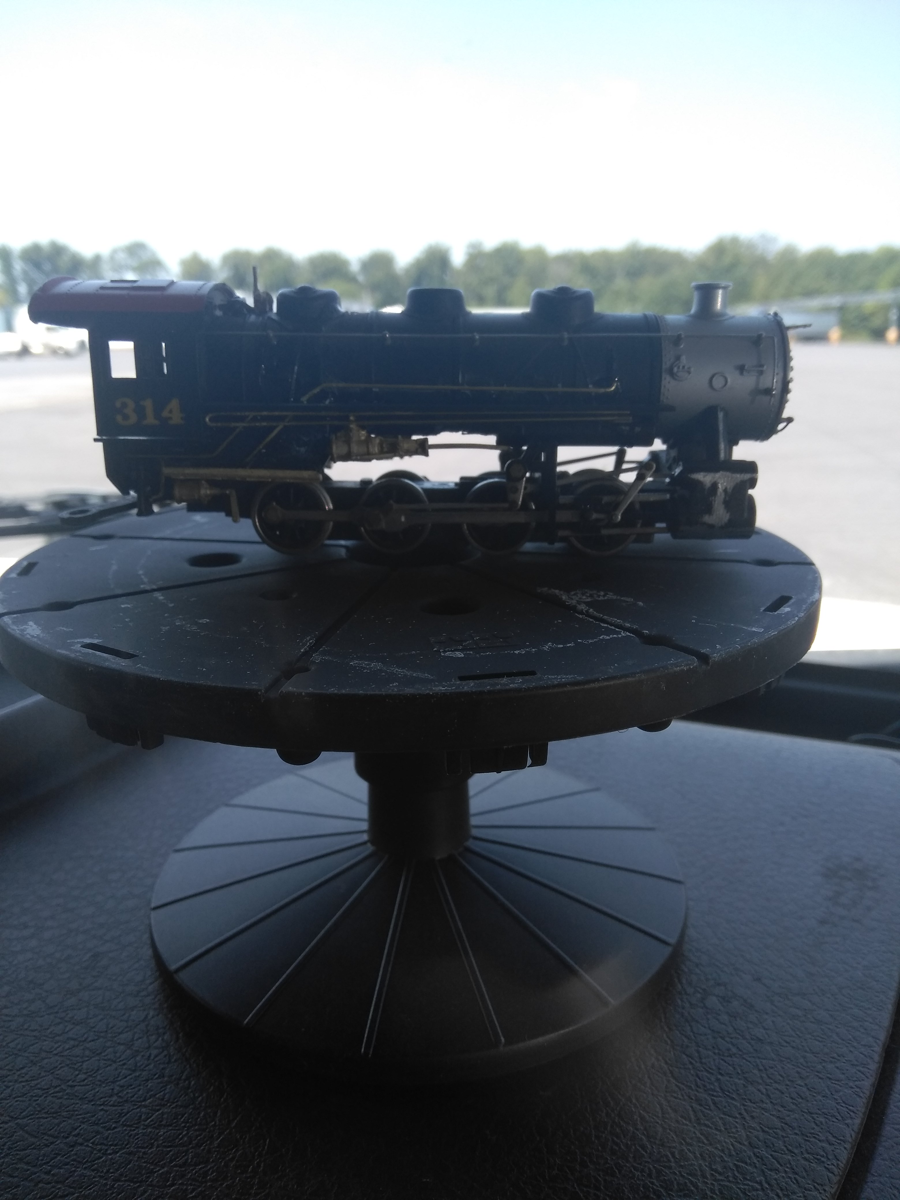

 Posted - May 19 2020 :  02:42:27 AM Link directly to this reply  Show Profile  Add Redneck Justin to Buddylist

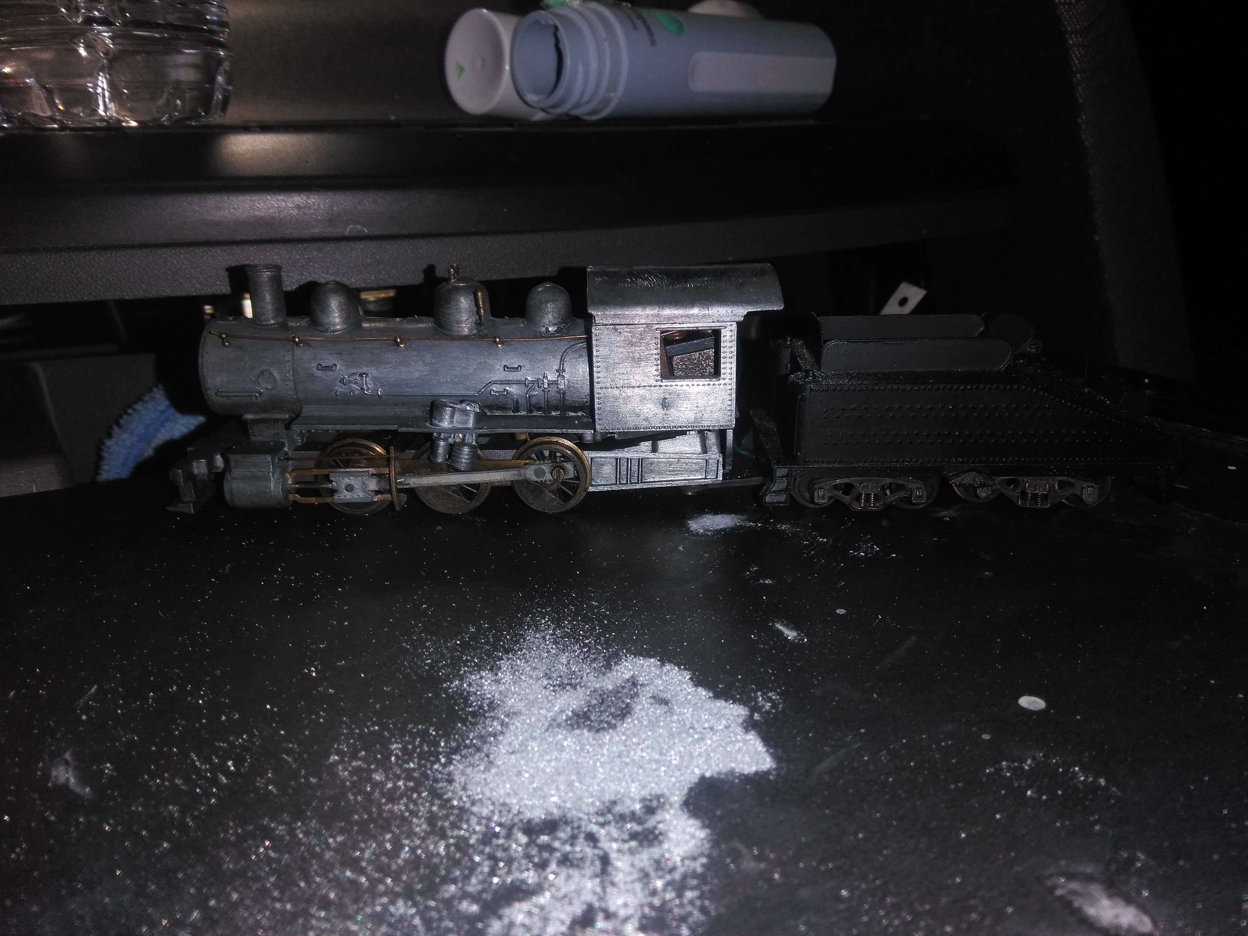

The MDC 0-6-0 is nearly done! Just need to add some details to the tender and off to paint it goes.

 Posted - May 19 2020 :  08:52:49 AM Link directly to this reply  Show Profile  Add southwestforests to Buddylist
Unpainted grey and brass on the 0-6-0 look pretty neat together.
Also bring to mind a French narrow gauge railway which had some steam locos in light grey paint and polished brass.

 Posted - May 19 2020 :  09:04:10 AM Link directly to this reply  Show Profile  Add BlaxlandAlex3 to Buddylist
Wow, That's really shaping up! Aside from some crooked handrails (It happens to all of us) It looks sweet! Can't wait to see it painted!

 Posted - May 24 2020 :  9:50:10 PM Link directly to this reply  Show Profile  Add Redneck Justin to Buddylist

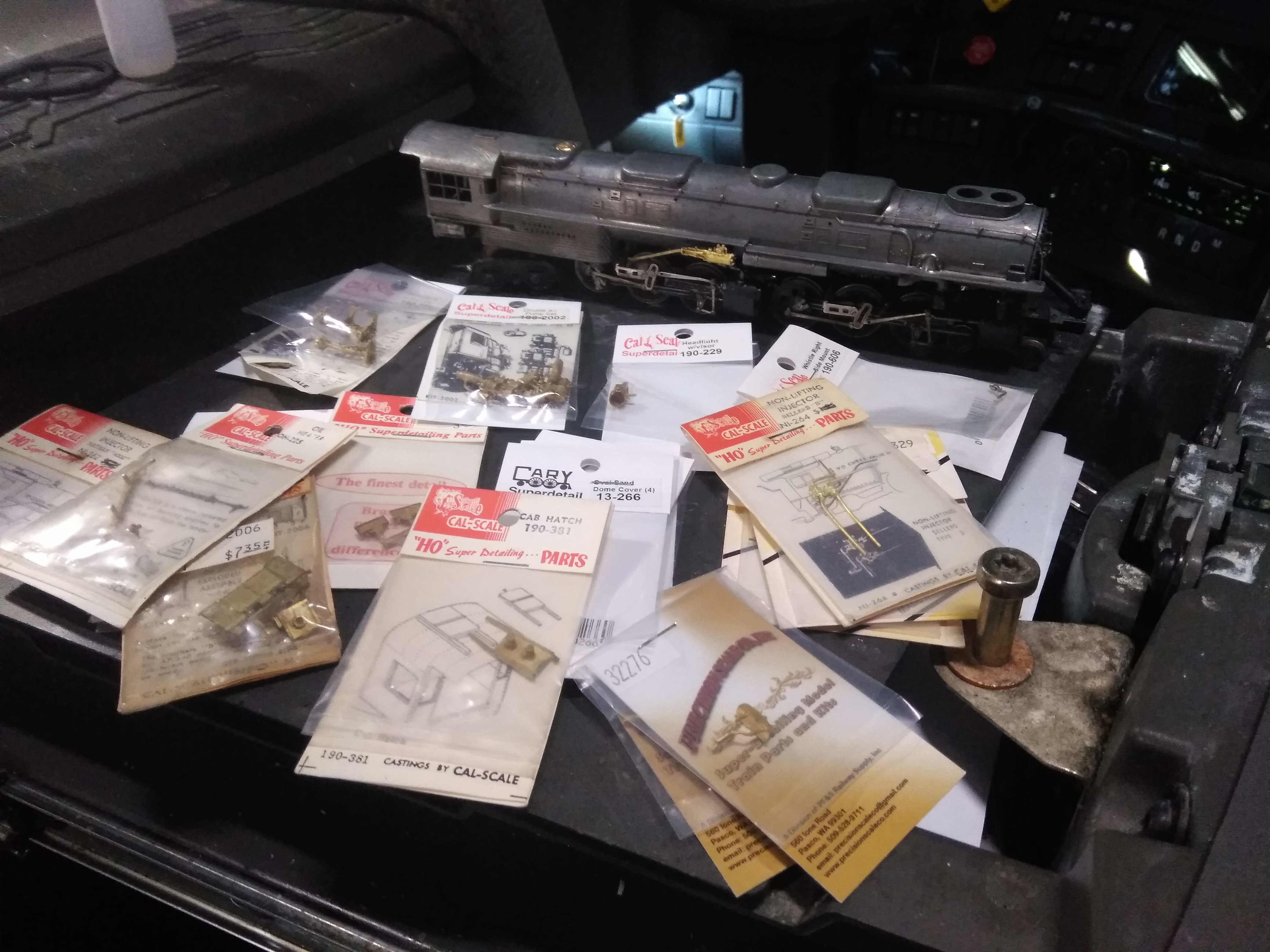

Thanks for all the kind words. I ordered just about all the detail parts for the Challenger. The 0-6-0 will get steel wire handrails as they don't bend or get flimsy. I plan adding a false floor to the tender frame and add brake rigging. Got a nice detail kit from PSC. Hope to order a copper and nickel plating kit soon so I can properly repair the piston rods on the 4-4-0 Varney Kitbash and re-glue the boiler halves. I'll never use JB Kwik Weld again! My plan this year is to start detailing the models into completion and have them ready for paint.
 Posted - May 24 2020 :  9:55:25 PM Link directly to this reply  Show Profile  Add Redneck Justin to Buddylist
The third brass model on the roster. My plan is to replace and relocate the bell. I'll also relocate the air compressors as I never liked the location of them. I'll mount them on the pilot similar to a UP Big Boy/Challenger.

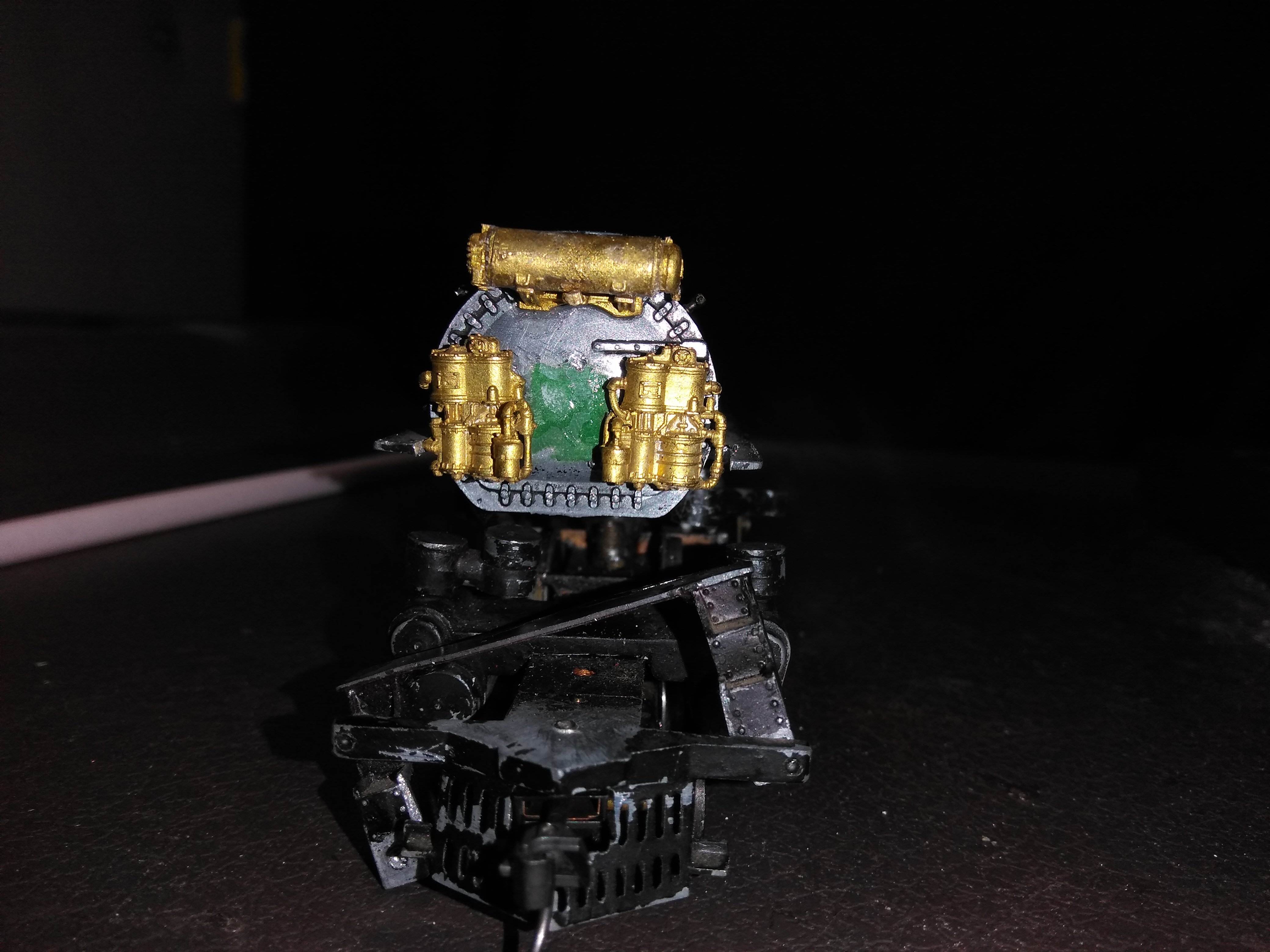

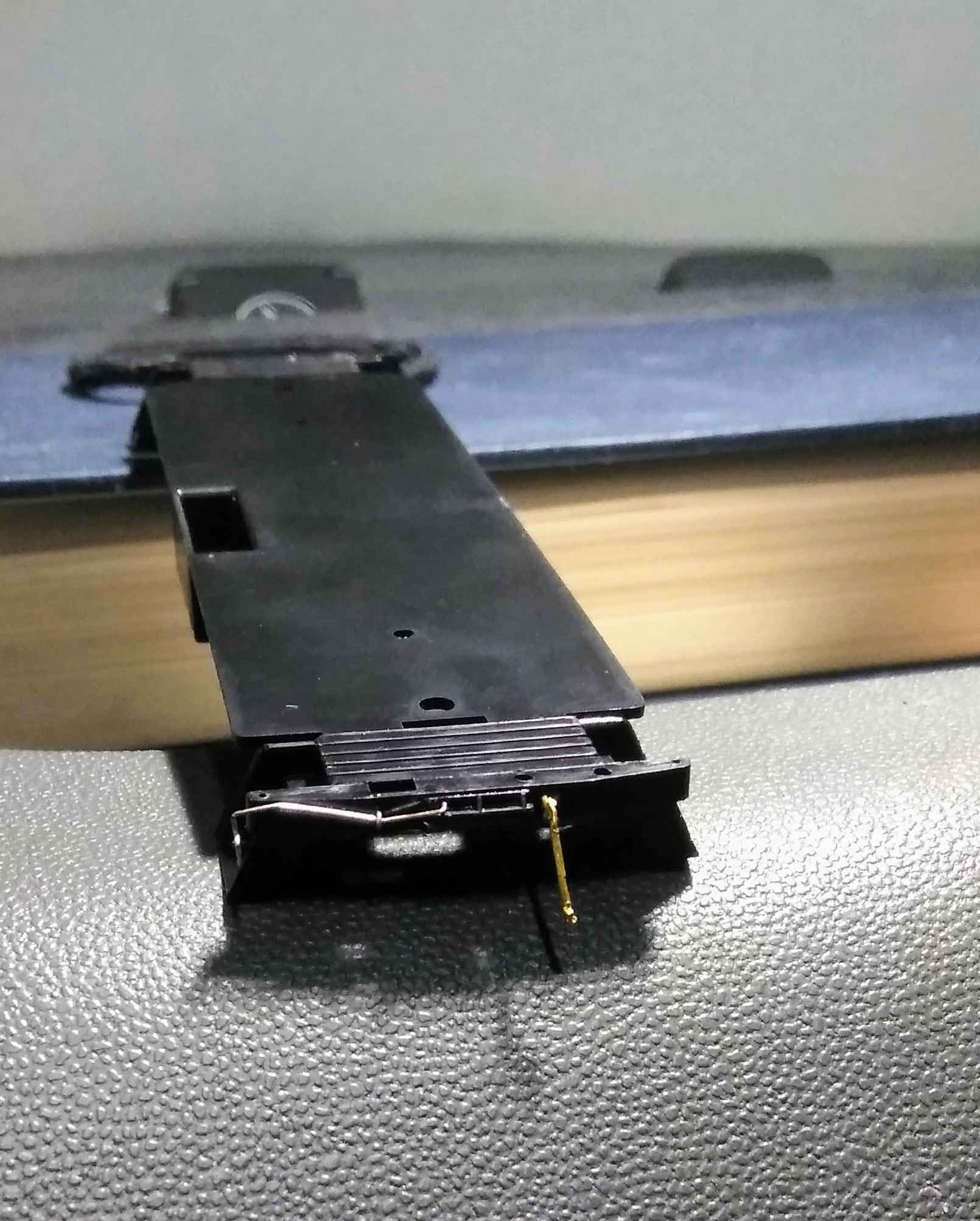

 Posted - June 08 2020 :  12:12:15 AM Link directly to this reply  Show Profile  Add Redneck Justin to Buddylist
Relocated the back up light on the tender and added a head light bracket. I also added the missing water hatch on the tender. I built the area up with putty.
I added a false floor and a PSC brake detail kit. I had to move some components around to clear the trucks.

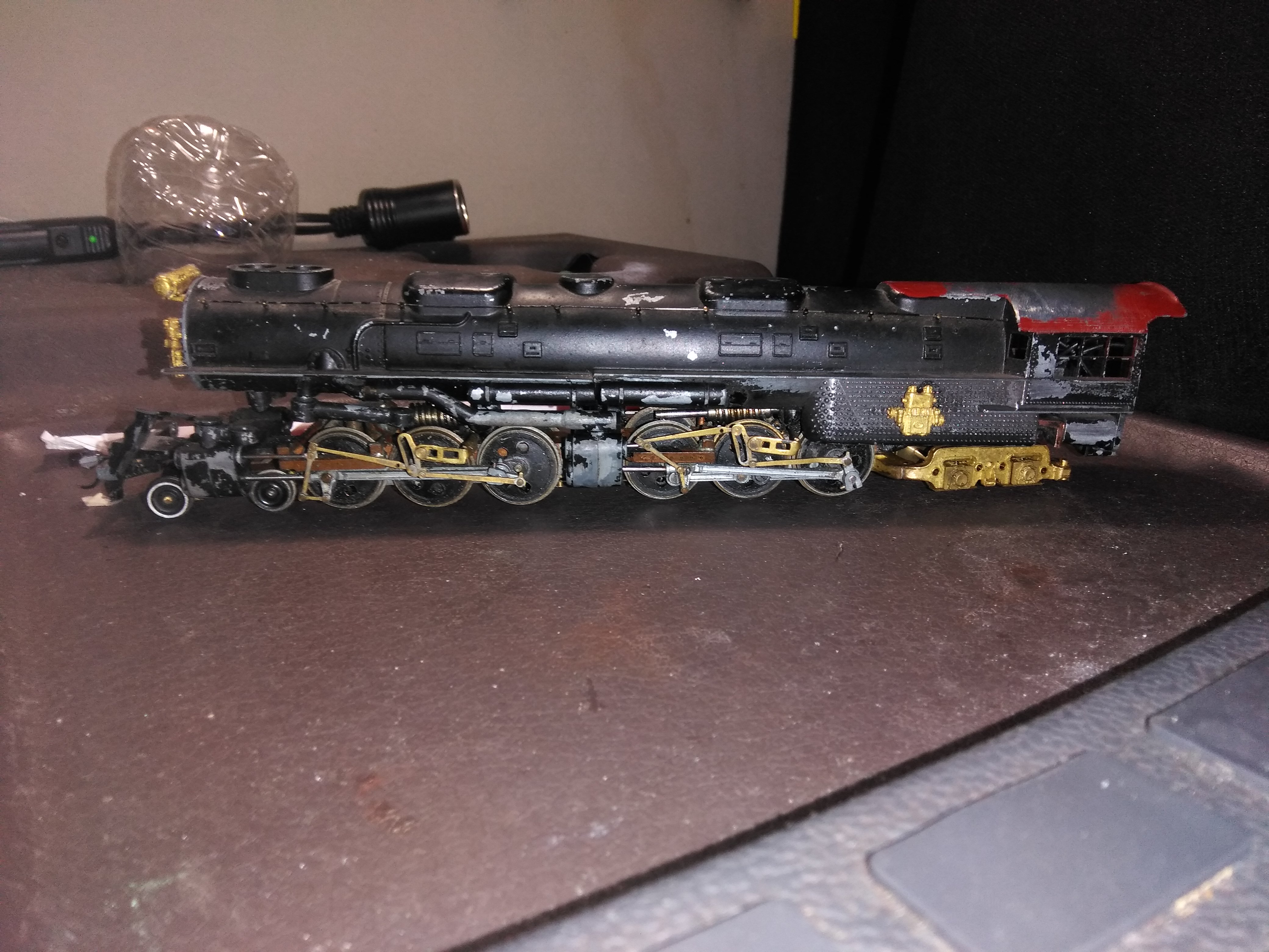

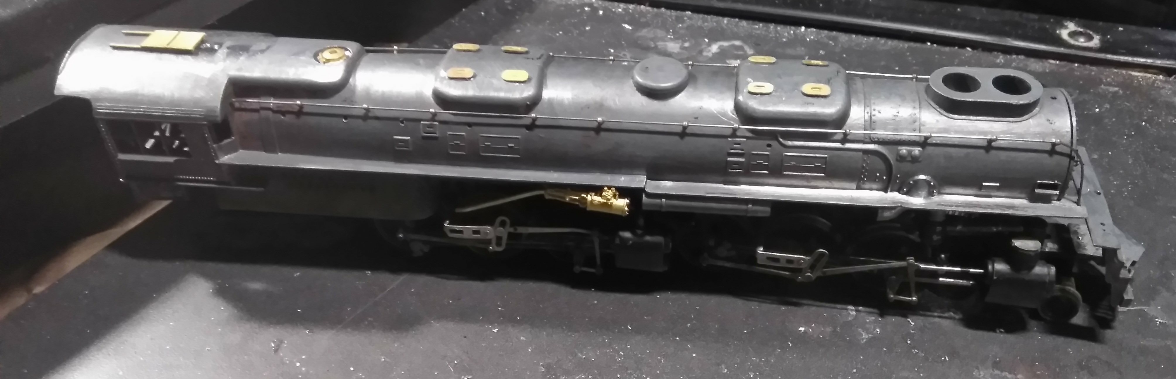

The Challenger begins. I stripped the paint off the boiler and pilot. I went ahead and installed a muffler and a power reverse prior to the photo with all of the detail parts for the engine. I need to order 2 more detail parts from PSC and it'll all here. This is just for the engine! I plan on installing lubricators on the boggies per the prototype as well.

Wow! That's a boat load of detail parts on that Challenger. How are you attaching them?
 Posted - June 14 2020 :  10:05:04 PM Link directly to this reply  Show Profile  Add RP model railroads to Buddylist
Whoa. Looks like it's gonna be awesome.
 Posted - June 15 2020 :  07:10:32 AM Link directly to this reply  Show Profile  Add Redneck Justin to Buddylist
Originally posted by scsshaggy - June 14 2020 :  10:01:43 PM
Super glue.

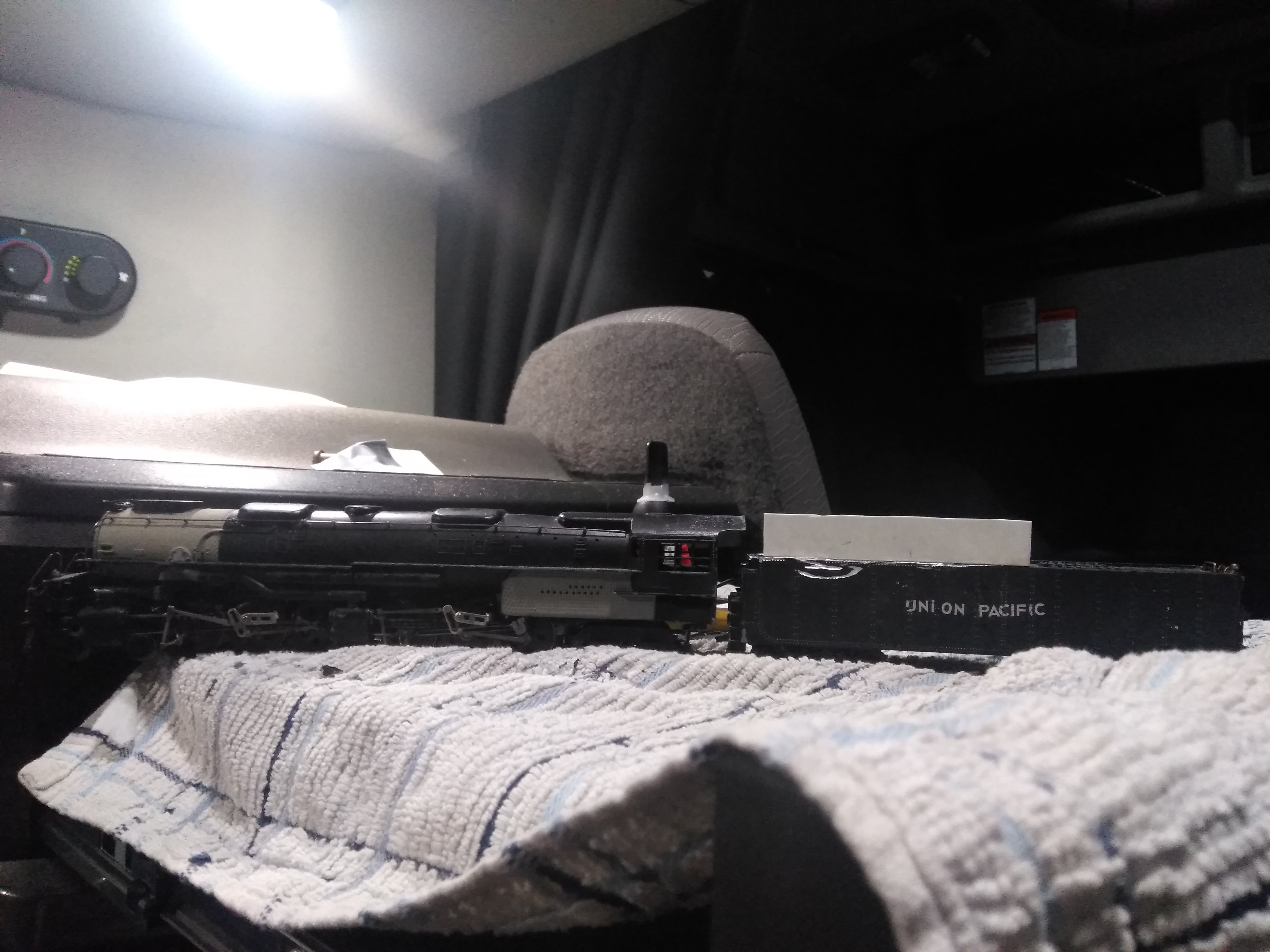

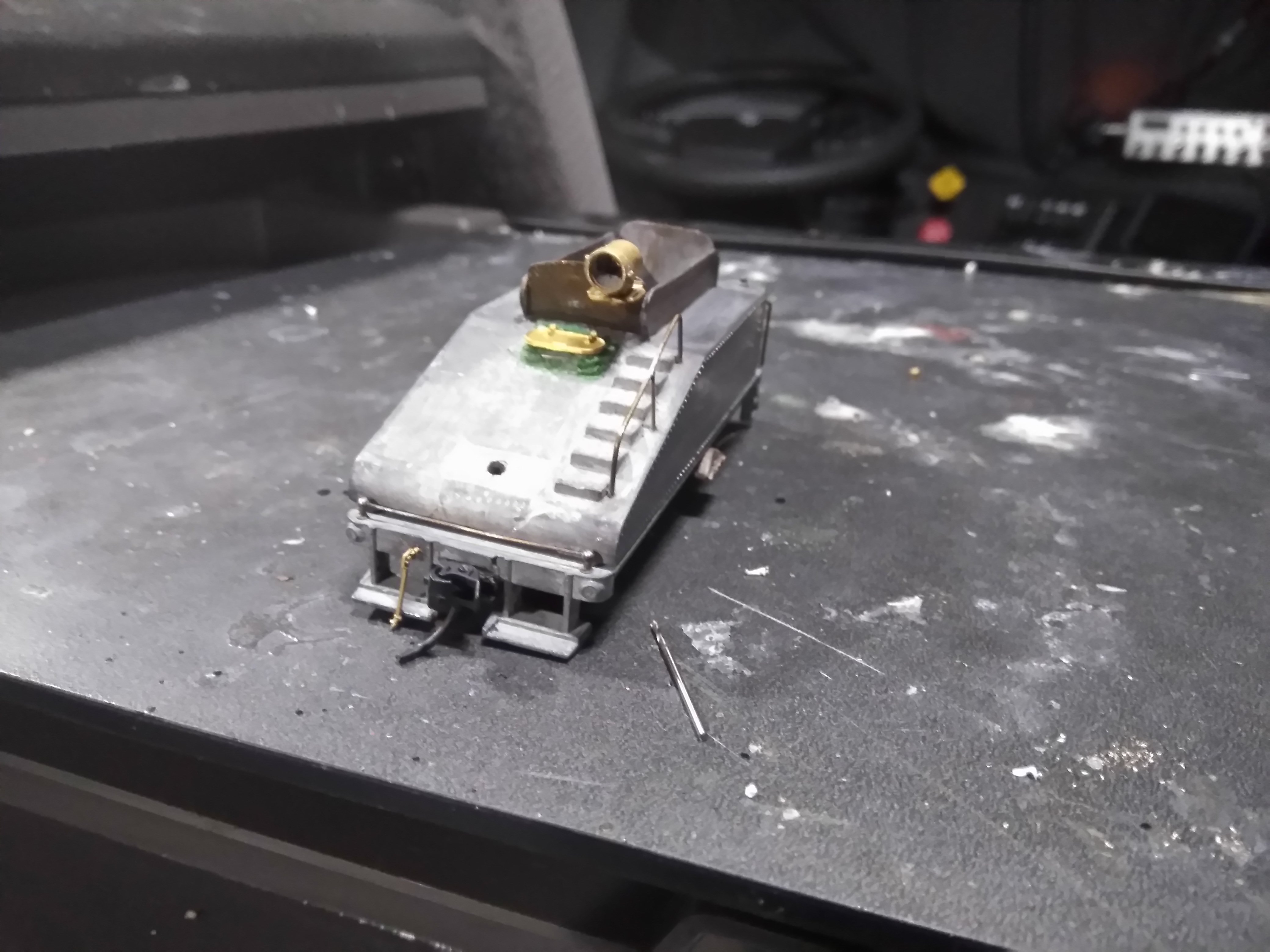

 Posted - June 29 2020 :  12:30:13 AM Link directly to this reply  Show Profile  Add Redneck Justin to Buddylist
Made headway on the tender for the Challenger. It's a Penn Line/Bowser Pennsylvania Railroad long haul tender. I removed the coal bin walls and scratch built a new oil bunker. Wanted a oil burner mallet. I then went over the sides, etc with putty and filed and sanded it smooth. The bunker is just styrene.
