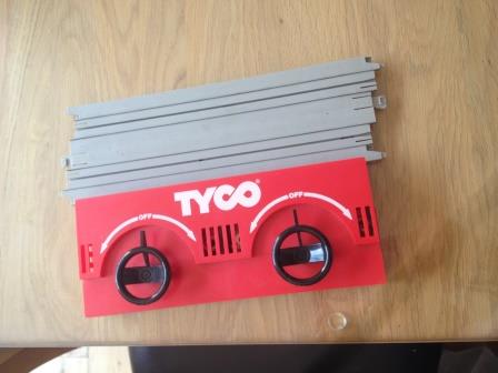

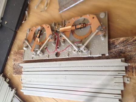

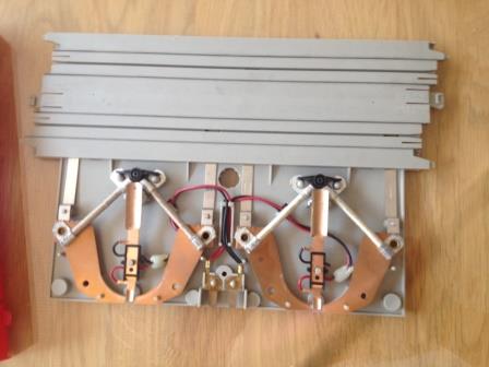

Here are a few images showing what I did:
The built on controller from above

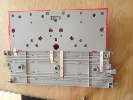

and from below

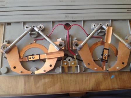

With the top removed showing the workings

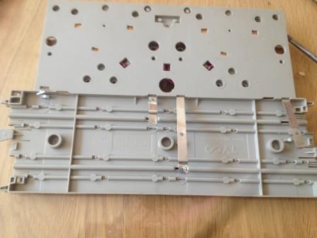

Removing the metal straps from the underside of the roadway
Removing the metal straps from the control gear to get then clear of the saw!

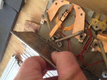

Cutting the control gear portion off the roadway
When the cut is complete.

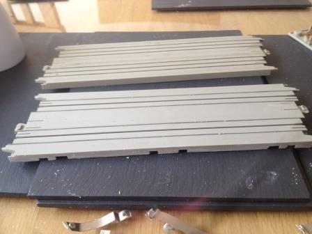

Two sections of roadway made from control sections. The side with the openings is that from the old control box side.
I now have five very good and useful 9" plain roadway sections for the next layout and not had to spend a single cent/penny!
